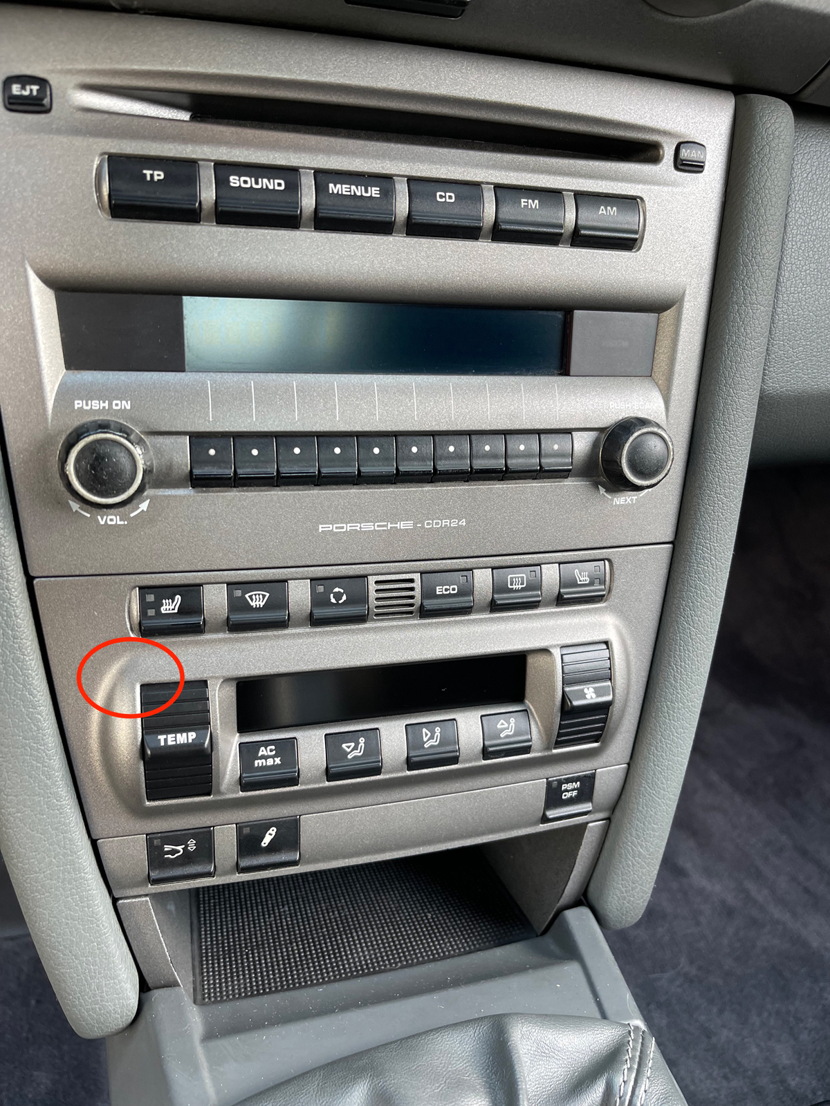

Does anyone know if there is touch up paint available for the 997.1/987.1 center consoles?
I've got a little knick that i'd like to make look better.

I went on a hunt for something similar recently to match a bezel to a modern Porsche interior. I came up pretty much empty. I did find this, and a few others like it:
https://www.colorbondpaint.com/products ... VwEALw_wcB
But with so many different Porsche interior colors in that same basic range, the odds seemed pretty low that it would match what I was looking for.
I also had someone who really wanted a bezel in Texas burnt orange. Weirdly, all efforts to get that color off the shelf failed, so I ended up getting a starter pack of acrylic paints from amazon, watching a bunch of videos on matching paint colors, and mixing my own in a little one once jar. If you got a set of metallic acrylics, like the one linked below, I bet you could get mighty close by just adding the white and black to the silver as needed until you have the exact color:
https://www.amazon.com/Shuttle-Art-Non- ... 11&sr=8-22
I wouldn't paint and entire car is this kind of paint, but for stippling in a little chip like that (or even airbrushing), I suspect you can get a great results that will last plenty long. My only hard-earned tip is that liquid acrylic is milky white before they add the color, but that milky white dries clear, so to get a good match you need to mix it to something that looks a shade lighter than you want, then dab a little bit and let it dry to see the actual/final color. Here's a video I did to celebrate the Texas-colored bezel, and you can see how many time I tried to get the color right -- and how many of them were too dark until I figured out that secret!

Great advice Tom. I may give that a shot if I don't find anything through further searching.
Sooo many 987 and 997s out there so i'm surprised this isn't a thing.

Or maybe even something like this for such a small spot:

Well, for $7.99 it's hard to go too wrong. My concern would be the paint needs to be very thin to flow in a pen like that, so less likely to 'fill-in' the chip. How about a bottle of Testors silver for $2.09

Haha. You fixed it for me. Oh wait....Tom wrote: Wed Aug 03, 2022 6:33 pm Well, for $7.99 it's hard to go too wrong. My concern would be the paint needs to be very thin to flow in a pen like that, so less likely to 'fill-in' the chip. How about a bottle of Testors silver for $2.09
Too bad real life isn't as easy as photoshop....
I suppose anything silver in that spot will look better than the black. It's a 17 year old car with 128K miles and this is what i'm nitpicking about. haha
