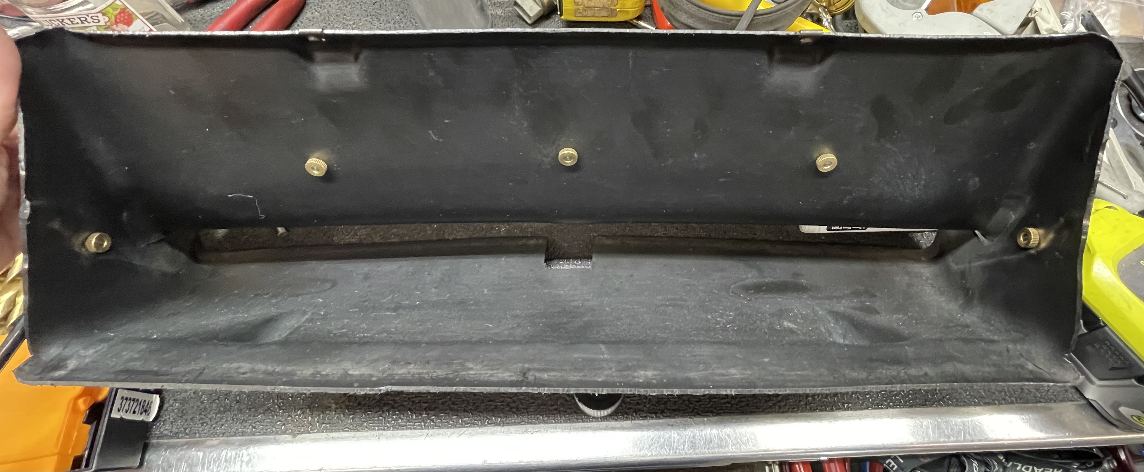

Nozzles
DGUN951
Posts: 52
Joined: Wed Oct 13, 2021 5:10 am
Has thanked: 11 times
Been thanked: 19 times

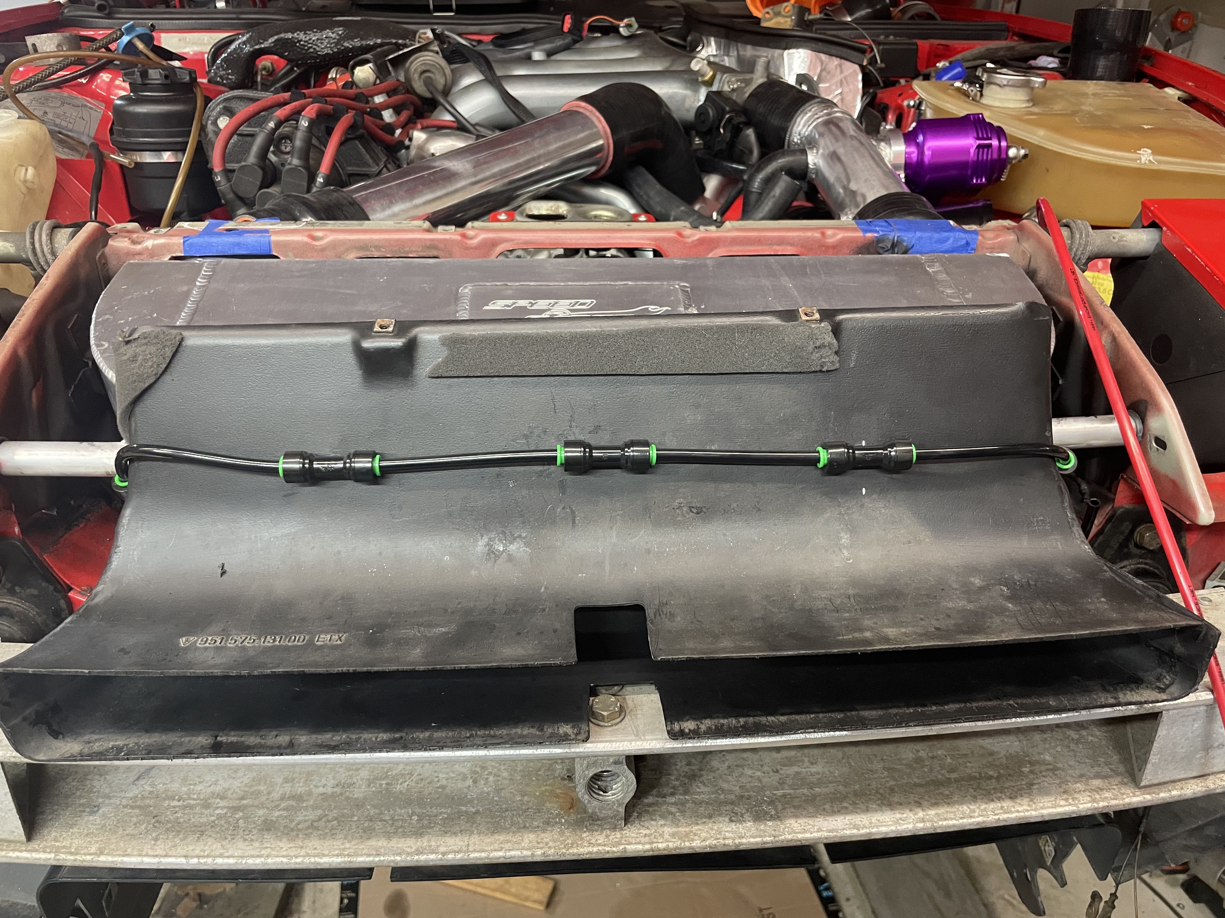

Plumbing

Here’s the list for easy access
Mister jets
Aimego Outdoor Misting Cooling... https://www.amazon.com/dp/B08V972ZXT?re ... b_ap_share
Pump…. This one’s cheap but works, it’s a bit on the loud side, I’m sure a better pump could be sourced
Windshield Washer Motor Pump, Keenso SIA0050 12V Universal Windshield Washer Pump for Car Van Bus Truck https://a.co/d/7X8KCbn
