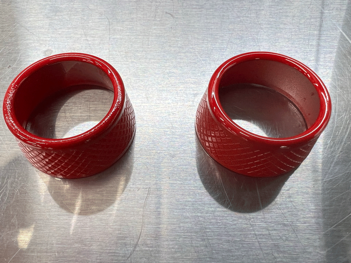

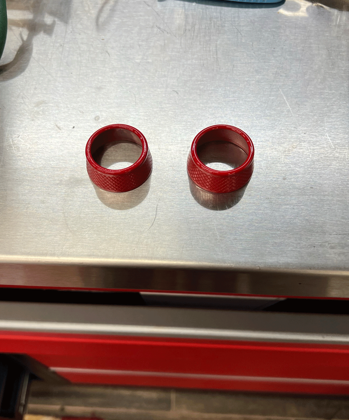

Here is an original 100-micron version and the new 50 micron version side-by-side. Both look good and ready to go, and once installed most people would ever notice the difference when viewed from the driver seat....

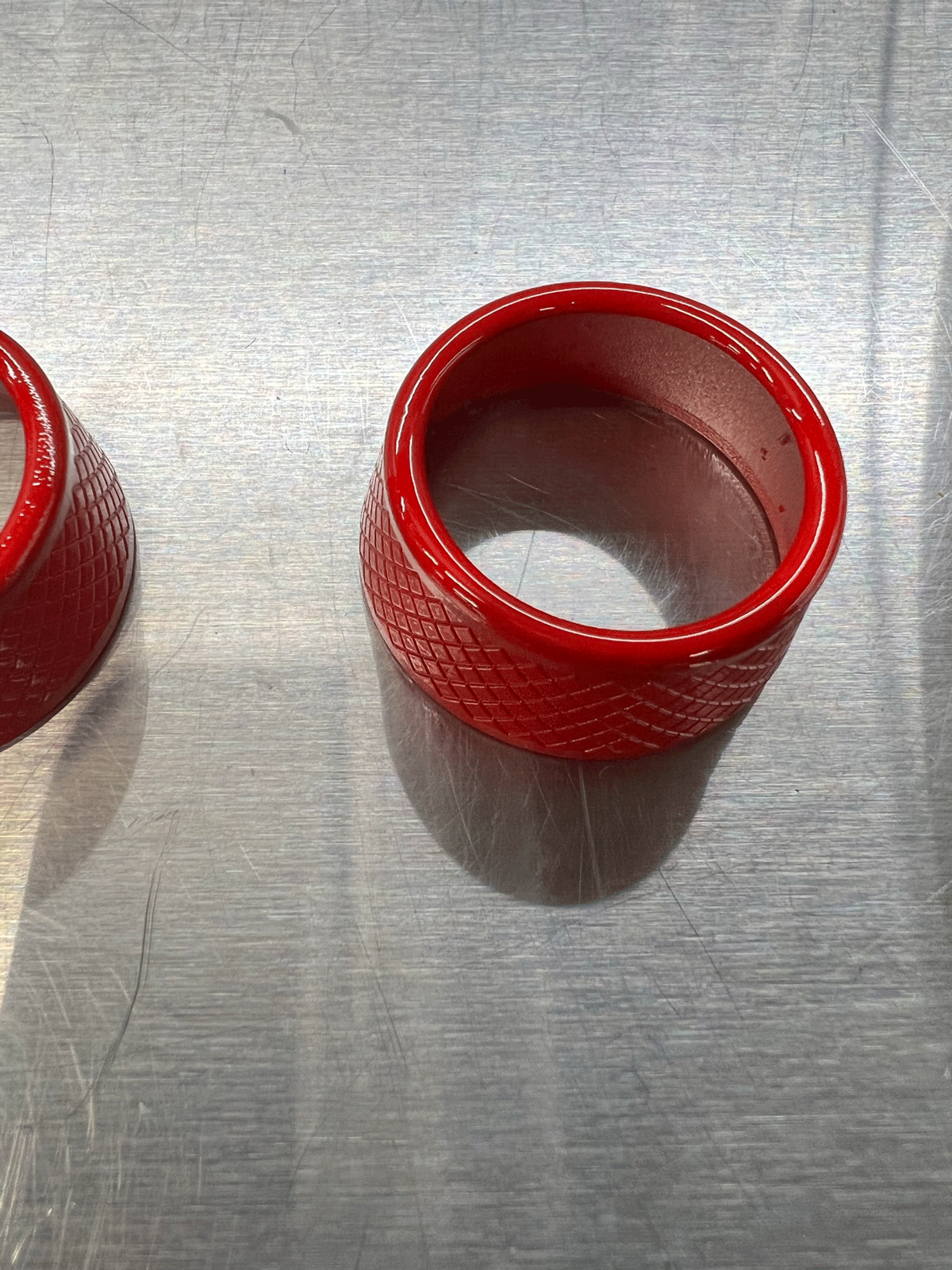

But here is a close-up....
I can't guarantee they will all look this good (they won't) but once you see them look like this, it's easy to obsess on making them all look like this.... That paint is dry to the touch in case you're wondering. This isn't your father's 3D printer!

Wow, that is amazing and both look great!!! Tbh I don’t think anyone could tell the difference once installed - I sure couldn’t!
When I look at both closeups carefully, it ‘seems’ the cross-hatch grooves are slightly more pronounced on the 10mm version… is that just an optical illusion?

Well, it's actually the same CAD model, which we'll call V14
The knurling on the sides is the same, as it the whole thing.

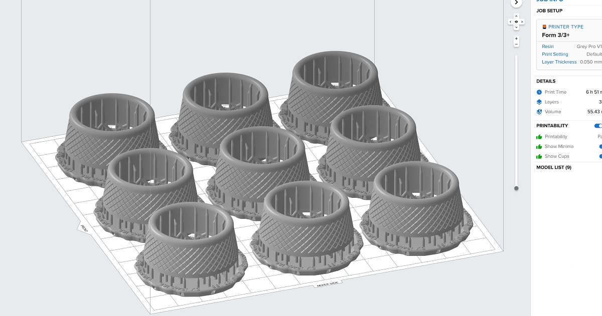

In person, I need to look under a magnifying glass to see the difference -- at least until the paint goes on. The model is created in CAD software (Fusion 360). And then that model is imported over to the 3D printer software (Preform), where you set it up for printing. That's where you set the layer height and support structures and print orientation, etc. There's a whole trial and error aspect to that too. A lot of that isn't something I'd fuss over if just doing one part for myself, but if I end up making dozens or hundreds of these, it really helps to start with a print that lends itself to the paint.... Here is the current set up on the printer, which seems to be the keeper....

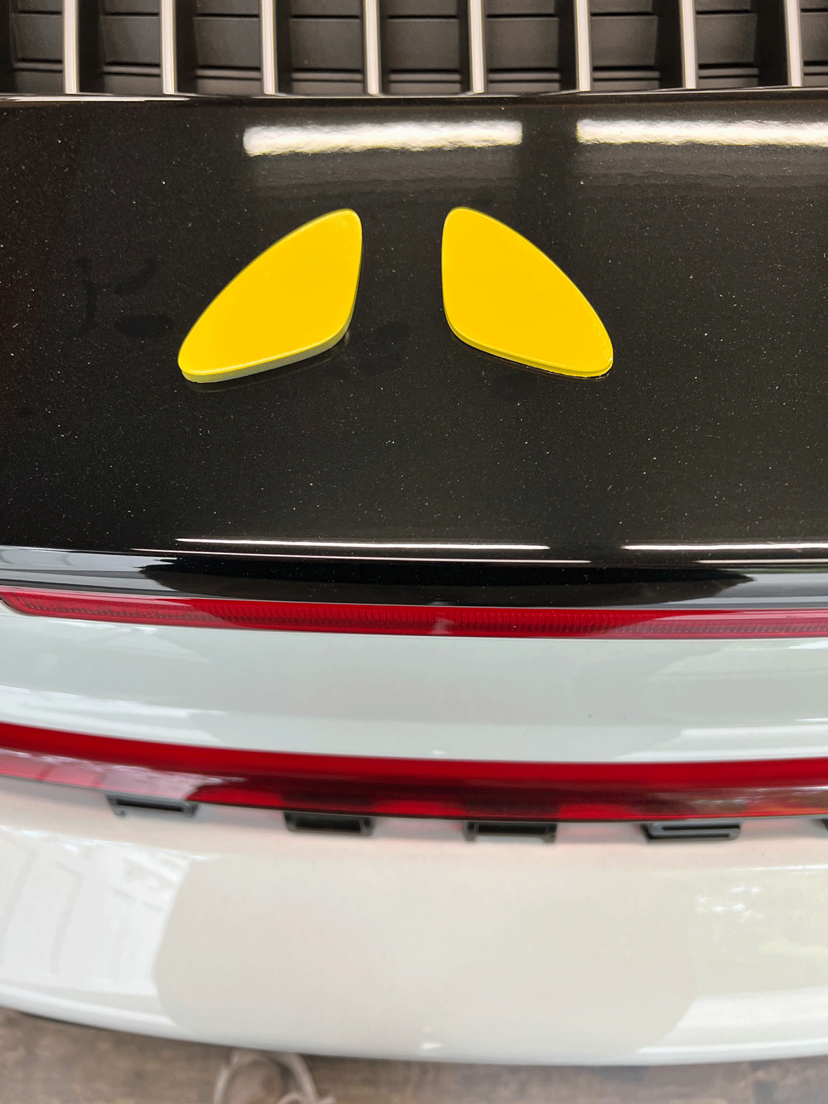

Thanks. That said, the yellow is a different type of paint (base/clear) so I'm not expecting to get quite as glassy the red. I have not tried to optimize my process for it yet, so stay tuned. With the bezels, racing yellow is by far the most difficult color -- even more so than white for some reason. However! Yesterday I found a Rustoleum yellow can that should dry to a glass finish like the red. So we shall see. I did some test pieces on the same plastic and, while not absolutely identical to the Racing Yellow I had mixed, it's remarkably close. Without color-matching to a specific car, both are probably as close as the other to any given car. Left is Racing Yellow I had mixed; right is Rustoleum JD Yellow....
