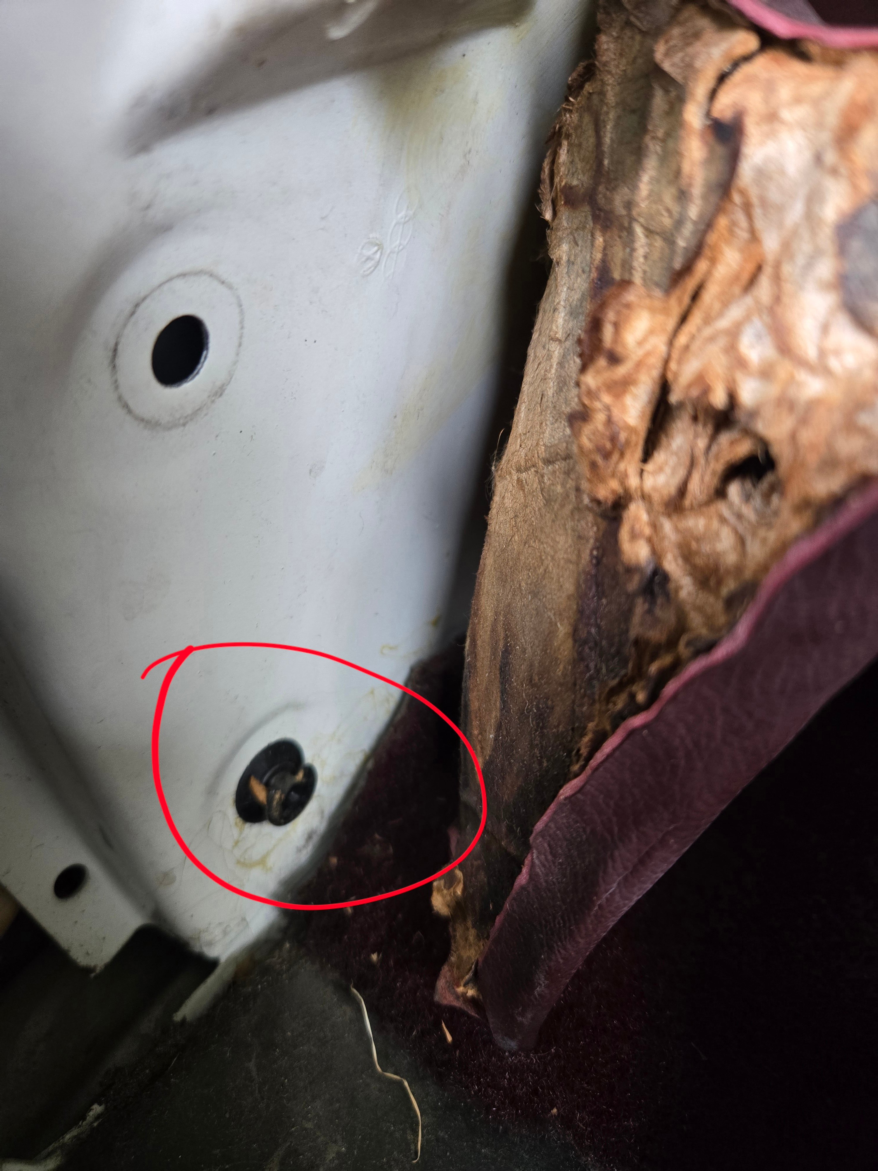

One of the bolts that attached the original AFM to the original air cleaner housing
Very possible, but I would be surprised that it didn't bounce out of the engine bay a long time ago. The MAF has been on the car at least since 2010 from the previous owner.

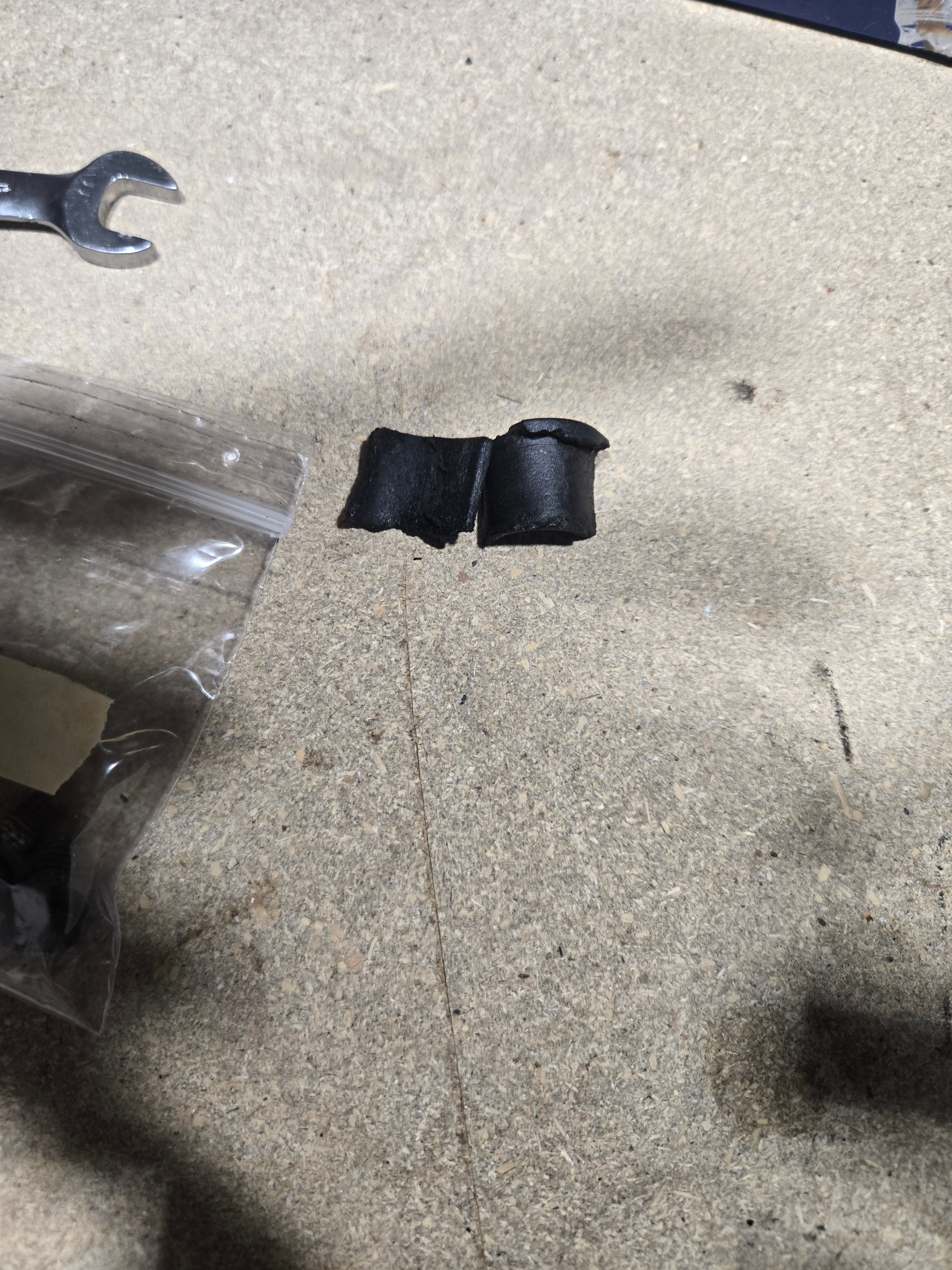

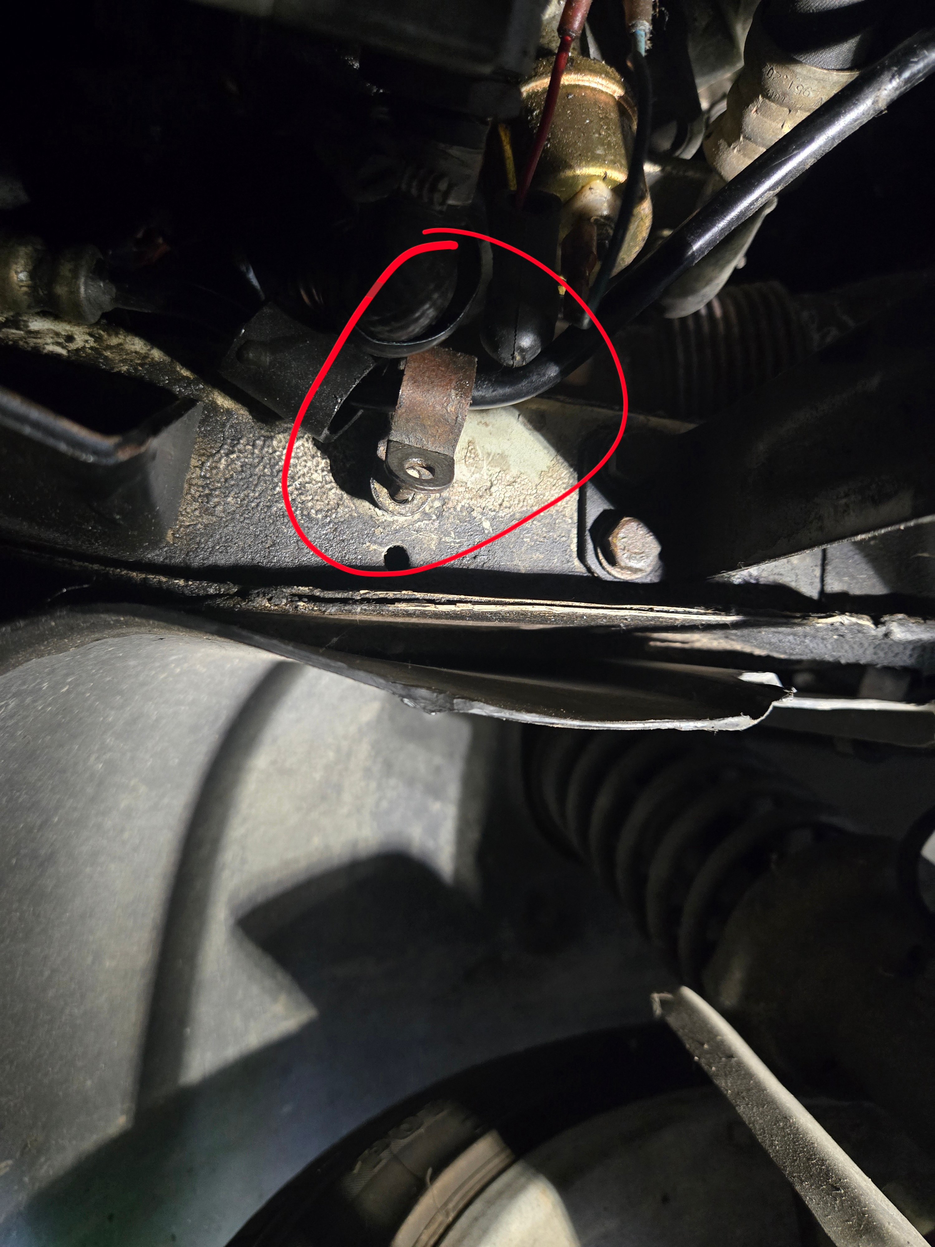

-There is a hard-line clamp near the oil pressure sender that has disintegrated - the rubber is thrashed.

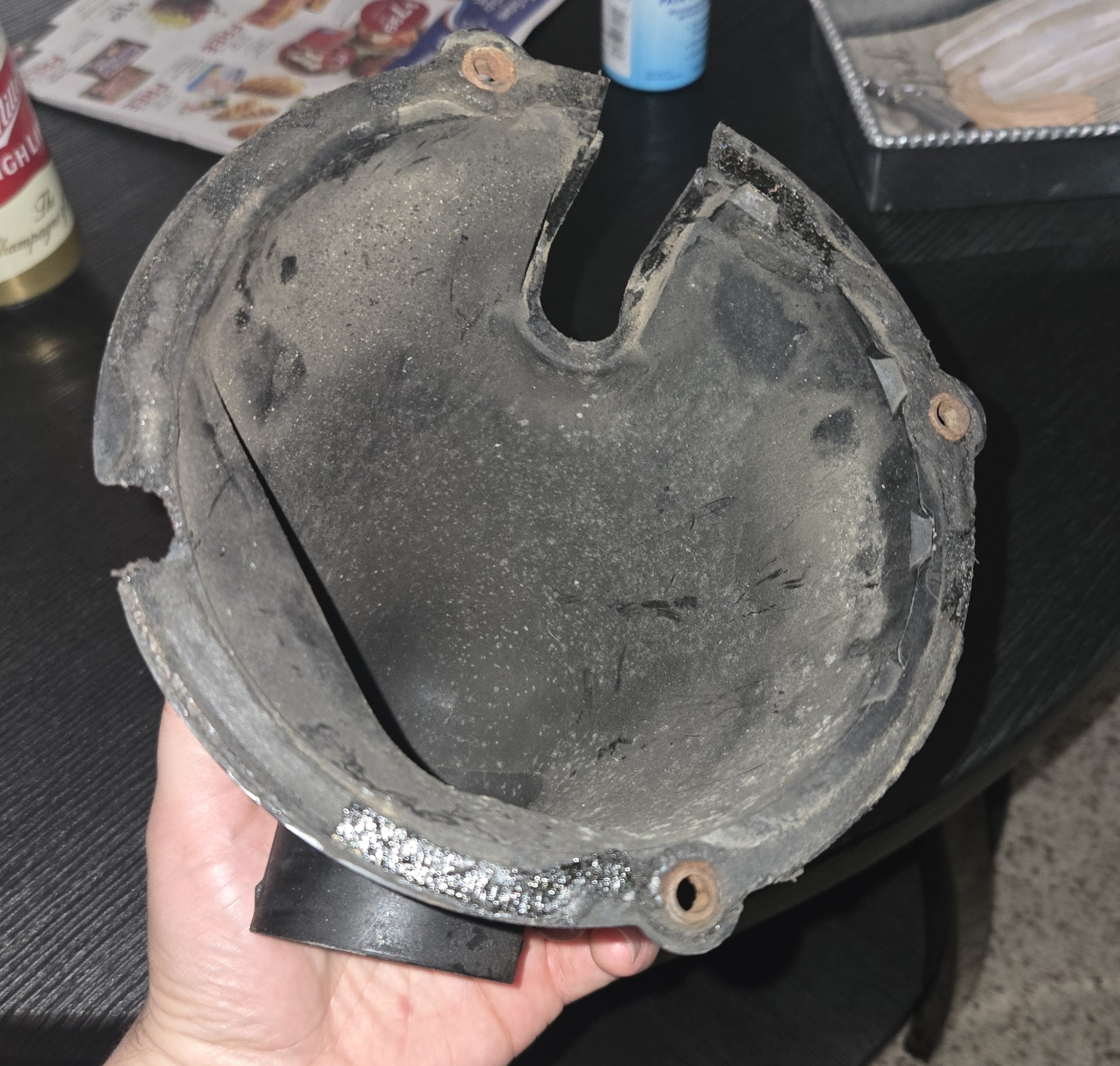

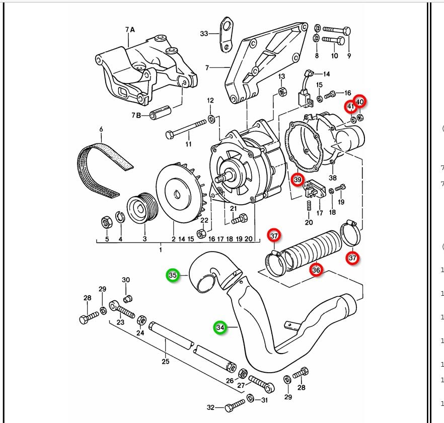

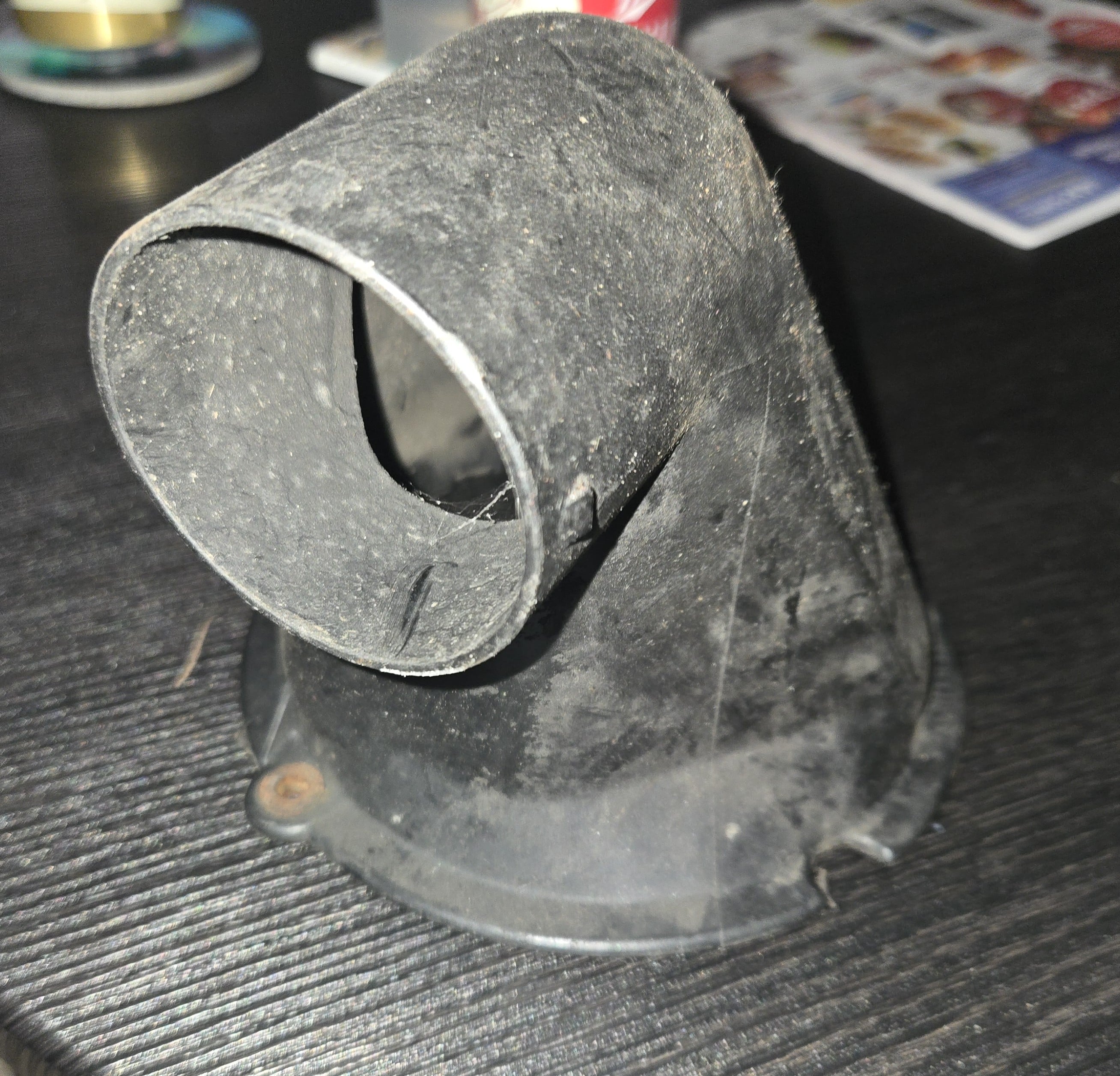

It appears that my car has been running without the alternator cooling air ducts. I have the cover for the rear of the alternator, but the seal has had it.
This may be contributing to overheating of the alternator, causing needle bounce on my gauges when letting off the throttle.
I've placed and order for the seal and the flexible hose. I will need to check my spare parts bin for Item 34 (944-603-441-00 / long air duct) and Item 35 (944-603-442-00 / short air duct). The short duct is available new, but the long one seems harder to find.
I will also replace the voltage regulator for the alternator while I'm in there. The alternator has been replaced under current ownership so should be OK.

Hardline PS clamp is 10 x 15 clamp pn 99951111602
I think any 15mm diameter clamp would work, but hope that helps. I order nuts, bolts and clamps from Belmetric.com , they have p clamps there too. I think you need an m6 mounting hole.
