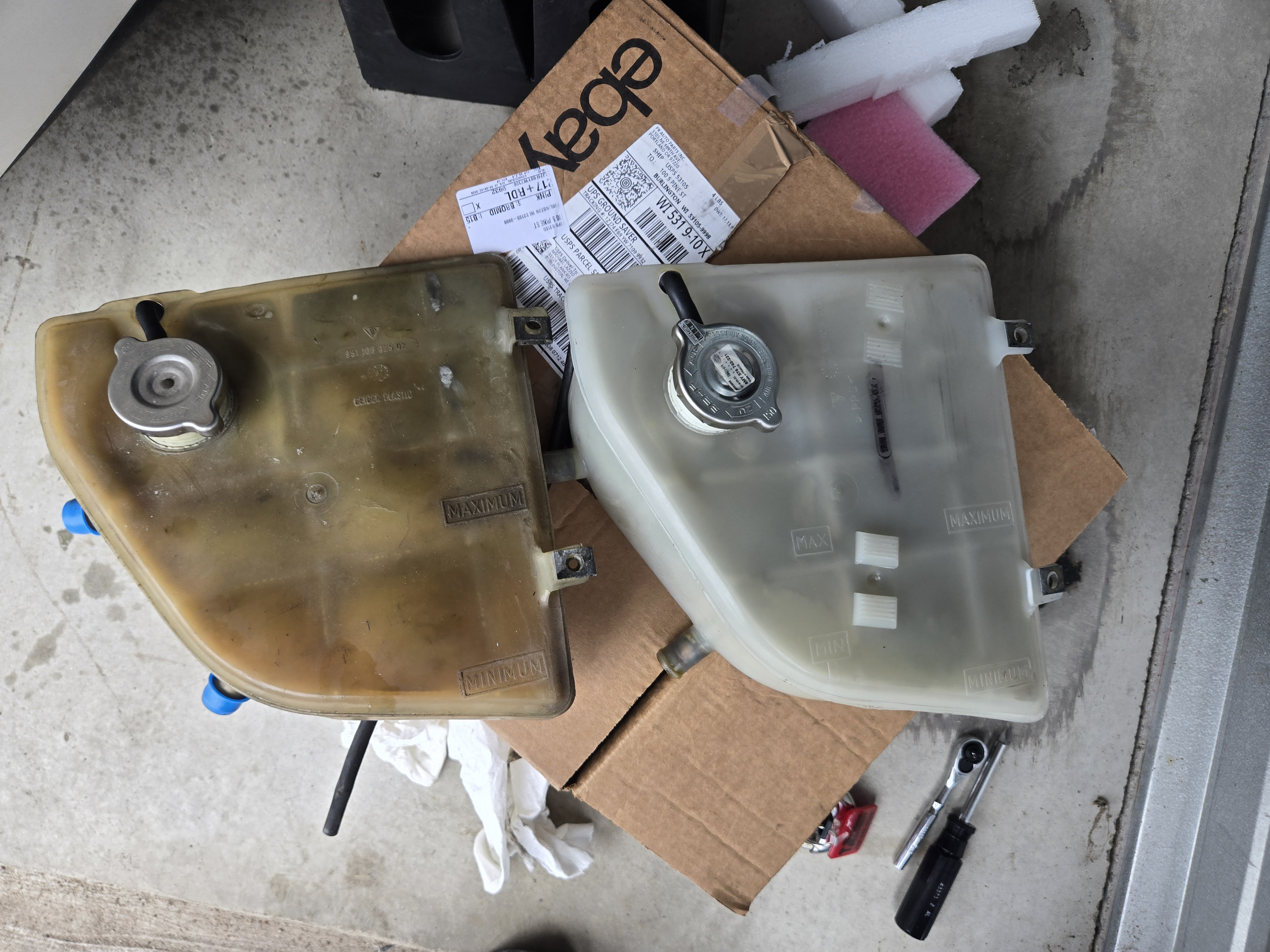

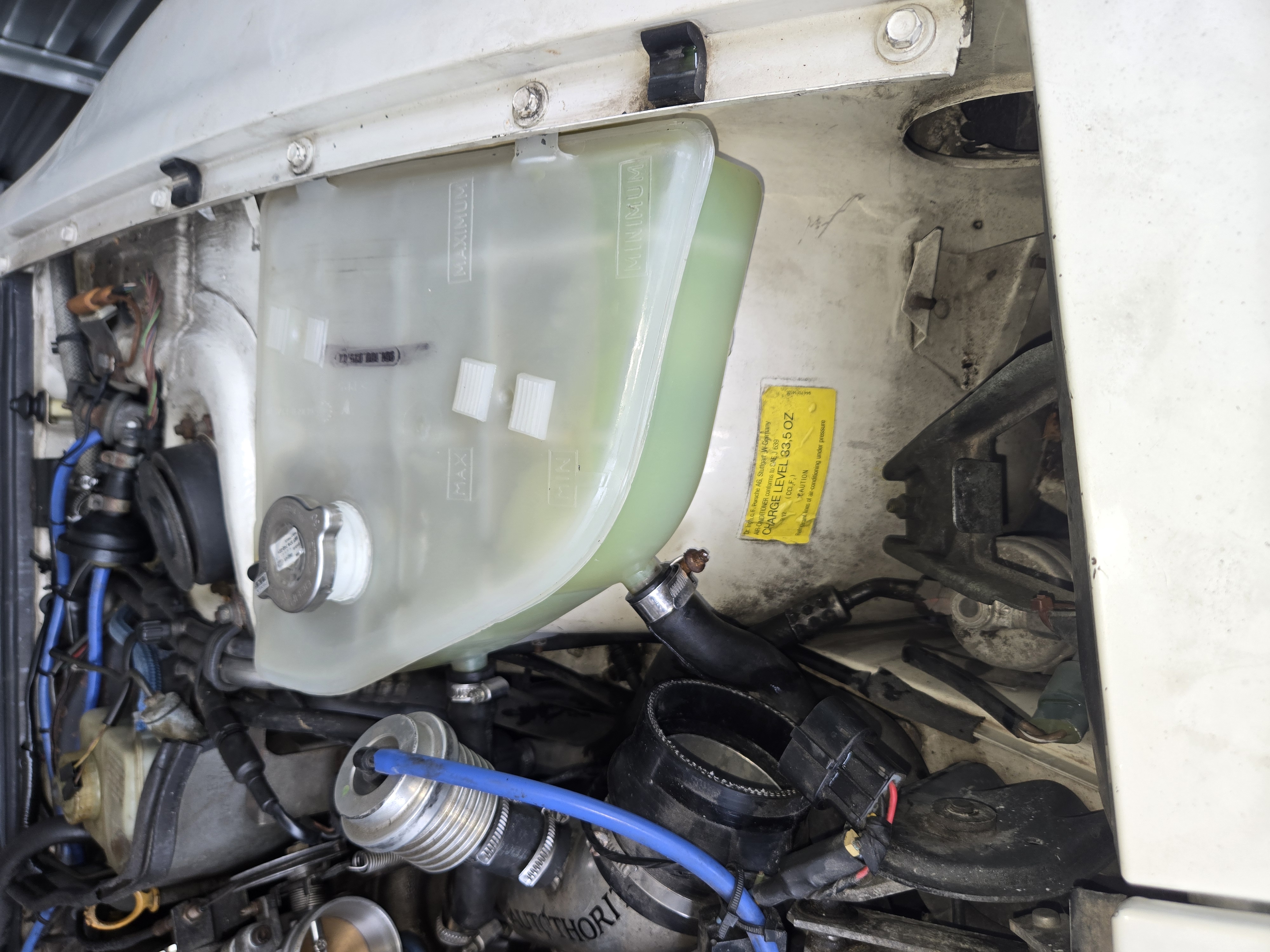

I haven't been able to spend much time on the car lately due to my work schedule.
However, I did find a used coolant reservoir at a price that I couldn't pass up, and it was worth every penny!
Now the coolant level is clearly visible; no more guess work.
I will still bleed the system through the vent bolt and cycle the HVAC system to get air out of the heat exchanger etc. I do plan to invest in a pressure tester also at some point.

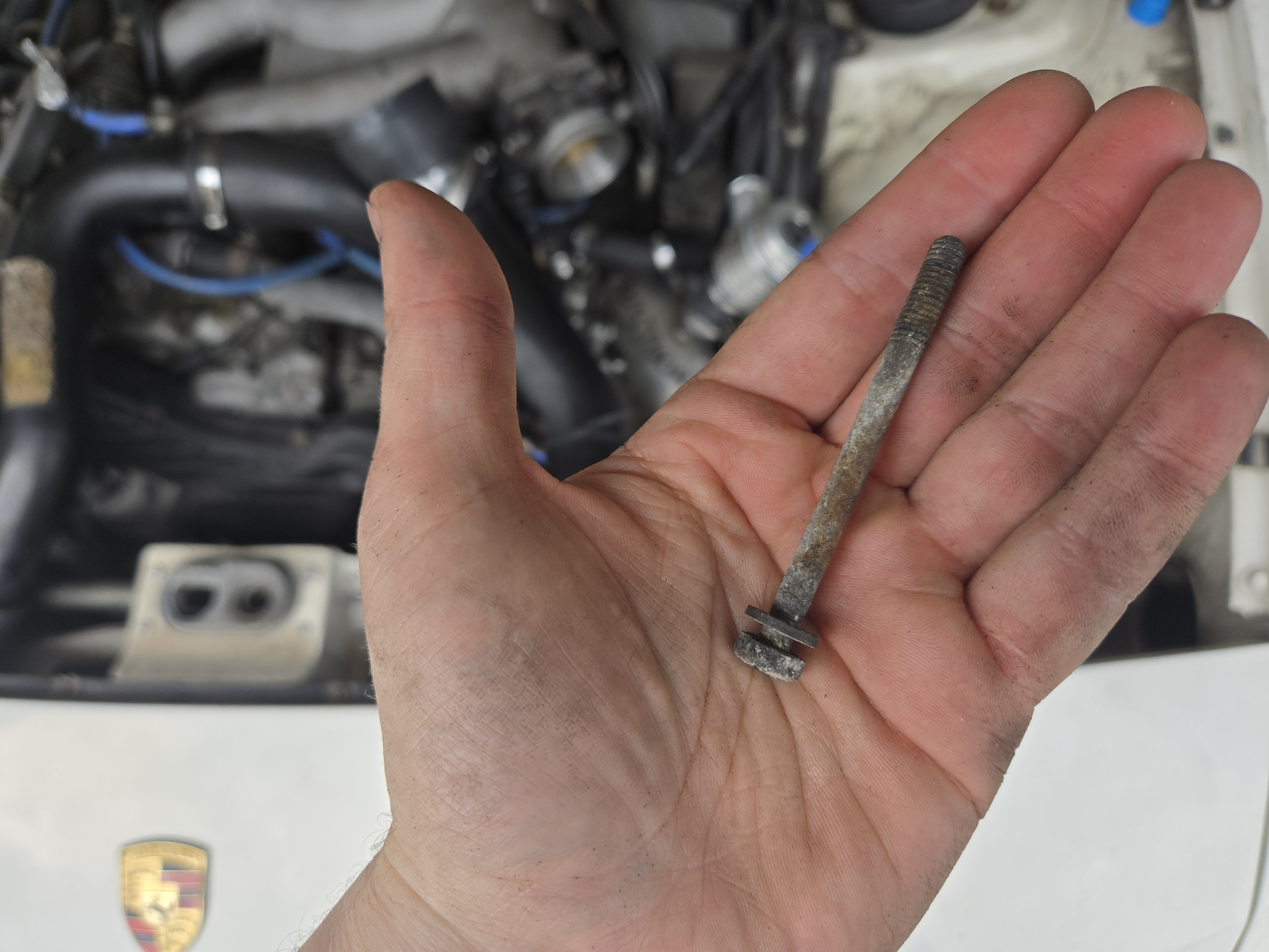

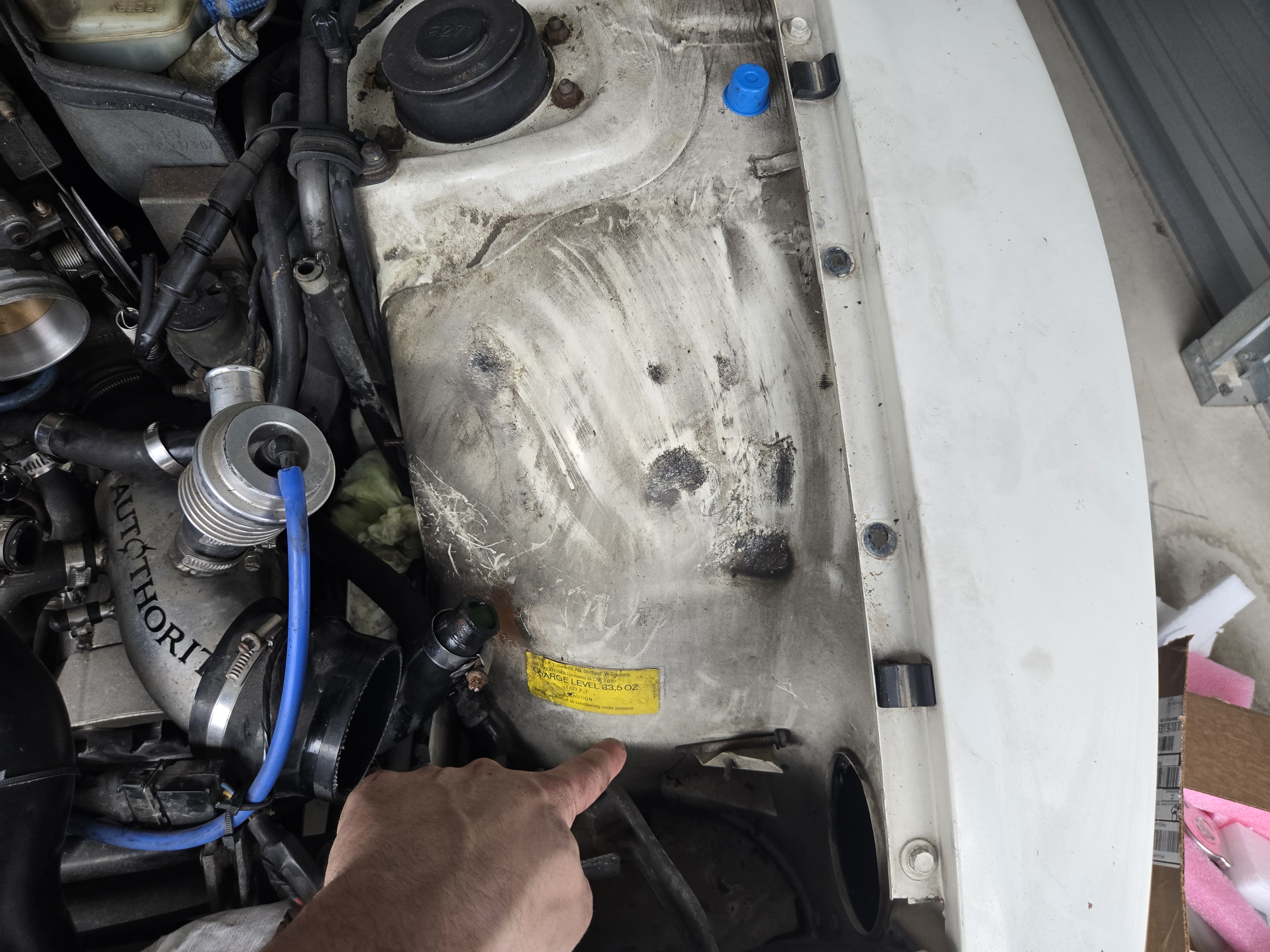

danmartinic wrote: Wed Apr 15, 2026 1:24 pm What are you pointing at?
When I removed the coolant reservoir, I found a loose bolt in the engine bay. I don't know where it came from or how long it's been rattling around in there.
Hopefully it's not for something important. :think:
#26
danmartinic
Posts: 291
Has thanked: 23 times
Been thanked: 41 times
I'm game
One of the bolts that attached the original AFM to the original air cleaner housing
