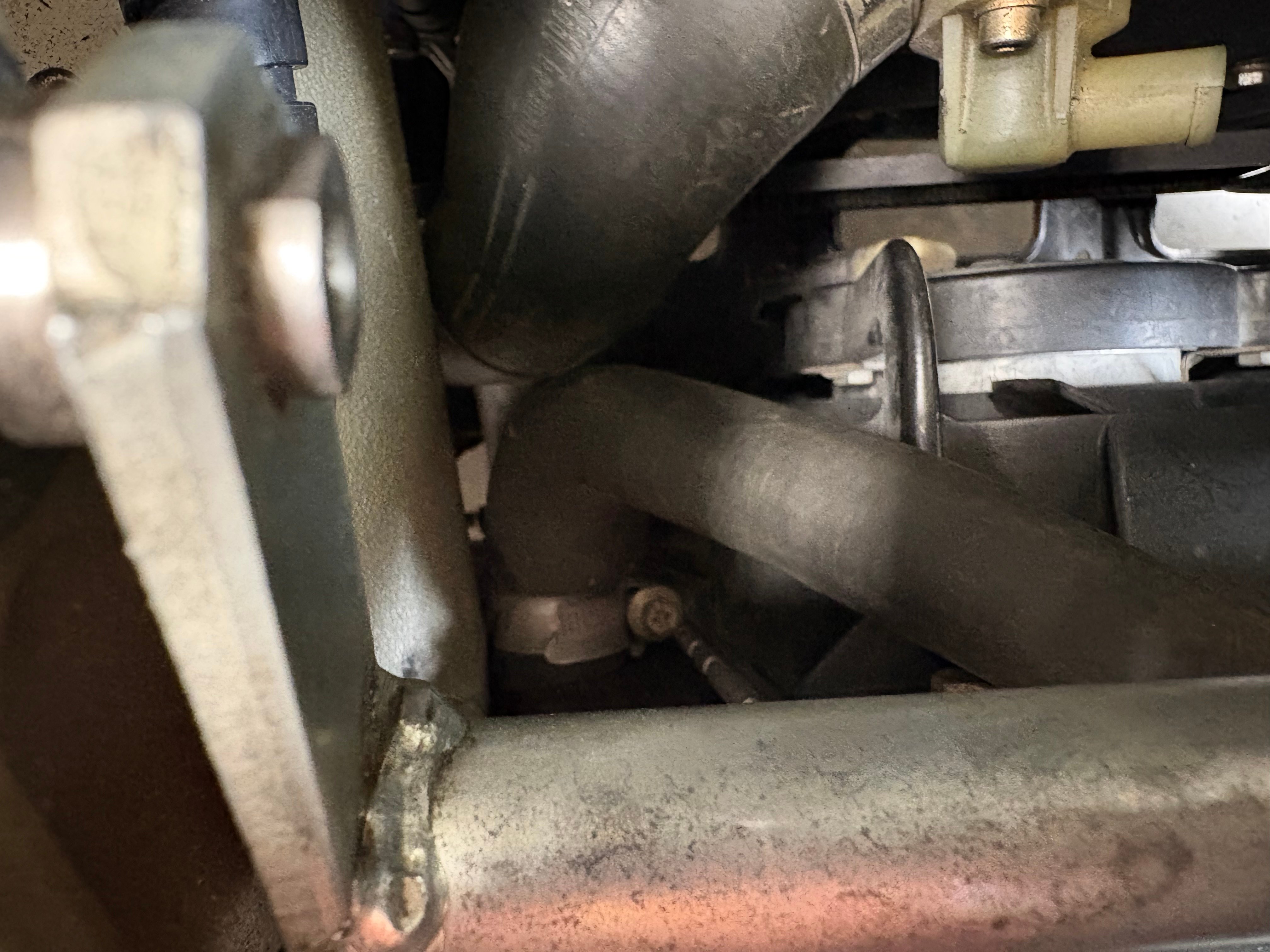

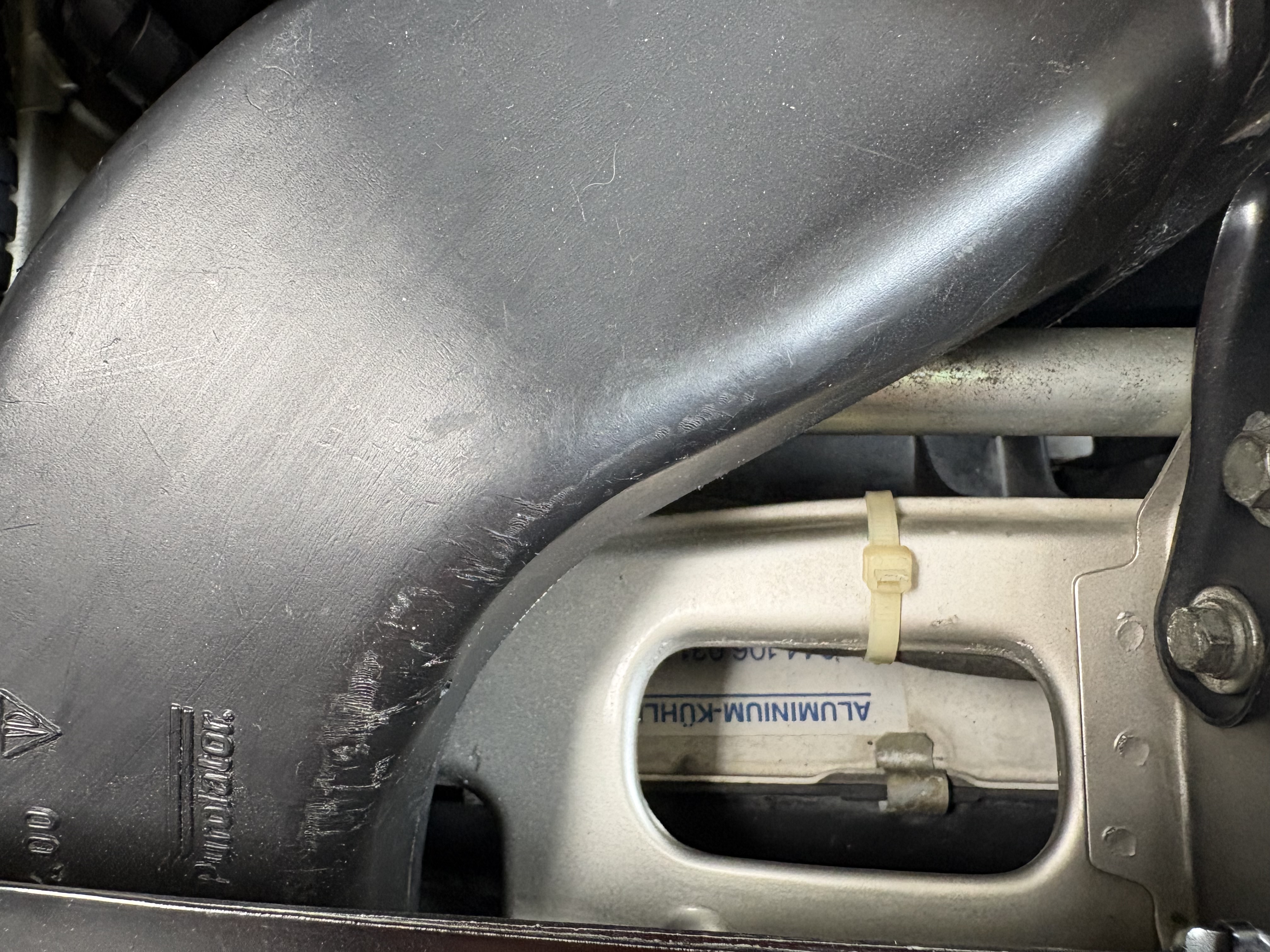

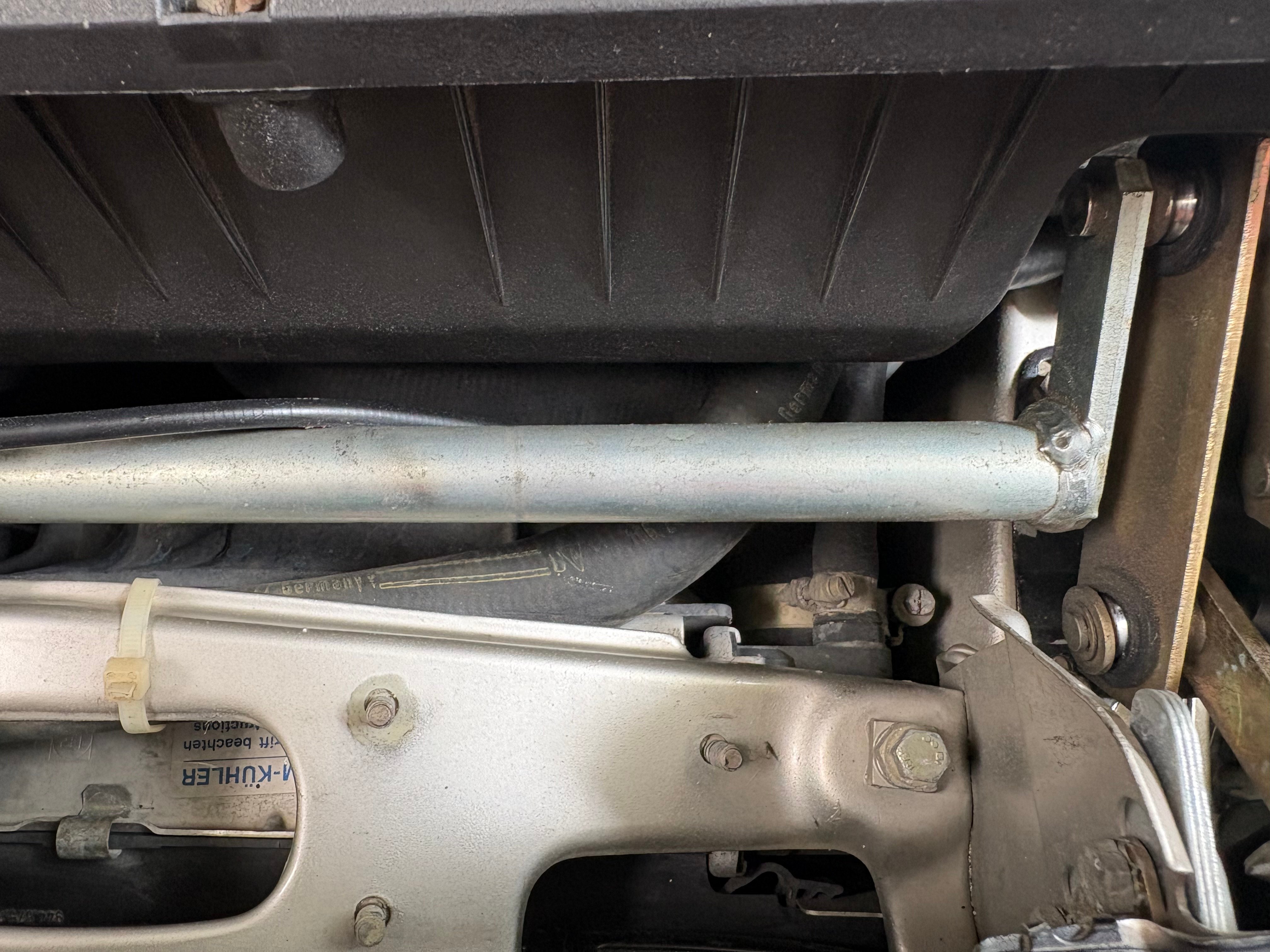

Here are some pics of how mine is routed, using a couple of zip ties to the frame above the radiator:
Hose has come out of reservoir

Hose zip tied above radiator
Pic 3.jpeg (2.77 MiB) Viewed 35 times
Hose connection to radiator
Pic 4.jpeg (2.13 MiB) Viewed 35 times
