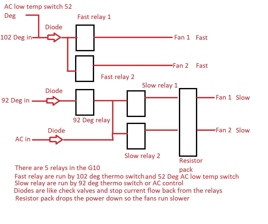

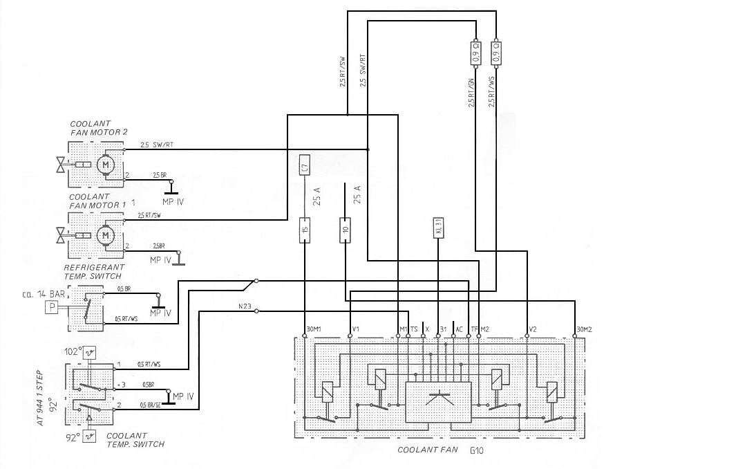

There is a whole bunch of info here if you like.
https://forums.pelicanparts.com/porsche ... ystem.html
Also inside of the fan relay.....
Sox
cooling fans circuit.jpg (123.07 KiB) Viewed 11 times
coolant fan relay G10 block.jpg (161.71 KiB) Viewed 11 times

soxnail wrote: Wed Jun 24, 2026 9:46 am There is a whole bunch of info here if you like.
Sox
Thank you. I read through the whole thread and sounds eerily similar. I am still chasing the issue but one thing is for sure, the last 4 wahler thermostats are not opening anywhere close to where they are rated. Not sure this going on but quality control seems to be severely lacking..
