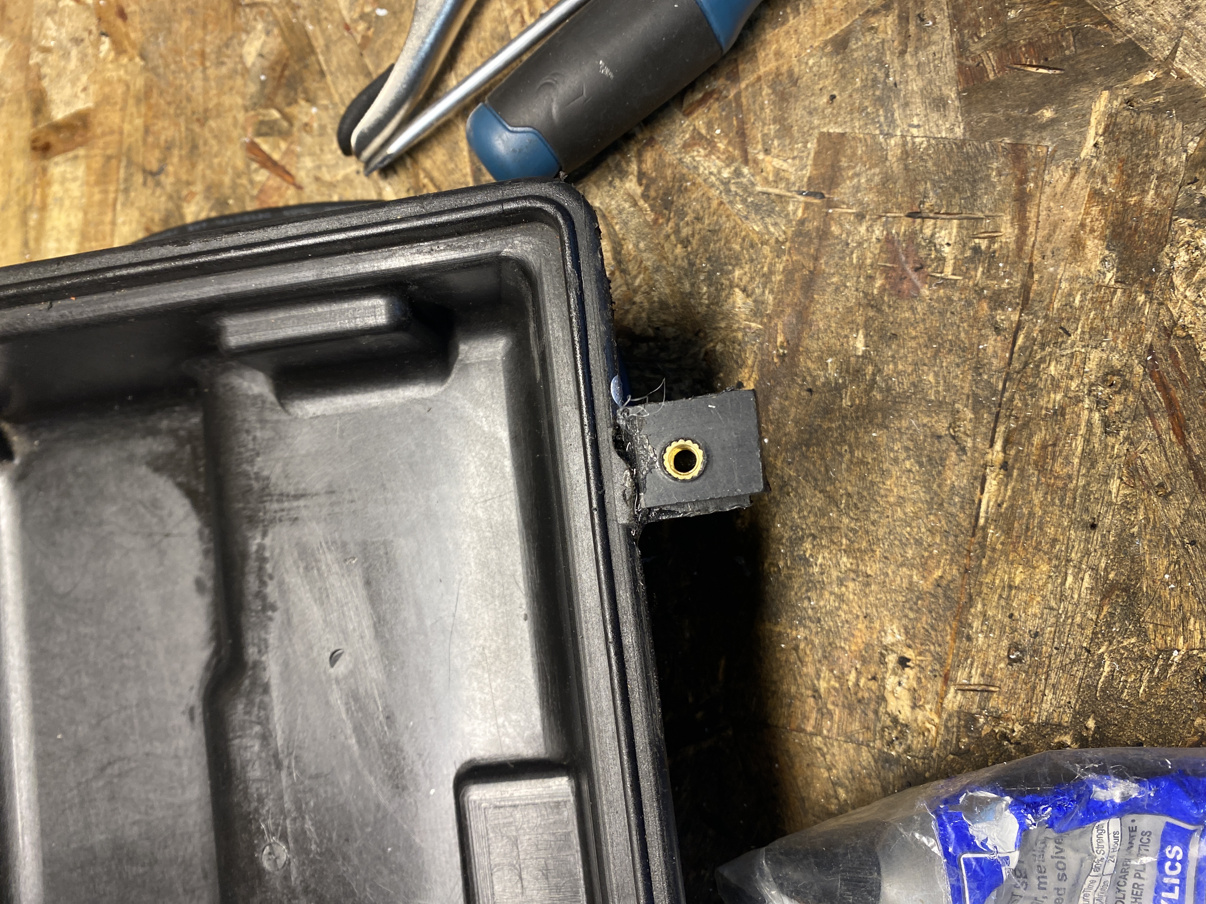

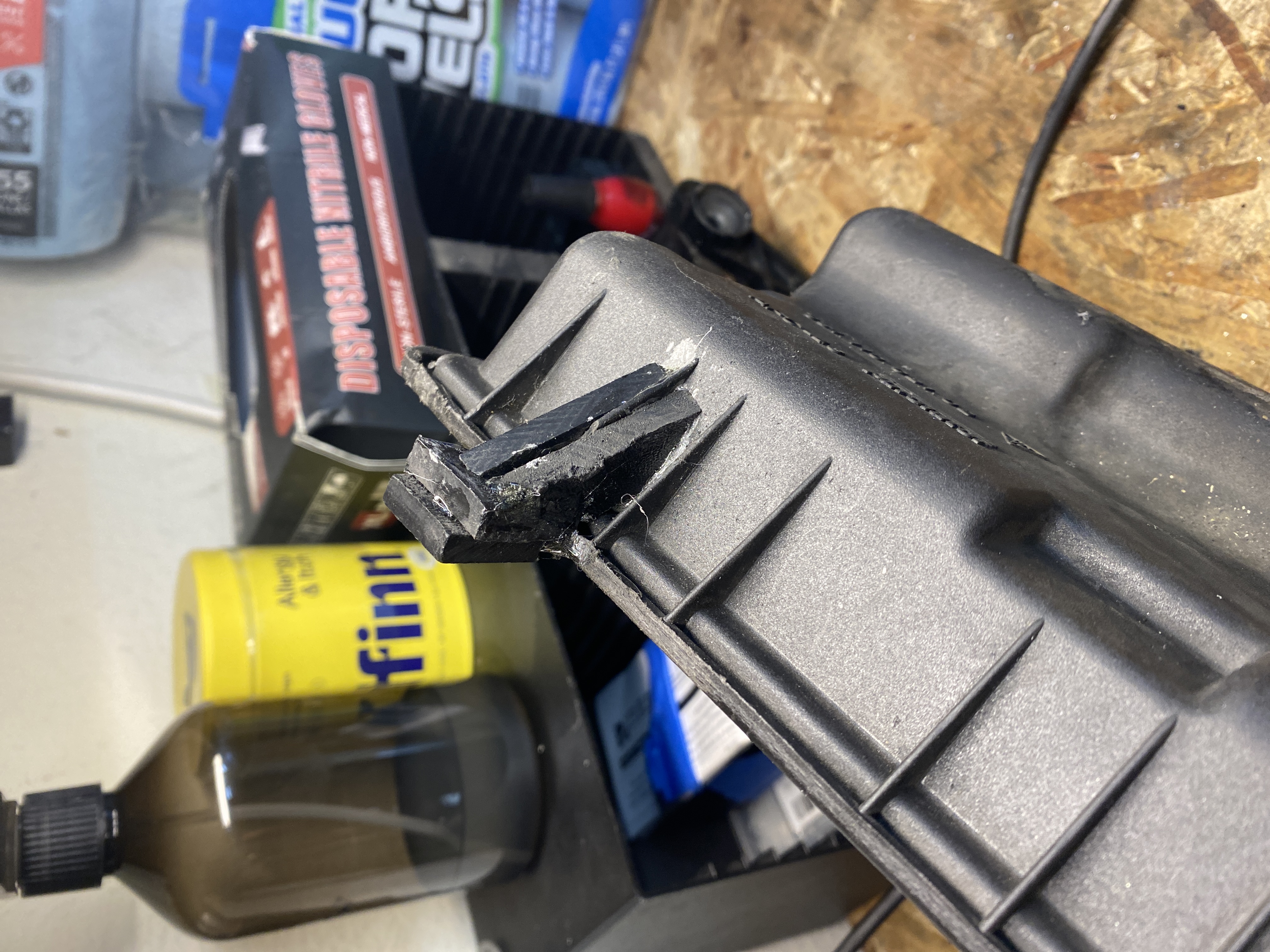

I couldn’t print the file on my FlashForge ADM5 so used some ABS scraps from a previous project, a dremel, sand paper, brass inserts and ABS cement.

Spencan wrote: Sat Jun 06, 2026 11:21 am I couldn’t print the file on my FlashForge ADM5 so used some ABS scraps from a previous project, a dremel, sand paper, brass inserts and ABS cement. image.jpgimage.jpgimage.jpg
Looks good and like it'll hold up just fine. Nice job!
