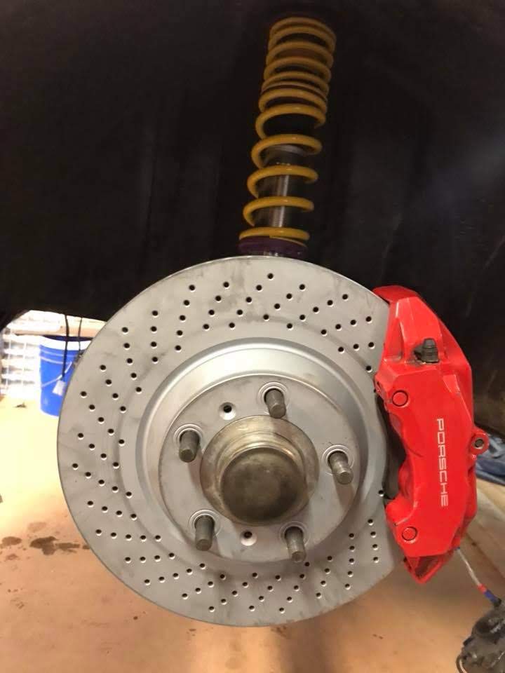

Hello, i went with 87+ spindles, 996TT calipers and 996 gt3 front discs with an adapter.
The 86 spindles are weak if you want to track with slicks etc.

ealoken wrote: Mon Apr 18, 2022 1:06 am Hello, i went with 87+ spindles, 996TT calipers and 996 gt3 front discs with an adapter.
Erik
Looking at your picture it appears the 996TT calipers don't have the depth to completely cover the GT3 rotors, so whatever adapters you used places them at the outer edge so you gain swept area vs 996TT rotors? If so, then you should have more "stopping power" as Tom put it compared to big red/black calipers and rotors.

Latitude48 wrote: Mon Apr 18, 2022 10:16 am
Erik
The 996TT is 330mm vs 350mm on the gt3 discs.
If they don't hold up, I'm switching to 997calipers, Giro disc and ebc rpx pads.
The oem 951 brakes did not survive track days, even with big cooling and full race pads.
