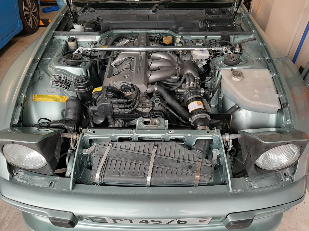

I have an S2 airbox in my '86 944. it is indeed noticeably tight. I will change to a large pod filter in time. I do wonder about airflow into there, whether I do get enough compared to an S2 or Turbo. I have a 924 turbo vent panel but I am put off on using it because of potential water ingress from rain.
- j1nx3d 968 944S2 airbox.JPG (221.16 KiB) Viewed 1137 times
