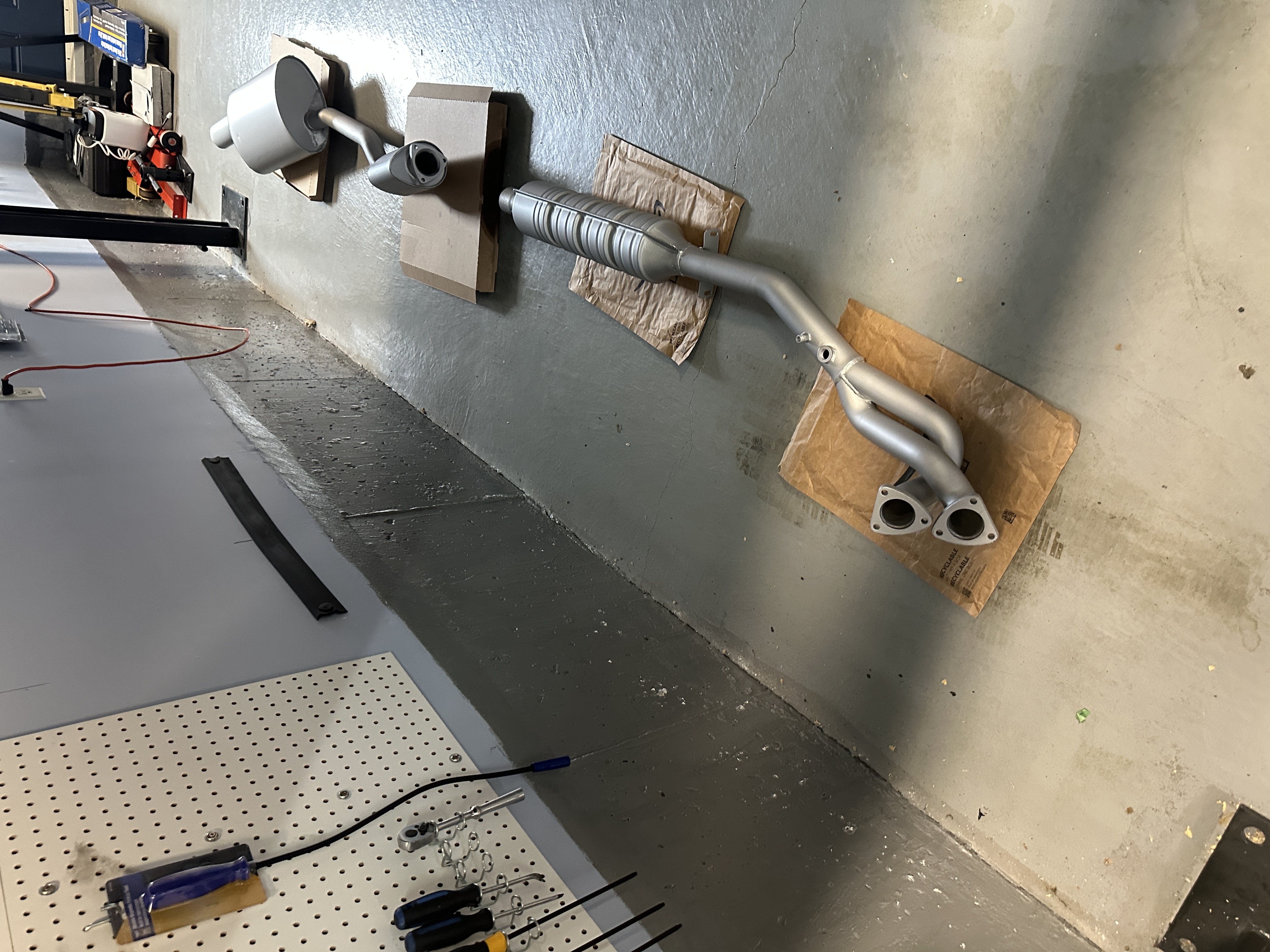

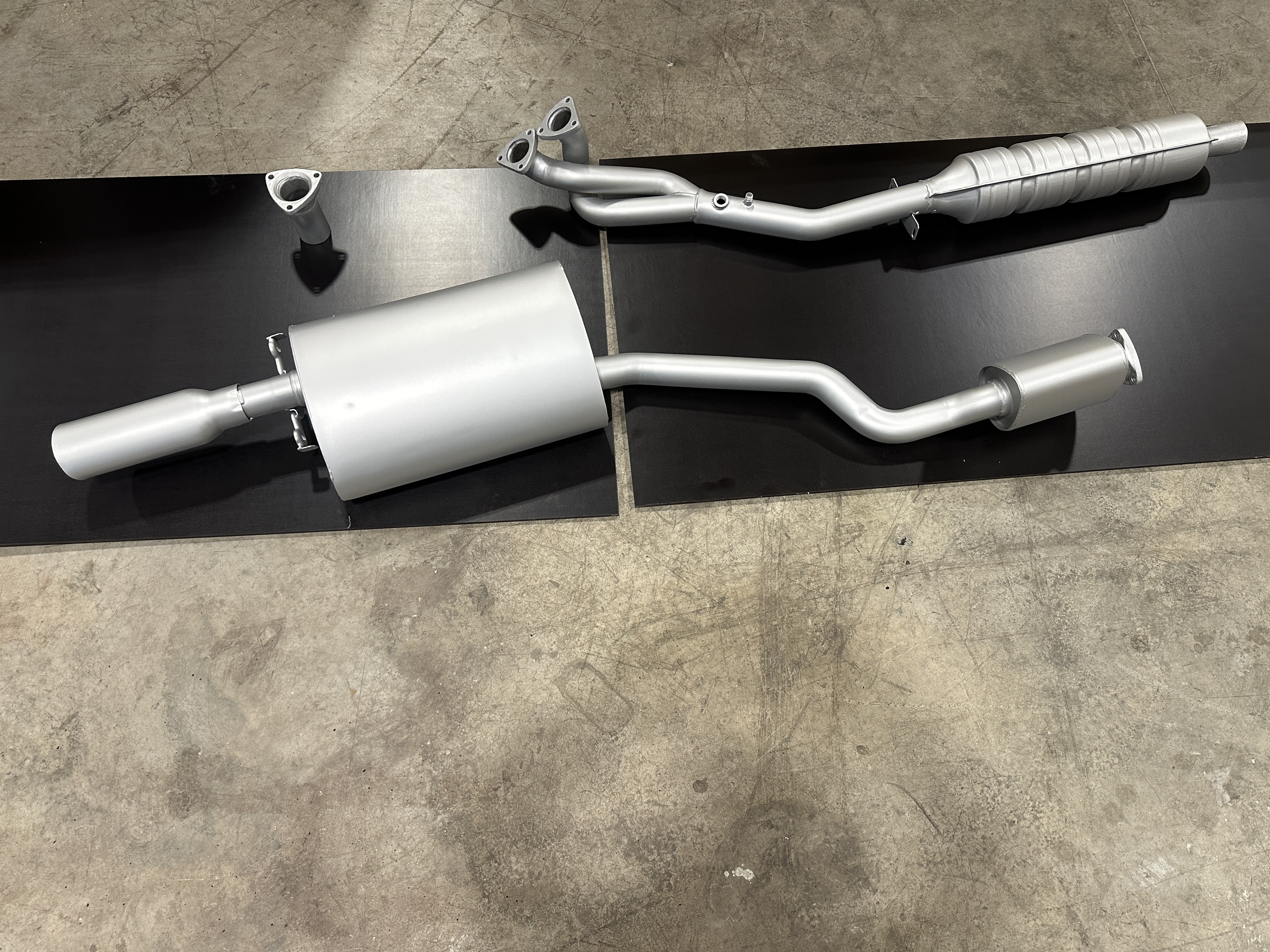

I wanted to apply Cerakote to the exhaust parts, and originally wanted to sub it out, but quotes were quite high, so I decided to do it myself, which meant hours of blasting with aluminum oxide to prep the substrate. I had to spread it over multiple evenings to get it to a point that I thought was good enough.
I purchased a half pint of C-series Cerakote and applied it with a 0.8 mm HVLP detail gun and the result looks good. Cerakote has worked really well on my 911 headers, so I am hopeful it performs well here too.

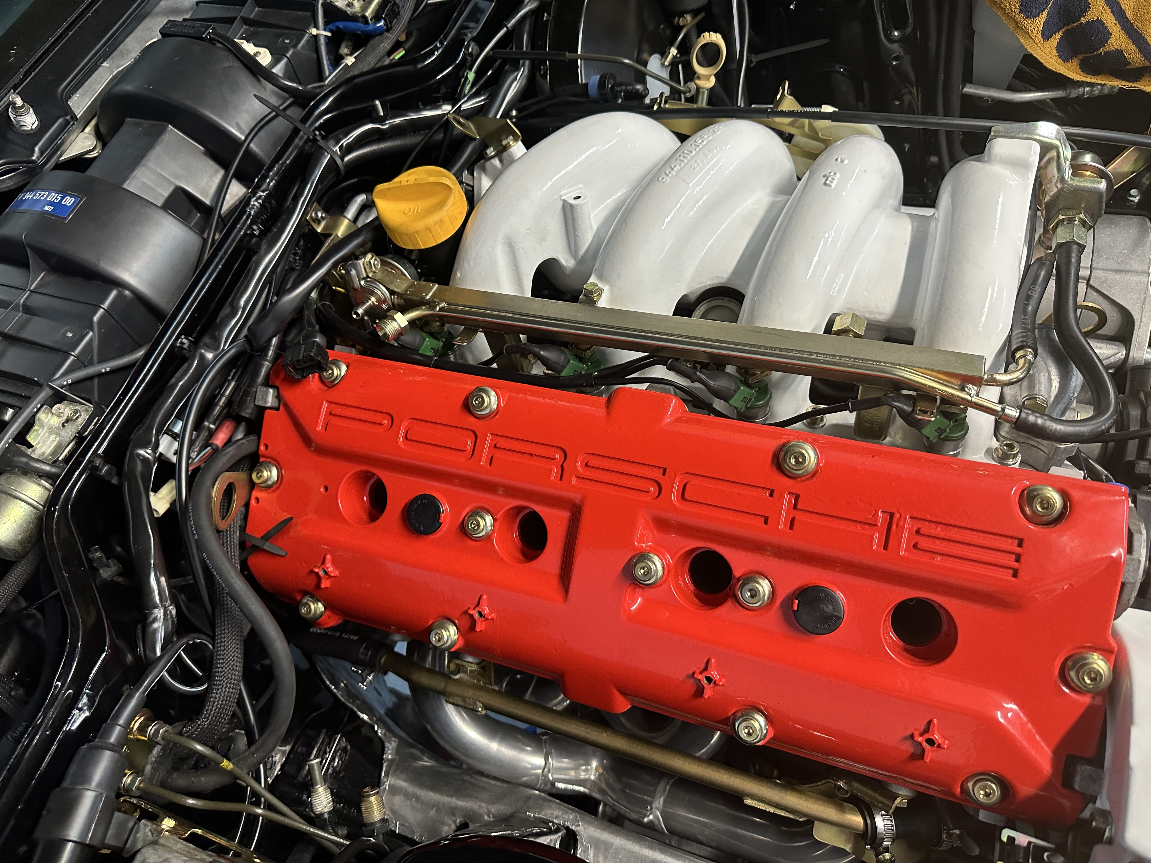

moved ahead a bit with tidying the wiring routes in the engine bay:

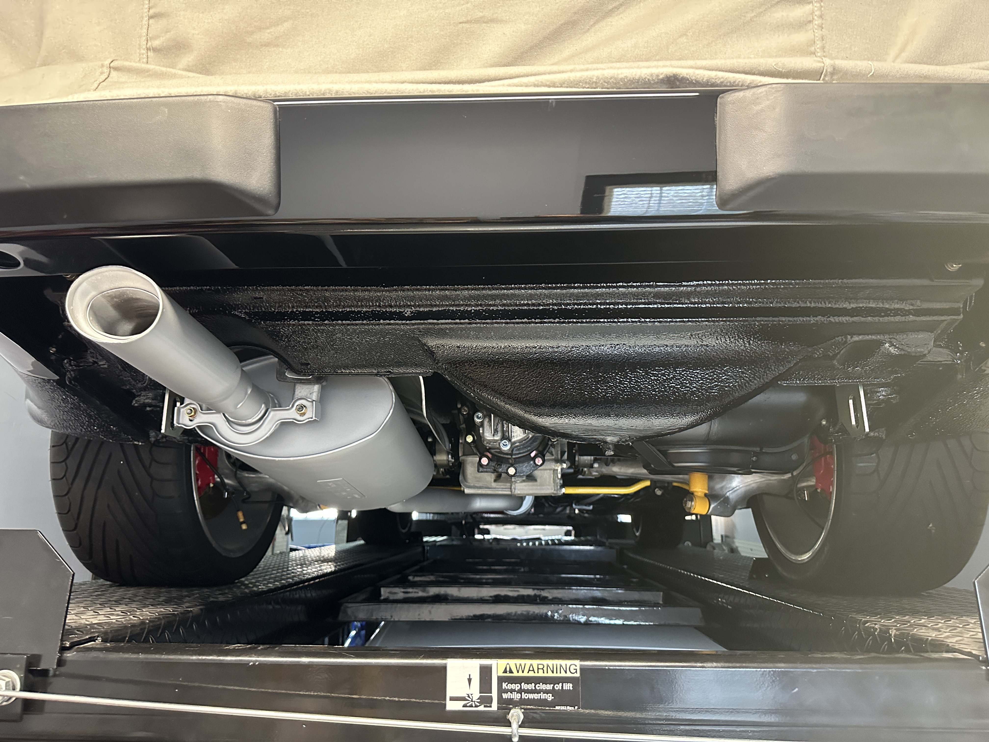

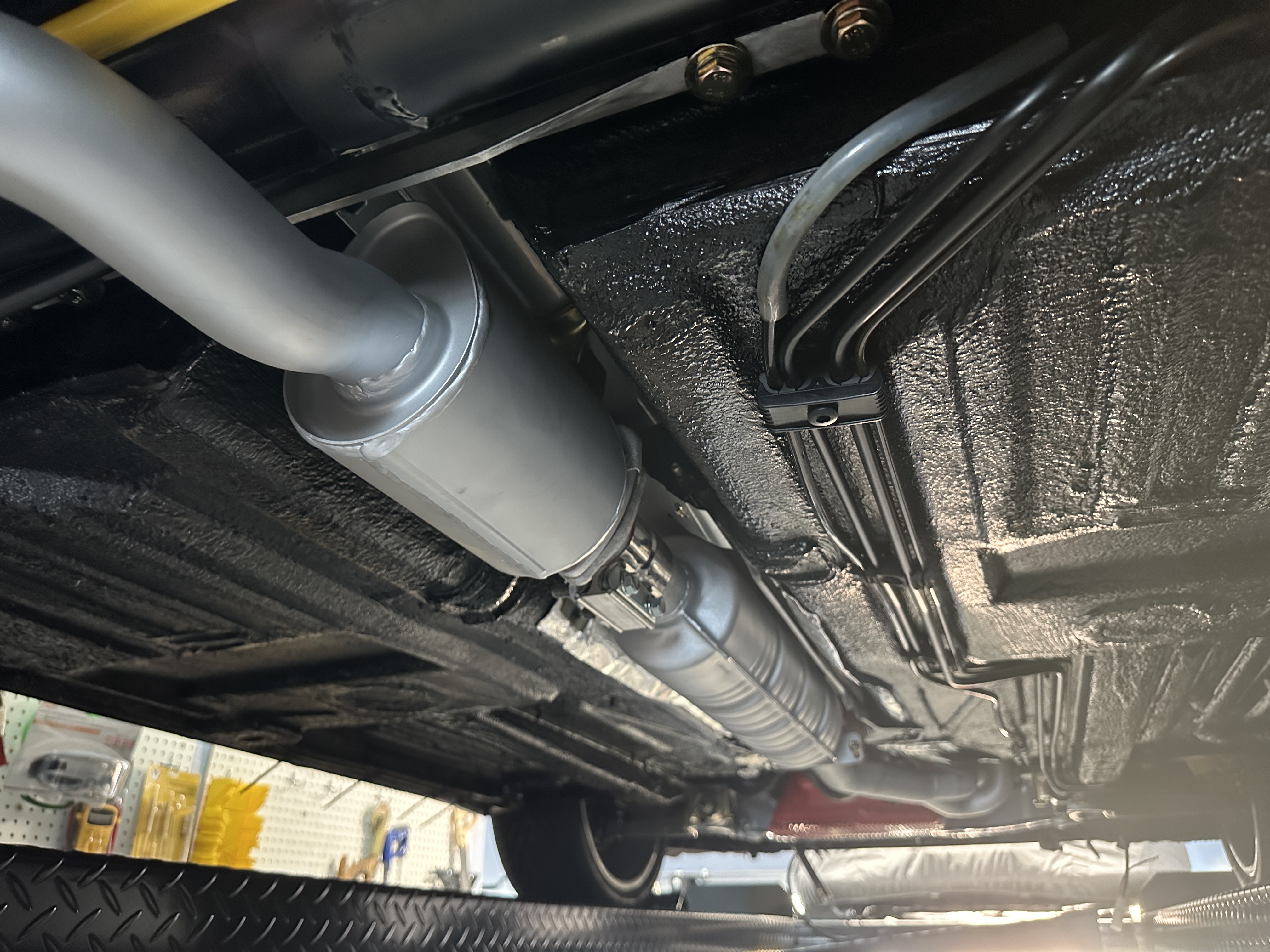

The exhaust is installed.
Happy with the fit. I used a stepped band clamp for the slip fit of the flange piece to the back of the mid-pipe. Seems to be a good seal (I also used a film of silicone exhaust sealant on the slip fit. We shall see if it is actually good enough, but I am cautiously optimistic.
Rear view of the exhaust shows off the Glacier Silver Cerakote. I think OEM is for the back half of the muffler to be painted black. Maybe I should have done that, but I am going to leave this as it is.
