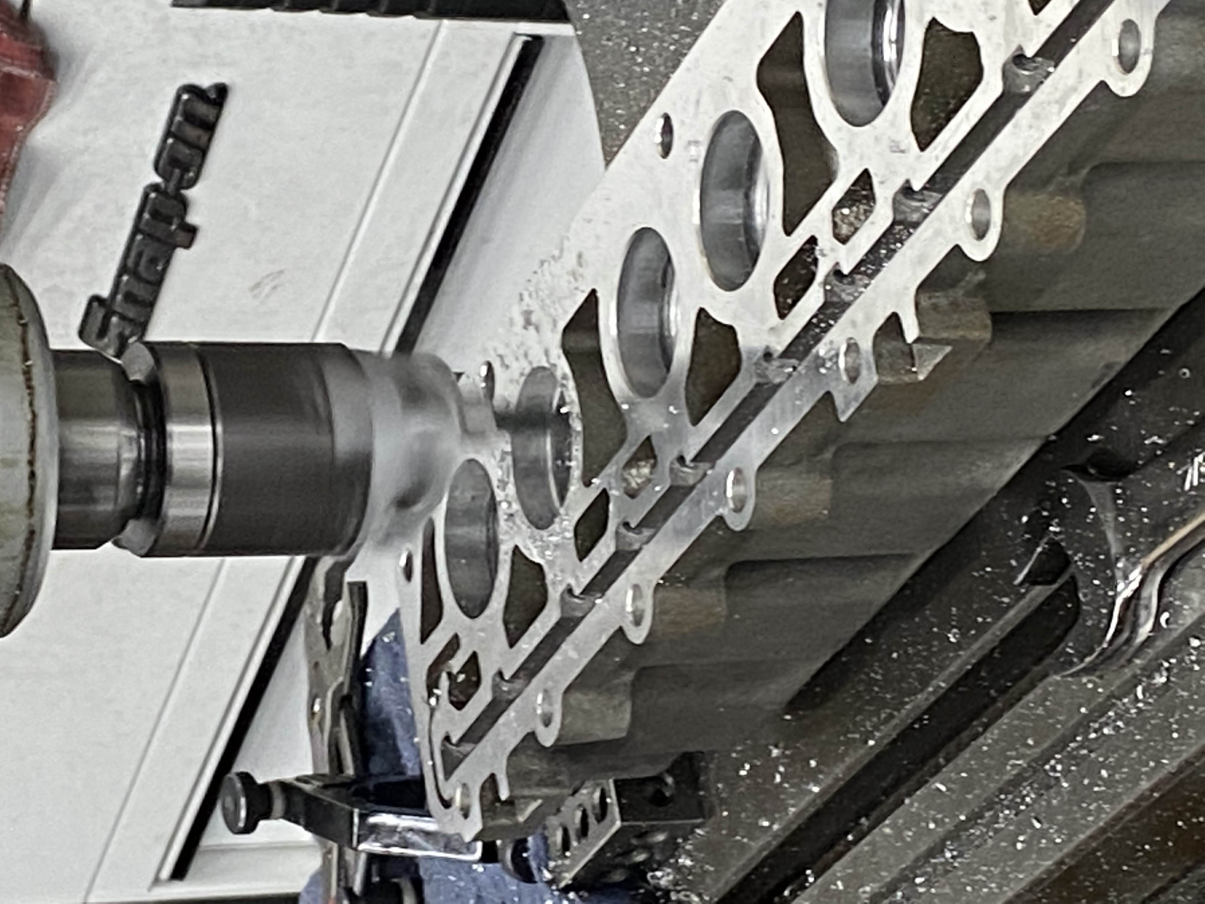

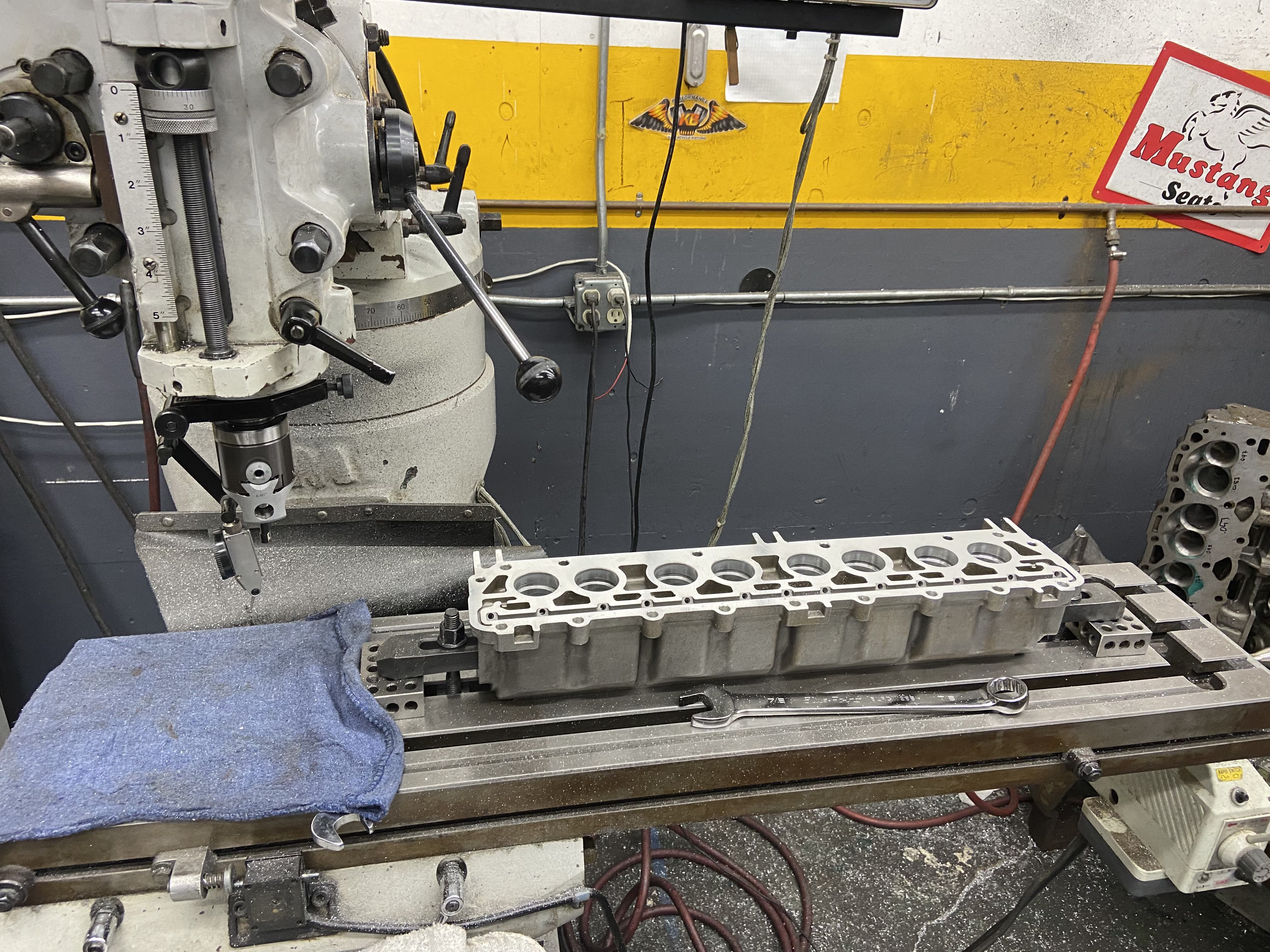

Ok, so I did a thing...
My machinist expanded my cam tower bores to fit a larger INA hydraulic lifter. I know the INA replacement lifters for the 944 are horrible but these are supposed to be much better. I think this is a pretty interesting procedure so I will do a full write-up once I get the car back together. I am told this is pretty common on domestic cars but is just starting to be done on 944. The machinist I used is super knowledgeable and has done this on several other 944s.
It's going to be really cool to have brand new lifters in my car :D

Cool, I just read that thread... that's exactly what is being done on my car! The machinist that did the work is partnered with Emanual from 944 store (Joshua at Valley Cylinders). The lifters are out of a 1991 Mercedes 300D INA part #4200001100 I don't think it's my place to release the specs for the machine work just in case it becomes a 944 store product. Those guys did all the R&D in this so I don't wanna release anything I'm not supposed to. I am super excited for this to hopefully go mainstream it would be really cool to finally have a solution. Also it is cool that Joshua skimmed the cam housing so now I have a square surface for the first time in 32 years :D and on a rebuilt flat head surface!!!!!!
