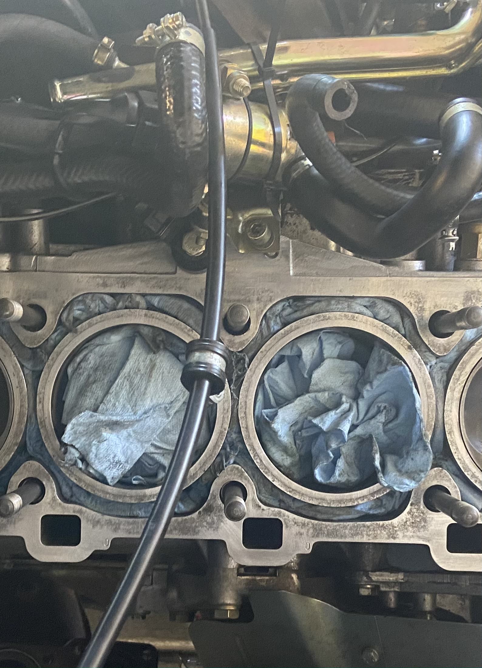

Thank you, guys! Sorry, it has taken me forever to respond to all of your thoughtful advice. Final exam preparations have taken up my 944 wrenching time :evil:
How does my prep look?

Looks great! As long as it's smooth to the fingernail, I'd run it!

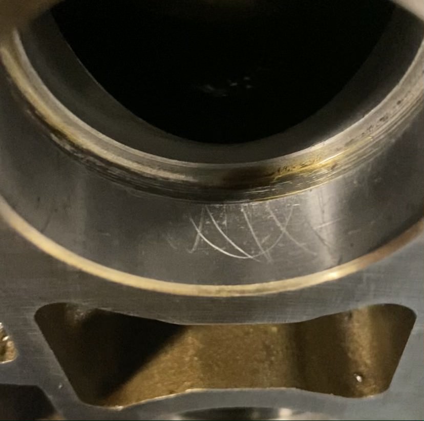

Yikes! should I be concerned about the scouring on one of the cam tower lifter cylinders? The rest look fine... touch it up with high-grit paper?
Close up on cam tower lifter cylinder scouring

How did that happen!!? Can you feel the scratch with your fingernail? How does the lifter that came out of there look?

Tom wrote: Tue Dec 14, 2021 7:50 pm How did that happen!!? Can you feel the scratch with your fingernail? How does the lifter that came out of there look?
I don't know :cry: I need to check on the lifter tomorrow, currently in a solo cup of oil.
Dang it! ran great before I pulled it apart.
A guy in SF is selling a Turbo cam tower for $50 might just have to pick that up and swap my cam and other hardware over.

Hmmm.... If it was already there and the lifter shows no wear/damage, and if you can't feel it with your fingernail, then I'd probably just run it and see what happens. On the other hand, if its deep enough to catch your fingernail, cam towers are cheap and there's not much to swap over other than seals you'd want to do anyway....
