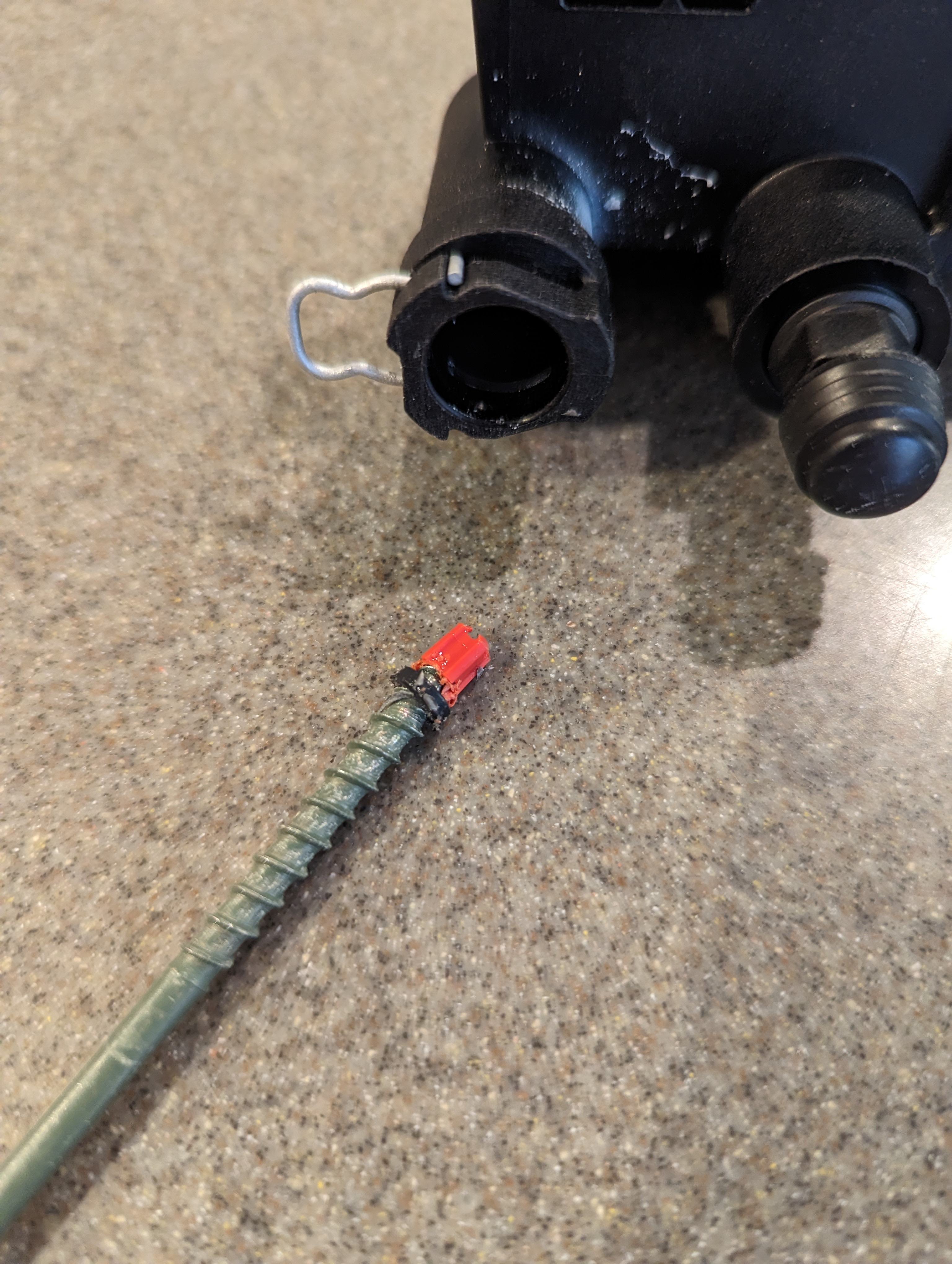

The clutch slave cylinder has a small red plastic restrictor inside. Supposedly it is there to prevent overly aggressive launches. If one wants to remove it, a properly-sized screw makes quick work of it. Just a thought.

I really appreciate this post, I have been looking on google and have not found this information yet. I will have the replacement slave cylinder this week and the old one will be perfect to experiment on with. Is it fair to say that you have not yet done this to your car? How did you learn this tip?Ix_ wrote: Sat Oct 14, 2023 12:53 pm Jeremy,

Interesting. I remember there was something like that in the clutch hydraulics of my old BMW E36. The clutch was much more responsive once I removed it. I had no idea Porsche was doing this also.Ix_ wrote: Sat Oct 14, 2023 12:53 pm The clutch slave cylinder has a small red plastic restrictor inside. Supposedly it is there to prevent overly aggressive launches. If one wants to remove it, a properly-sized screw makes quick work of it. Just a thought.

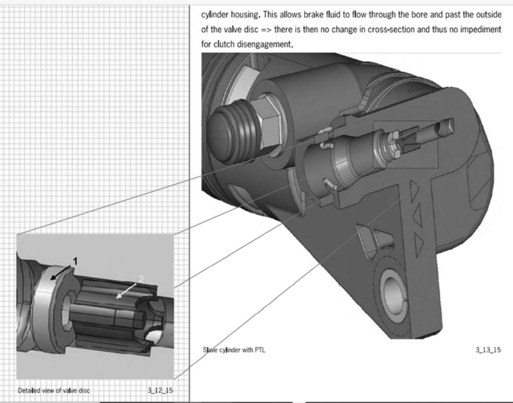

I have done it. There was a discussion on another forum and someone posted that Porsche service manual diagram. I ordered a replacement s/c and studied how best to remove the restrictor.J-Dub wrote: Sun Oct 15, 2023 7:49 pmI really appreciate this post, I have been looking on google and have not found this information yet. I will have the replacement slave cylinder this week and the old one will be perfect to experiment on with. Is it fair to say that you have not yet done this to your car? How did you learn this tip?Ix_ wrote: Sat Oct 14, 2023 12:53 pm Jeremy,
