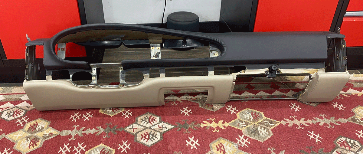

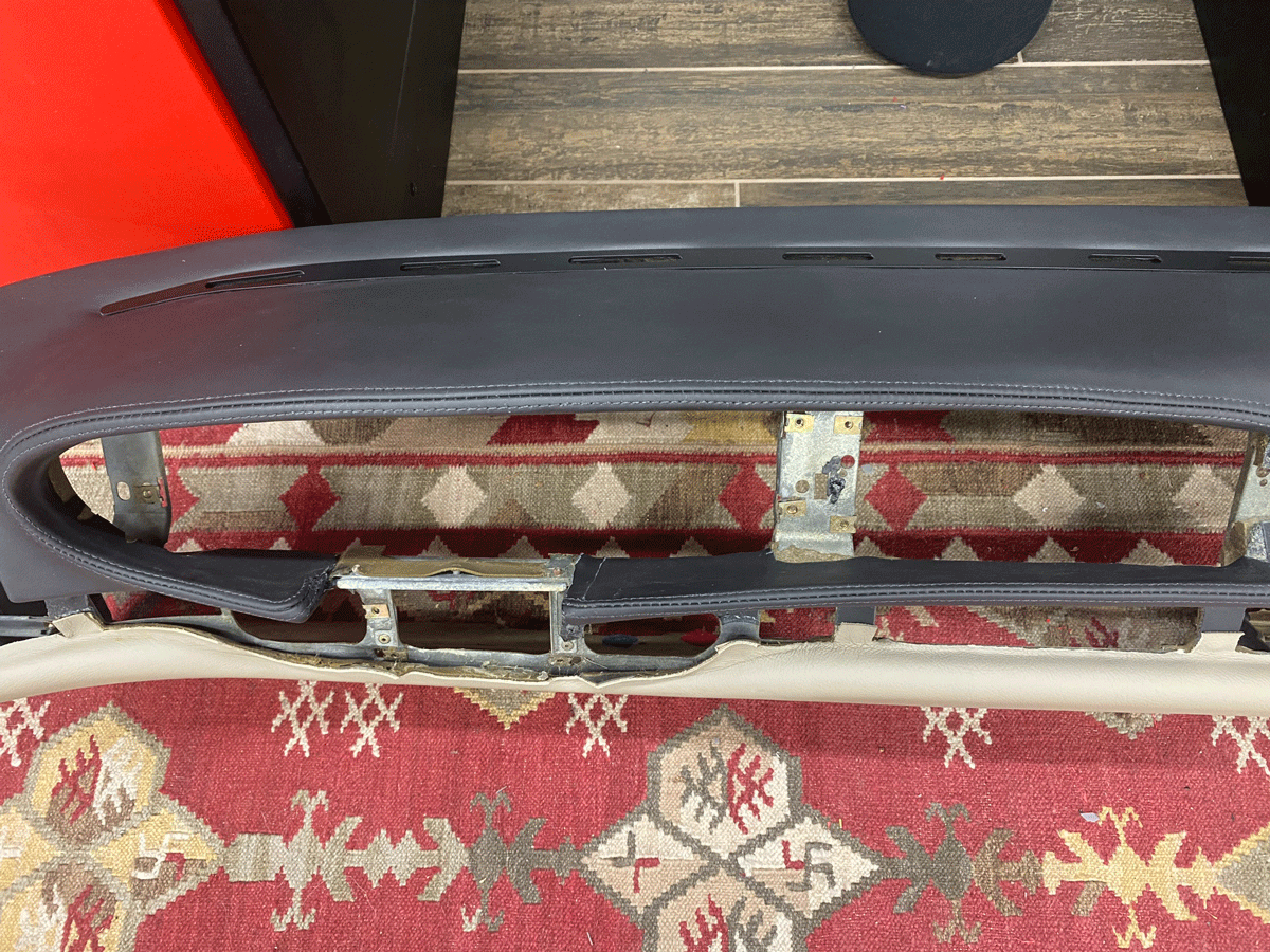

Well I pulled it out of storage and it looks pretty good. Other than the screws actually holding the dash to the frame, I honestly think I've removed all the little bits needed to remove the dash, at one point or another. I've just never did all that at once and, of course, never yanked the actual dash out. Seeing the leather one is helping to motivate me though. As lazy as I am, this doesn't 'feel' like a good job to farm out, insofar as it seems way too easy to cut corners, mix up screws, etc., etc. I also have a matching leather center console in the lower tan color, although I'm thinking it might be better in black in my interior.
This is how it looks right now....
