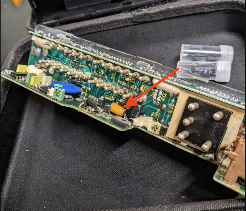

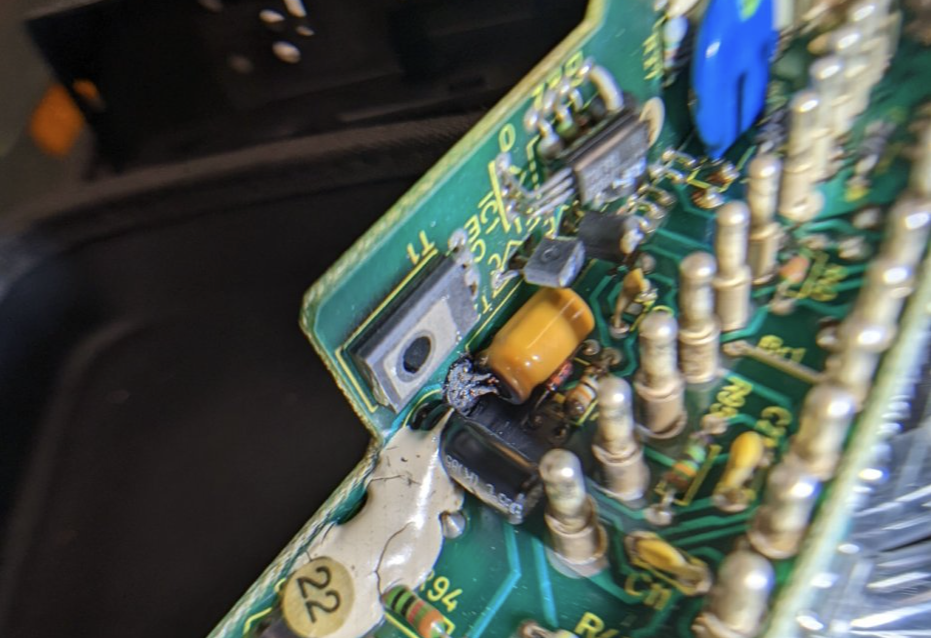

With all that said, I think I've discovered a problem (very possibly the problem). When pulling out the CC module, I noticed the familiar smell of burned electronics.. I pulled the CC unit apart and discovered that this little yellow capacitor appears to be having a pretty bad day:

Do you think this is fixable or is it dead?

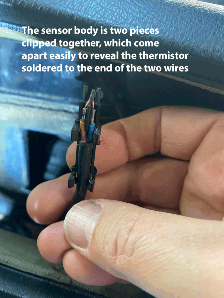

What was the temperature outside when you tested those temp sensors? 17k equates to low 50's F. Could be a wiring/connection issue, but if that one is bad, you can replace just the little thermistor that is soldered to the end of the sensor harness wires. NTC thermistors are spec'd by their resistance at 25C and a "beta" value -- which approximates their resistance curve as the temp changes. The three temp sensors in the 944 HVAC system are rated at 10k @ 25c with a beta of about 3900k over the relevant temp range, as best I can approximate. Digikey 570-1200-ND (mfg. ACC004) is a good replacement:

If you get the thermistor I mentioned above, it should match the others (so I'd leave them alone). The outside temp sensor is under the blower motor cover (black plastic at the base of the windshield) and is attached to the side of the blower motor intake screen. It has a different housing than the one I posted, but the thermistor inside has the same specs. It's built into a little connector that plugs into a JPT connector, so probably worth pulling the sensor and cleaning the connectors with sandpaper, etc. and testing at the sensor itself, just in case the extra resistance is coming from the connector/wiring. It never moves or gets bounced around, but the connector style is the same as the injectors and speed/ref sensors, so prone to failure under the connector on the harness side. I'd probably ohm it out from under the hood to A9 too, in case there's extra resistance in the harness (it goes through another connector within the harness). Last I checked that sensor is NLA, but if you have a hard time getting the thermistor out, let me know and I may be able to help.

Edit in case I buried the lead with a TL;DR post.... The CC unit is probably not working right and why you are stuck on heat. Most people would toss it and find a new one. My comments below are for people interested in trying to diagnose and repair a bad climate control unit....
Now, re the blown capacitor. I believe that is C1 on the circuit board, a 25V 47uF electrolytic capacitor. It would be easy enough to swap out that capacitor, but something most likely caused it to burn up -- meaning a new one would likely suffer the same fate if you don't sort out the cause. Check your fuses too to see if whatever blew that capacitor also took out a fuse.

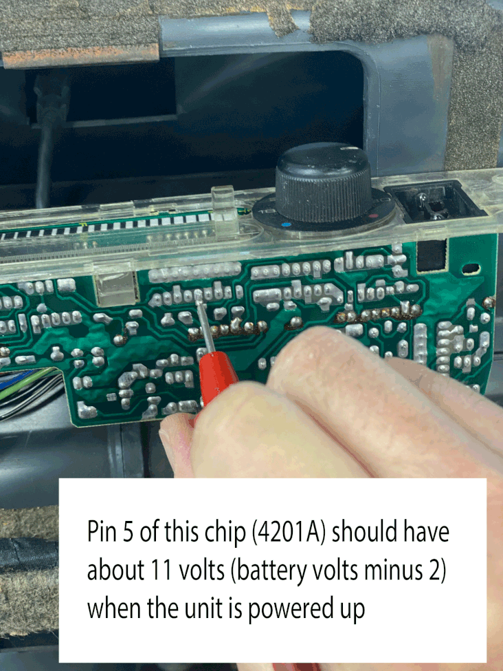

The CC unit has two unique voltage rails -- one is ~6.5 volts and the other is closer to 11 (battery voltage minus 2). Both are created with zener diodes and transistors, rather than a dedicated chip. The 6.5v rail helps create references voltage for the chip (4201A) that control the heater motor. The 11 volt rail is the supply voltage for all the 4201A chips that control the servo motors. The capacitor that blew on your unit hangs off the 11 volt rail (to ground), so there's a good chance none of your motors work via the CC unit -- have you checked?
I would check to see if that voltage rail is dead by probing the pcb pad shown below. If you still have voltage there, then it's possible something downstream of the voltage regulator circuit blew the capacitor, such as a blow 4201A chip. If there is no voltage, then the rail is probably dead, and more likely a blown zener diode or transistor (which should be available). If it's a blown 4201A chip, I have them. When mine blew, I discovered they were obsolete and had to buy the remaining stock (like 150+ of them for like $20) from some vintage chip dealer in the UK -- which at the time were the only ones anywhere I could find anywhere. Not sure how electronicsy you are and if this is any help or not? Like I said, I'd be happy to take a shot at fixing it if helpful. You can also get used ones on eBay, but you never know what you're going to get....

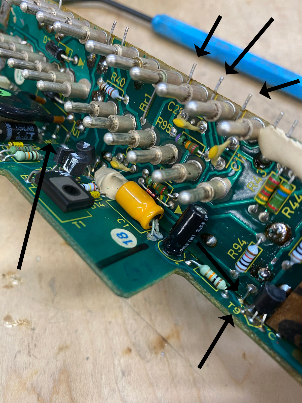

Separating the boards is a total pain. They are held together with a series of bare electrical leads/pins that carry signals and serve to connect the board together physically. The leads are spindly and have a tendency to corrode and fail. There are a couple dozen leads on each edge, so quite tedious to unsolder, but worth the effort to replace. I've disassembled maybe 6 or 7 of these, and literally everyone had connector leads that were either already reduced to dust/crud, or were 99% eaten away. On two different units I worked on, replacing those pins alone fixed the whole thing. I had some wire "bus bar" handy so used that -- I think it was 24 gauge, but don't quote me on that. Use the biggest solid wire you can get in the holes. Here are the little pins that hold the boards together....

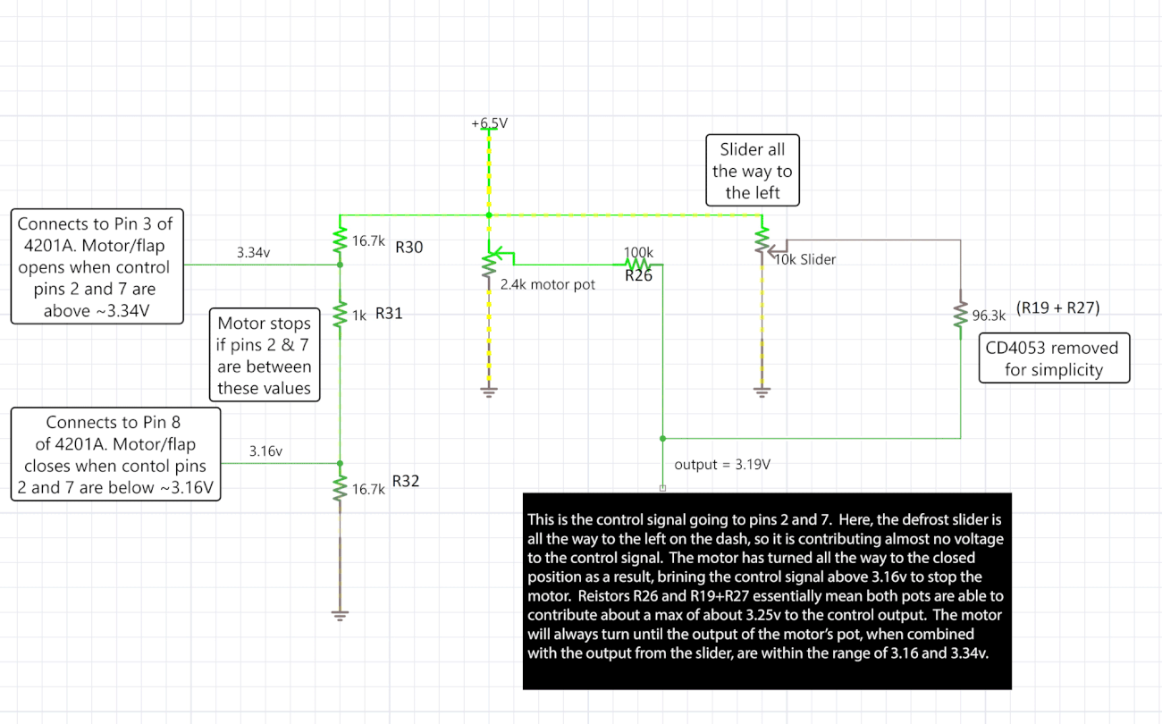

I posted some of this on RL before the great schism of 2021, but to keep the discussion alive in case you dig in yourself, here is the theory of operation -- as determined by an accountant turned lawyer :)
This is what I’ve come up with so far in terms of how the motor/flap controls work. I’m no engineer, so any/all comments and corrections from the better-informed are encouraged. The key seems to be the chip they used to control the motors/solenoids, an obsolete TLE4201A chip by Siemens (aka 4201A1, which works fine as well). It’s hard to find the chip, but I was able to find a batch from a place that specializes in obsolete chips. (See datasheet attached.) There are actually four of these chips in the unit, one for each of the three motors, and one for the two solenoids. The description below is based mostly on the defrost and footwell flaps to make the concept easier to follow.
The 4201A puts out close to its supply voltage on Pins 1 and 9 and, depending on its inputs, is able to reverse polarity of the output voltage between those two pins. That’s how it opens and closes the flaps. It can power its output in either polarity, or put out no power at all, depending on its inputs. The circuit uses a voltage divider to set up a narrow range of voltage on pins 3 and 8, roughly 3.34v on pin 3, and 3.16v on pin 8 (depending on the exact level of the ~6.5 voltage rail in the unit). The output gives power in one polarity above 3.34v, power in the opposite polarity below 3.16v, and no power in between those voltages.
The control input for the chip is on pins 2 and 7, which comes from the dash slider pots for the defrost and footwell flap, and from the temp sensor circuit for the heater flap; along with the feedback potentiometer inside each motor. (This input can be over-ridden by defrost buttons and the like, but I’m sticking to how the basic system works for now). If the control voltage on 2 and 7 is above 3.34v, the 4201A sends power out in the polarity needed to open the flap. If the control voltage is below 3.16v, the chip sends power out in the polarity needed to close the flap. In between 3.34 and 3.16v, the chip puts out no power. The sliders in the dash and the motor pots work like a see-saw, always keeping the motor moving until the two pots create a combined/blended voltage between 3.34 and 3.16. If you move the defrost slider all the way to the left, for example, it contributes very little voltage to the control signal, so the control voltage will be below 3.16v and the motor will turn unless/until the motor shuts the flap. When the motor is all the way in the closed position, its pot is contributing its max voltage to the control signal, getting it back above 3.16 where the 4201A turns off the power to the motor. I modeled the signals in iCircuits and think it’s very clever. Move the slider 40% to the right, and the motor needs to turn about 40% before the control voltage gets above 3.16v to shut off the motor. Same results at any point on the slider. This may be engineering 101 to those in the know, but it was new to me and seems clever. In any event, I thought it was cool and might help somebody down the road….

RE: Voltage on the 11V rail - Nope. Well, not entirely nope - I'm getting ~0.28V, but I think that qualifies as 'nope' where 11V is expected.
