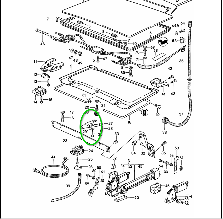

Meine44 wrote: Thu Jul 09, 2026 8:54 am Also, I would appreciate any help identifying two small pieces that I need to replace:
-The clip that holds the rear interior trim piece to the body of the car. Two are broken and one is missing. This clip holds the interior trim / leather side panel to the inside of the trunk.
-There is a hard-line clamp near the oil pressure sender that has disintegrated - the rubber is thrashed.
You can get those cushion clamps at a local hardware store, or amazon, though the ones Porsche sells are higher quality by a country mile (thicker rubber, thicker metal)... That panel clips are available, but you may need to re-secure them in the panels (JB Weld, etc.)... I 'think' your picture shows this style...

Tom, I think you are right! PET shows 27 of P/N 823-867-299 are used in the car. Interestingly they are only shown for the interior door panel but there is a good chance that is the part I am looking for.
Thank you!

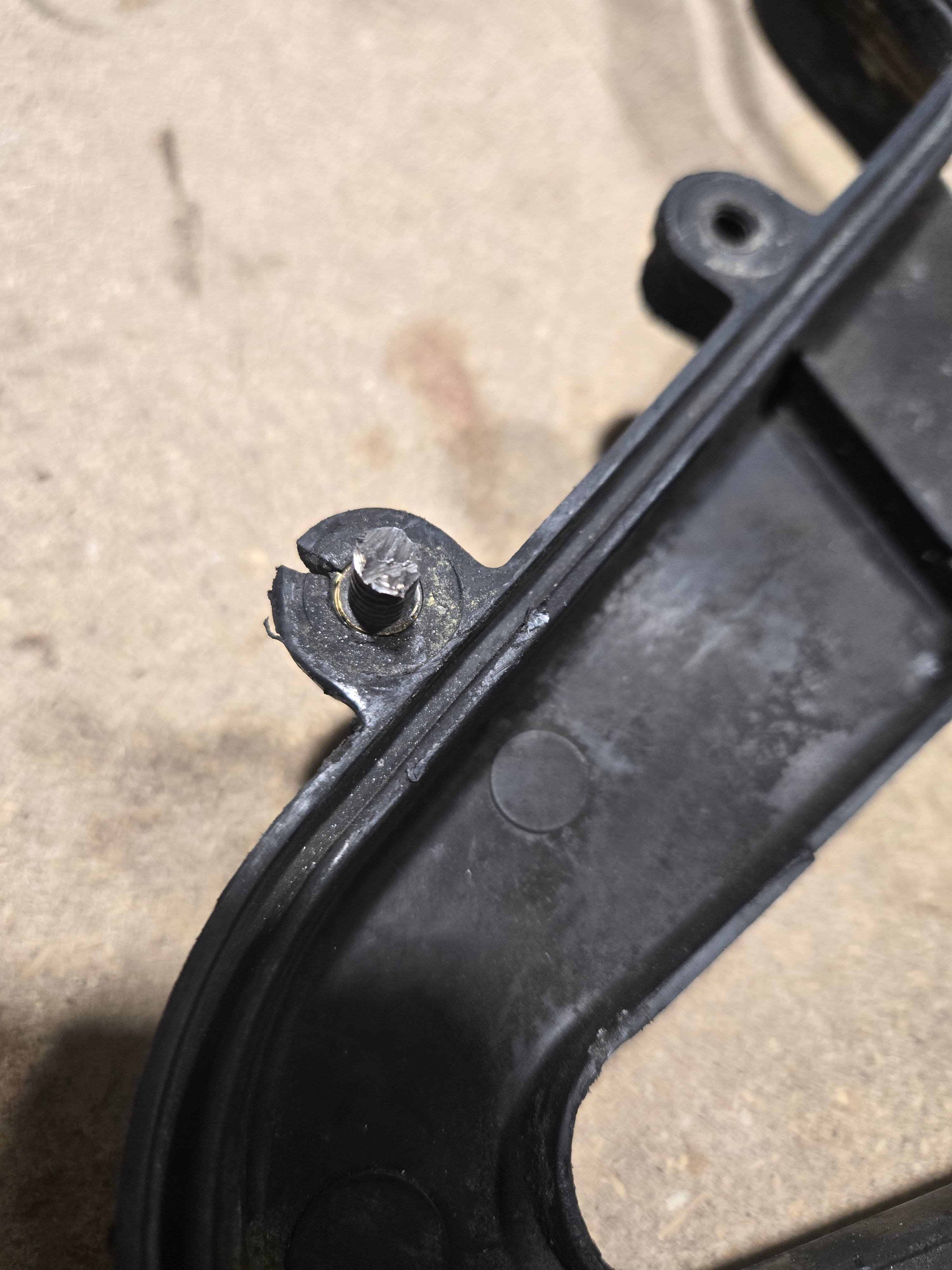

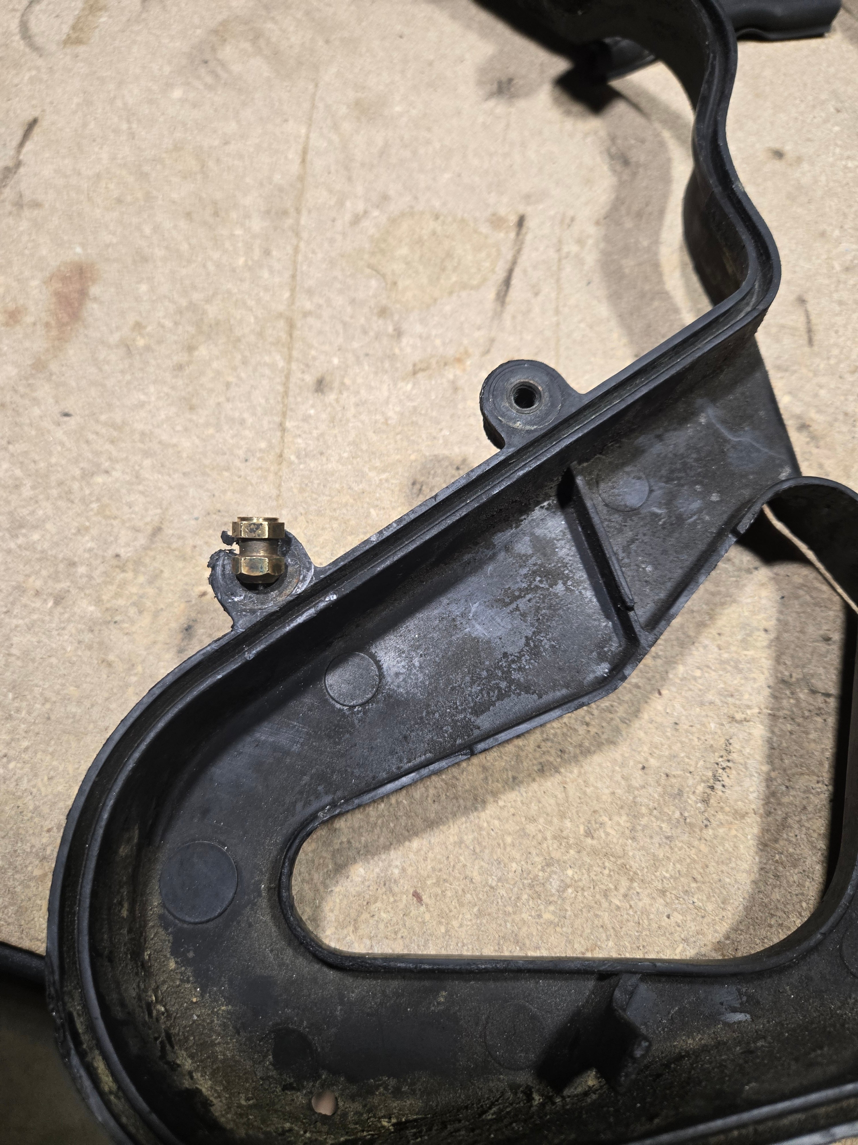

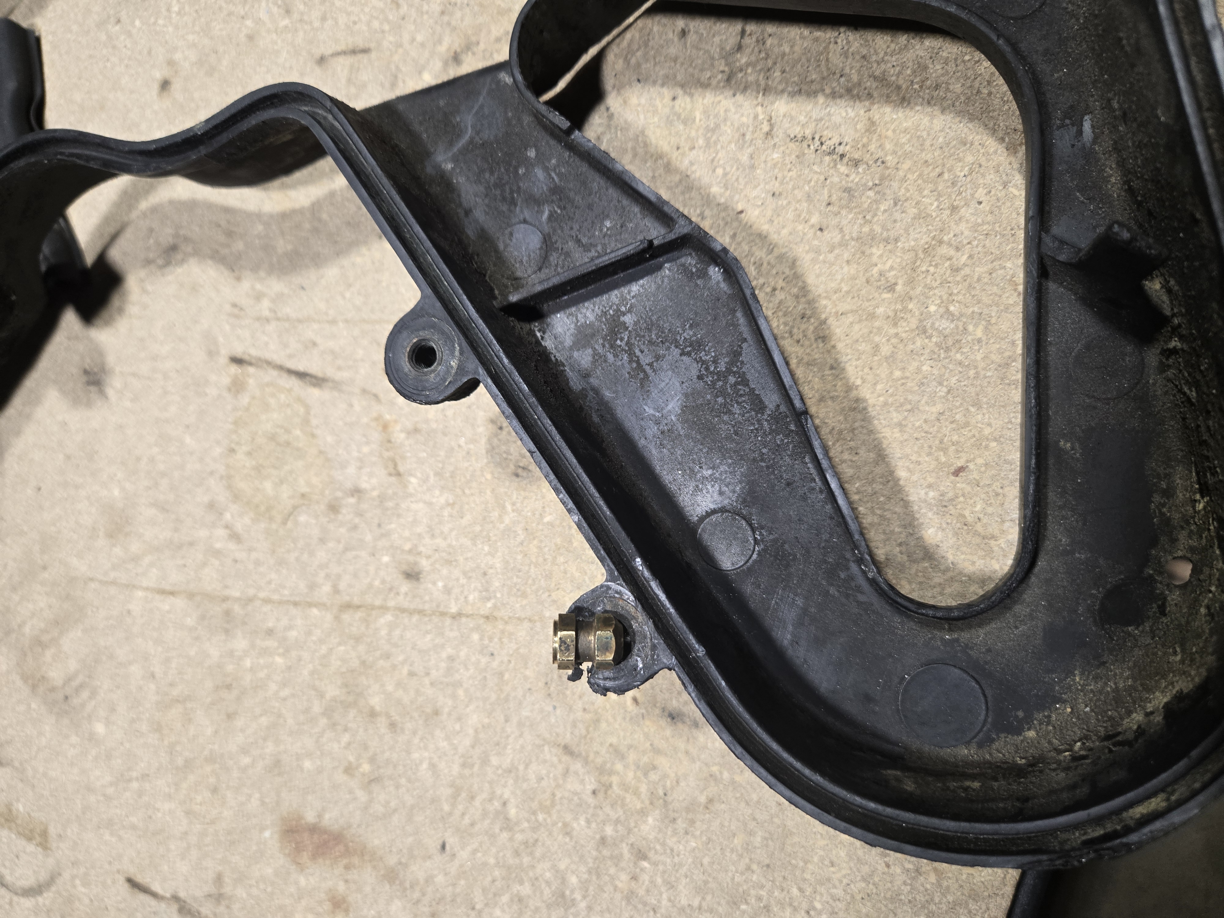

~One (1) of the bolts that secures the front timing belt cover into the rear had a failed threaded insert. I had to cut the bolt to remove the covers; the threaded insert in the rear cover was loose and just spinning.
Going to repair with a heat-set thread insert per Tom in this thread:
viewtopic.php?f=4&p=42096#p42096
Thanks Tom!

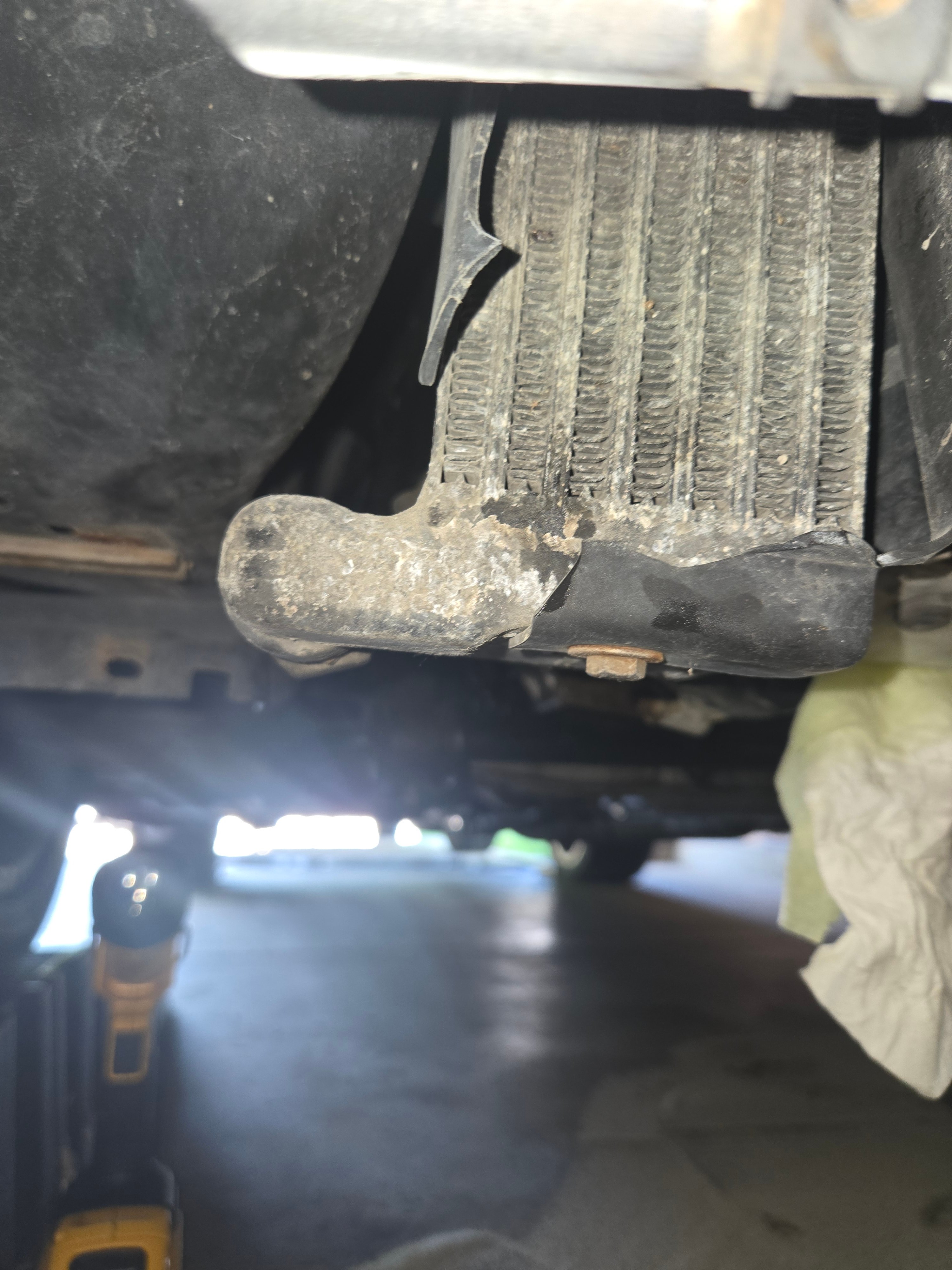

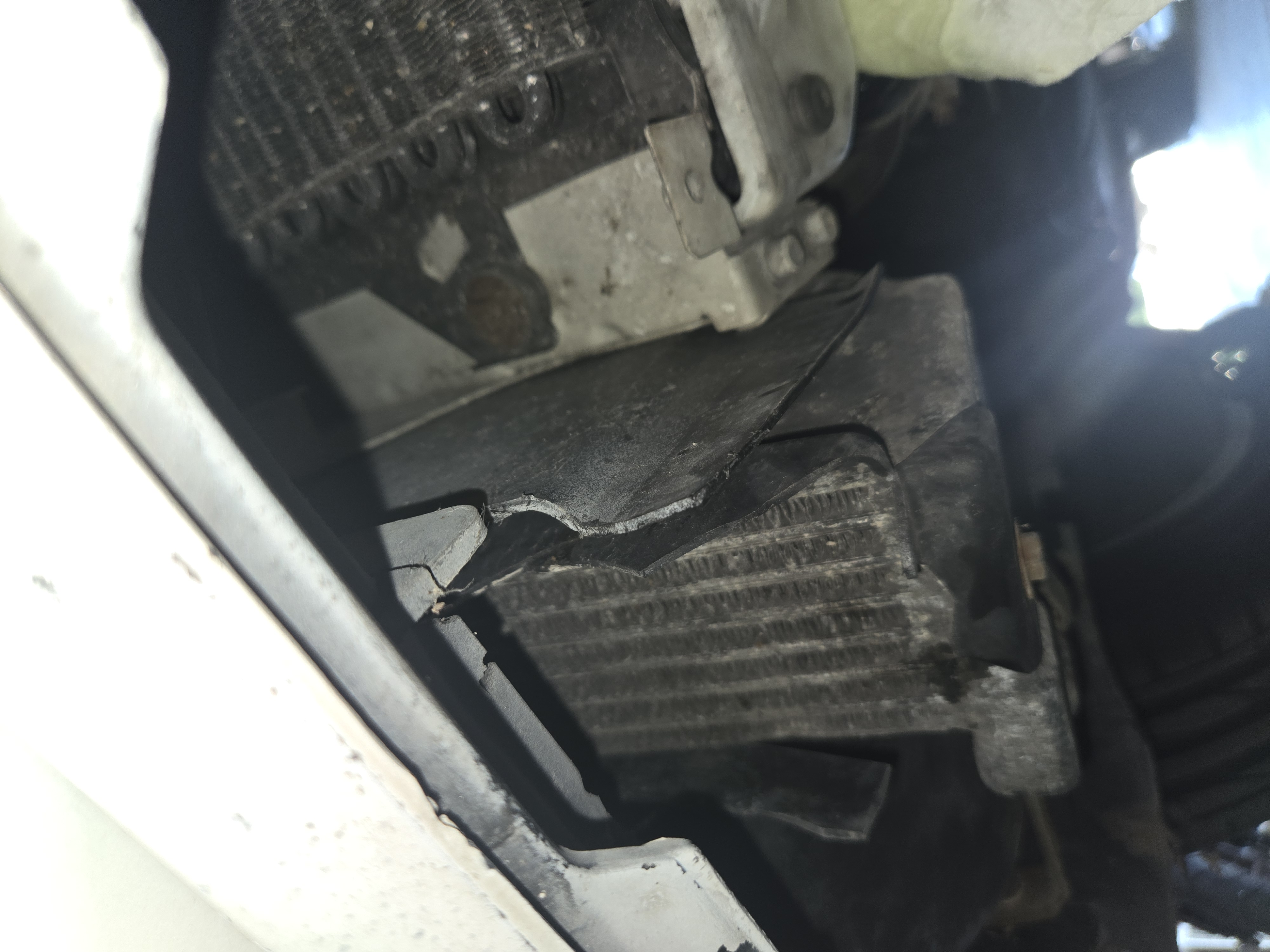

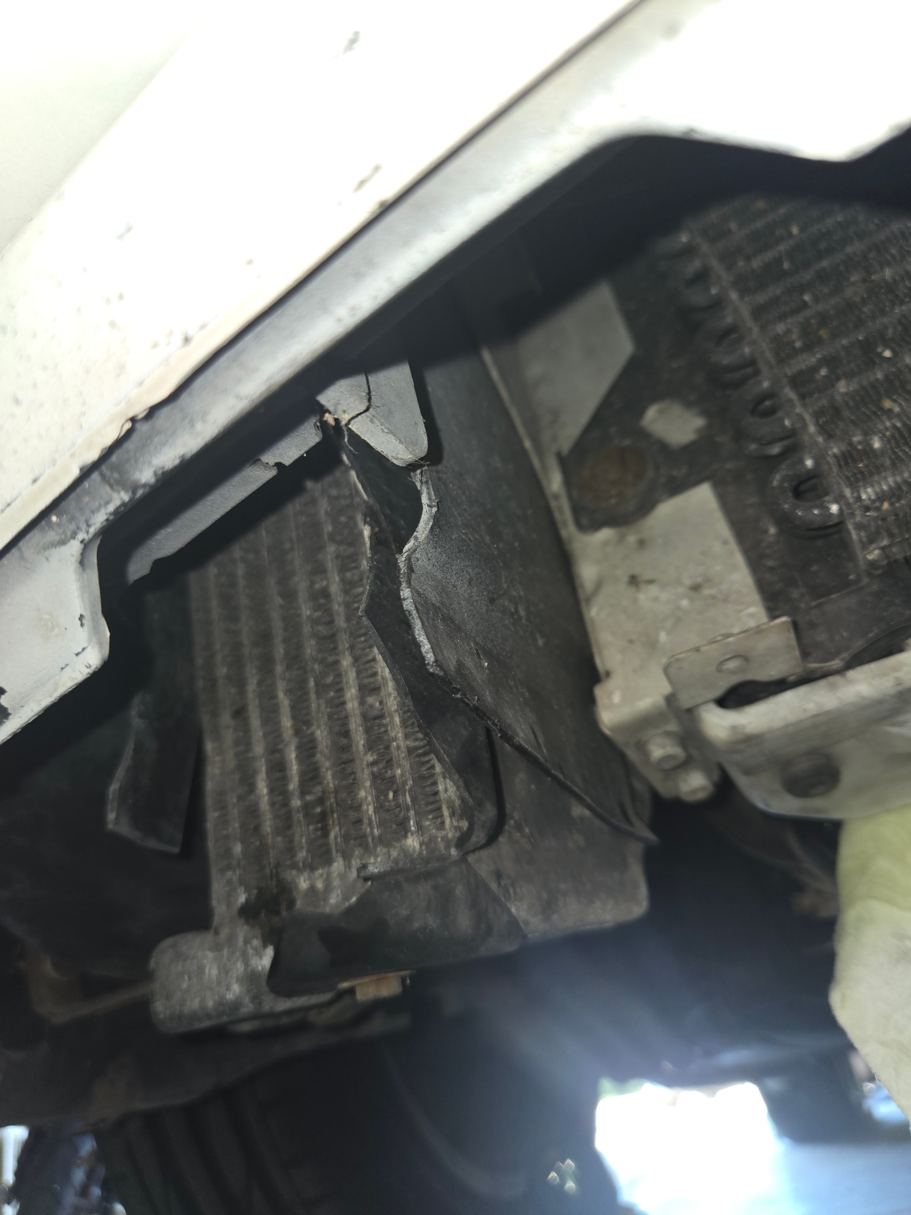

~I have found a source of overheating! The air duct for the oil cooler is f*... uh, mangled beyond saving.
Based on the cutting tool witness marks that travel up into the fog light area, it appears that this air duct was cut at one point in order to access the fog light hardware from the rear. I wish I could remember which shop replaced the fog light when I bought the car in 2010 that also sated "the Euro fog light is cheaper, want us to install one of those, it won't match the other one." In my ignorance I approved of this replacement but should have inspected their work after the fact. This one is on me for being young and ignorant. What a hack job. :oops:

Since that part is cracked, I might be inclined to fill the whole thing with jb weld and drop the insert in before it hardens...

Tom wrote: Wed Jul 15, 2026 6:54 pm Since that part is cracked, I might be inclined to fill the whole thing with jb weld and drop the insert in before it hardens...
To clarify, do you mean JB weld instead of heating the threaded insert?
I do have a plastic welder, but that usually works better with hard plastics. I'm not confident the plastic welder would take well to this softer type of plastic.
There is one other threaded insert that is split like this one but hasn't failed yet. That one will get JB weld / plastic weld treatment as well.

Yeah, since it is split, I don't think the insert will be secure if you just try to melt it in. I've had luck rebuilding similar tabs with jb weld and those brass inserts. Just the 24 hour version for sure though...
