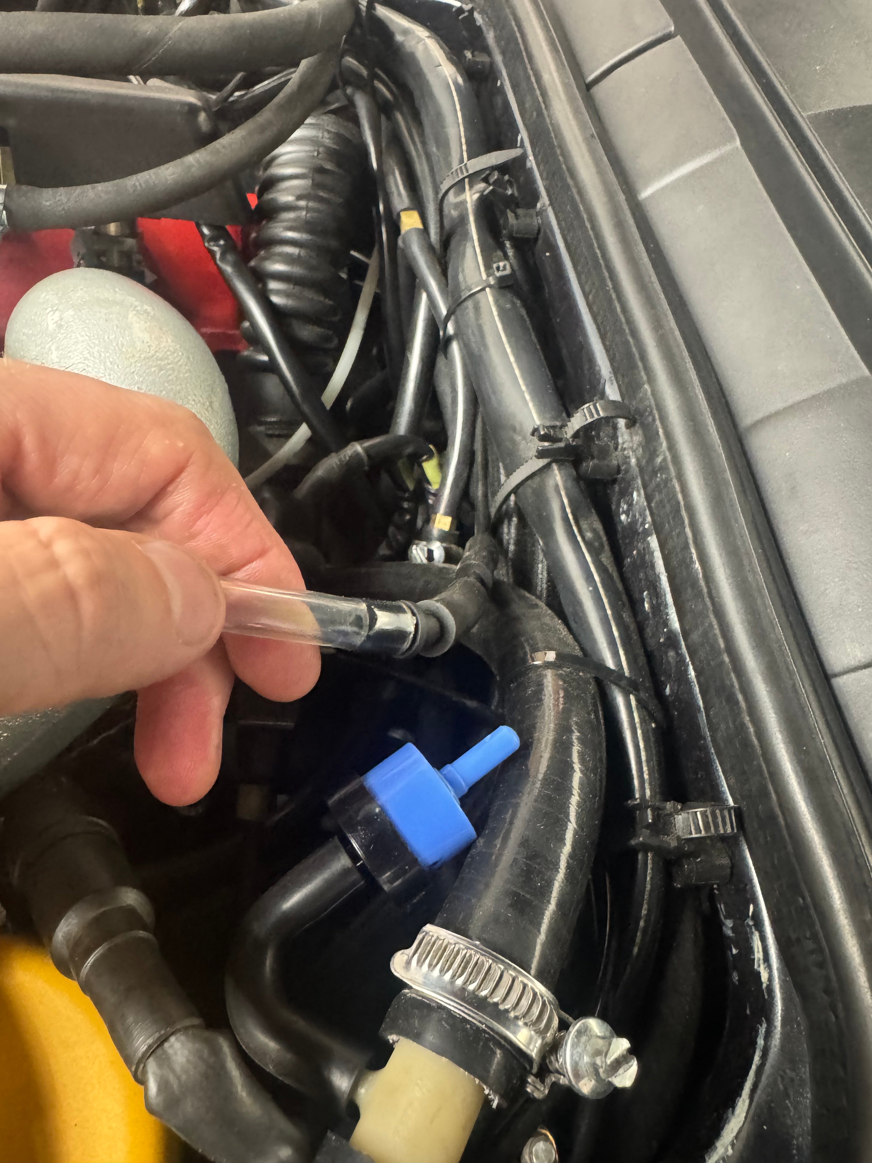

So here’s another update. I thought I got all the exhaust and vacuum leaks taken care of. Started the car and only slight improvement. Still 15-16 in HG at idle and still lean at warm start- but my wBo2 seems to be more accurate.
Then it dawned on me. Whats the one system that is connected to the intake but wouldn’t show any leaks via smoke or boost leak test?….because it’s separated by a one way check valve? The HVAC system.
I hooked up my mighty vac on the vacuum line that supplies vacuum to the HVAC system on the passenger side of the check valve - it won’t hold vacuum at all. In fact it immediately goes down to zero.
I’m assuming this isn’t expected behavior, but wanted to confirm. My next step is to smoke test the HVAC system.

Can you post a pic of the line you tested?

Tom wrote: Sun Jun 28, 2026 12:51 pm
Here you go:

As a quick test, you can just plug those lines to see if vacuum improves at idle. I doubt it is big enough to drop the vacuum to 15 by itself, but every little leak adds up and is worth fixing. :angel: If your heater generally turns on an off as designed, your leak is likely in the vacuum canister over by the battery (rather than the hvac plumbing that t's off that line). Very common for the nipple to snap off or the canister to develop cracks/leaks. I'm starting to wonder if your issues may have been a thousand little cuts rather than one big 'aha' thing?
