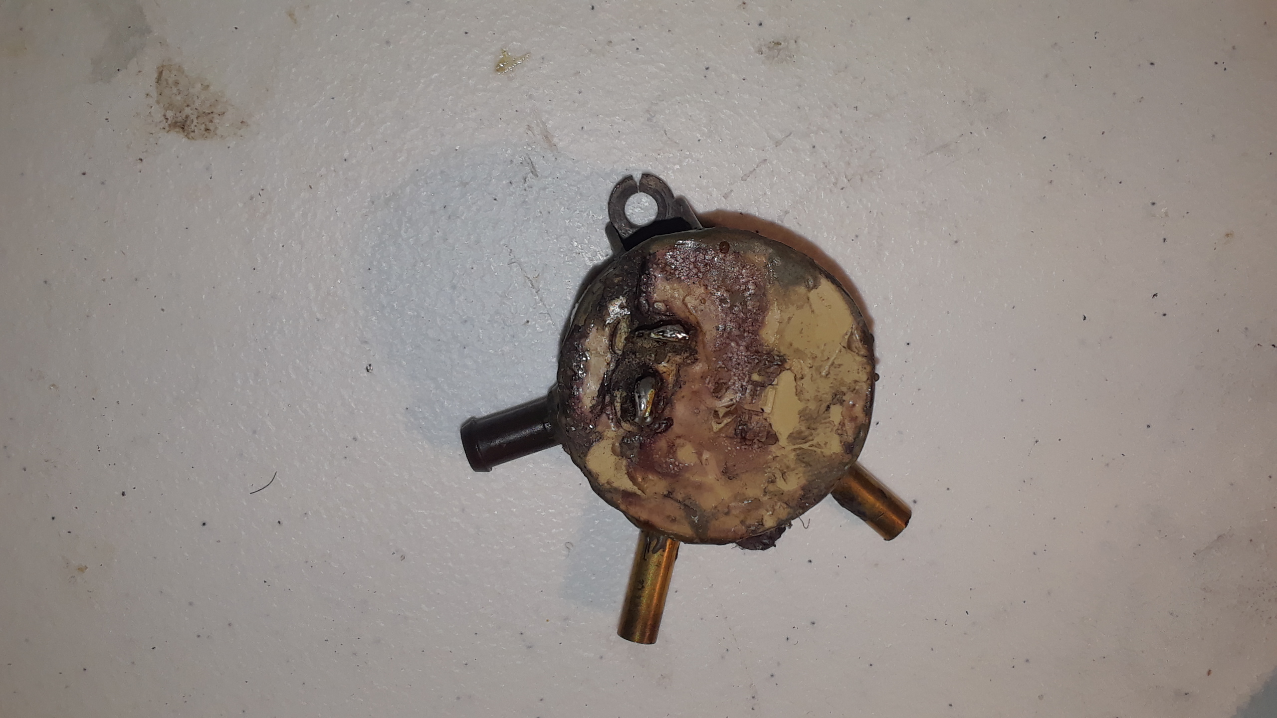

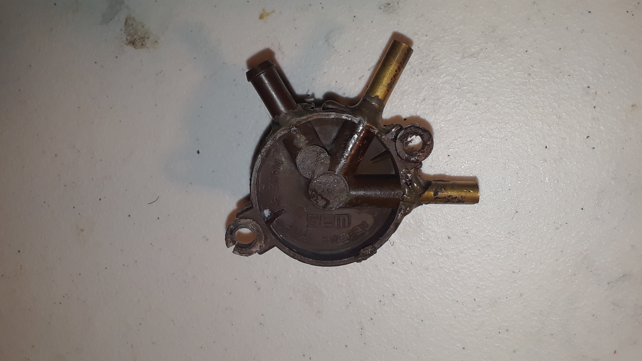

I did this to my CV a while back and used it for multiple years before I put in a mac valve and home made EBC. I just J.B welded two copper tubes in it.
Sox
