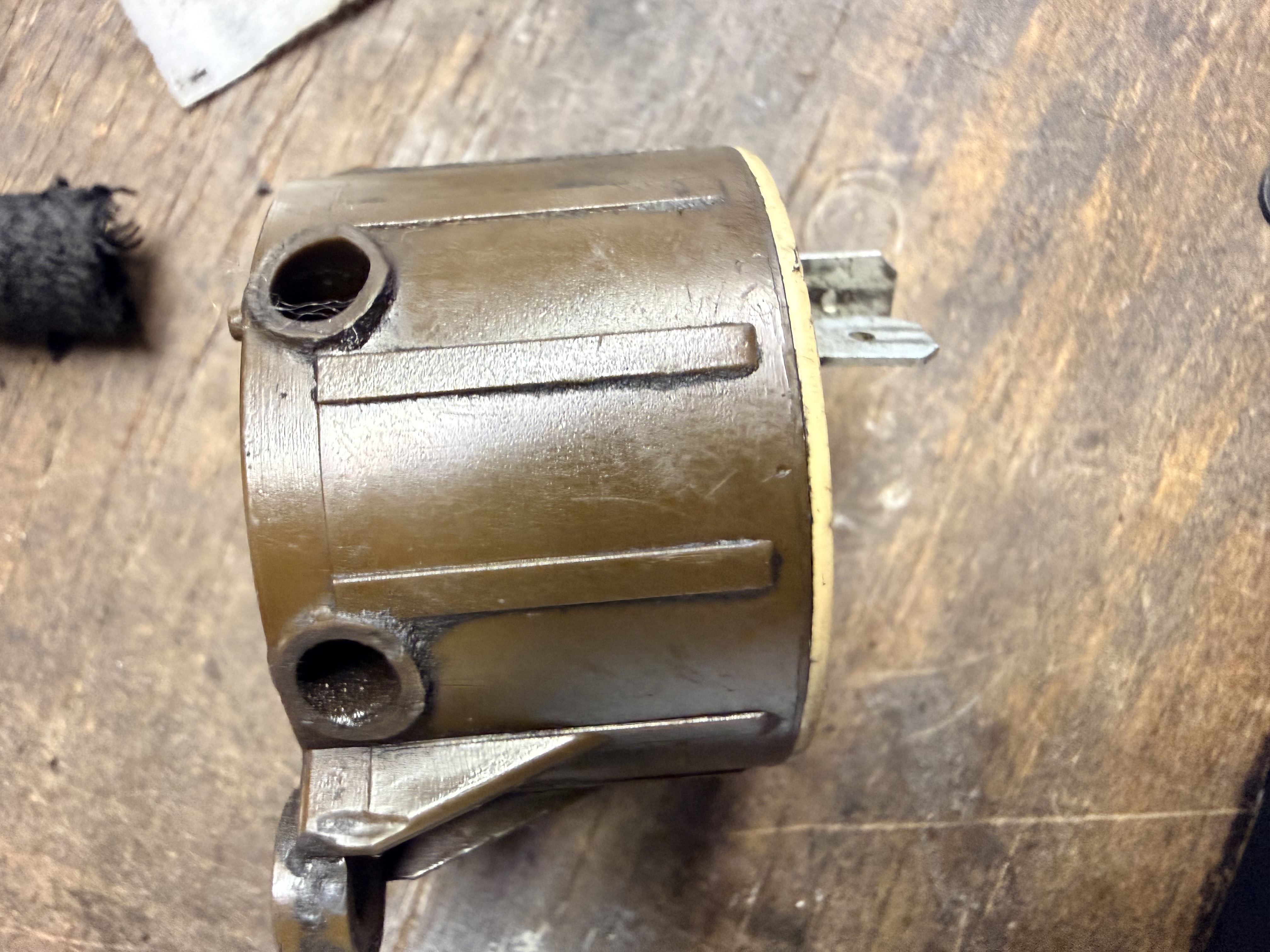

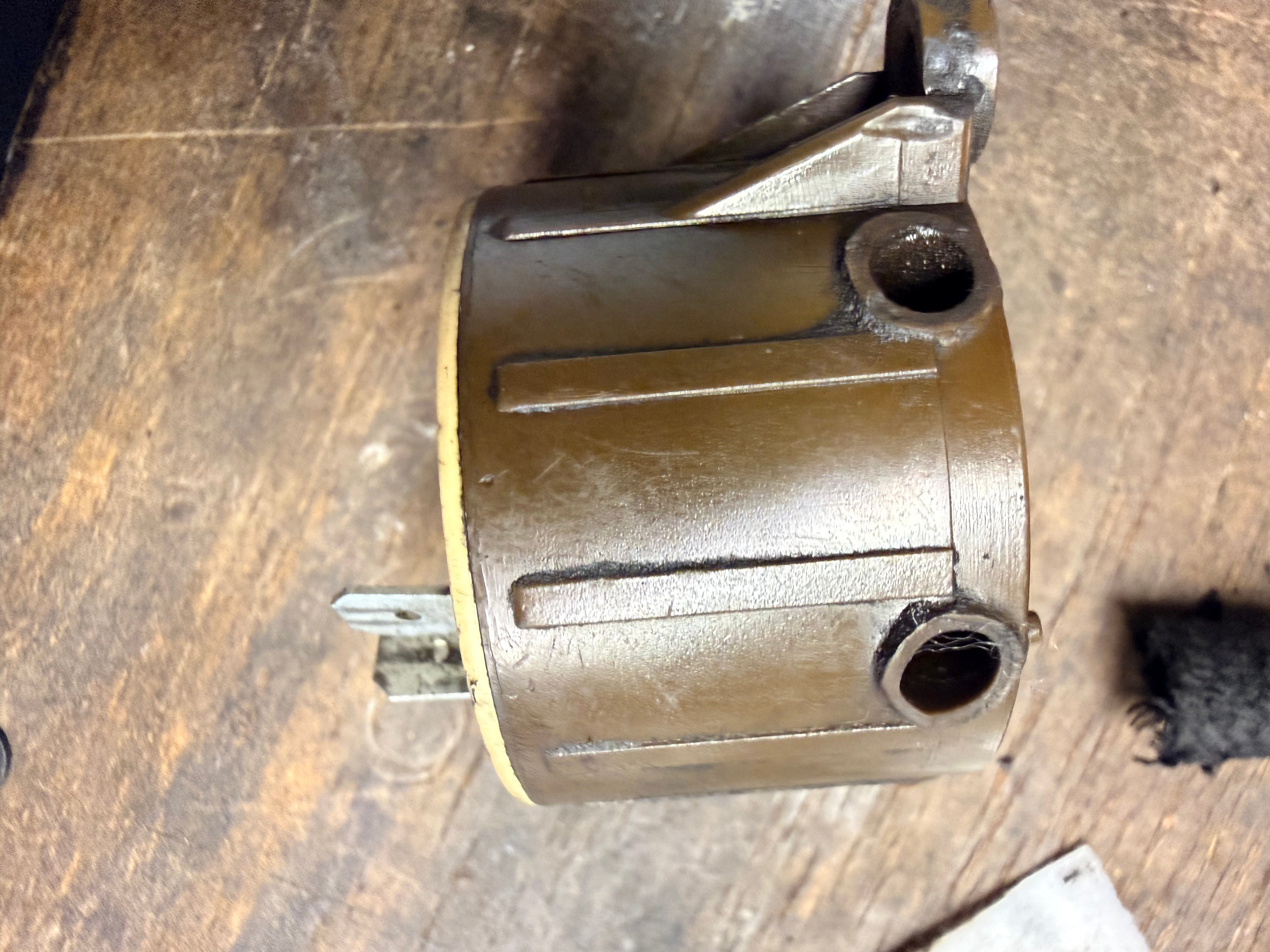

In the midst of doing Venturi delete, vacuum line replacement and replacing my turbo, my cycling valve plastic lines snapped. Didn’t apply much pressure but all 3 were so brittle and they’re gone..
Trying to come up with a solution here and would appreciate if I could get some advice on options forward. I have a 86 turbo with a stock 26/6 turbo and wastegate. As I understand it, I guess I have 2 solid options and 1 probably not so ideal wildcard.
  • bypass the cycling valve and run a manual boost controller. I’m fairly new to the 951 and trying to understand the MBC. Can I run a Lindsey MBC with a stock turbo and watergate setup? Can someone explain exactly how it works? Before this happened, I was also considering a Lindsey boost enhancer. Can these both be ran together?
  • replace the cycling valve. Not great since the only place I see it in stock it’s $600
  • Try to hack the cycling valve back together or rig it. I attached a picture of the damage. All 3 ports are broken 😞. Could I try to glue some vacuum fittings or barb together to rig it up? Probably not a great option as I would assume there needs to be an air tight seal and the broken ends are pretty cooked so I don’t think I can glue those back on. [/ list]

Thanks for all the suggestions! I watched the video and will need to watch it again as someone else said! I was eventually planning to mod the car, but not now. I wanted to get this project done and drive it for a bit to get a feel for what I want to do in the future. I think I’m going to stick with locating a decent used CV and go from there..

Appreciate the info. I was able to locate a good used cycling valve. For now, going to keep it stock and go from there. I am considering the Lindsey Boost enhancer though, but not yet! I’m going to focus on getting this project done - replacing the whole top end rubber and Venturi delete, aos seals etc and swapping the turbo with a newly rebuilt spare 26/6. The turbo that is in the car has compressor damage (I guess something got caught in there at some point 😮) so just swapping this one in to start fresh stock. I’m sure down the line the more I drive it, I’ll get the itch.
