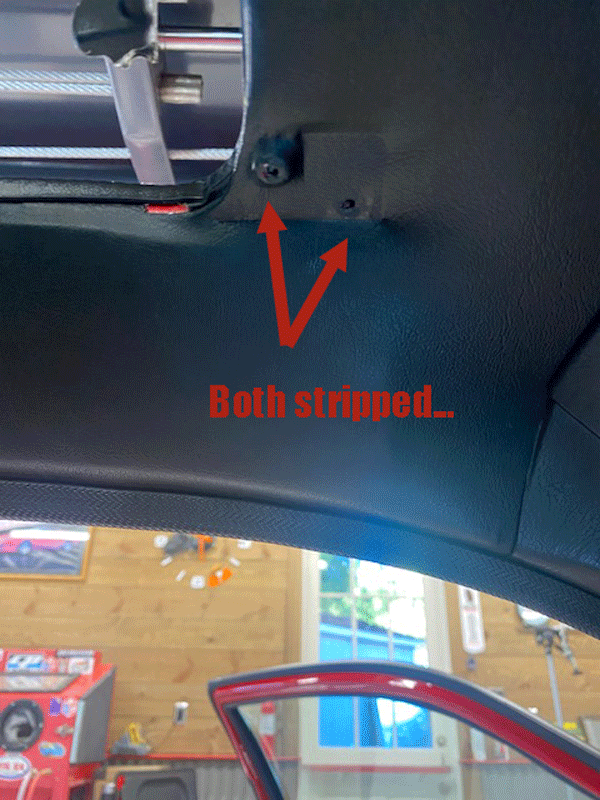

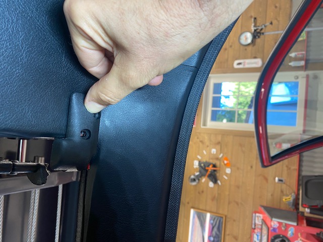

So I did a little investigating today, and see results in the video. The wind deflector is held in place with "hinges" on both ends. Both of my hinges were cracked, and one fell apart completely in the video (oops). The good news is that those hinges are still available for 'only' $25 each.
As seen in that video, however, the hinge also wasn't screwed tightly to the car, which allowed it to move around. I have a hunch that's a big source of the creak. I'm the second owner and have never taken it apart, but when I took that hinge off, it's very clear someone was in there before. The screws are sheet-metal self-tapping types and someone had cross-threaded the holes they go into. They only went in part way before getting stuck, so someone's bright idea was to stack some washers over the hole so the screw didn't need to go in all the way.
It appears I was able to 're-tap' the holes with another screw. If so, with any luck, when I get the new hinges, I'll be able to get them tight now. Otherwise, I'll need to get creative. Not 100% this will fix the creak, but seems promising, and needed to be fixed anyway. Stay tuned.
This is the hinge that was sliding on the headliner to matter how "tight" I did the screws...

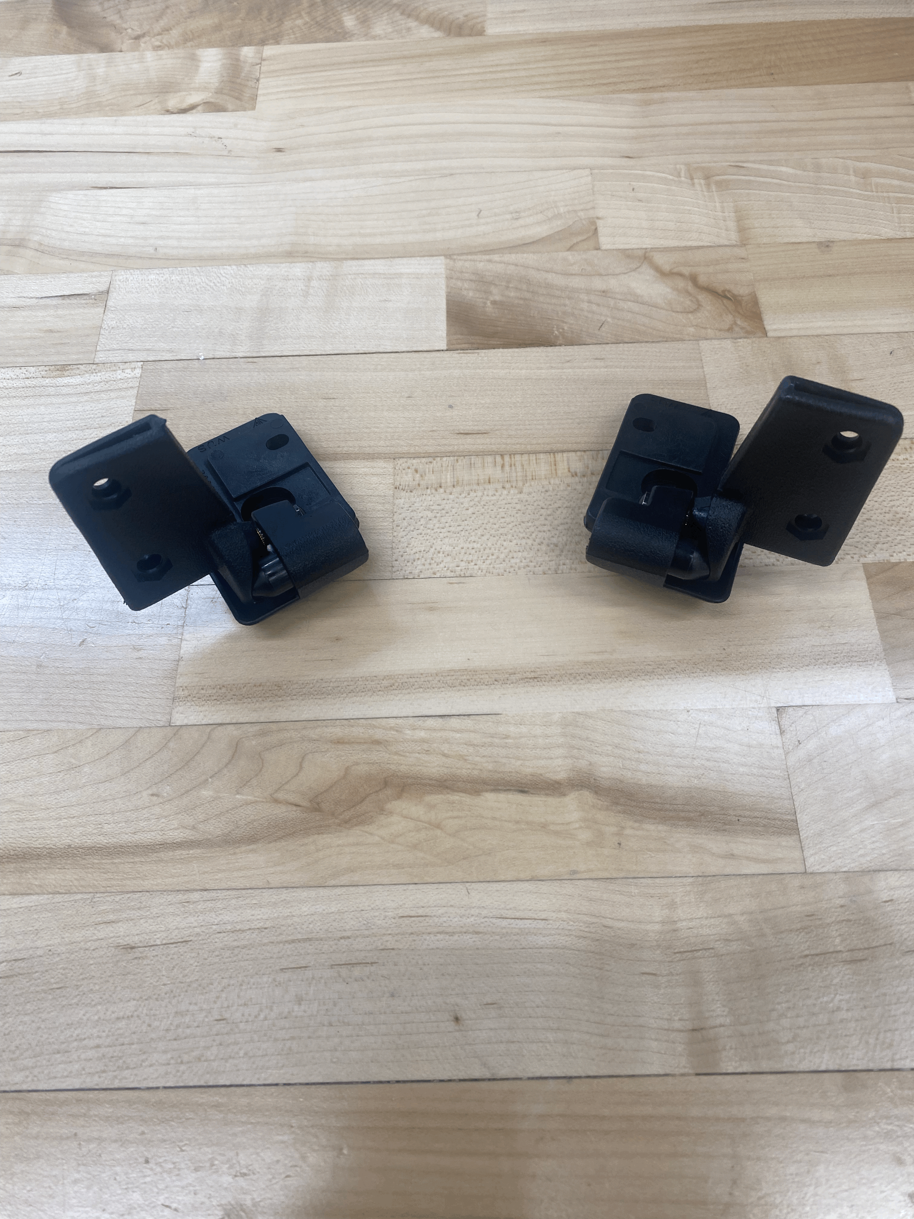

The new hinges are here, the new hinges are here!!

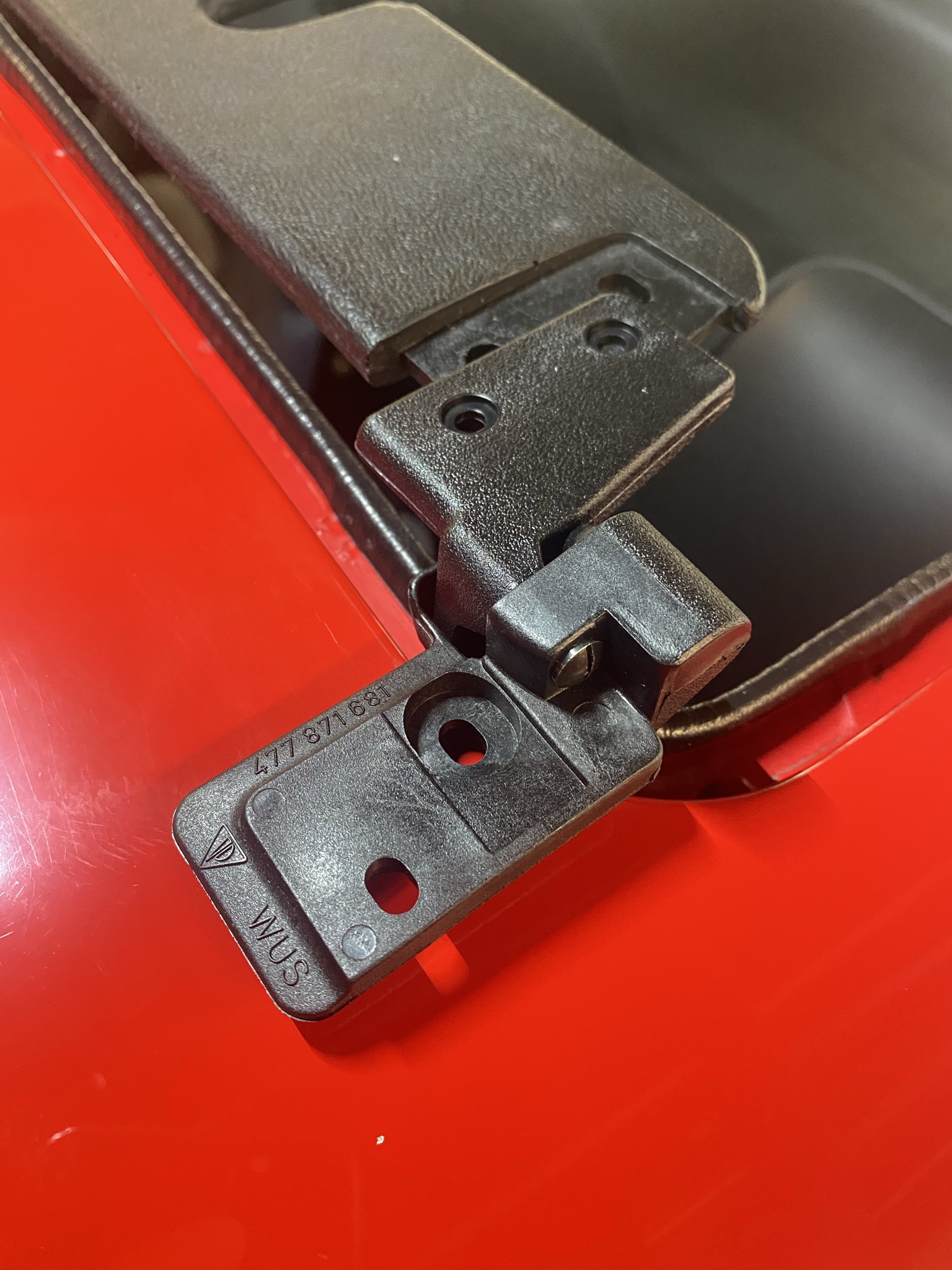

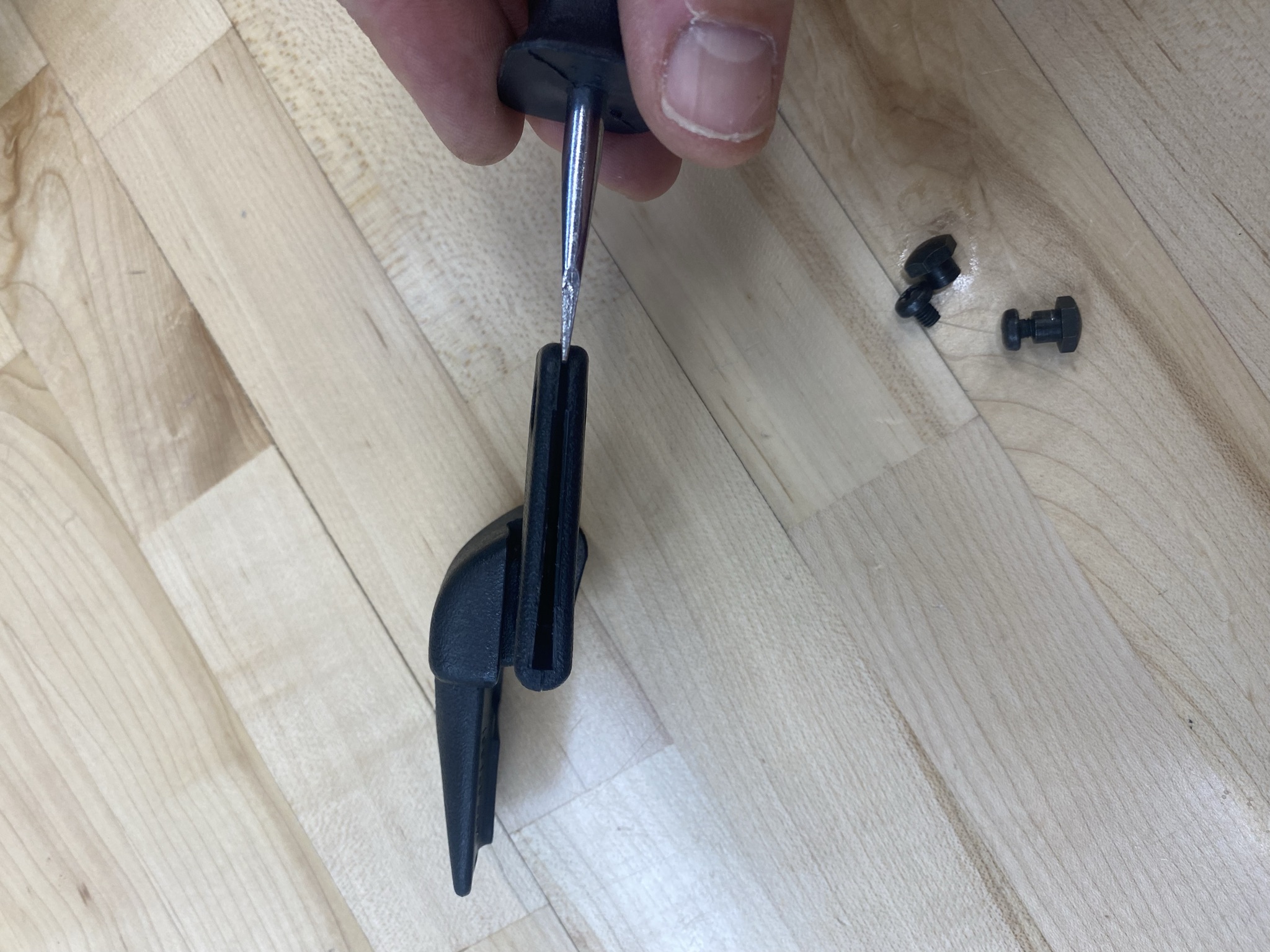

Hinges went on both sides with no problems at all. You need to pry apart the little sandwiched flange part to get it on the wind deflector, but the whole thing is a 10 minute job. However, when I went to relatch the sunroof in the front, the latch clamp thing disintegrated in my hands. The plastic timed out at 35 years I guess. Cheap W. German junk
It's so common it seems, that Rennline makes a billet replacement, so I ordered 2 or those from Pelican and the wait continues. To make it worse, I'm now wondering if the creaking is really the 'headliner' panel creaking against the metal sunroof. Pushing on it, I can get it to creak pretty noticeably...
The hinge slides on to the wind deflector and is held on with custom captive screws nuts you won't find at the hardware store (i.e., don't lose them when you take them out!).
You have to pry the sandwich flange open a bit to get it to slide on -- and see the specialty screw/nut combo that holds it on.
