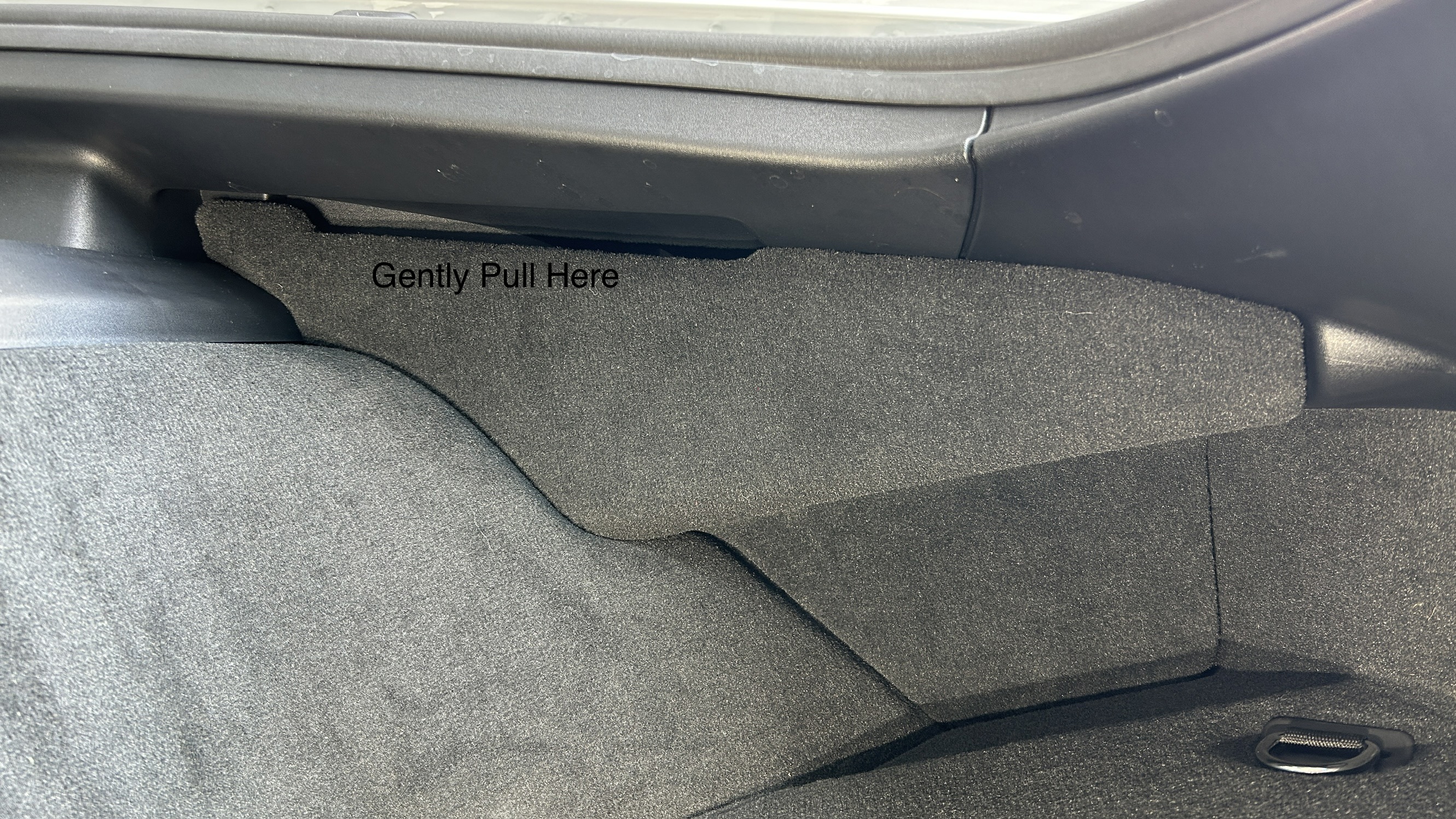

1. Remove Fuse Cover on the rear passenger side (LHD Cars), watch for the little cones that like to fall off.

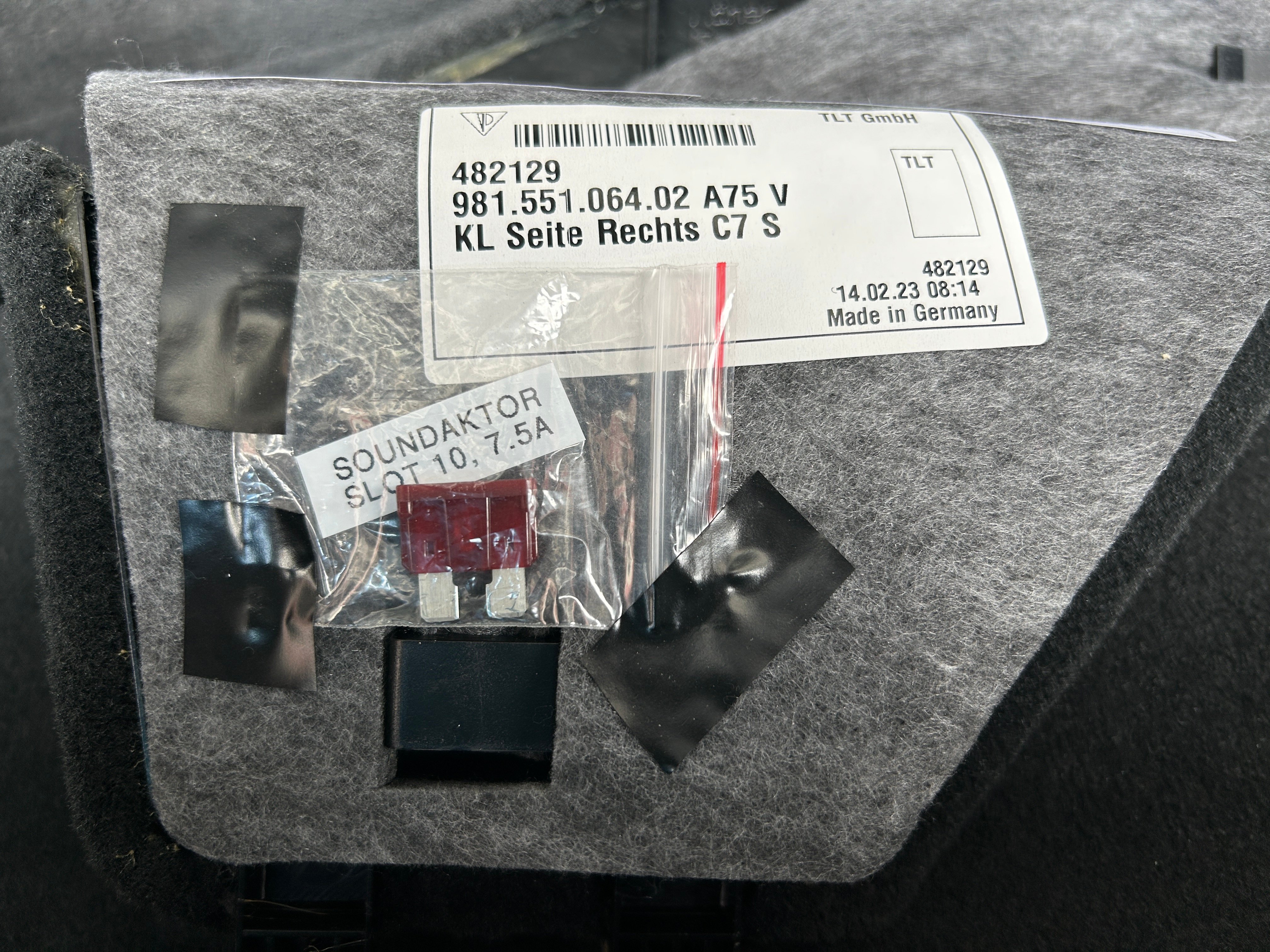

2. Find the 7.5 Amp Fuse in Slot 10, and remove it.
3. I followed an example from another forum and taped a baggie containing the fuse, inside the fuse cover.

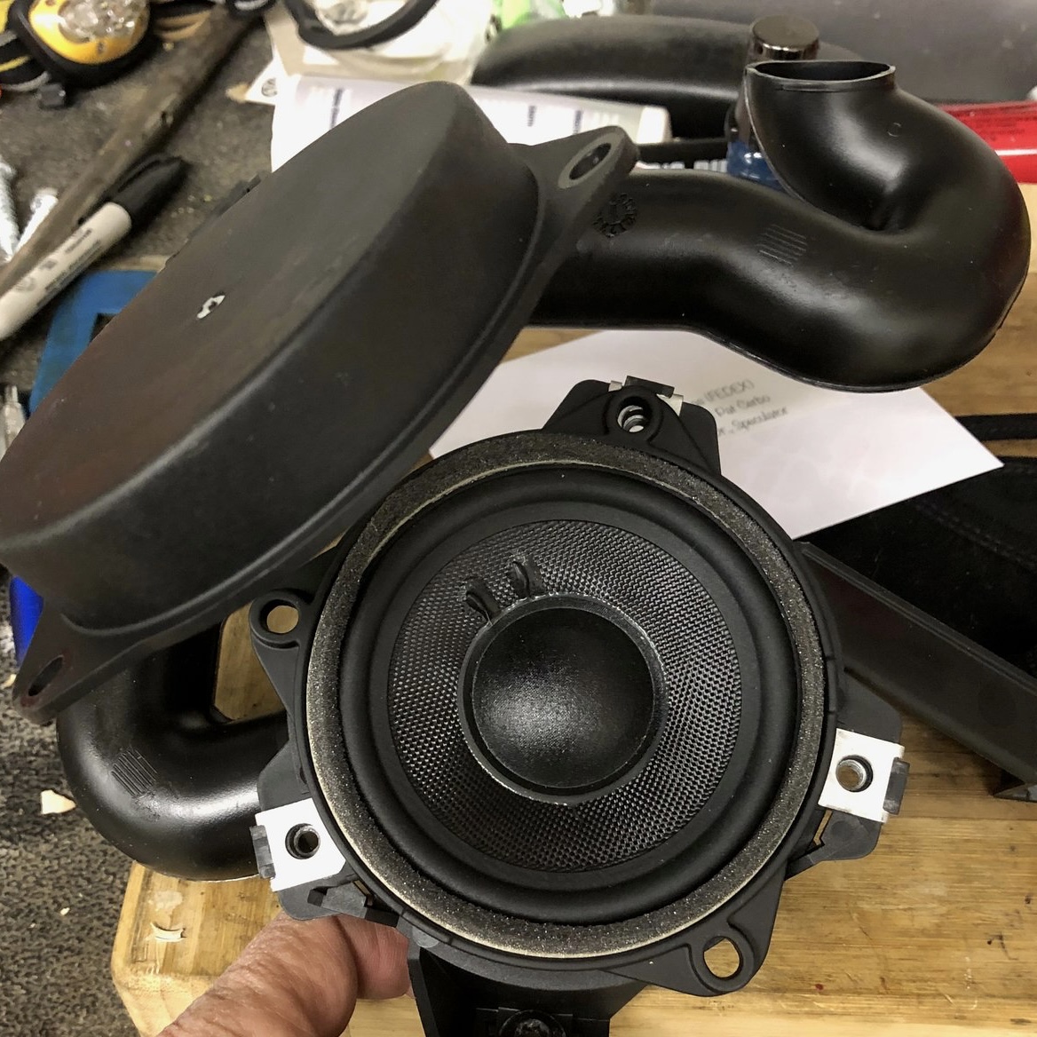

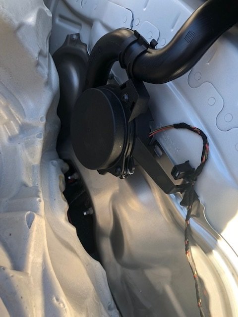

2019 - 2025 models had a newer design, which is a speaker and tube design apparently less harsh than the older design as it does not vibrate the firewall the way the older design does.
Newer Design:
The fuse pull works with either as it kills power to the Control Unit.
