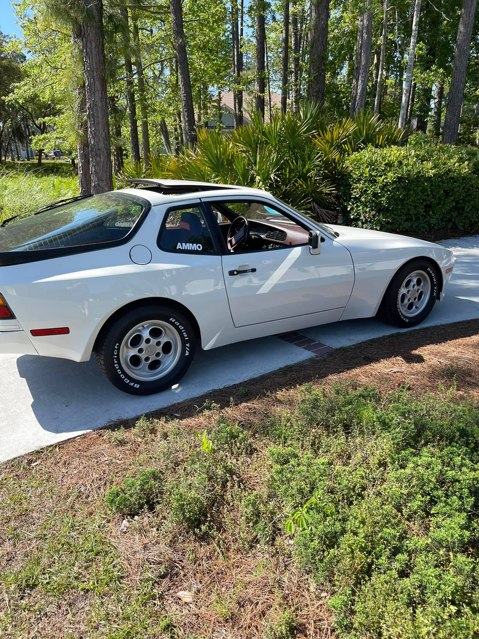

Pic for attention. New tires mounted. I put in a new battery last weekend and was shocked and pleased to find my dash and sunroof came back to life. Everything works even the up shift light. But, it all went out again after a couple of miles. Any tips on how to track this down? I was hoping that because the dash and sunroof are acting in tandem that would be a clue.
