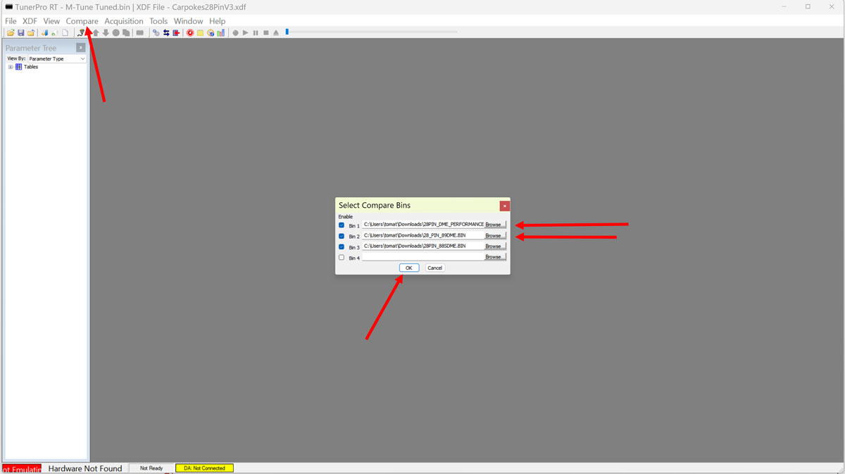

So I just checked the posted files and can confirm the Performance chip is indeed modified from the stock chips. The performance chip is basically the 89 turbo chip with the full throttle map and the overboost protection map altered. To see for yourself, do this:
1. Download the performance chip and the 89 turbo chip.
2. In Tunerpro RT, click Compare in the top menu and select Load Compare Bins...
3. In the pop up window, click browse and choose the performance chip for the first bin, and the 89 turbo chip for the second bin. Once those are uploaded, click ok.
4. Choose Tools in the top menu and select Difference Tool in the drop down.
5. In the pop up, make sure you select the performance chip and the 89 turbo chip in the two boxes on the top line.
6. Click the search button and a list of file locations that are different will be listed.
