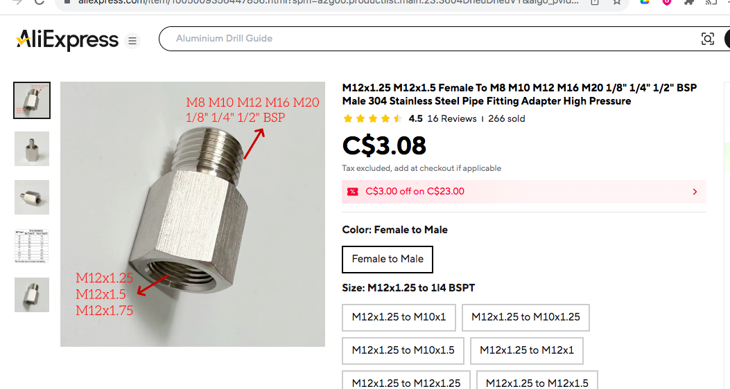

It's a rare thread and all fuel pressure kits that I've seen here don't have the fitting
Something called "Globe" fitting size 12 x 1.5
On that Clark's link there is another link to making your own adapter using either another factory end cap or a piece of steel / aluminum
You can source something to fit from China
Screen Shot 2026-05-09 at 7.54.44 AM.png (252.53 KiB) Viewed 267 times
Or... just stretch the hose over the end and hold it tight ;)

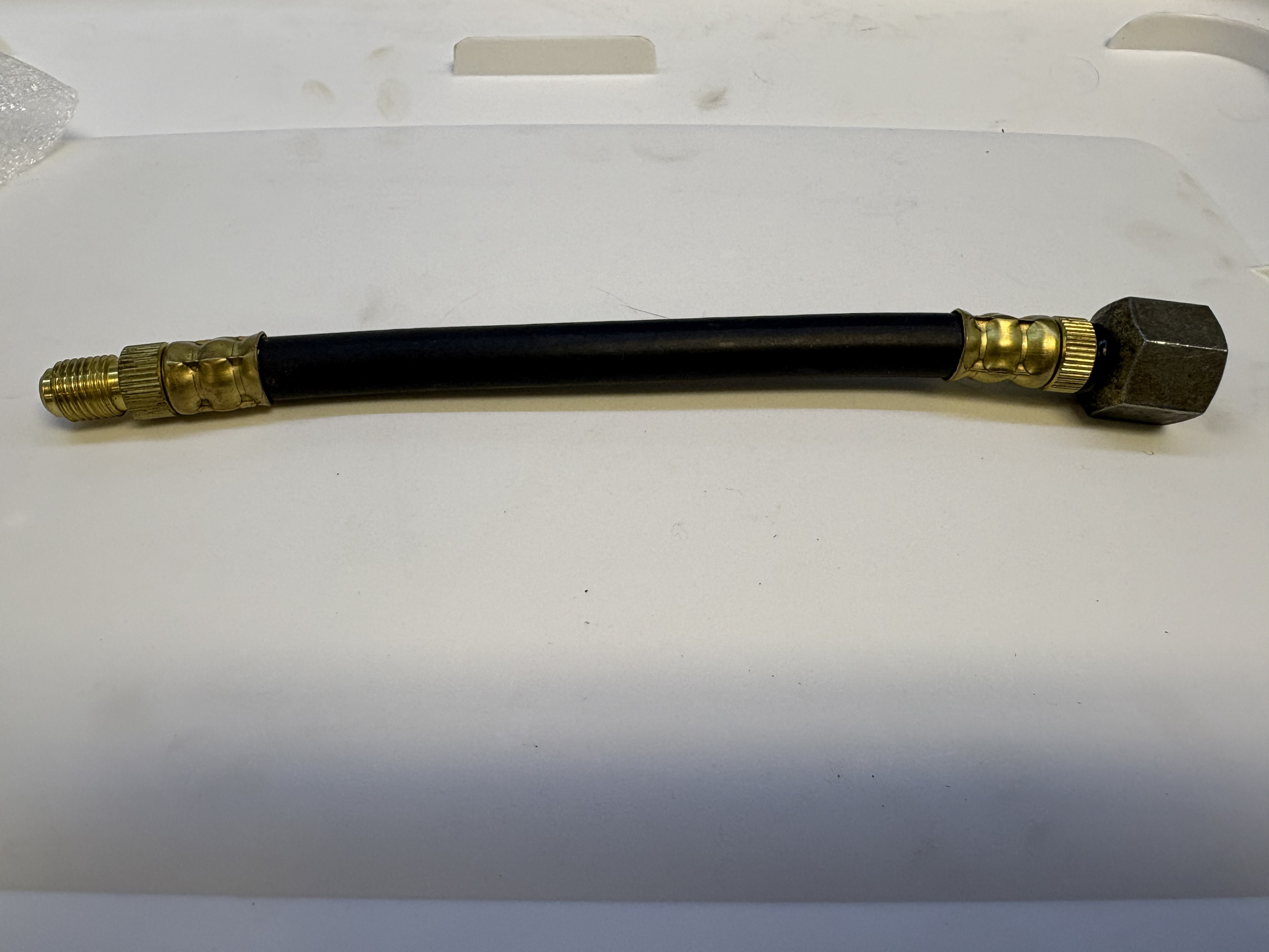

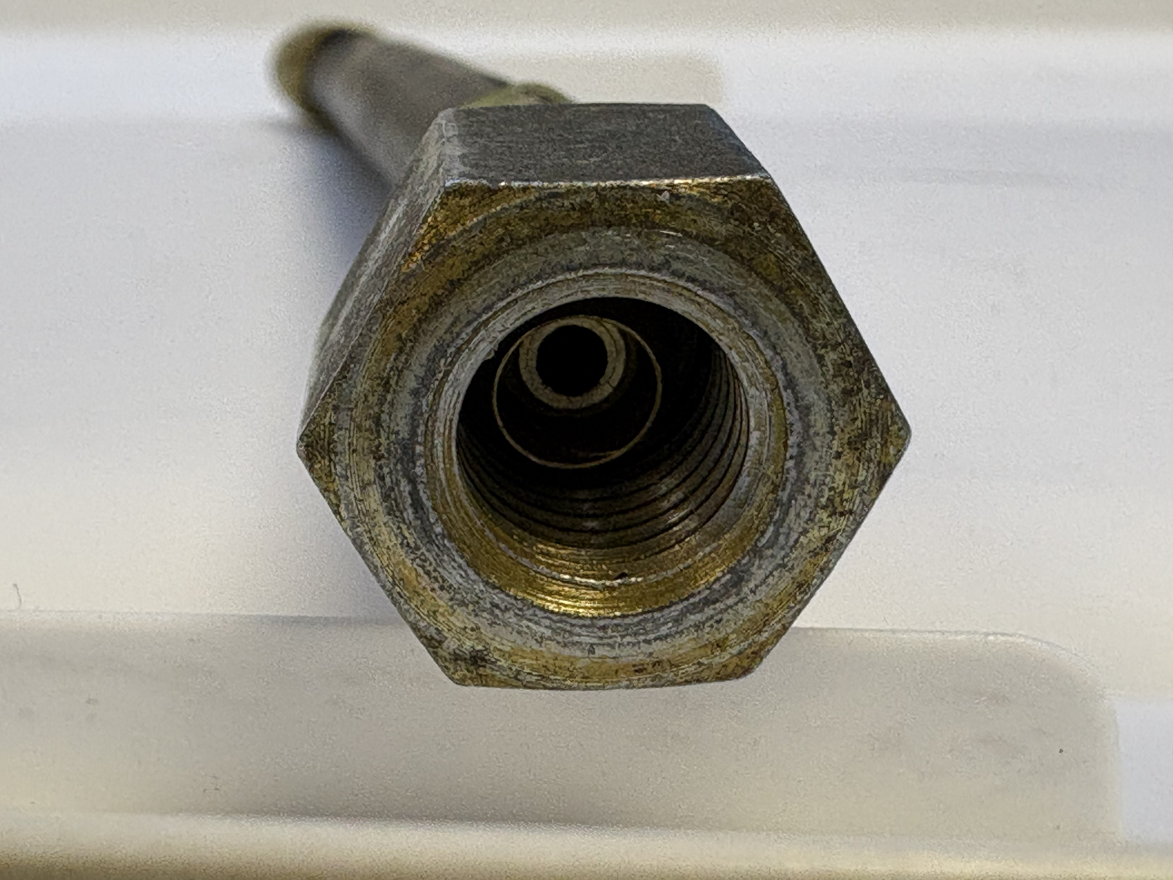

Carrying this a little further --
A 928 friend made a couple adapters for me, with o-ring grooves for a back seal. I haven't needed to test fuel pressure since they arrived. so have no experience to share on how they seal. For those looking to DIY an adapter, I share the pictures. One has 1/4 FNPT, the other 1/8.
Fuel Rail Test Adapters
The adapter I've been using has a used cap tapped 1/4-20, for a standard GM-style type test hose. On the GM fuel rail, there's a 1/4-20 bolt with a copper sealing washer to seal the hole. I should get some of those washers, but in the meanwhile the o-ring you see in the picture is doing that duty.
Inside the cap, the stub end of the hose adapter is deep enough to hold the brass ferrule in place. That's the reason I chose to use the GM adapter into the cap.
The important thing to remember is that the end of the rail has straight threads, and with no taper are no good at sealing on their own. The little brass 1/4" tube compression ferrule is a very handy replacement for the steel ball that normally does the actual sealing. It's soft enough to compress slightly, and offer no risk to the steel rail.
These are plumbing department at Home Depot pieces by the way. Look in the small fittings rack, maybe where icemaker tubing fittings are displayed. I bought a bag of ten a couple decades ago, and still have a few left.
HTH!
