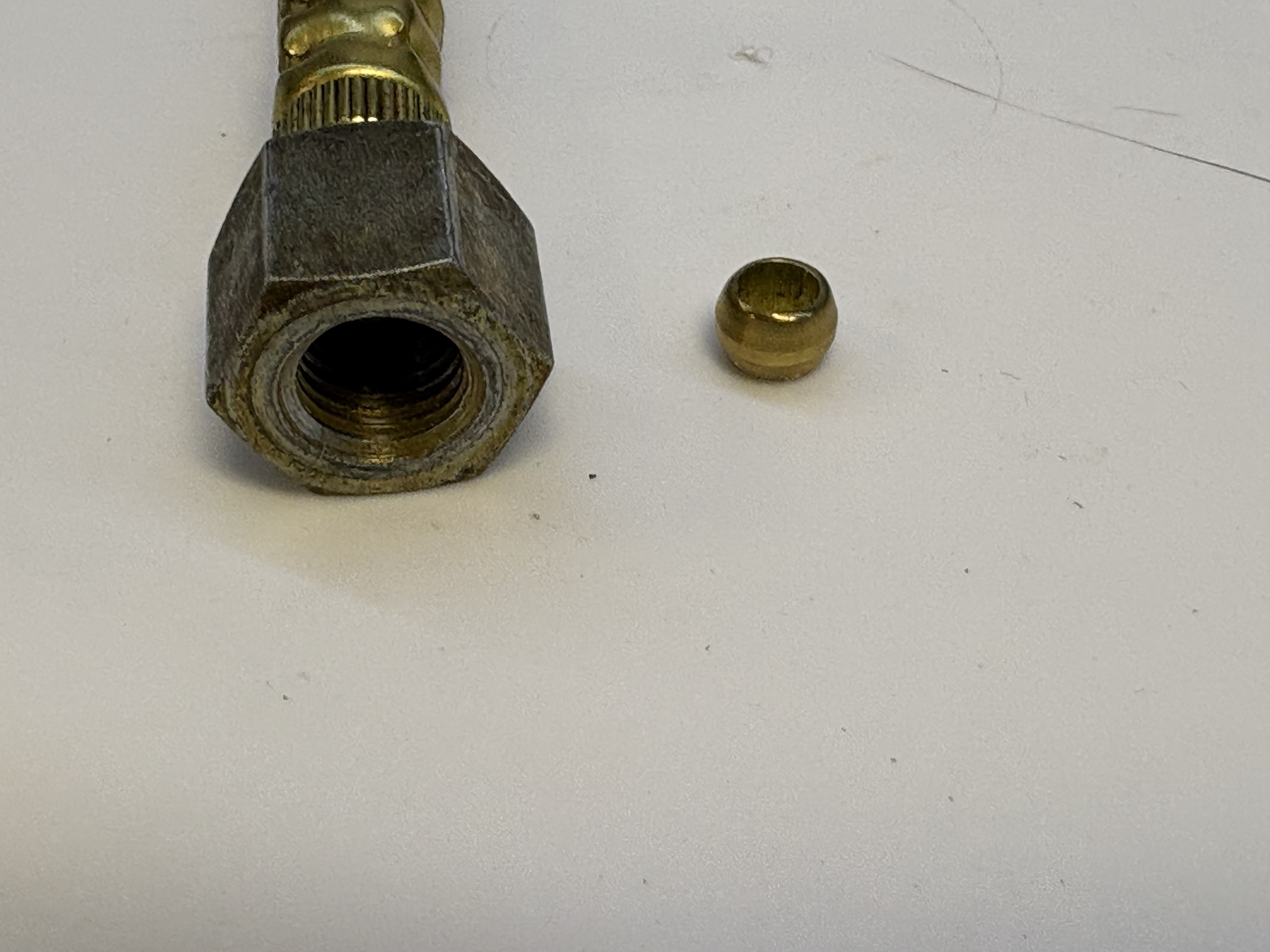

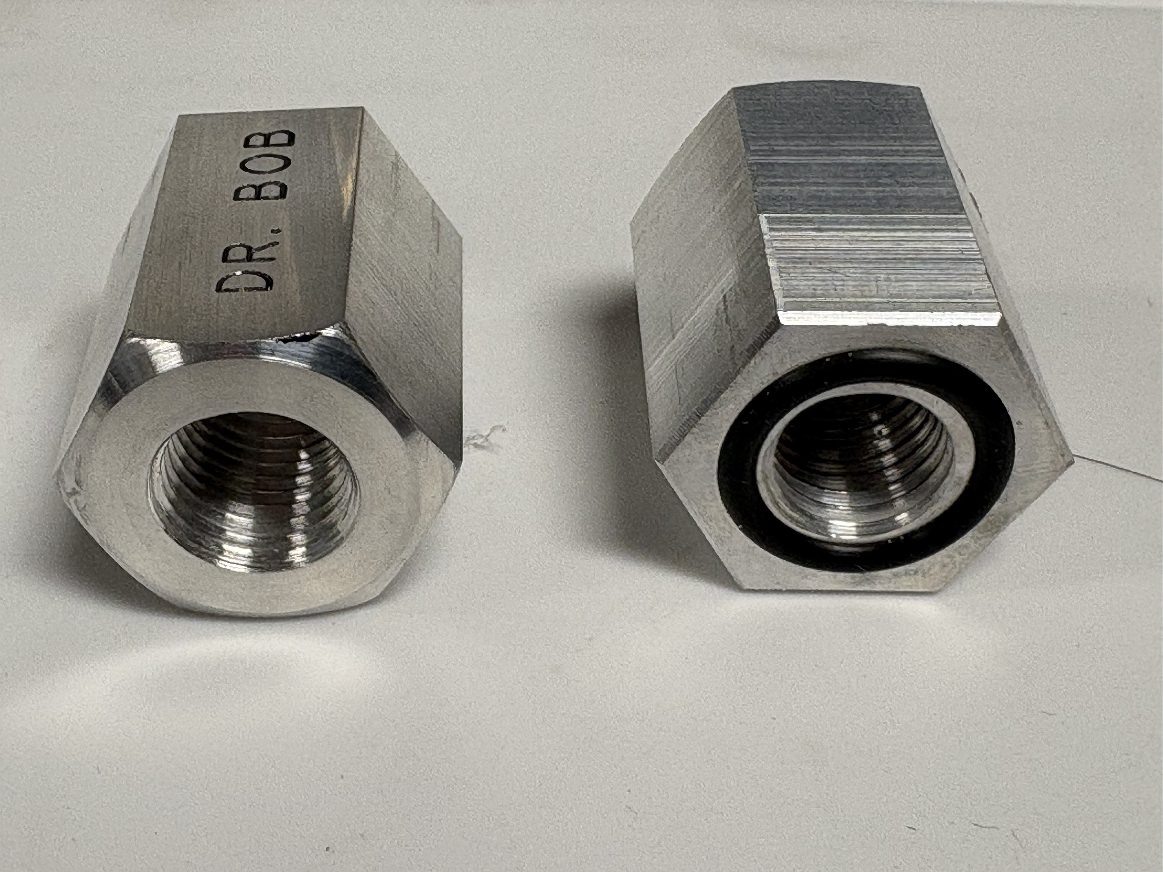

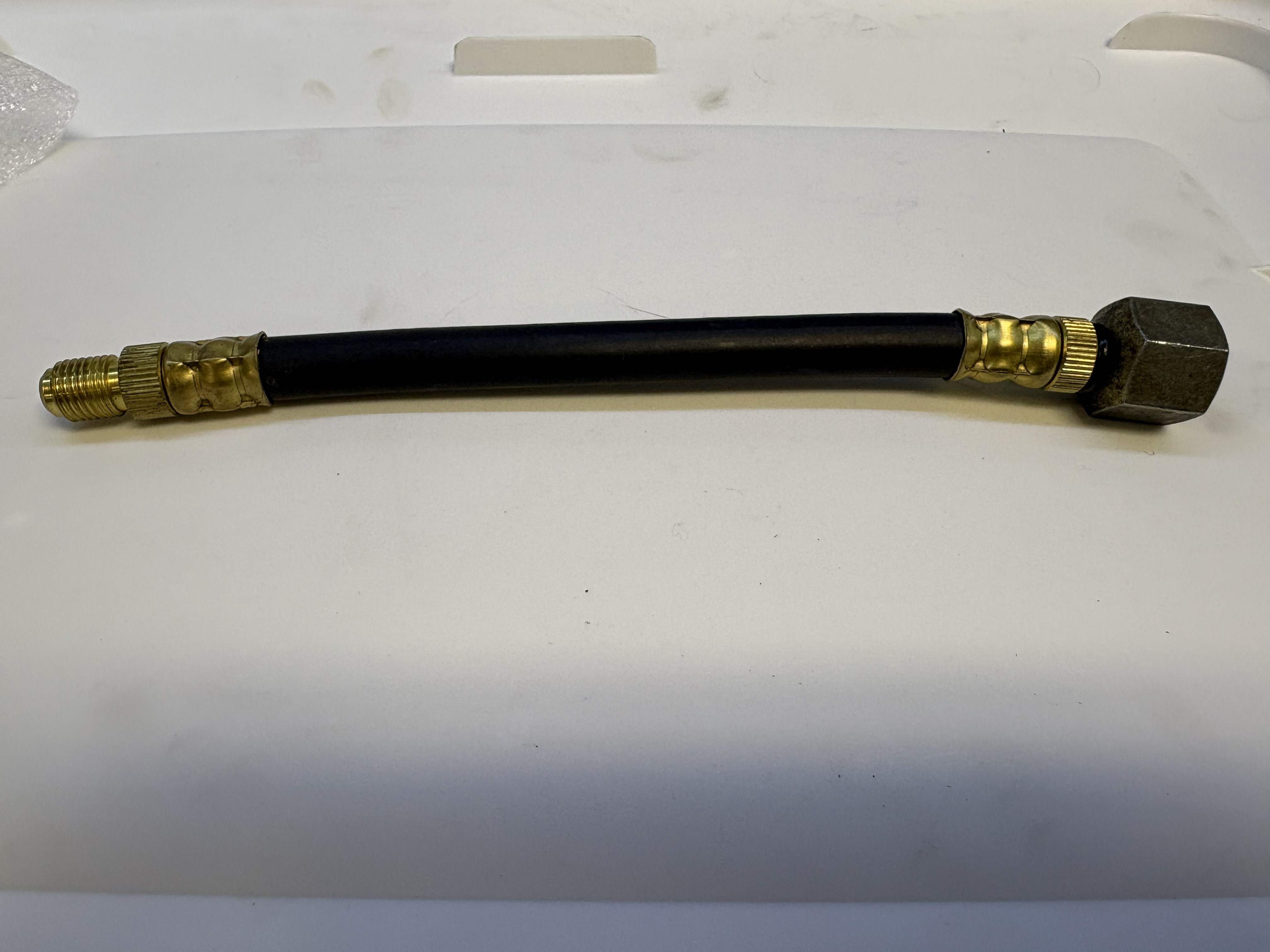

Carrying this a little further --
A 928 friend made a couple adapters for me, with o-ring grooves for a back seal. I haven't needed to test fuel pressure since they arrived. so have no experience to share on how they seal. For those looking to DIY an adapter, I share the pictures. One has 1/4 FNPT, the other 1/8.
The adapter I've been using has a used cap tapped 1/4-20, for a standard GM-style type test hose. On the GM fuel rail, there's a 1/4-20 bolt with a copper sealing washer to seal the hole. I should get some of those washers, but in the meanwhile the o-ring you see in the picture is doing that duty.
Inside the cap, the stub end of the hose adapter is deep enough to hold the brass ferrule in place. That's the reason I chose to use the GM adapter into the cap.
The important thing to remember is that the end of the rail has straight threads, and with no taper are no good at sealing on their own. The little brass 1/4" tube compression ferrule is a very handy replacement for the steel ball that normally does the actual sealing. It's soft enough to compress slightly, and offer no risk to the steel rail.
These are plumbing department at Home Depot pieces by the way. Look in the small fittings rack, maybe where icemaker tubing fittings are displayed. I bought a bag of ten a couple decades ago, and still have a few left.
HTH!

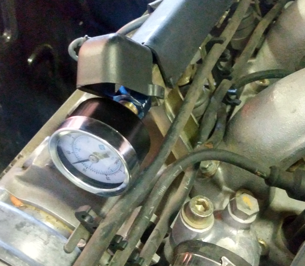

A -011 o-ring works to seal the fuel rail connection with the blue adapter many use to convert to npt.
https://www.amazon.com/M12x1-5-Aluminum ... C2YY/?th=1
Note that there was a fair bit of work to this short enough to install without removing the spark plug wire holder.

Same warning shared previously -- the normal engine vibration and the relatively large overturning moment on the small brass gauge threads, plus the brass bourdon tube inside, are a recipe for failure and a fire. Good if you need an instant check, NFG for a more permanent install. Trust me, and what we've learned from more than a couple car-be-ques. Whatever bling factor a gauge gives you goes up in smoke in minutes.
A small sensor wired to a gauge in the cockpit would be a good option. No need to drive with all those mirrors and the hood off to see the gauge in service.
