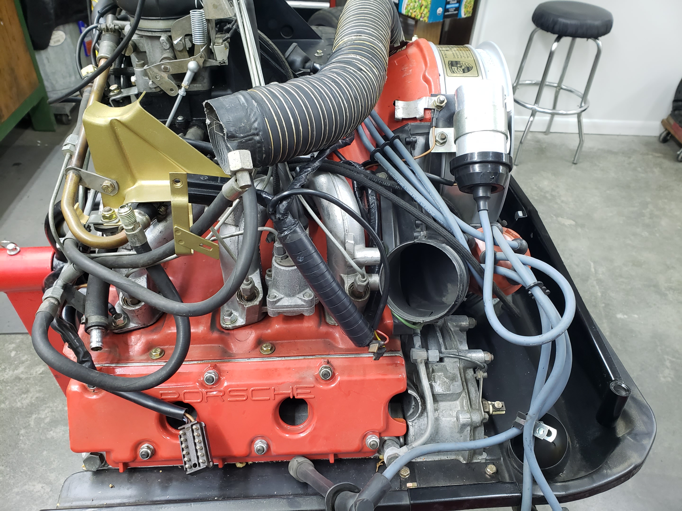

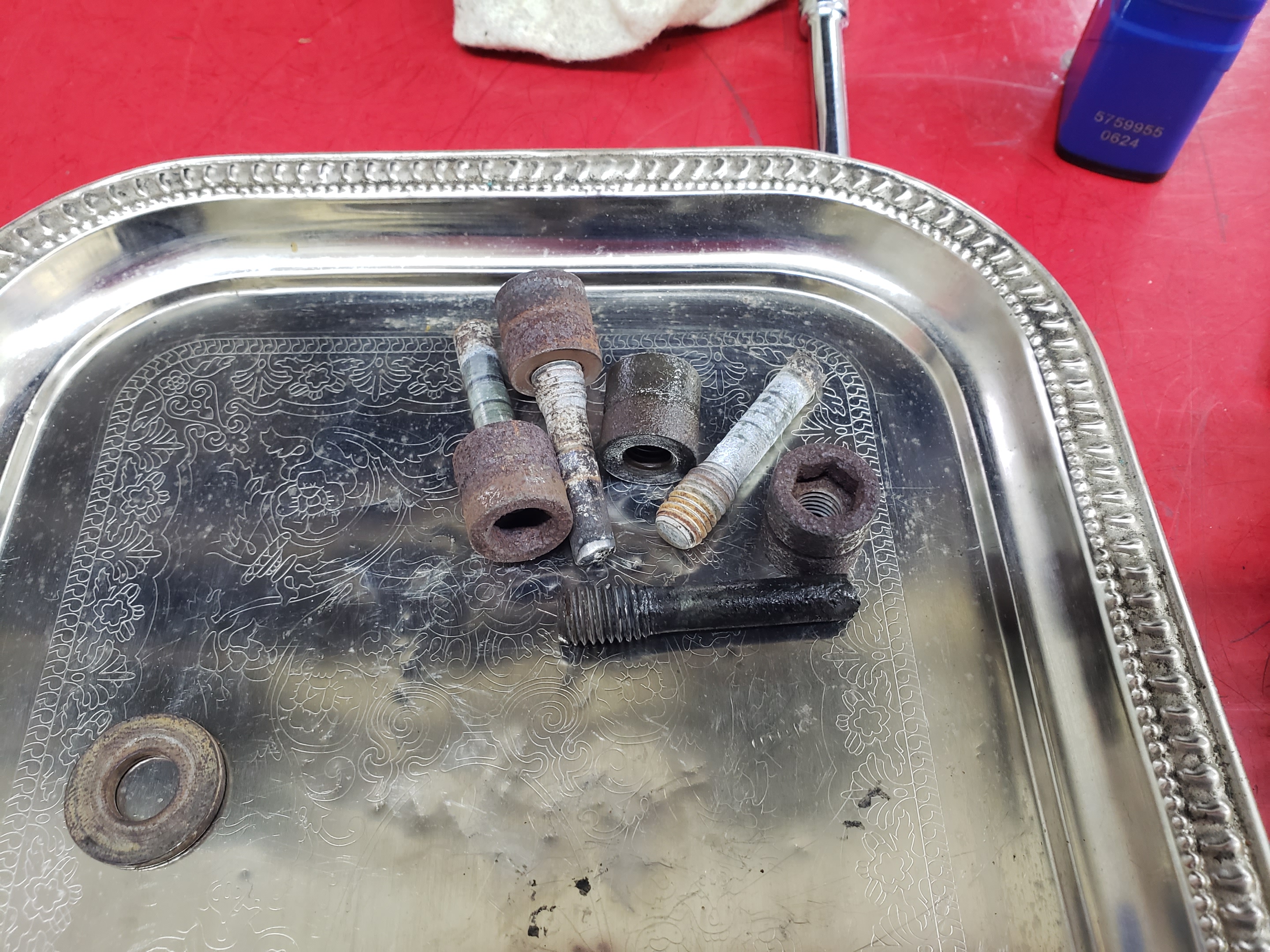

A few weeks ago I did oil and filter change on my 82 SC and also planned to check the valves. I started to remove the exhaust covers first. When I removed the right cover, something fell on the floor. It was a piece of a head stud.
Further investigation showed a few more.

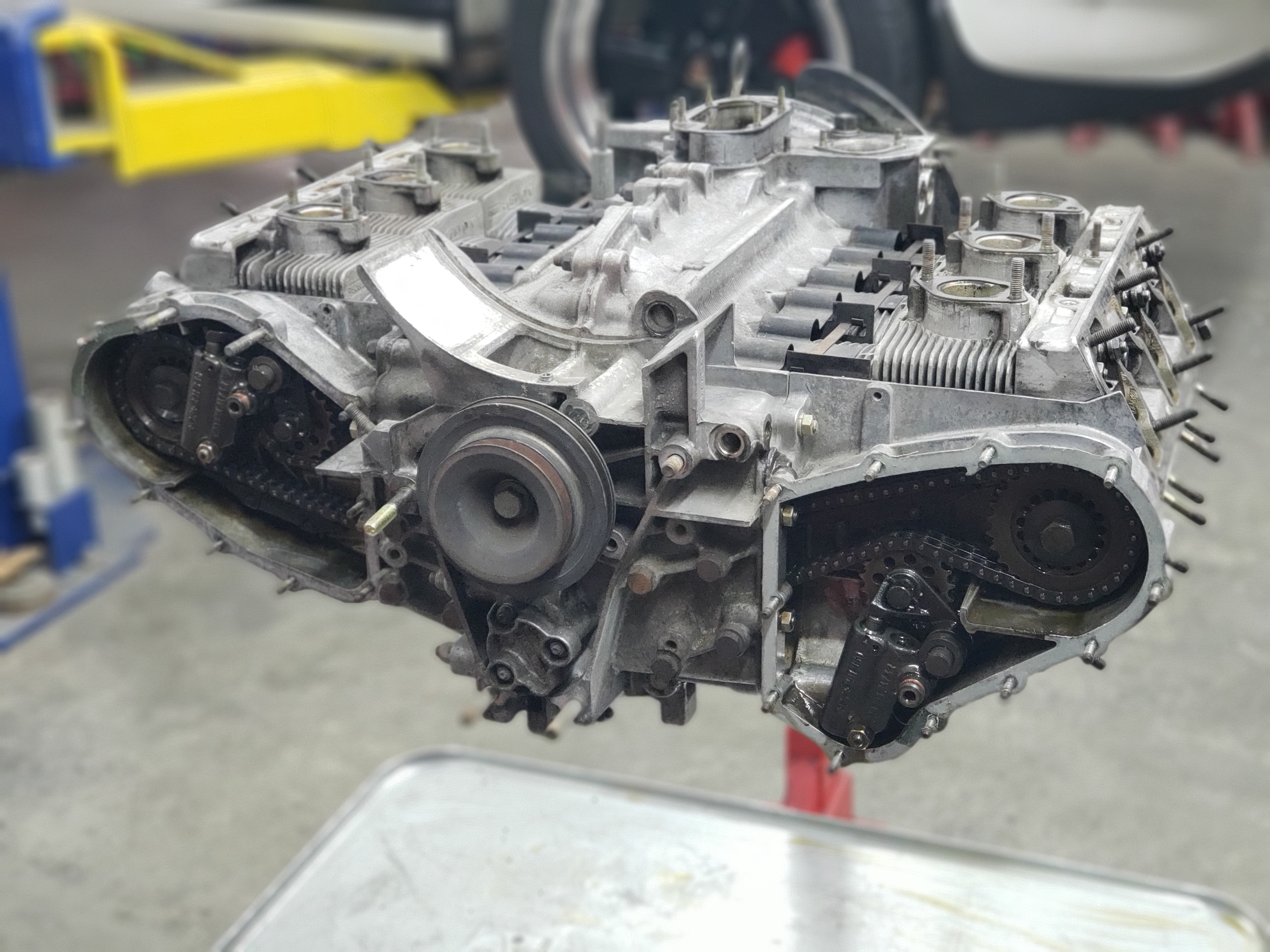

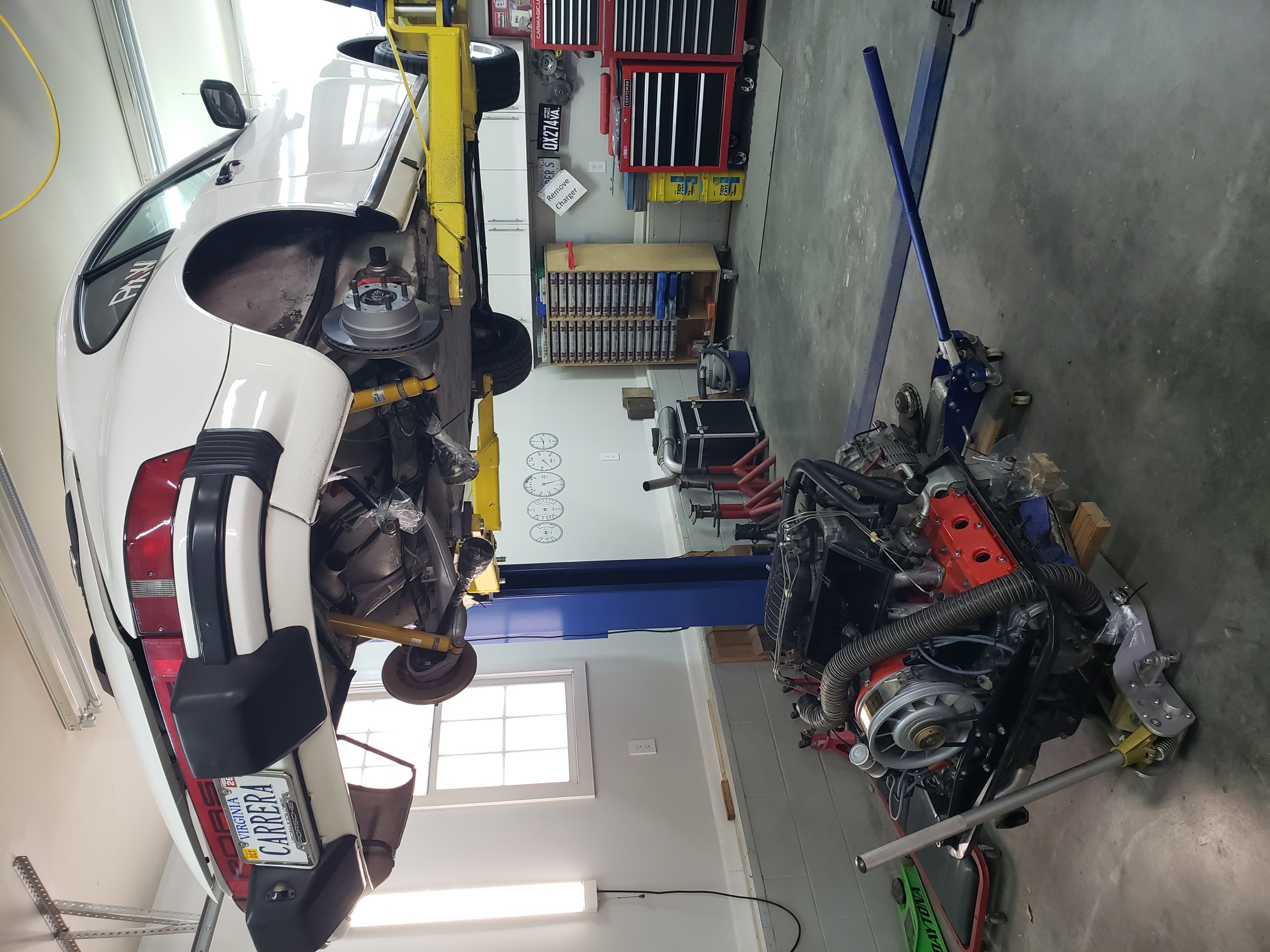

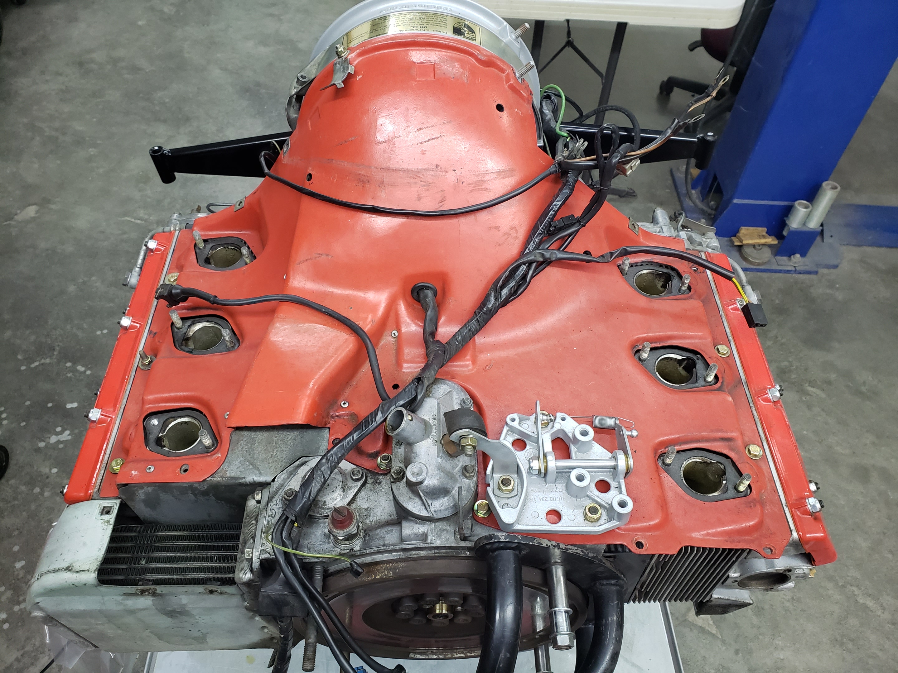

OK, here we go. A few hours later the engine was on the ground.
Disassembly can begin.
A few hours later.

Turkey timer style studs. They pop out when they’re ready (for service) 🦃

I admire your willingness and ability to just jump in and get it done without the usual drama. It's such a Godsend to have the skill, know-how, and equipment to pull a car apart so efficiently. Hoping you share the repair process in due course! Timeserts and Raceware studs?
The first Porsche I ever test drove to possibly buy was an 83 911SC -- it was a grey market Euro-spec car with higher compression and a performance chip. It felt great and I was ready to buy it, but the PPI revealed several pulled studs. You'd never know it driving the car -- it really pulled hard. I ended up getting a 3.2 Carrera at the time, in part because I was spoiled by the power of that SC. I briefly considered having the studs repaired but i was in no position to do that work myself at the time and paying a shop (Bob Grigsby) made the car too expensive overall for what it was -- and Bob pointed out the compression and tune would never be happy with our CA gas. :(

Hopefully the remainder of the studs don't fight on the way out and time-certs are not needed.

Continue on the engine.
Got it all disassembled.
I found 2 of the outer valve springs broken.
Eight of the 12 exhaust studs in the heads had to be drilled out.
