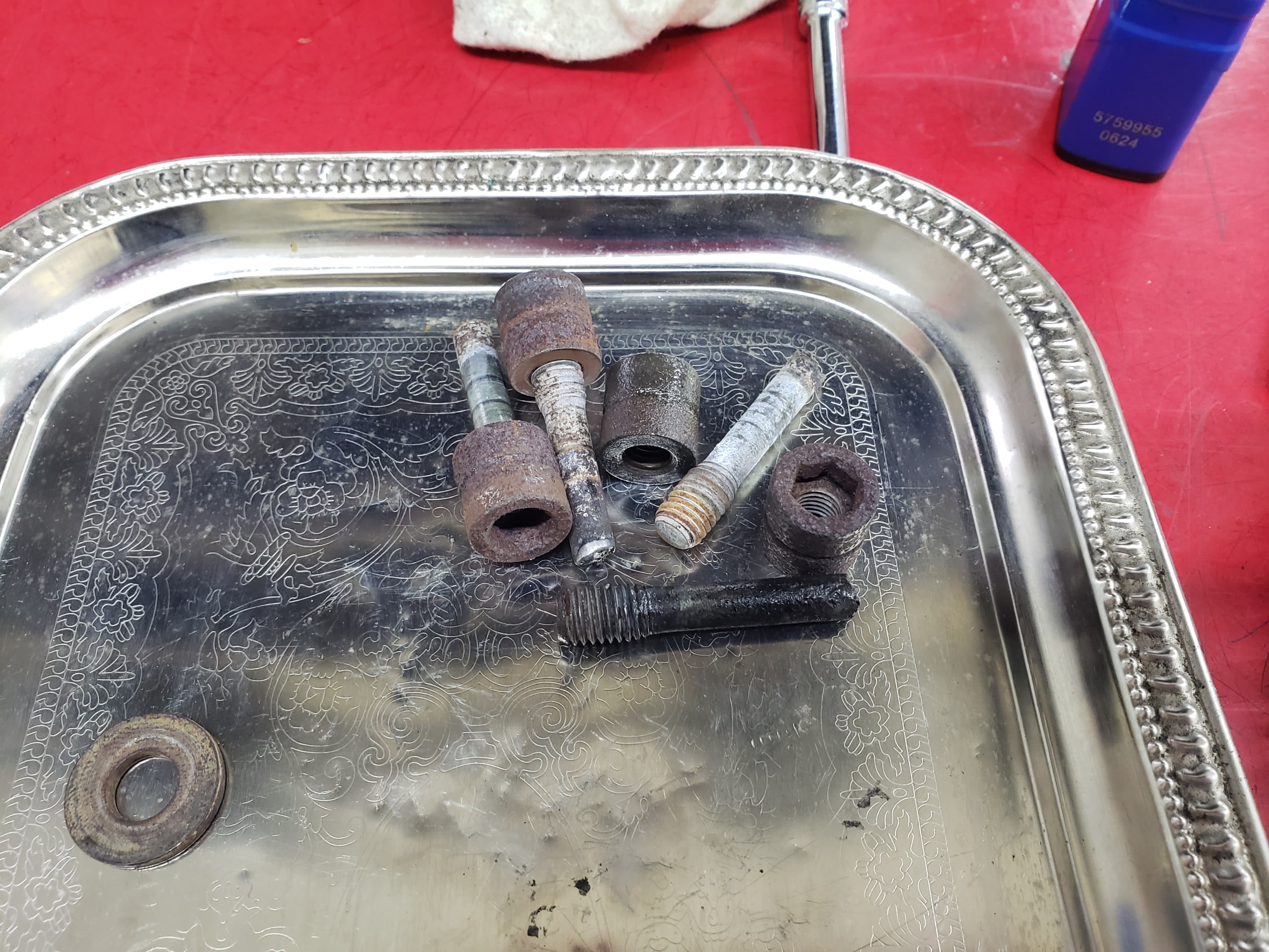

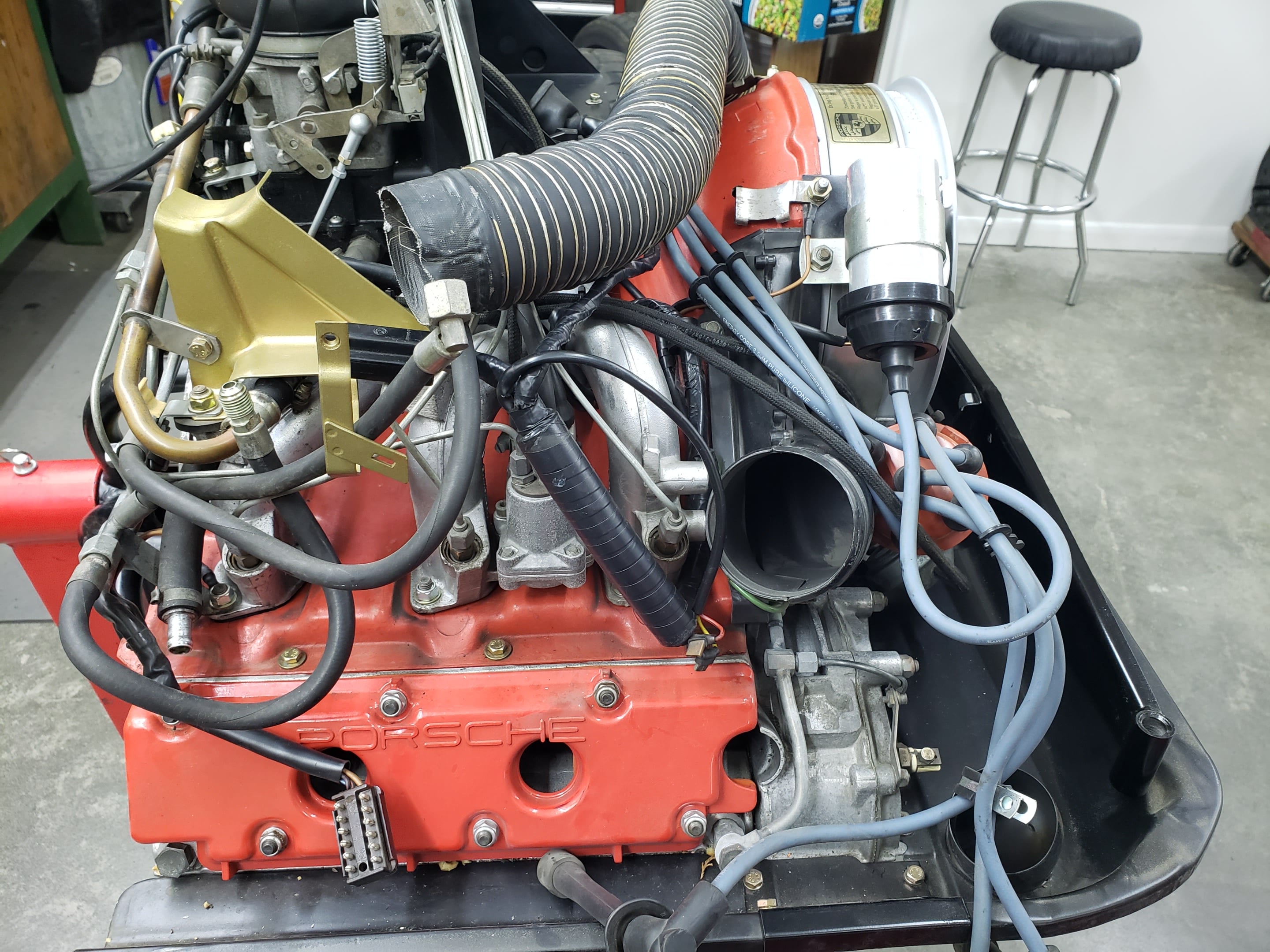

A few weeks ago I did oil and filter change on my 82 SC and also planned to check the valves. I started to remove the exhaust covers first. When I removed the right cover, something fell on the floor. It was a piece of a head stud.
Further investigation showed a few more.

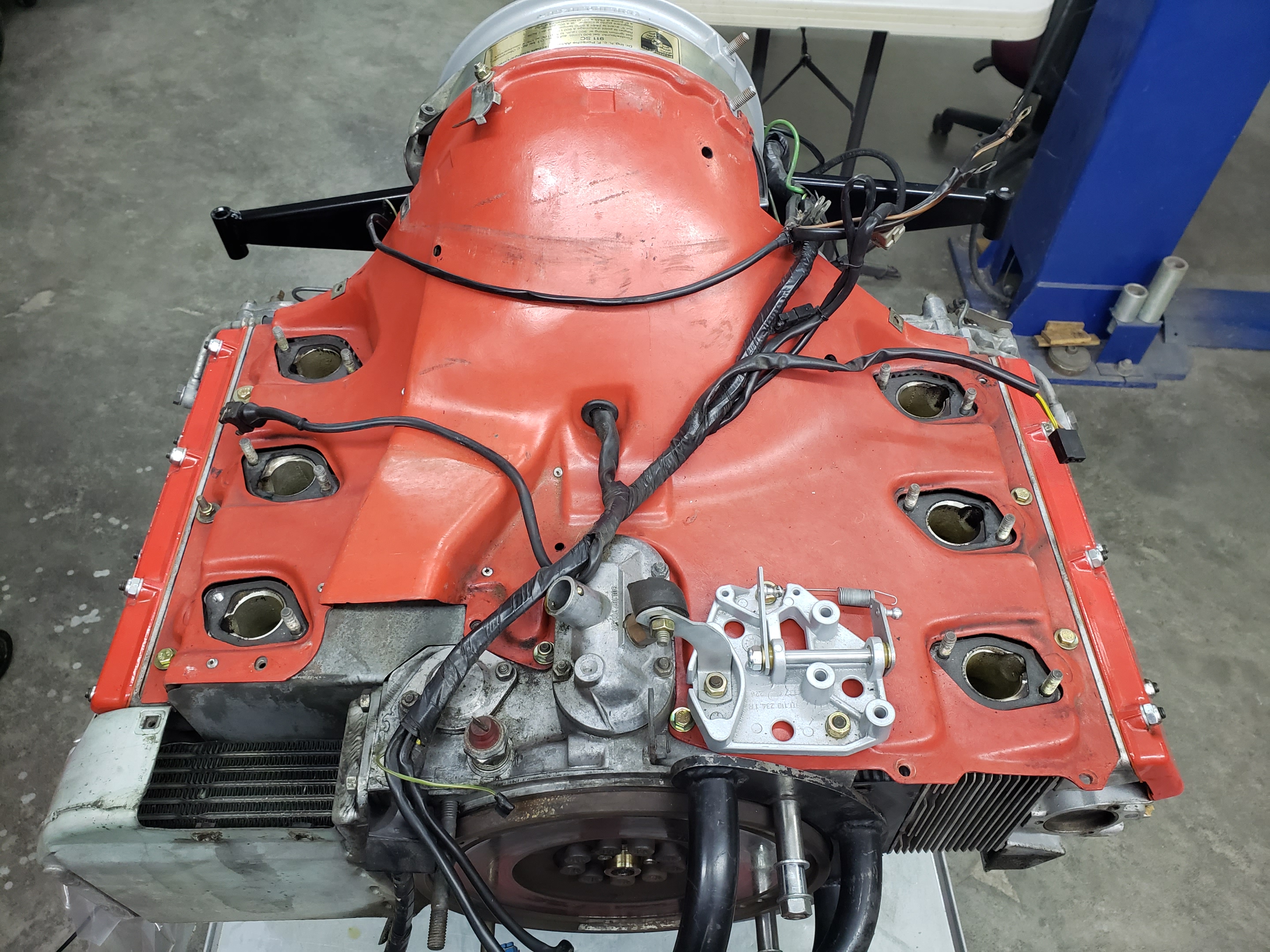

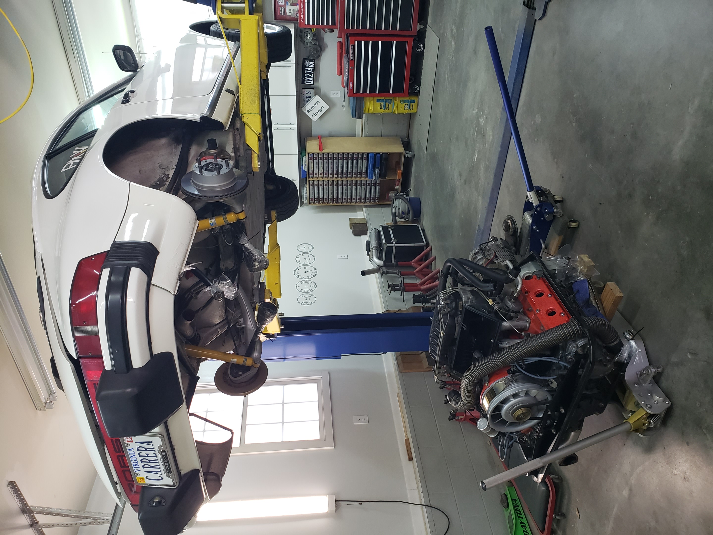

OK, here we go. A few hours later the engine was on the ground.
Disassembly can begin.

Turkey timer style studs. They pop out when they’re ready (for service)

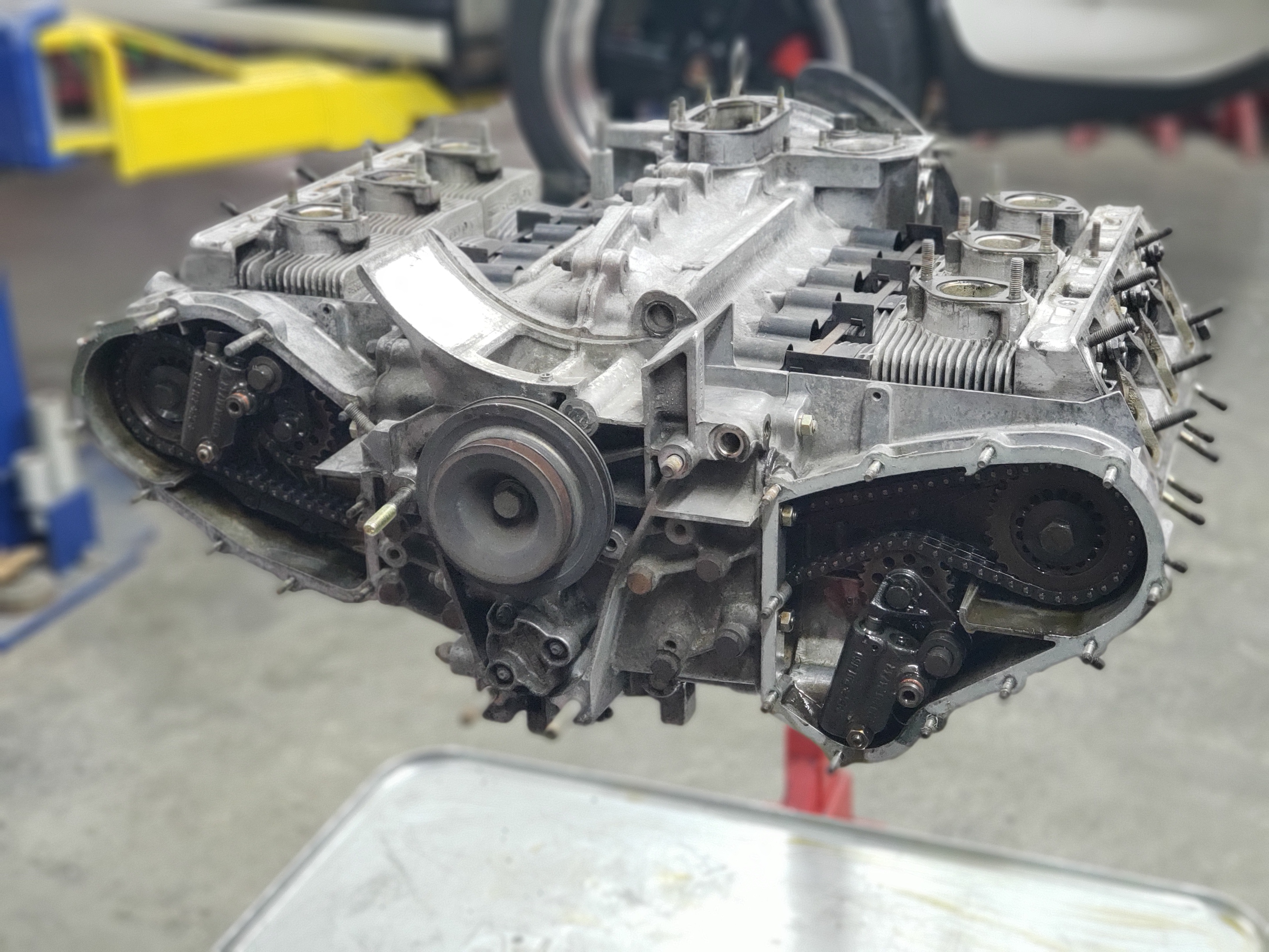

Continue on the engine.
Got it all disassembled.
I found 2 of the outer valve springs broken.
Eight of the 12 exhaust studs in the heads had to be drilled out.
This tool makes it a lot easier to drill them out.
All cleaned and ready for rebuild with new guides, valves and springs.
Got some other parts cleaned up as well.
Cheers
Engelbert
