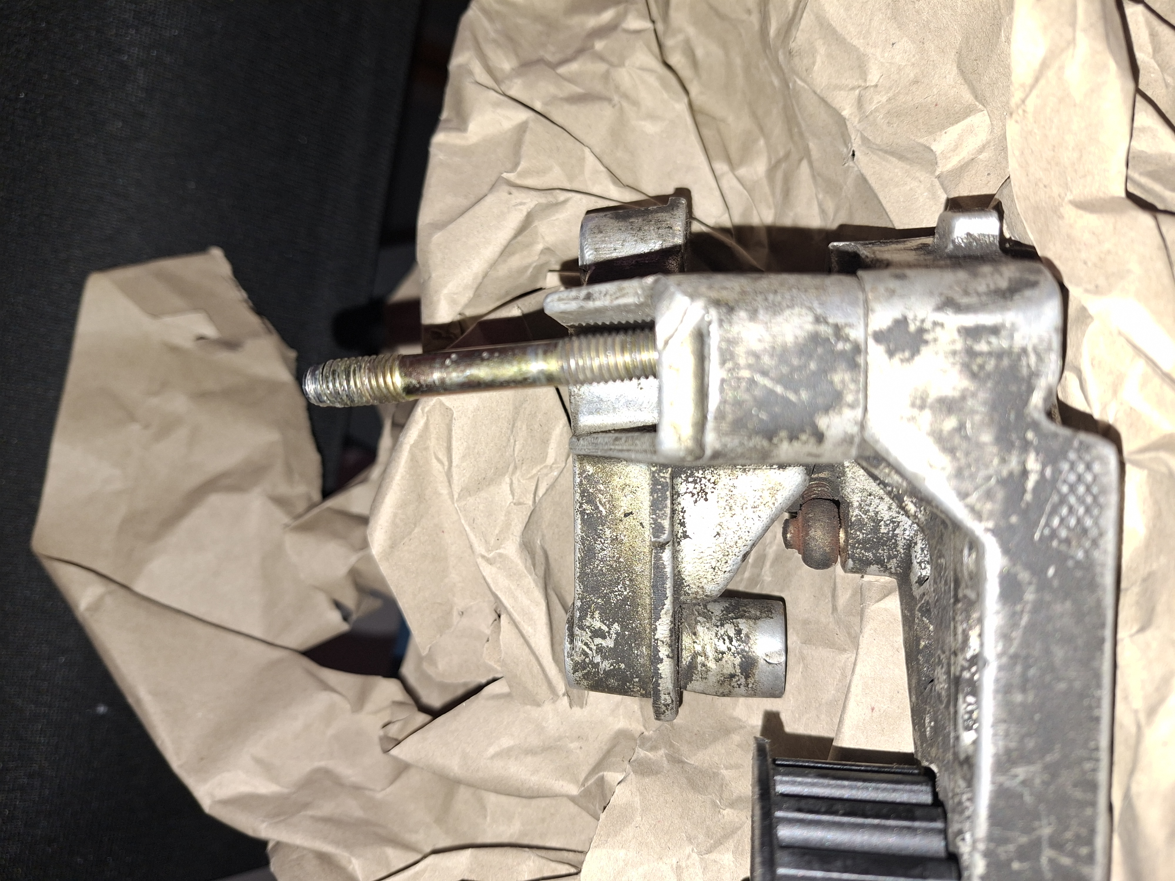

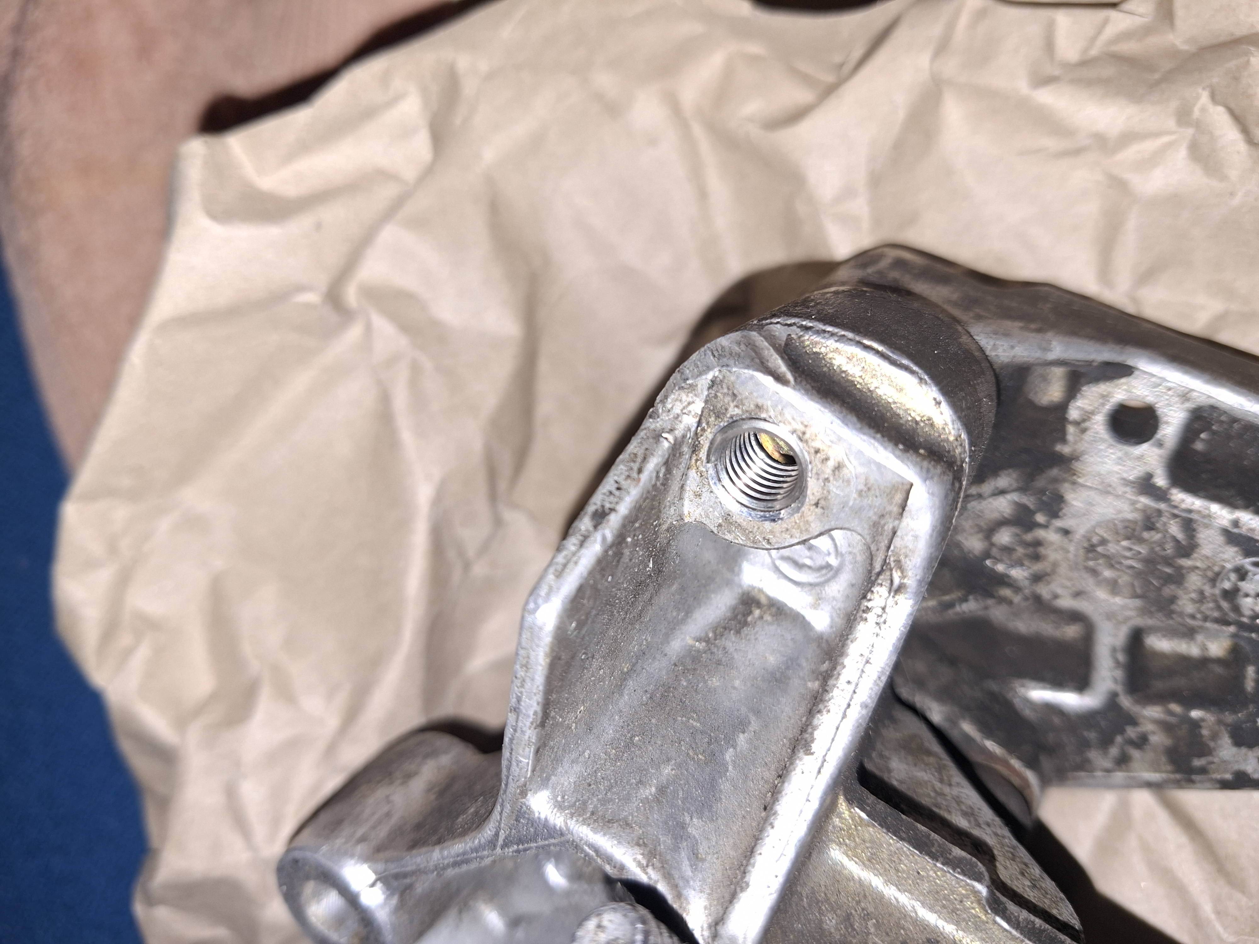

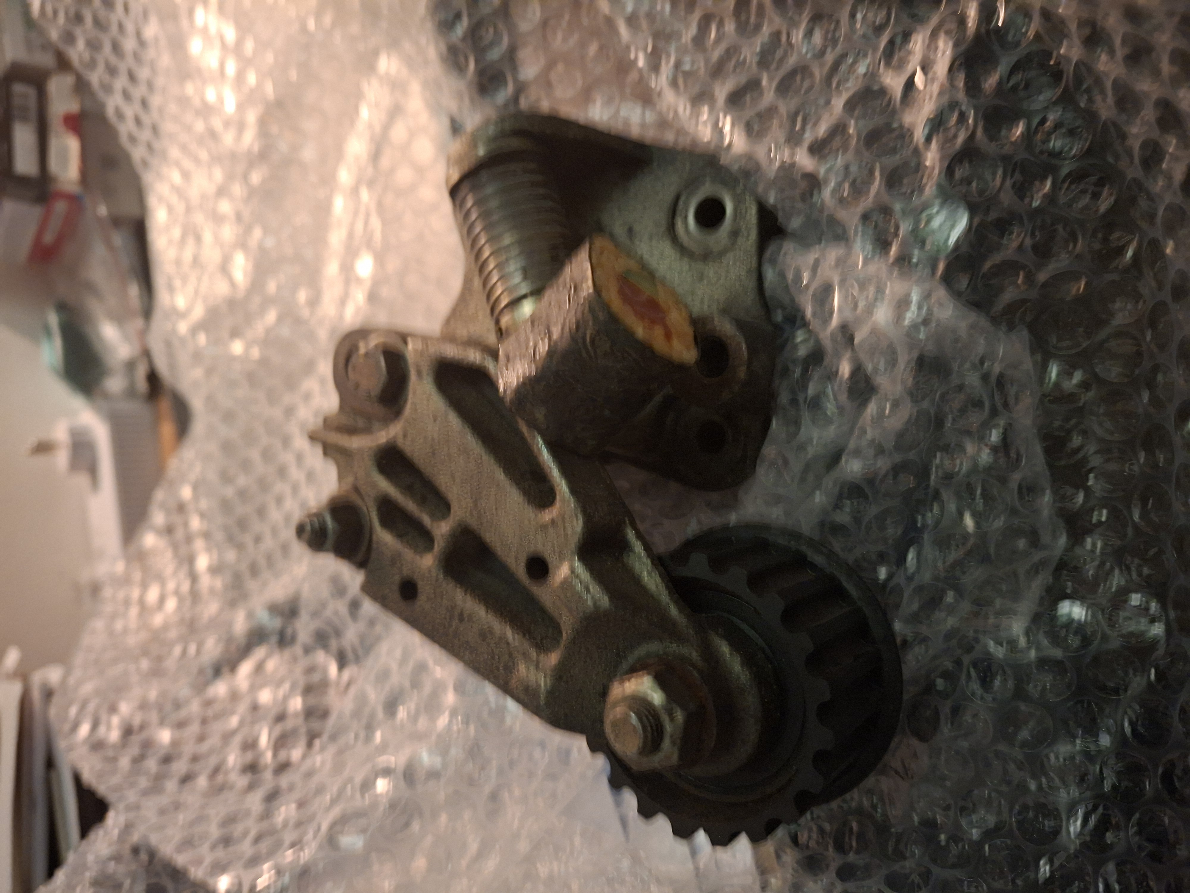

Iron tensioner? Have a picture of the one you say is iron? Does a magnet stick to it? I've never seen one made of iron, so I'm intrigued. :) For the life of me I have no idea how those threads get stripped. Makes no sense to me. Only thing I can guess is that people are wildly over tensioning the pivot nut -- but even that seems unlikely. I almost wonder if the factory helicoiled those threads for added strength and they sometimes pull loose when loosening the nut? Interesting that you came across a stripped one -- the one in the wall of shame is the only stripped one I've ever seen. In the grand scheme of what's reliable and what's not, I wouldn't worry about the spring tensioner being fault prone.

Here's a "2nd gen" Iron tensioner with a "sushi roll" magnet stuck to it

That's one of the iron tensioners I have with a "Sushi maki" magnet stuck to it...

Here's the heli-coil repaired alloy one i returned to the seller.

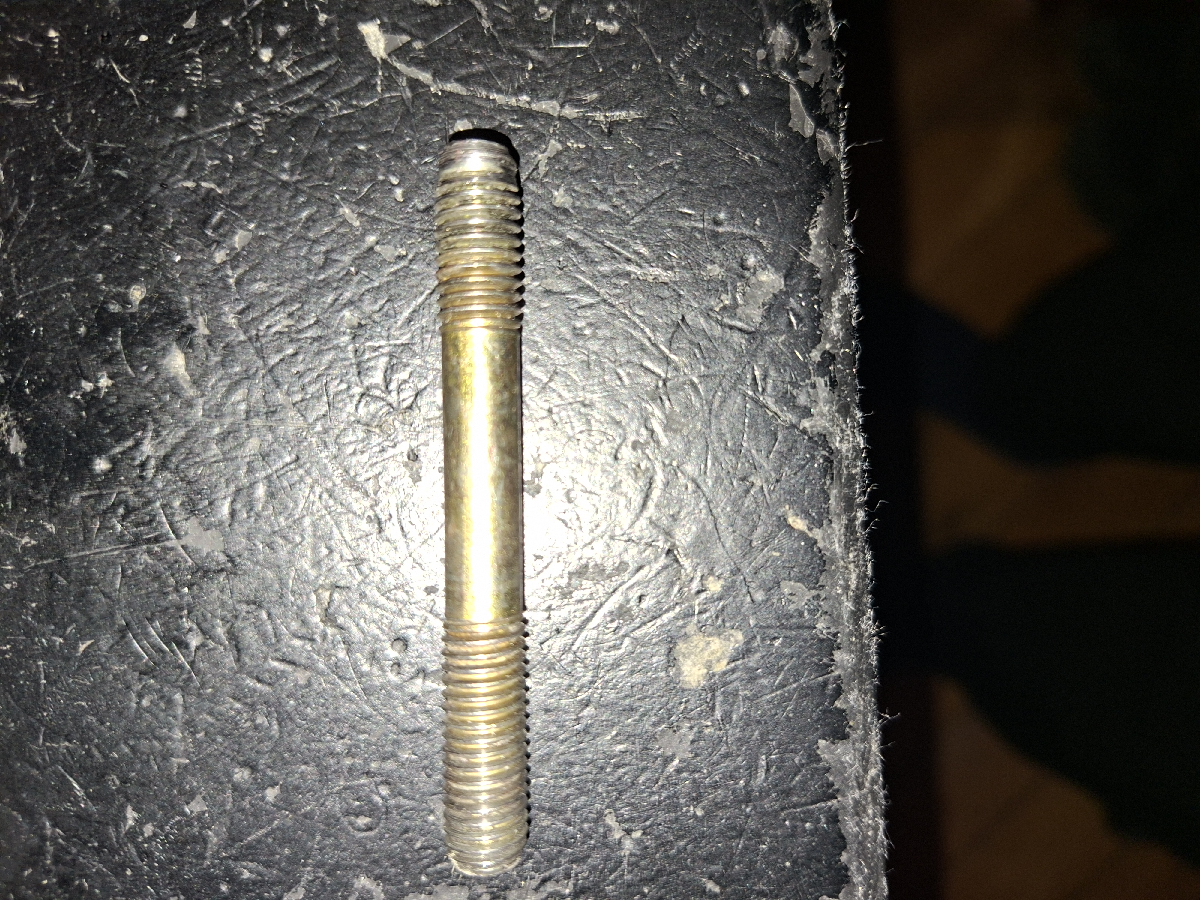

The stripped stud and a photo of the good side of the stud screwed in from the back, showing the heli-coil was not straight. The heli-coil was inserted from the back, and the tang was removed, but it wouldn't thread properly from the front side, so it looks like a previous owner/repairer just hammered the stud in until it stuck. When I got it, it was doing the "bobble thing" you described in your Wall of Shame post.
