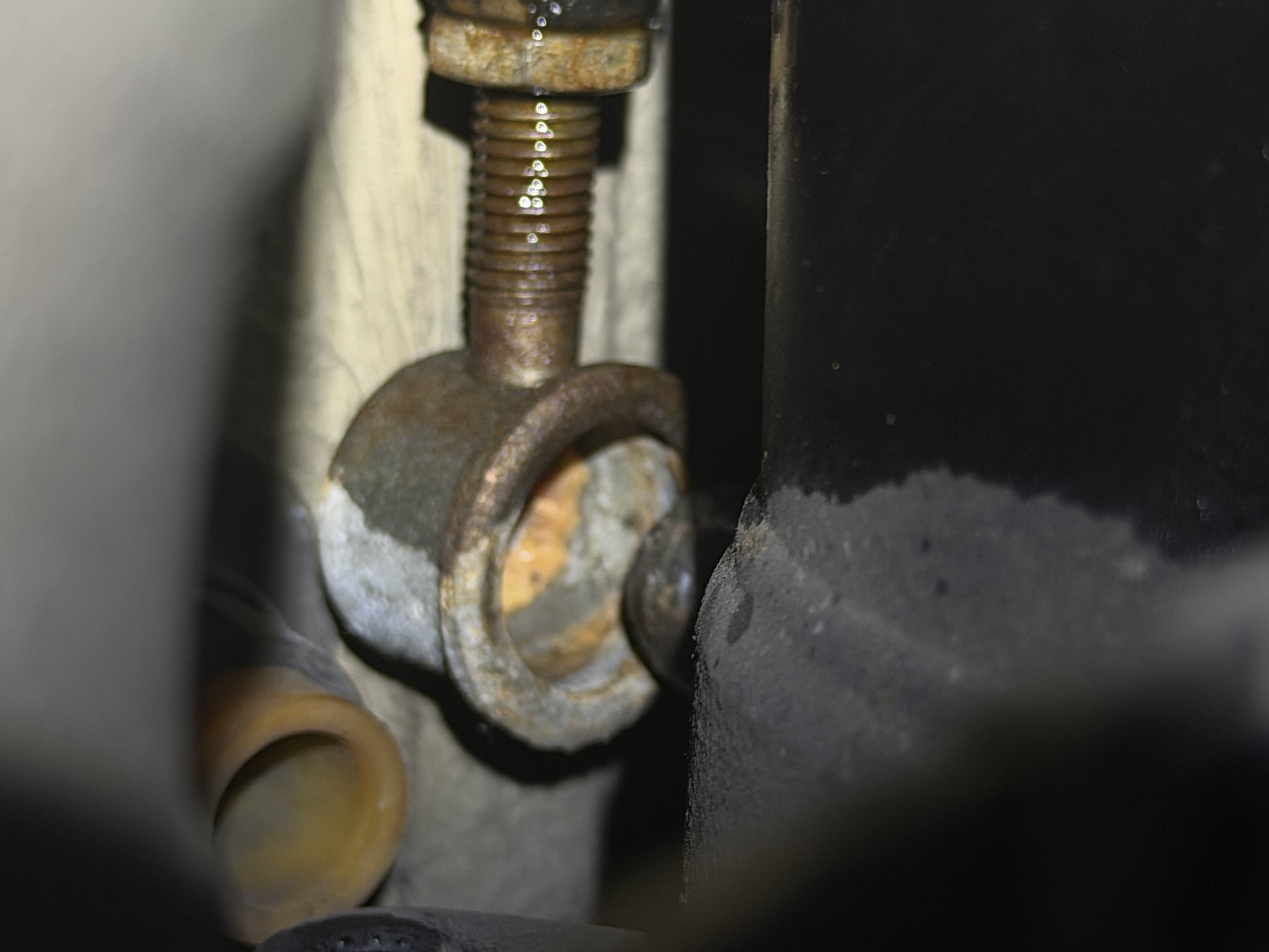

I just acquired this 928 and started with fluid changes and went to the shifter couplings as the shifting was quite poor. I was able to get the rear done even though the conical screw was a beast..
I have taken off the exhaust/heat shields/cross member and taken off the old coupler that was without any bushing inside.
Initially I was going to replace the old housing with a new (white) insert, but then also bought the new Porsche angular joint 928-424-005-01.
I placed it back to the same number of turns back in.
the problem I am having is getting the thing to pop back on..
in my searches I found that people have used a "Stanley wrecking bar" , ratchet straps, freezing the coupling before, or screwdrivers /pry bars...
I am in the northeast so I figured the garage is already pretty darn cold... but maybe ill try this on the next one..
I was able to get it pretty close with the ratchet strap with a wood block under the torque tube, but would always slide a bit to the side... I had the shifter connected to reduce play..
but after some spirited ratcheting I even noticed the coupling was becoming bent...
Any other tips/recs/pics /videos would be greatly appreciated... I have searched extensively but wanted to see if anyone here has some insight...

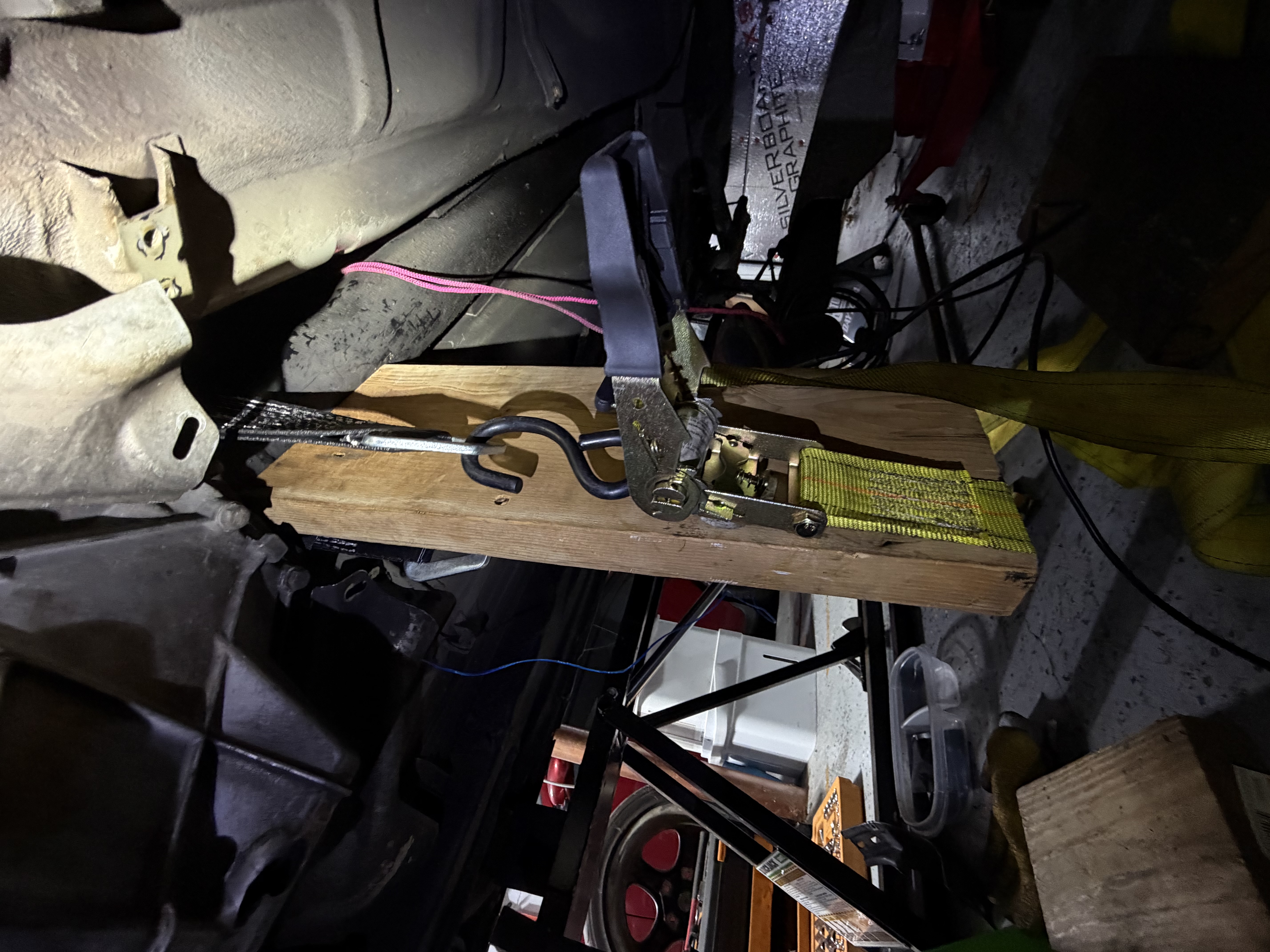

The D ring axle strap recommendation I think helped greatly too. When I tried without it I think the ratchet strap caused more twisting (it could have been just in my mind ). But I also realized I would not have been able to slip out the ratchet straps like the d ring strap was able to slip over the guide tube.

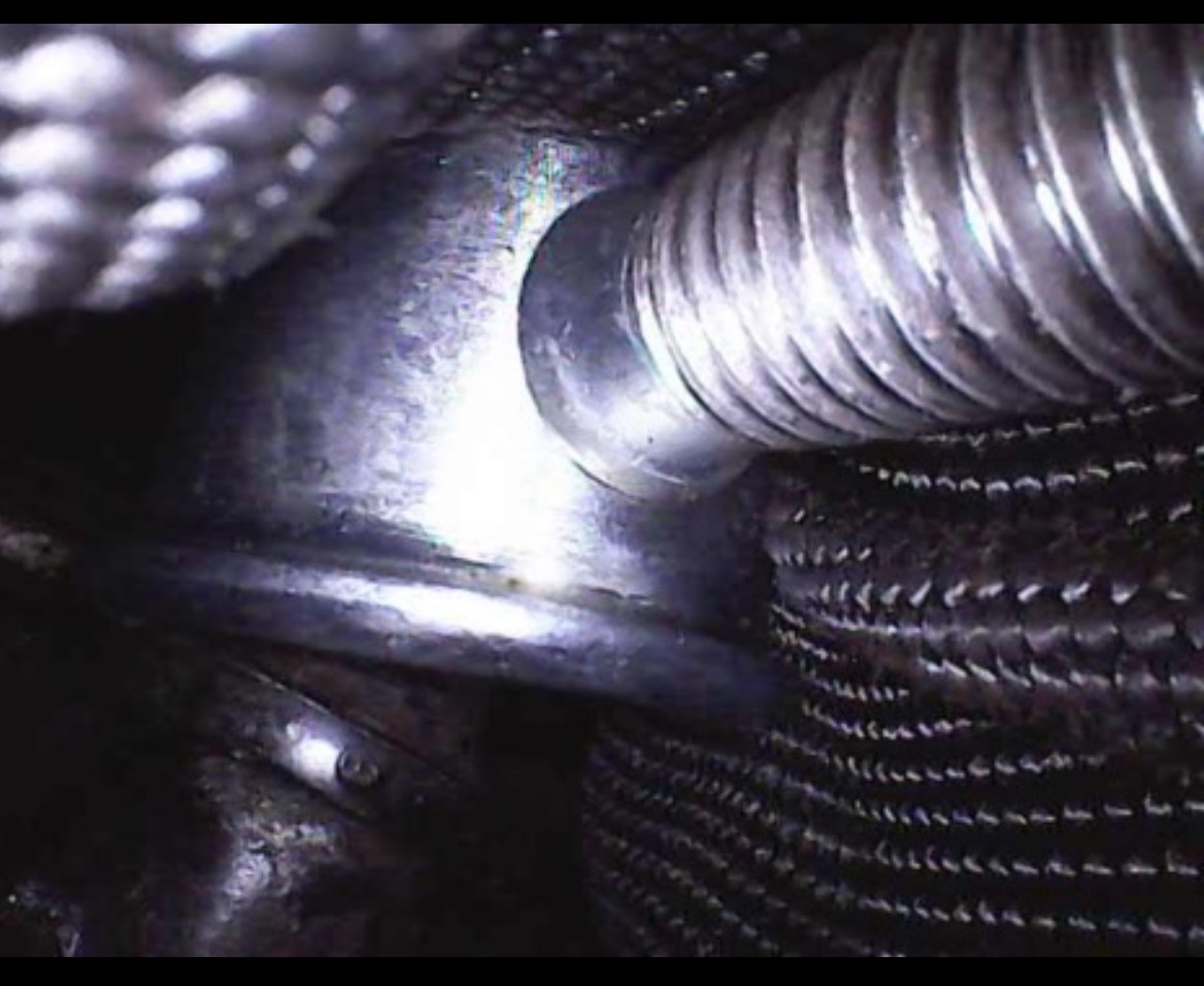

I tried with the long wrecking bar 4ft but it was harder for me to get a feel of if I was on the right track. The ratchet strap with checking with an endoscope to confirm the position of the cup at least helped me see if I was on the right track.
This was my setup that worked for me :
I ended up doing it without grease, in my mind it caused more slippage but who knows.
In the end I think as I mentioned above just having it lined up and tightened down so the cup would not turn more with ratcheting pressure was the key for me.
