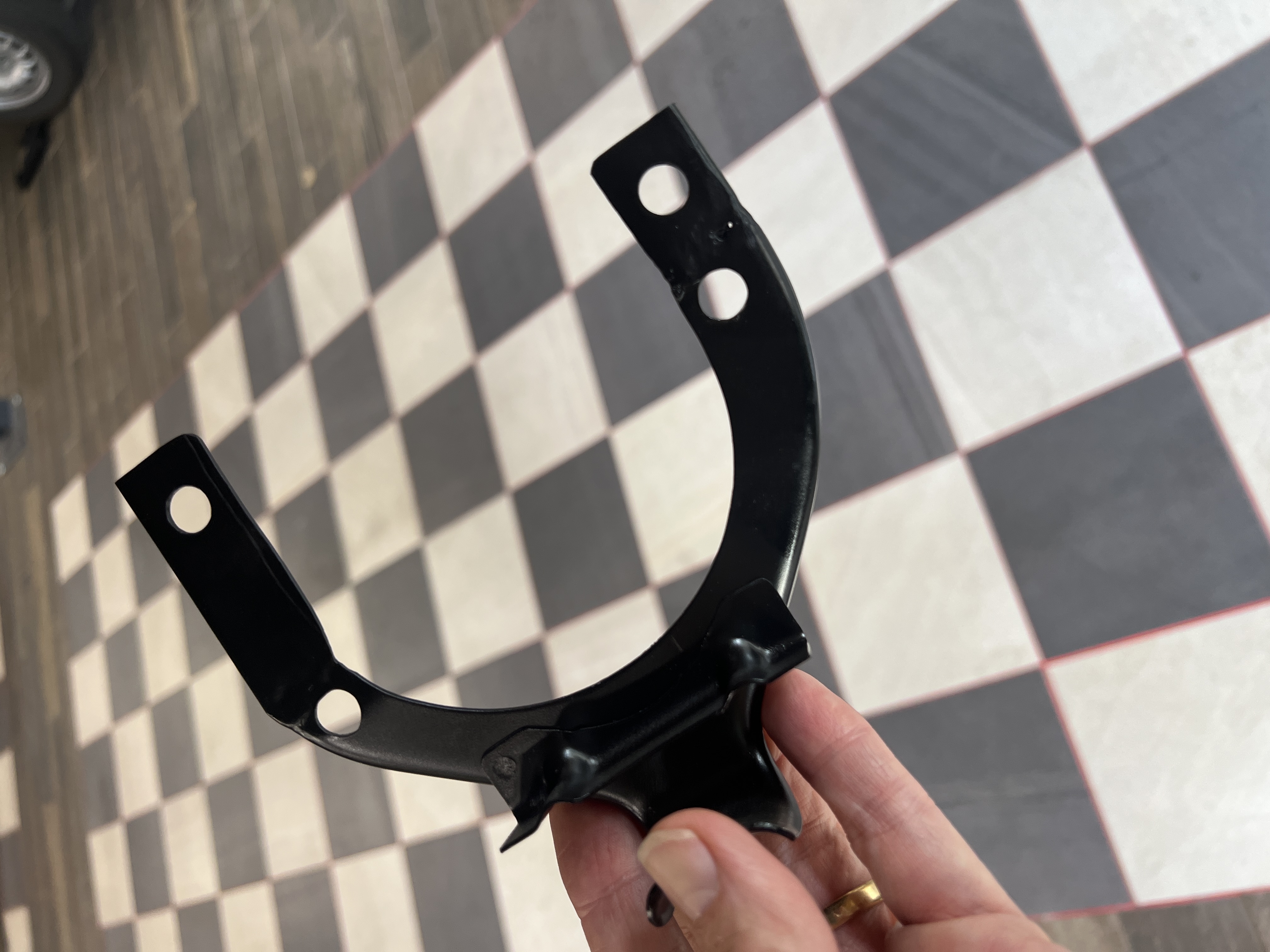

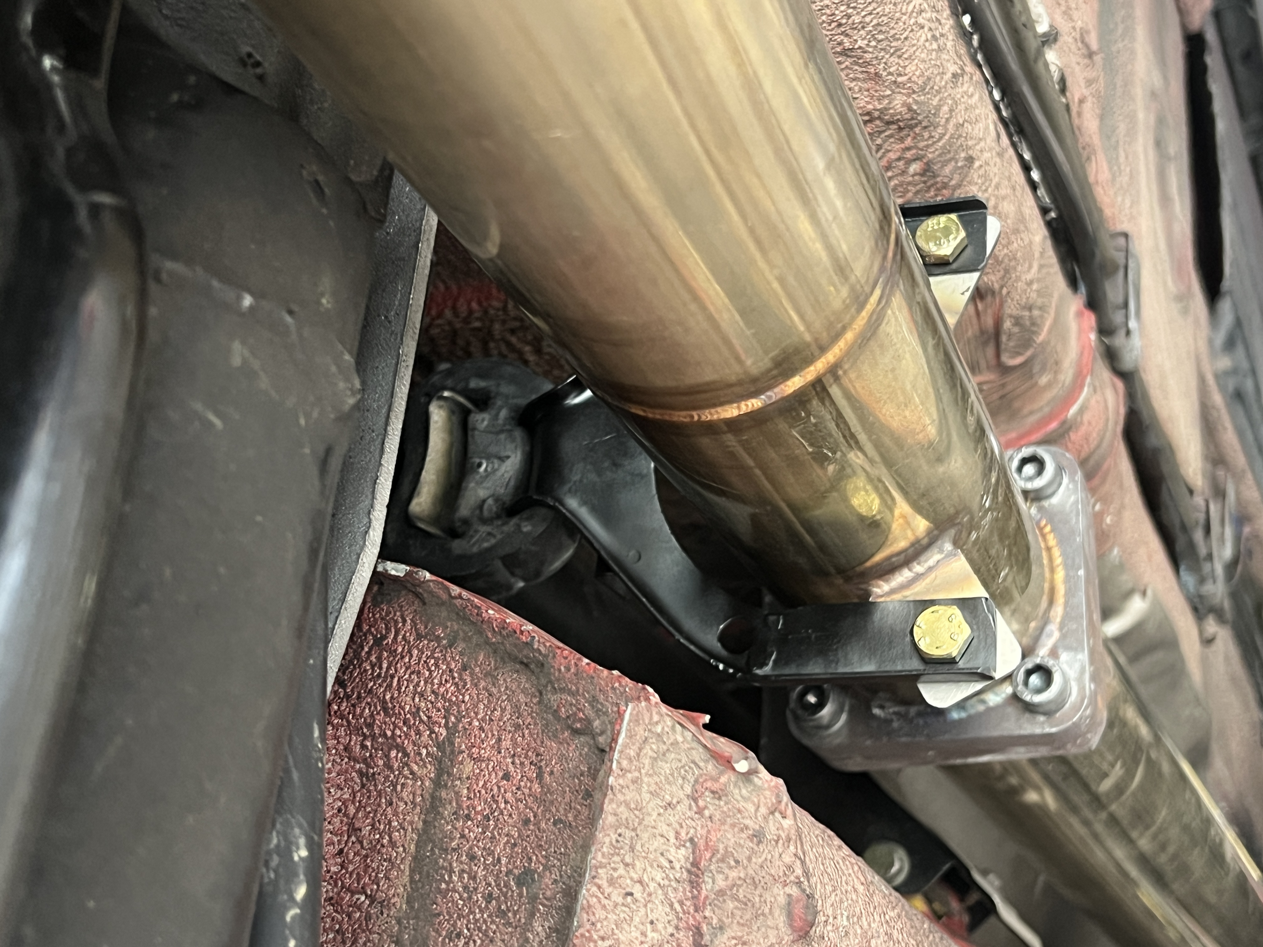

This discussion got me thinking about my exhaust hangers.The SFR cat-back pipe has hanger tabs that were welded on in the wrong direction. :lol: Earlier attempts to use standard exhaust donuts kept failing, so my exhaust has been held on by being bolted to the motor up front, and the one factory hanger at the very rear. I thought about removing the muffler and fixing the hanger tabs, but came up with a lazier solution by modifying the hanger to reach the hanger tabs. It seemed to work, and even eliminated a little exhaust vibration rattle I'd get on cold start up. Long overdue!

Funny you say that. The hangers on the Fabspeed were "sort of" in the right space at the more forward location. I had to drill a new hole in my hanger to compensate for one side being off.
