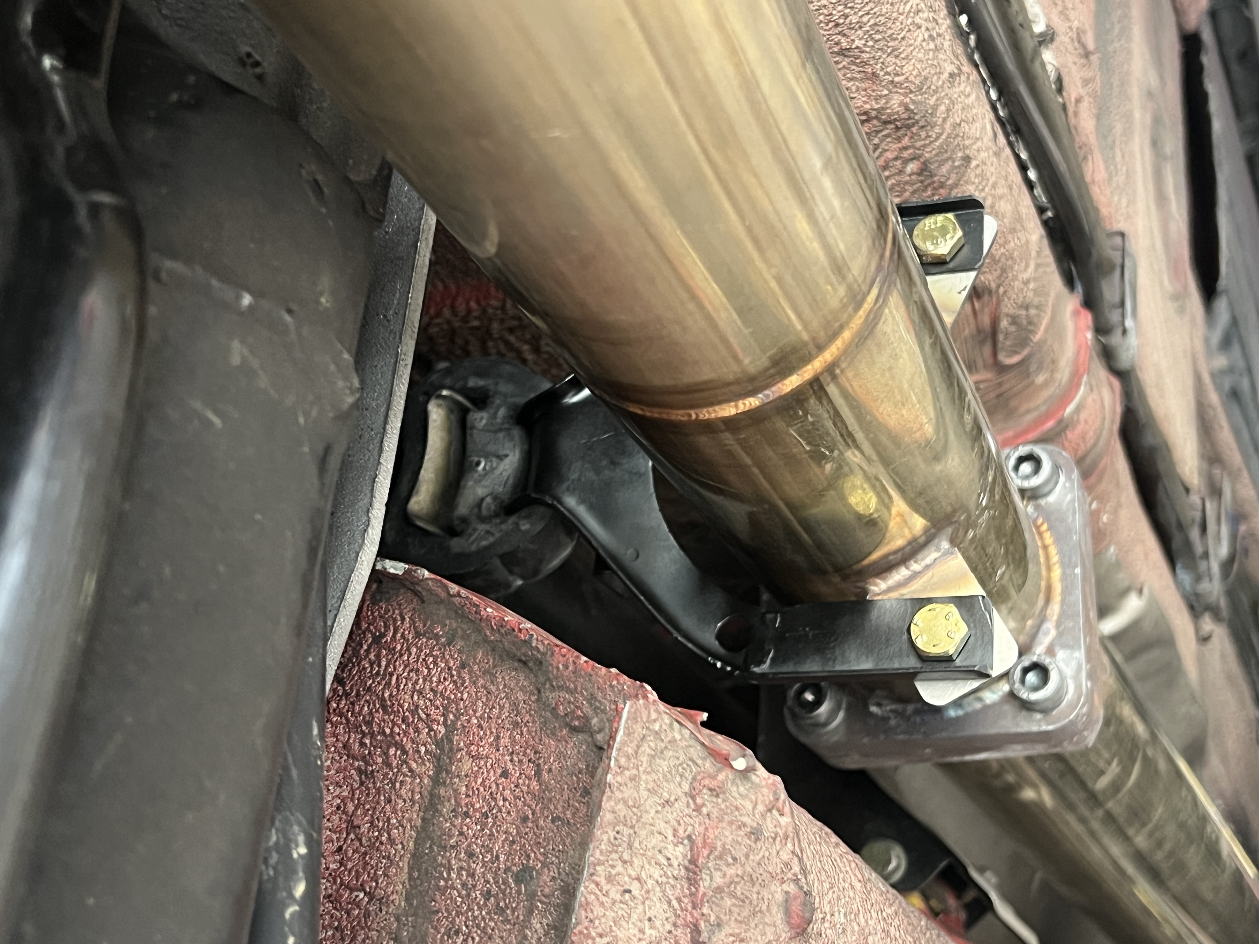

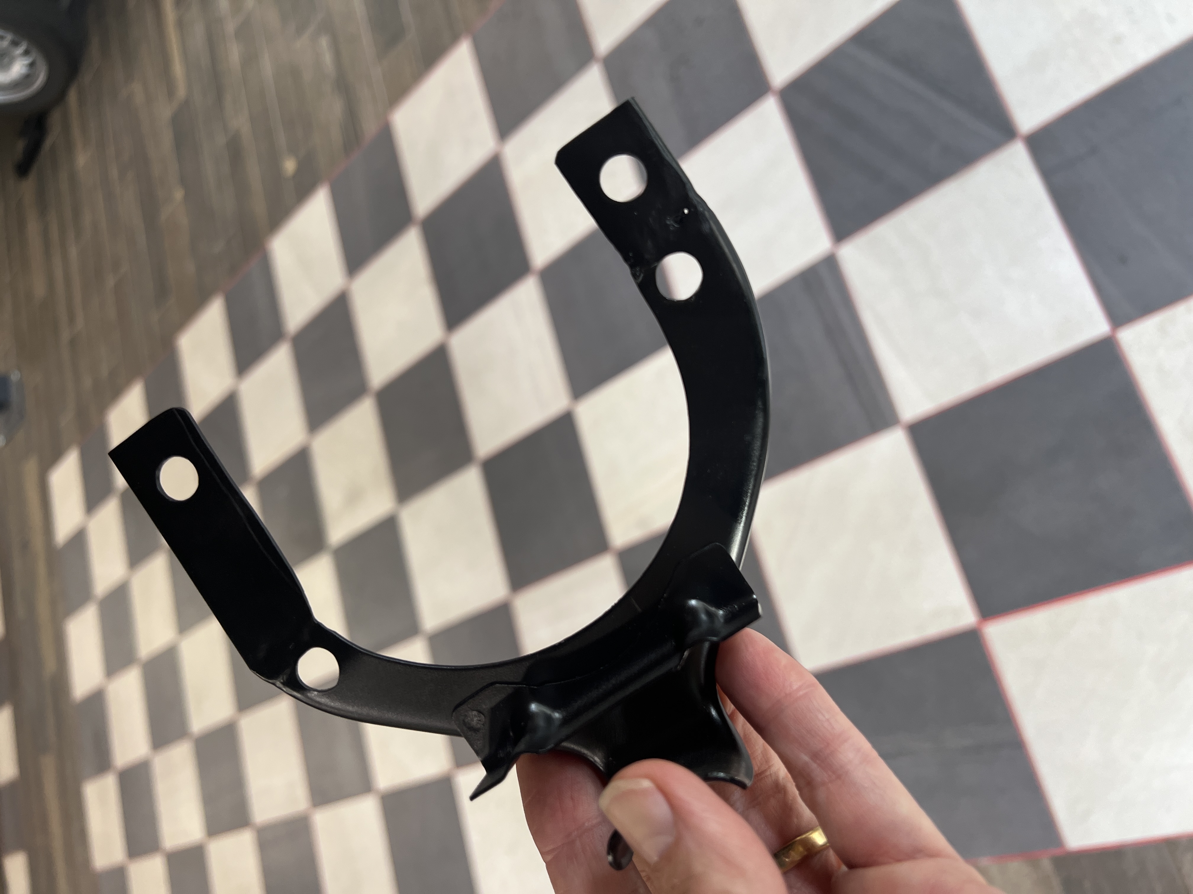

This discussion got me thinking about my exhaust hangers.The SFR cat-back pipe has hanger tabs that were welded on in the wrong direction.Tom wrote: Tue Sep 16, 2025 7:37 pm My 3" downpipe rubbed through the heat-shield. Spoiler alert, they don't really fit without some extra effort, despite what those selling them say...
viewtopic.php?t=157&hilit=heat+shield#p904
I often worried about my Tial just hanging there off the crossover and dump tube pipes. For the longest time I had intended to make some kind of support but never got around to it, and the longer I ran it without the support, the less I worried about it. If I had to guess, I'd say it's been on there 20 years or more...

Funny you say that. The hangers on the Fabspeed were "sort of" in the right space at the more forward location. I had to drill a new hole in my hanger to compensate for one side being off.
