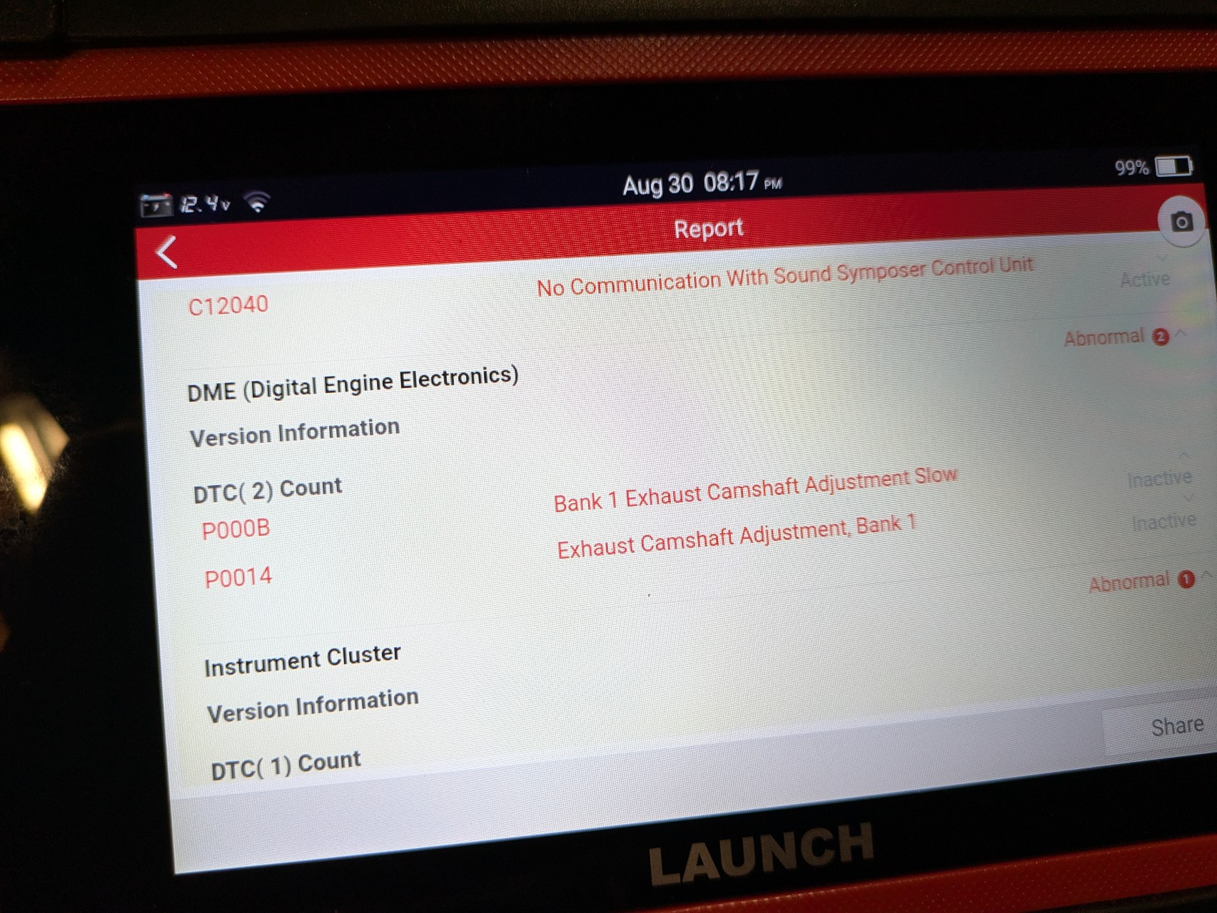

The plot thickens - This is worrisome: P000B and P0014 was stored in the computer. It's Bank 1, which is the same "louder" right hand side. I have ordered new cam sensors and a solenoid. AND and oil report for my latest 5K mile change.

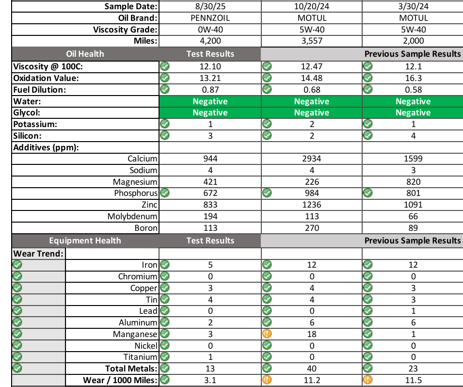

Oil report back and nothing is showing any wear - AND the wear rate dropped from when I was running Motul 5W40.
I went on a pretty long 300 mile road trip and a couple of canyon drives and the code has not returned.
I plan to swap out the sensor and the solenoid for bank 1 "the next time I'm in there"
** the Manganese was from fuel additives for track days

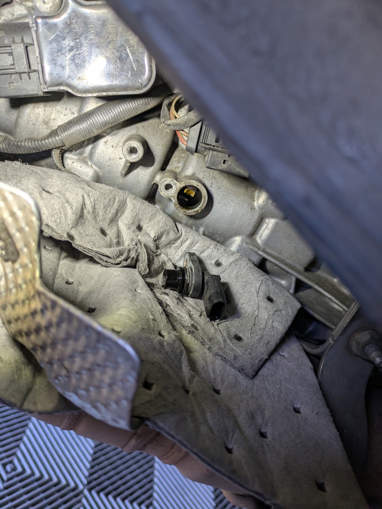

Update: I did some more investigation of the codes and it brings up two possibilities:
Camshaft Adjuster Solenoid - Part #: 0PB-109-259-C-M36
Camshaft Position Sensor - BOSCH 94660610600
The Solenoid was under $50 and the Bosch sensors are cheap.

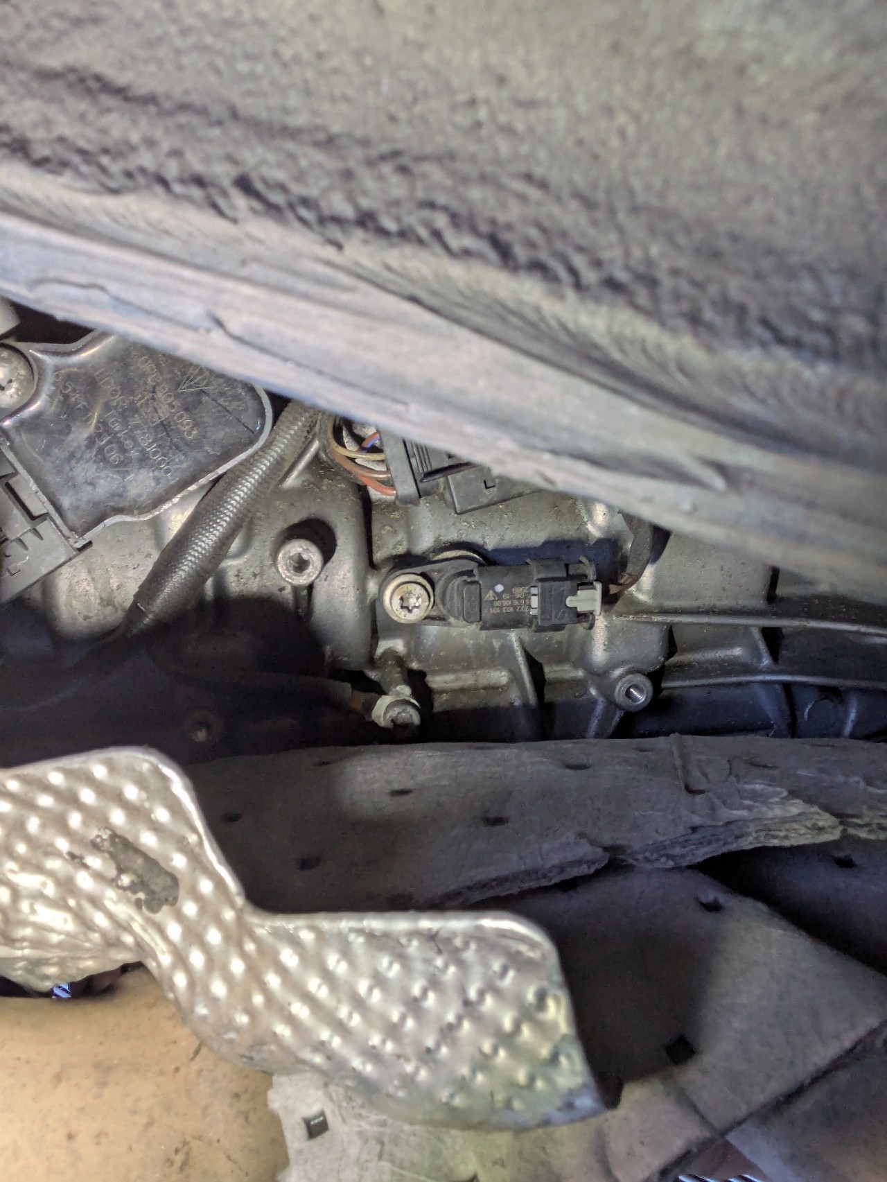

Some of the track day guys report that the cam sensor gets absolutely cooked by the turbo exhaust and I can see that. It's located just below the coil packs on the passenger side bank 1.
I started by replacing the sensor and I haven't had the code or "extra" noise on cold starts for a month + now.
If I have to replace the solenoid, it's very similar to the location of the water pump (just above it to the left). Not great, but totally doable with quick-jacks and time.
