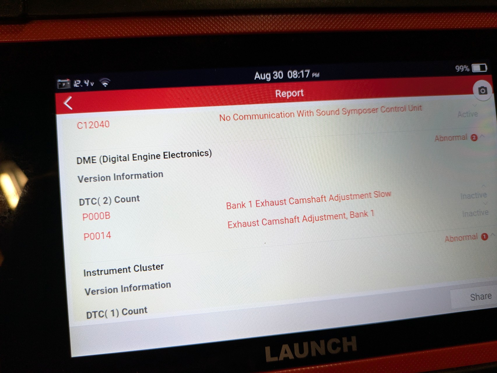

The plot thickens - This is worrisome: P000B and P0014 was stored in the computer. It's Bank 1, which is the same "louder" right hand side. I have ordered new cam sensors and a solenoid. AND and oil report for my latest 5K mile change.

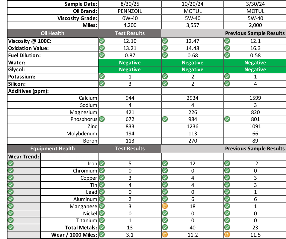

Oil report back and nothing is showing any wear - AND the wear rate dropped from when I was running Motul 5W40.
I went on a pretty long 300 mile road trip and a couple of canyon drives and the code has not returned.
I plan to swap out the sensor and the solenoid for bank 1 "the next time I'm in there"
** the Manganese was from fuel additives for track days

The Pennzoil Synthetic is made from natural gas and the claim of running cleaner would seem to get an endorsement from your test. I sold vehicles for over 30 years and there are so many cars/trucks that rattle or sound noisy at start up I would definitely note it is not just a Porsche concern as you mention. In almost all cases it is just normal and once warmed up things are fine. That said you have codes so that is always something, imho, that should be checked/diagnosed by a Dealer.

Update: I did some more investigation of the codes and it brings up two possibilities:

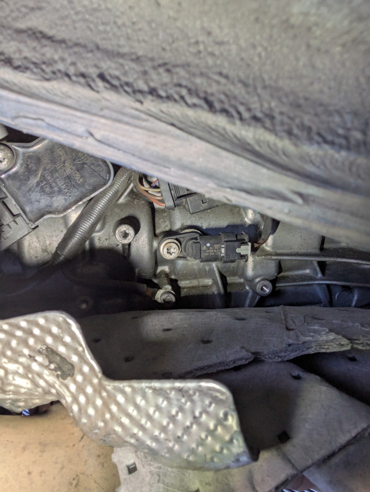

Some of the track day guys report that the cam sensor gets absolutely cooked by the turbo exhaust and I can see that. It's located just below the coil packs on the passenger side bank 1.
I started by replacing the sensor and I haven't had the code or "extra" noise on cold starts for a month + now.
If I have to replace the solenoid, it's very similar to the location of the water pump (just above it to the left). Not great, but totally doable with quick-jacks and time.
