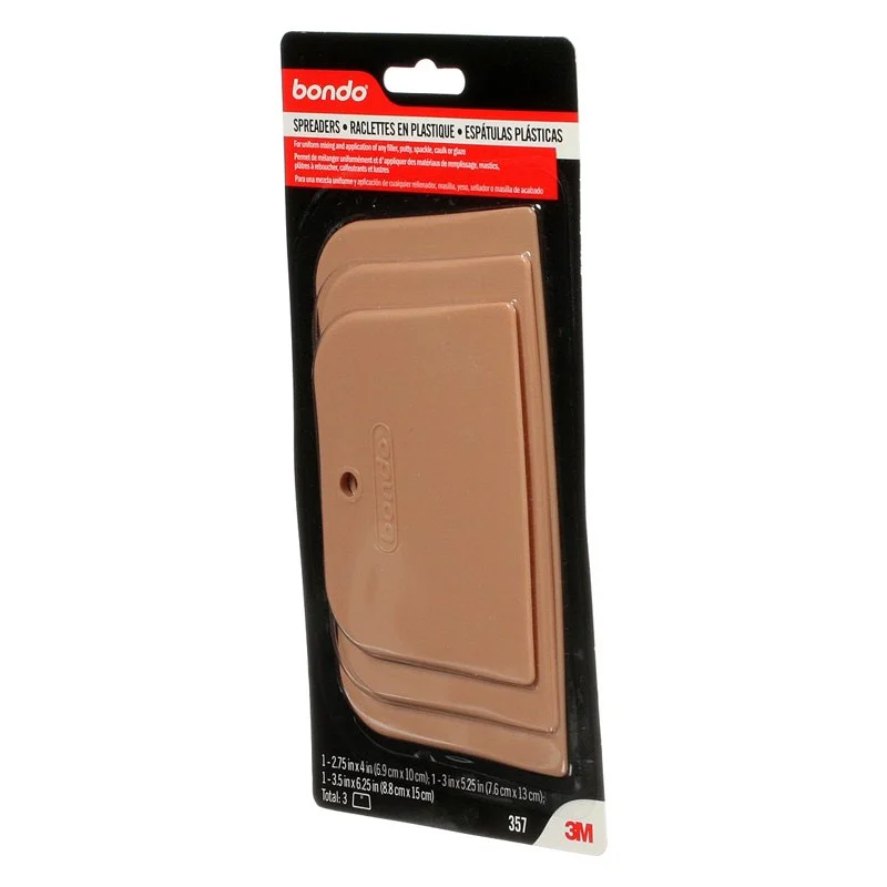

Great post. Harbor Freight actually sells a pretty good steamer too, which I've used for the same purpose. My favorite scraper for this are those spreaders they sell for bondo. They work well and are soft enough not to leave any marks.
