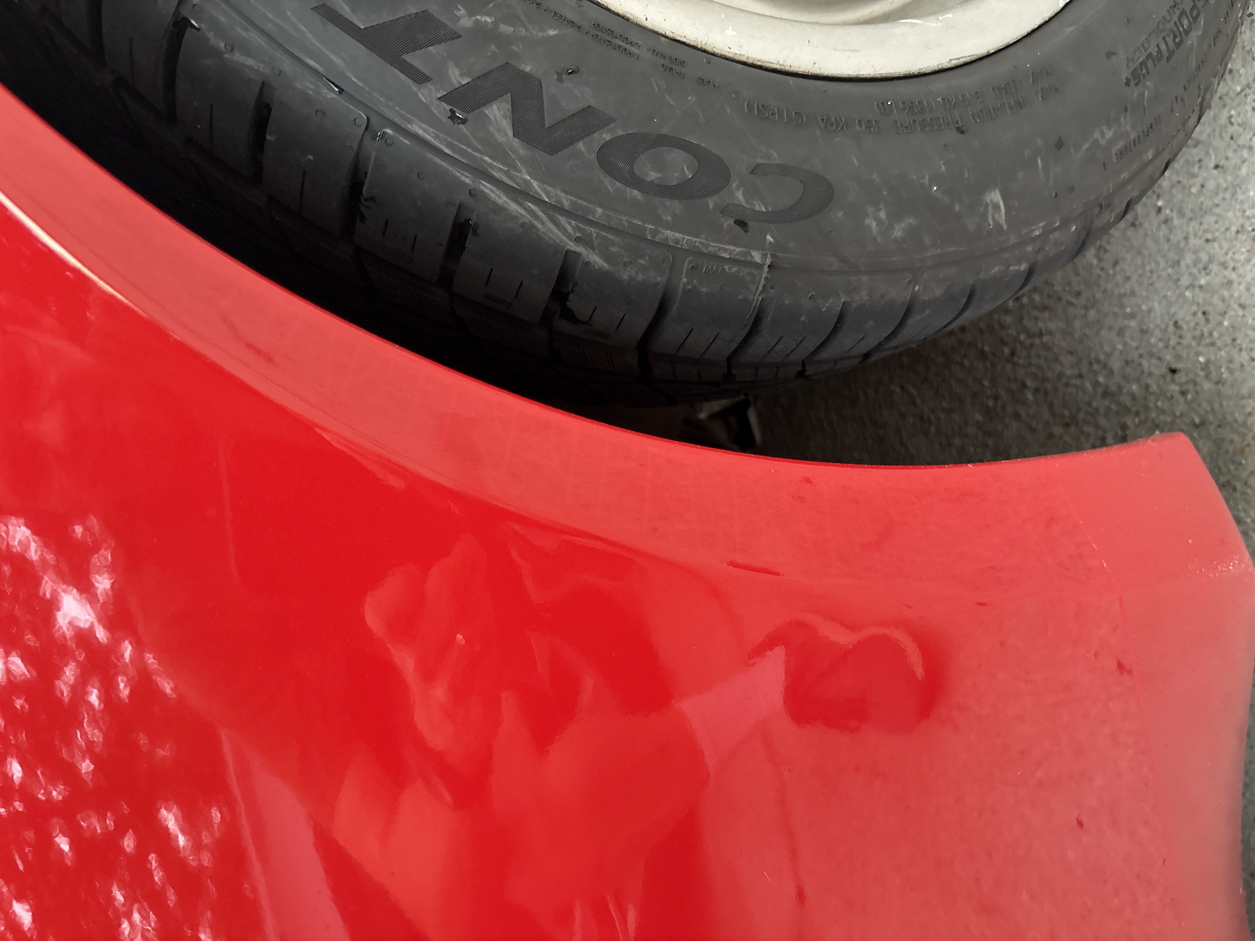

Wanted to share my removal experience. Like many others in the 944 community, I still had the original stone guard on the car. They had become cracked, hard and seemingly impossible to get off without causing significant damage to the underlying paint. I had various levels of success solvents, careful use of scrapers and razor blades and very light sanding. After a lot of searching I saw a mention of using steam. This reminded me that I had a great steamer and I had the time to use it this weekend. While I did not take any in process pictures, my basic process was to apply steam to a small area to soften the guard and then scrape with a plastic putty knife. That would leave adhesive residue to which I would apply more steam and rub the area with the plastic putty knife to rub/scrape off adhesive. I would repeat until most of the adhesive was removed and would use a microfiber cloth to rub off the last bits. I would then move to the next area. The plastic putty knife is important because while it worked to remove guard/adhesive, it did not damage the paint. I have this steamer https://www.daimer.com/steam-cleaners/kleenjet-200s.htm and had it set to 60 psi (4 bar) boiler pressure at 300deg F. Attached is a photo showing the front fender location.
