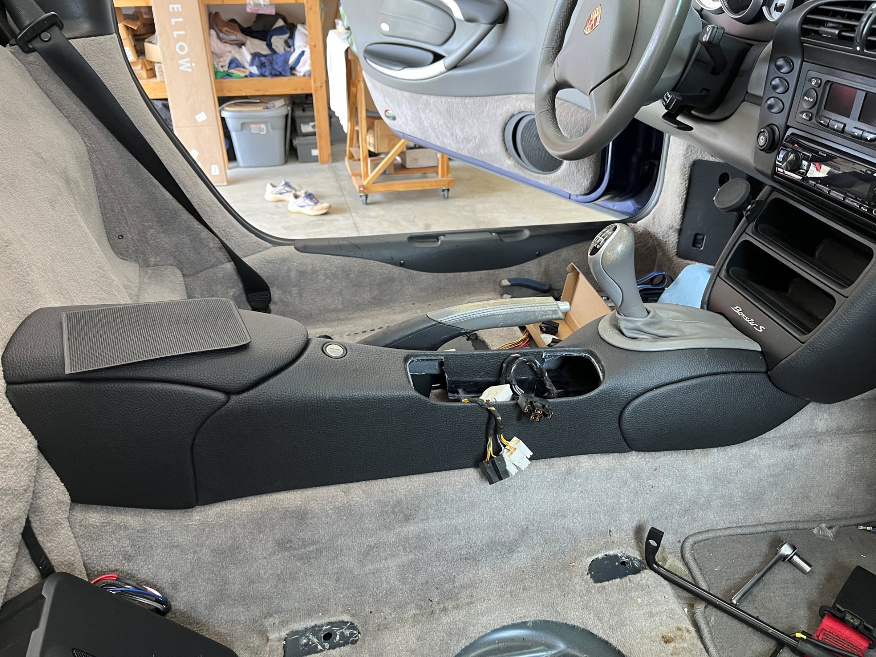

I recovered the console on my 986 with automotive leather look vinyl. Very please with the results. I got the idea from Pedros Garage site. I tried a couple of different paints with very poor results. The soft paint is a real horror story. I have a couple more items to cover.

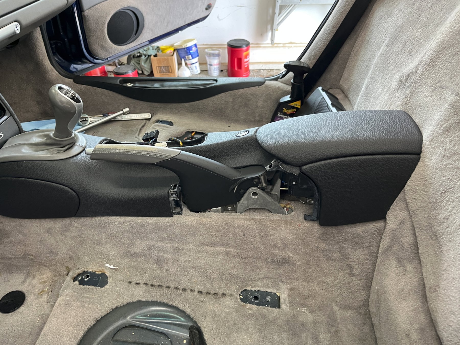

First attempt to post pictures.
I should have documented the process. It was easy, just very time consuming. Re-installation really required at least the passenger seat be pulled. Pulling both made things much easier.

This is an update on my reburb of my console. I pulled all the vinyl I used off and reapplied the original Porsche vinyl on the 4 pieces initially covered. I cleaned and sanded all the glue off and painted the console and vinyl with SEM Color coat obtained from my local auto paint shop. I was told to let the paint cure at least 3 days before installing. I think I waoted a week. It seems to be a very solid and durable surface and it looks great. If I had to do over would have started with the SEM Color Coat (flexible coating for vinyl surfaces, flexible and rigid plastics, carpets and velour).
