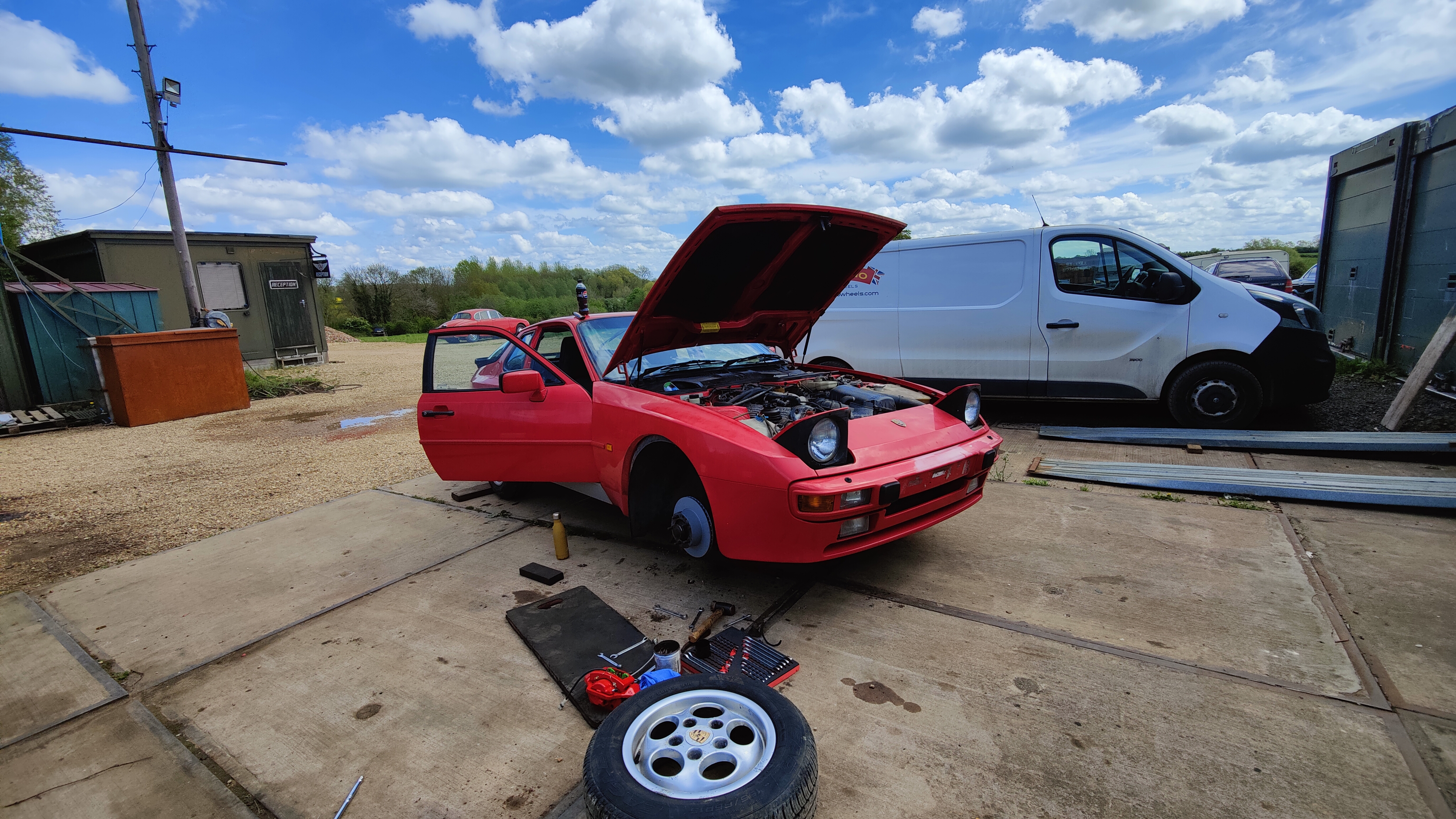

I bought this car in January 2024 after it had sat in various garages around the south coast of England for 16 years , in that time it had had the rotten sills characteristic of anything that touches British roads during winter welded and that was about it. after purchasing it I towed it 170 miles to my work where it has been in a state of slow restoration between other projects and waiting for parts.

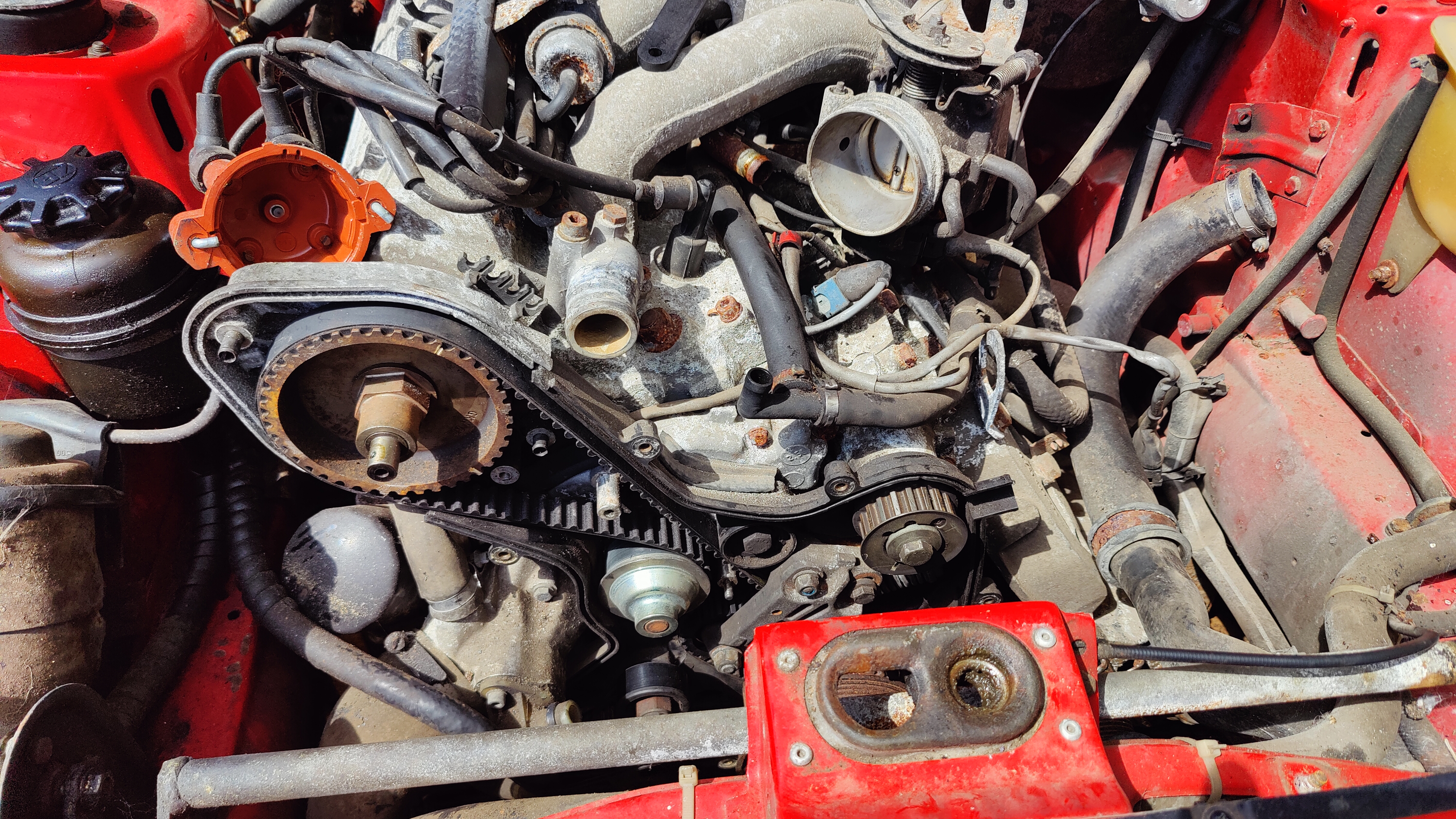

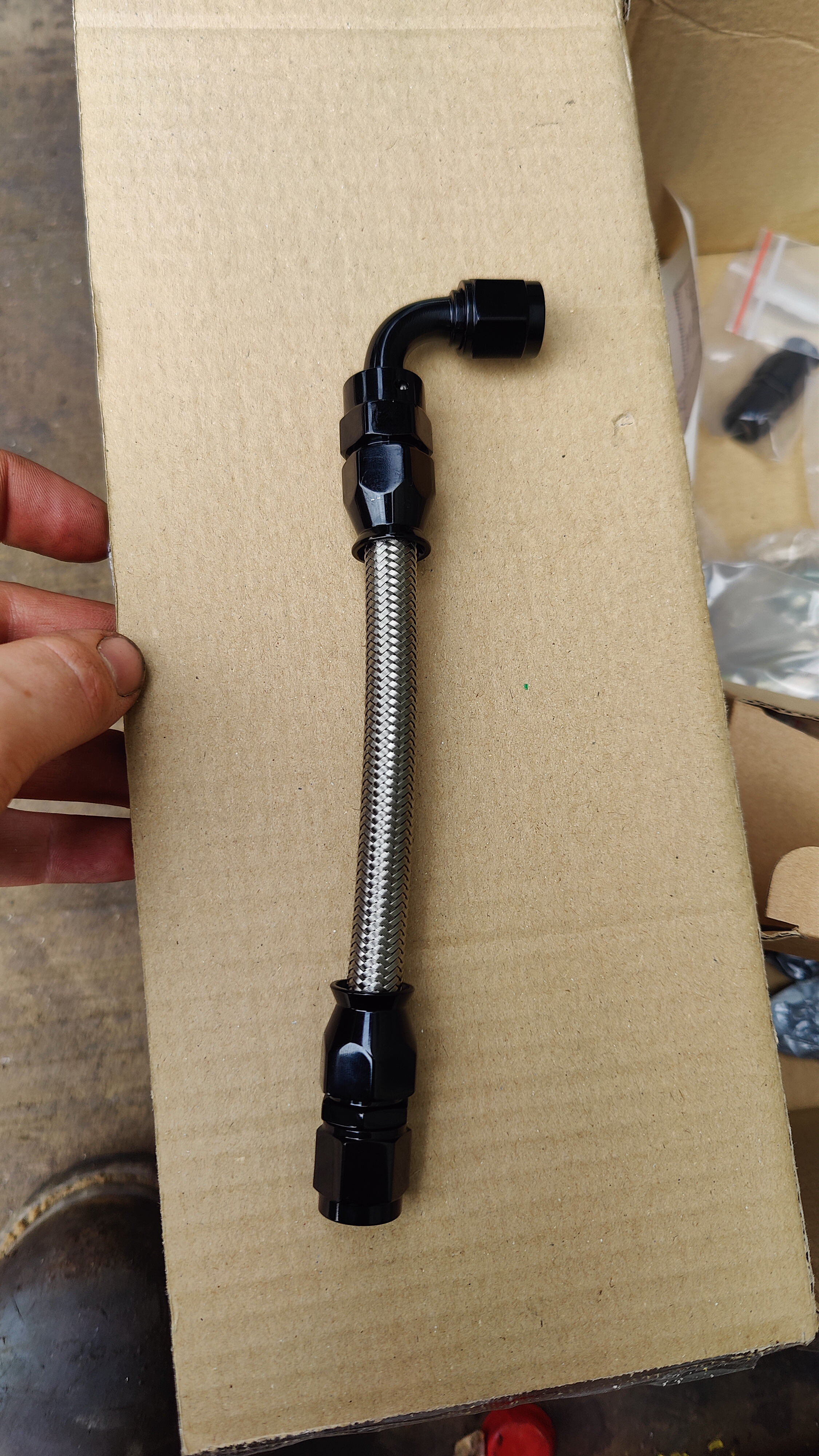

so far I have redone the front brake callipers hoses and lines , new timing belt and balance shaft belt , all of the fuel lines have been replaced with AN6 lines front to rear, and a full service .

new timing belt installed

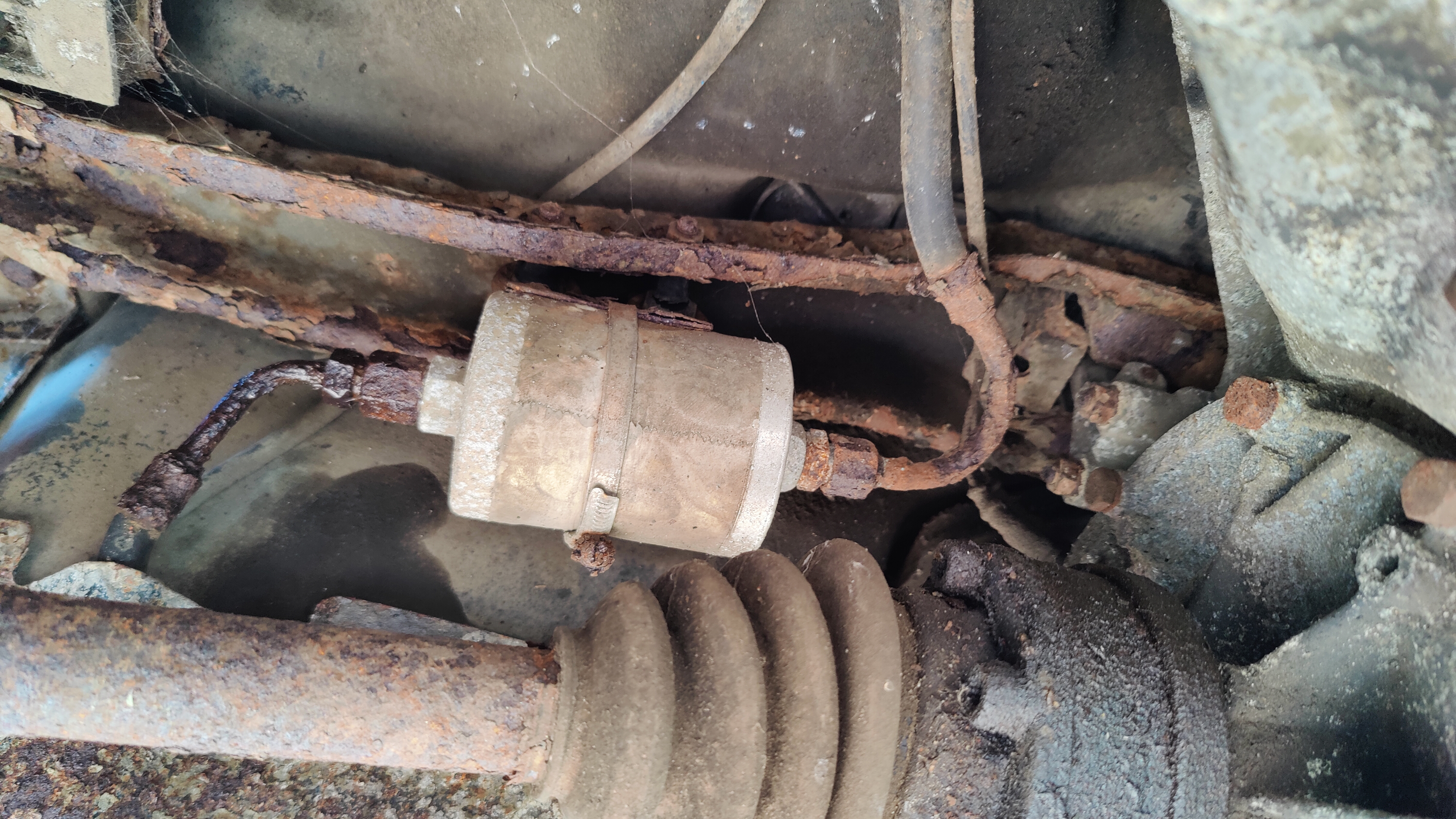

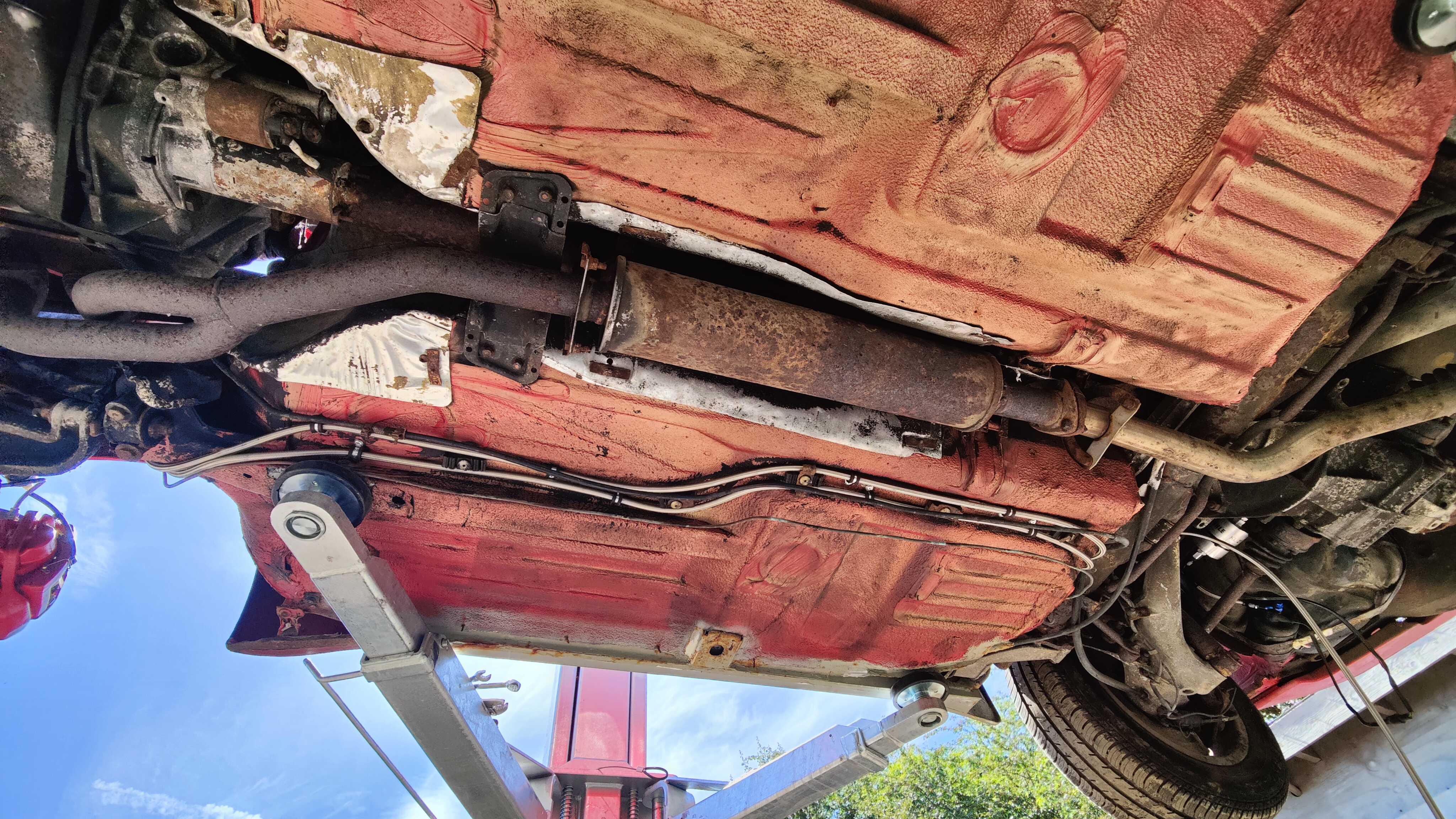

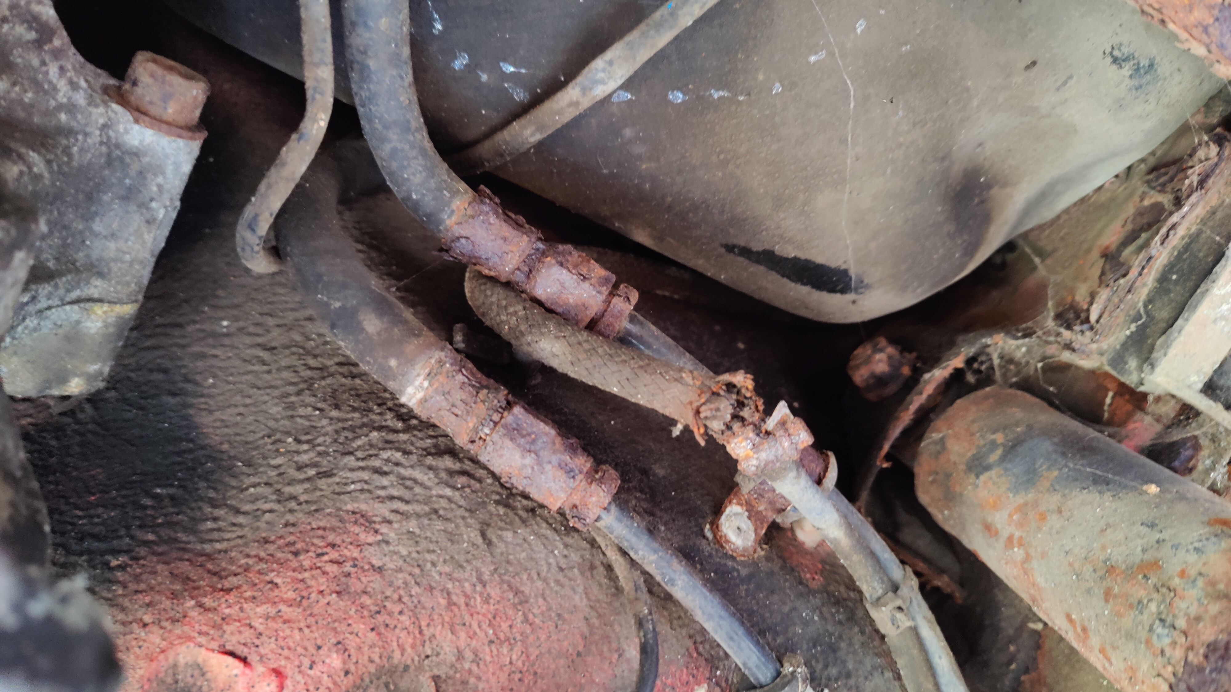

The old fuel system was way very corroded and most fittings leaked instantly when power was applied to the pump manually

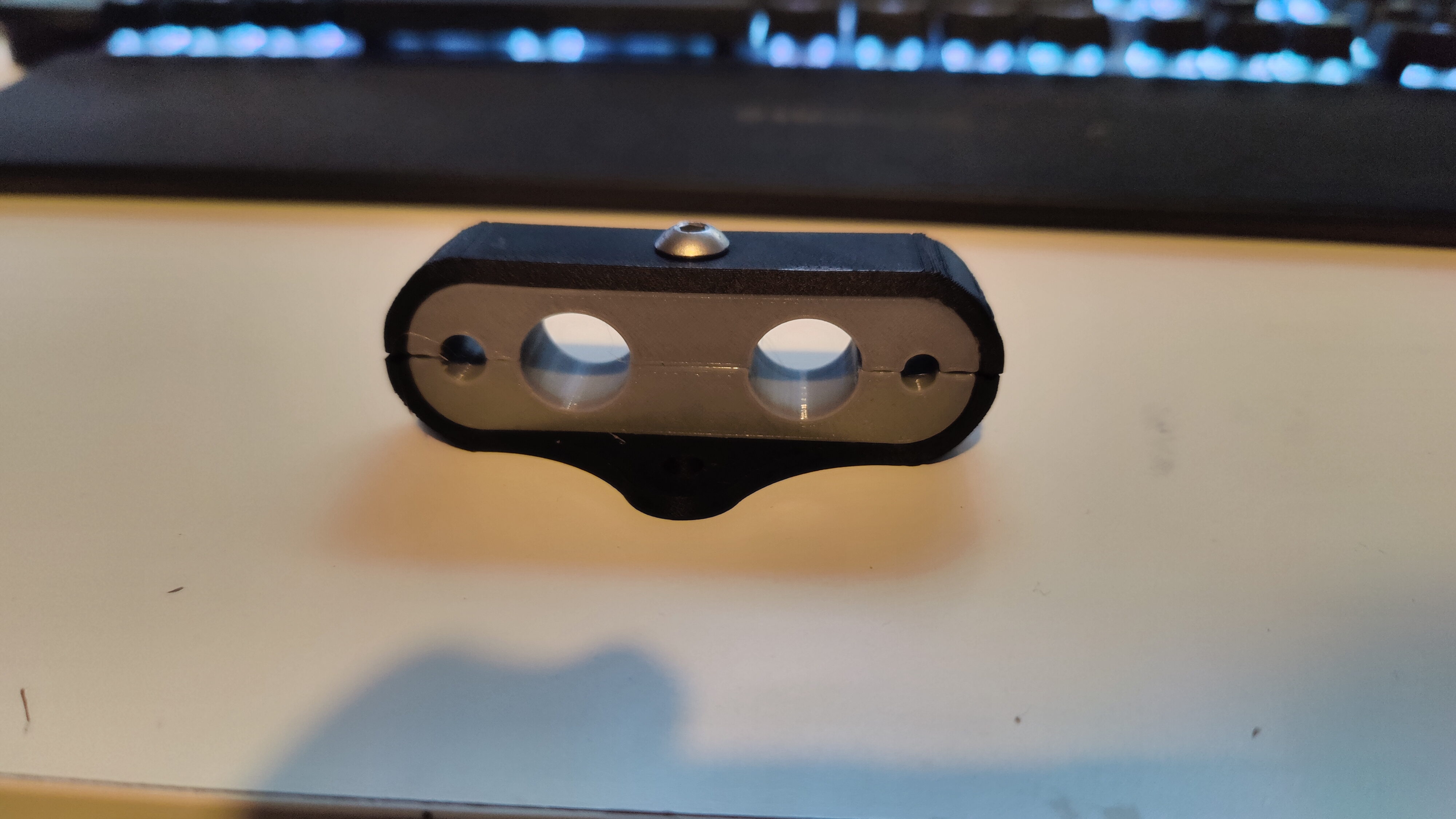

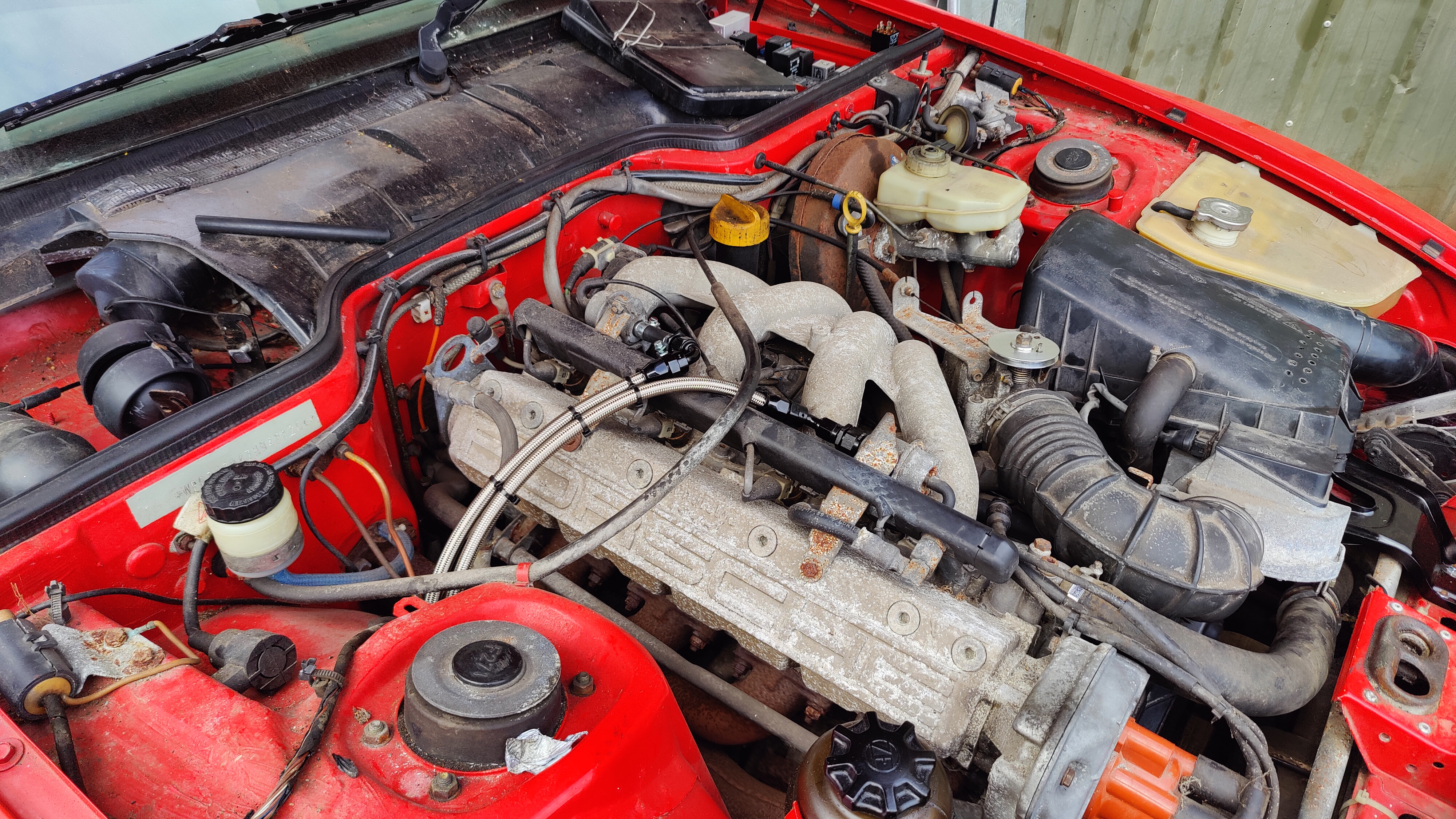

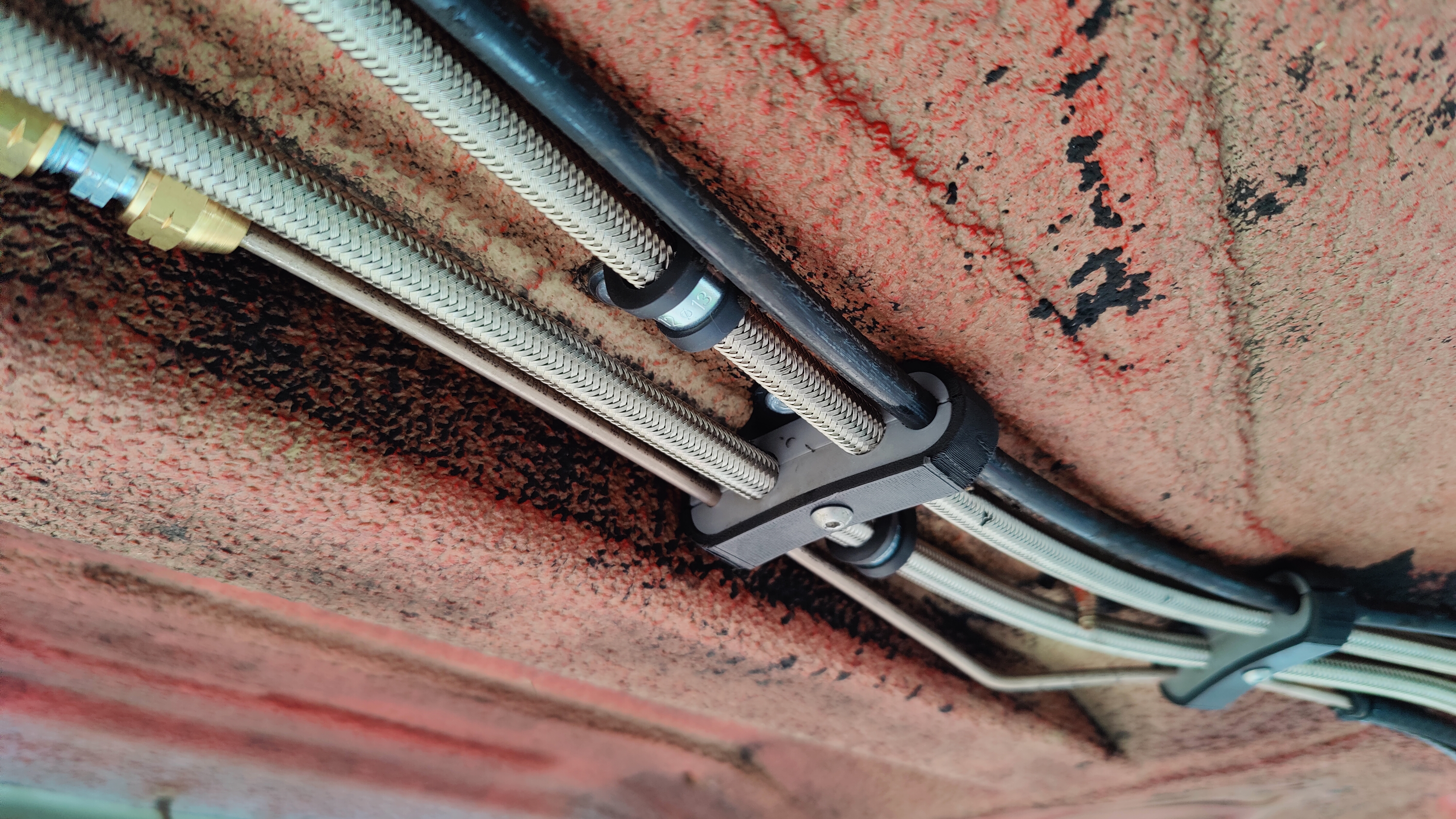

the new stainless steel over braid AN6 Lines all in the correct place ready for some 3D printed clamps to hold the breather and brake lines to them ( I will be designing and making these in the coming months and will make the files available )

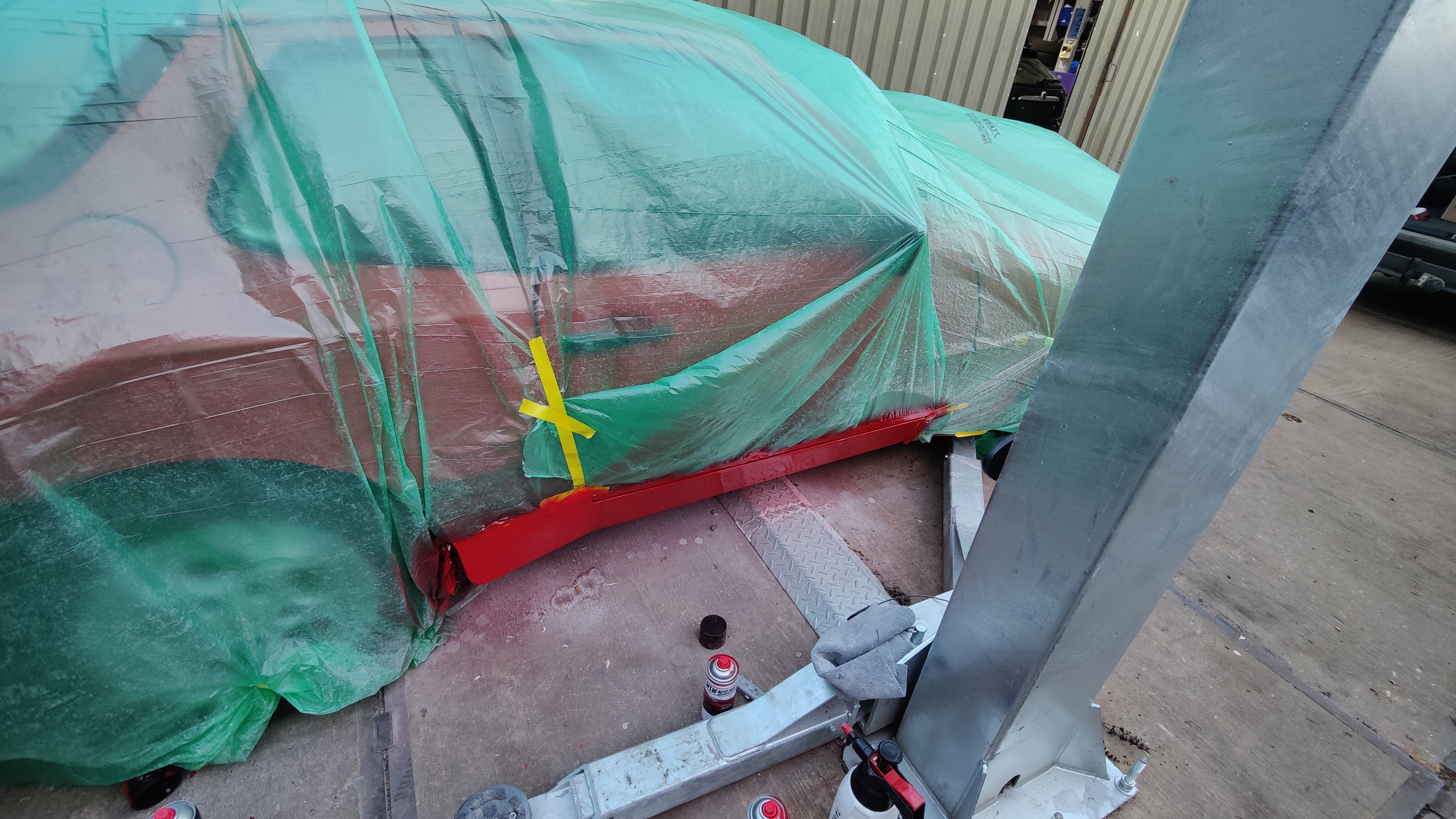

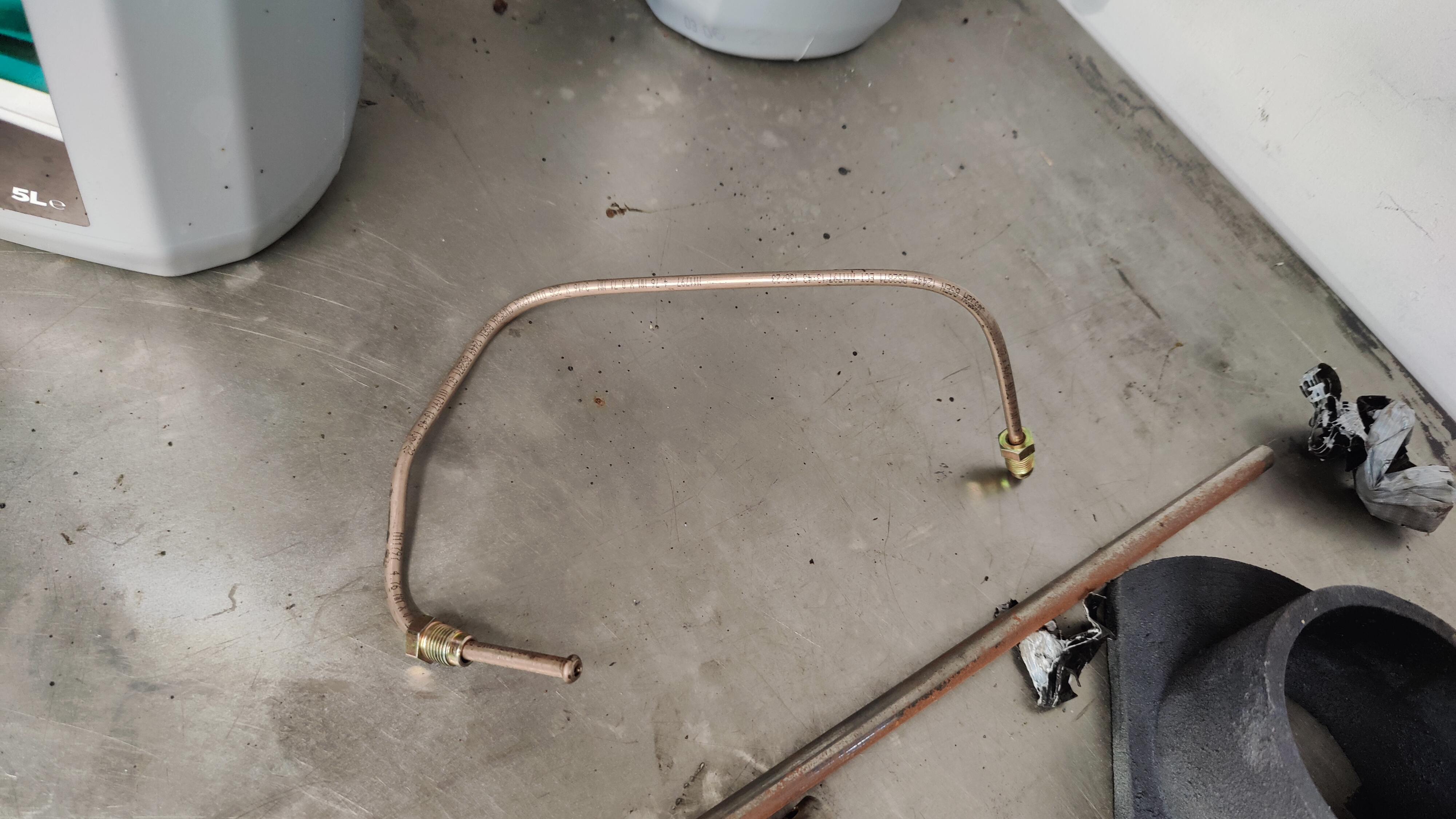

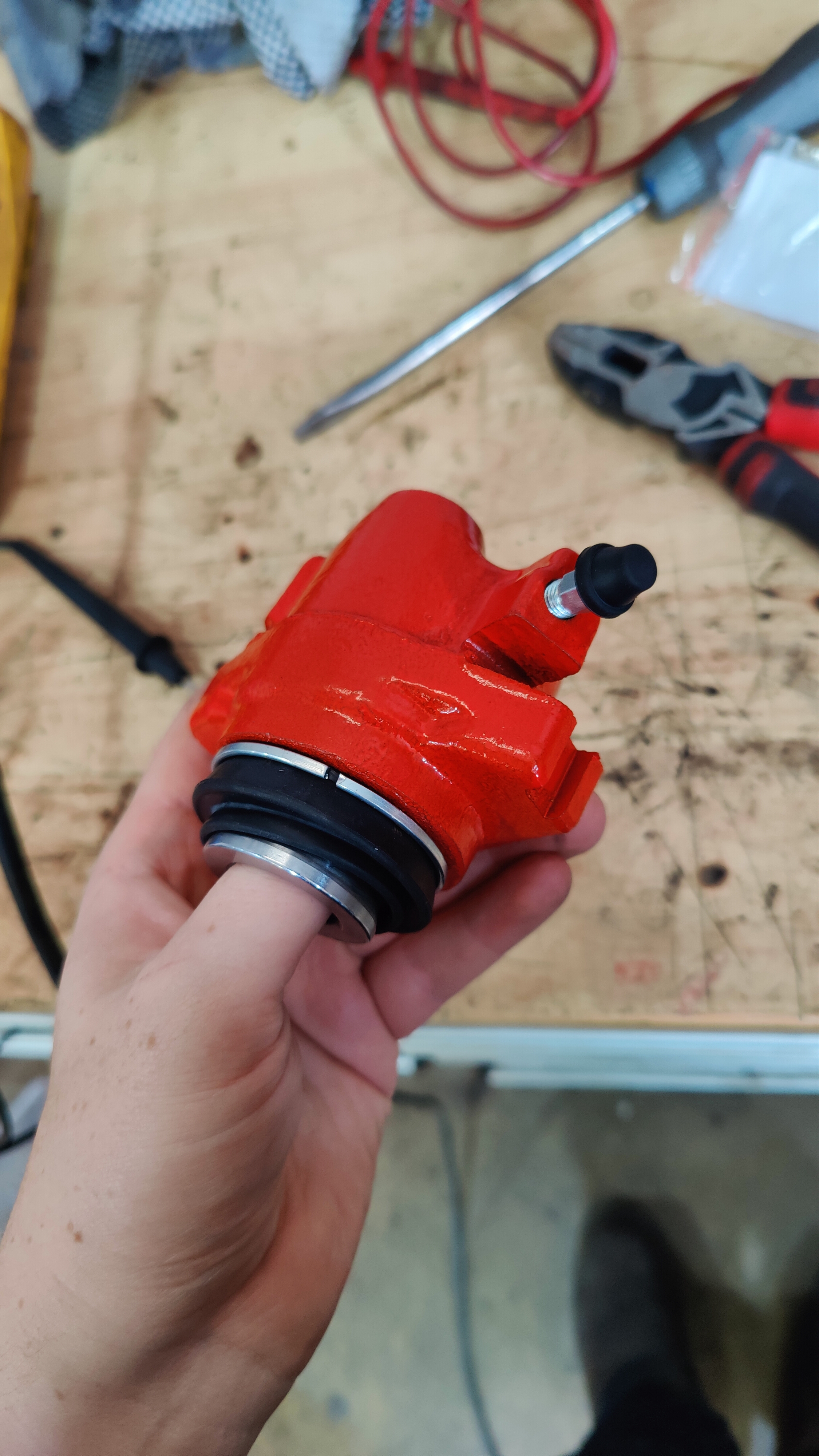

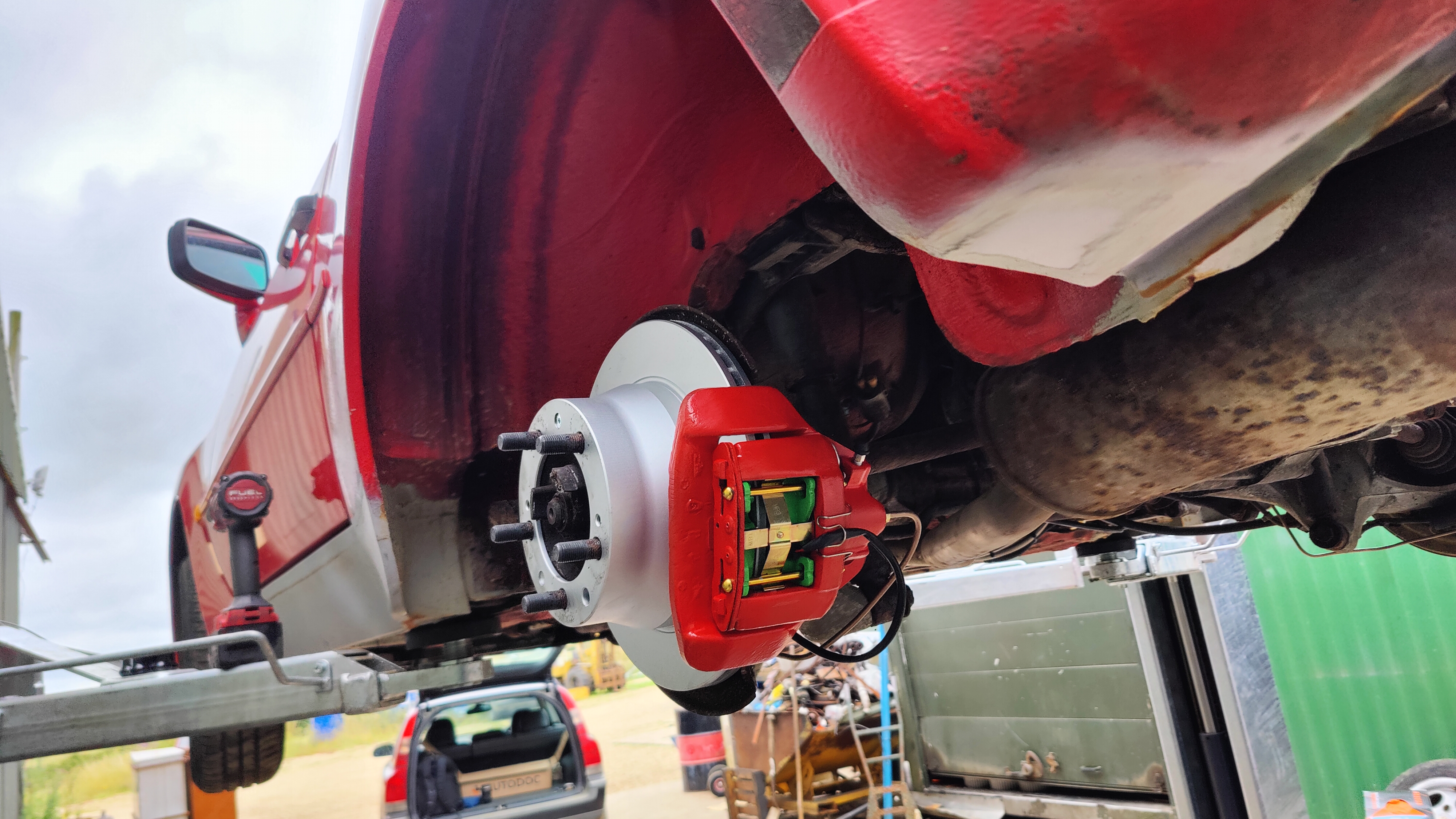

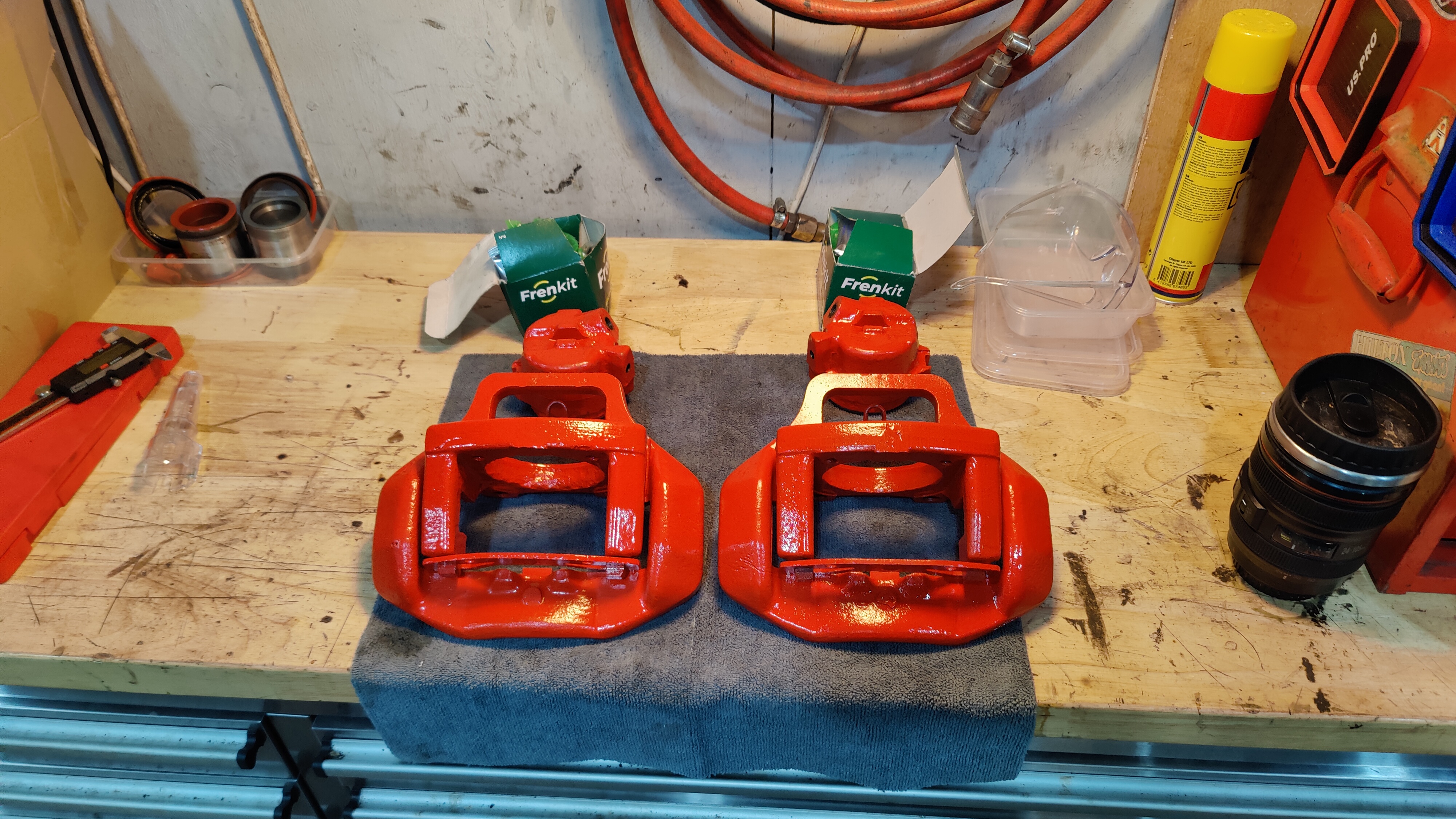

since the last update I have : Rebuilt and painted the rear calipers , replaced all of the brake hard-lines ,replaced the fuel pressure regulator ( this was the main reason it would not start ), painted the exposed primer on the sills and rear valance, replaced sunroof seal , and repaired the blowing exhaust.
I have also designed some 3D printed fuel and brake line clamps, these are ok for now but I am not entirely happy with the strength of the outer fixing , this may have to be made of metal or I may make an updated and stronger clamp .

rebuilt rear brakes
one of the new brake hardlines
My 3D printed clamps shown both off the car and attached the central grey inserts are made of a rubberised TPU filament to ensure that the hoses are clamped well enough the outer clamps are PLA-CF reinforced but still flex too much allowing movement when the hoses are under load .

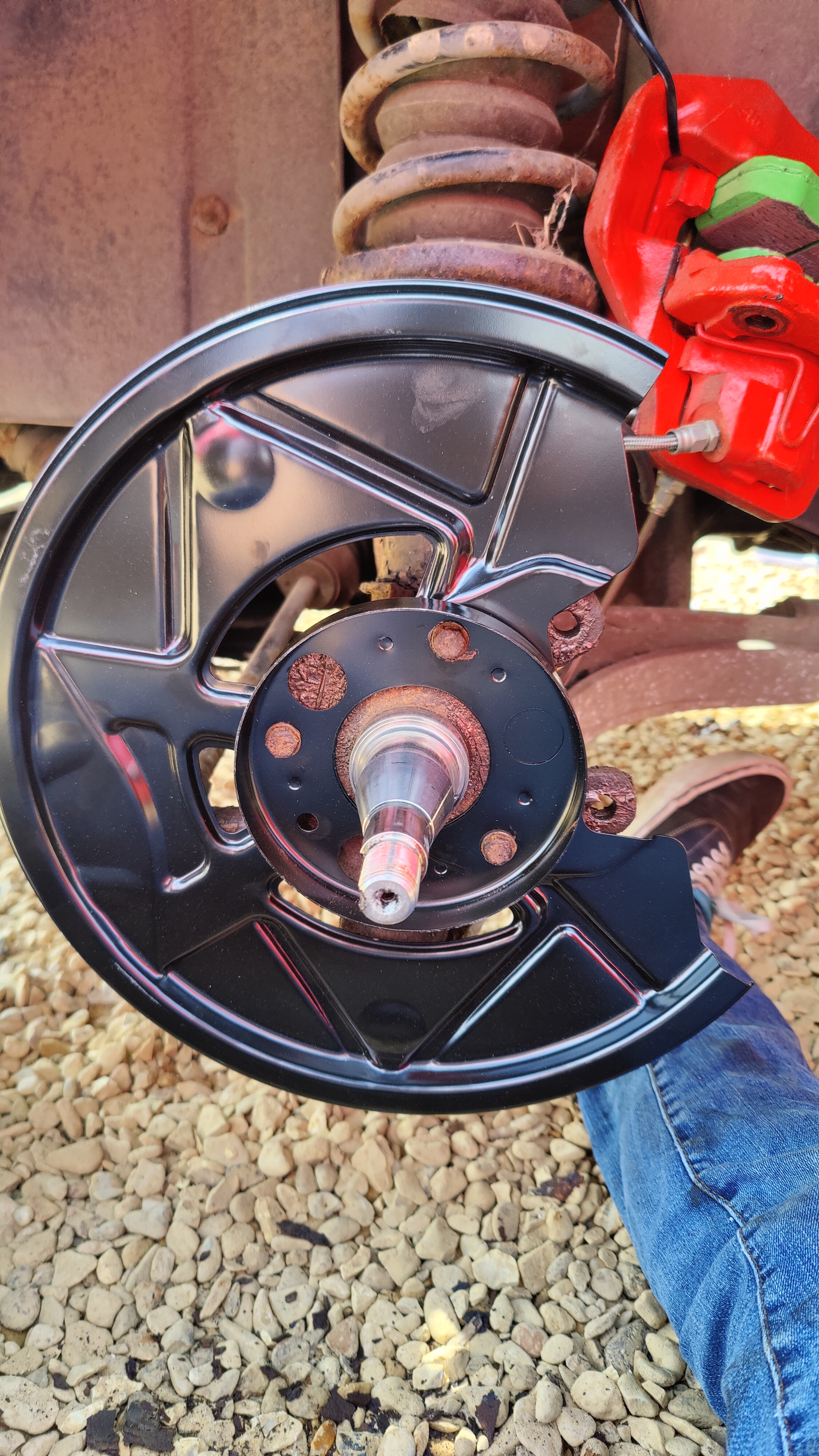

among the other things I have done include ,refurbishing the wheels , a new set of tyres , new brake backing plates , restored the fuel pump cover guard , new fuel tank straps , replaced the speakers and head unit, and finally reinstalling and refurbishing the turbo rear splitter

paint on the sills
painting the rear valance

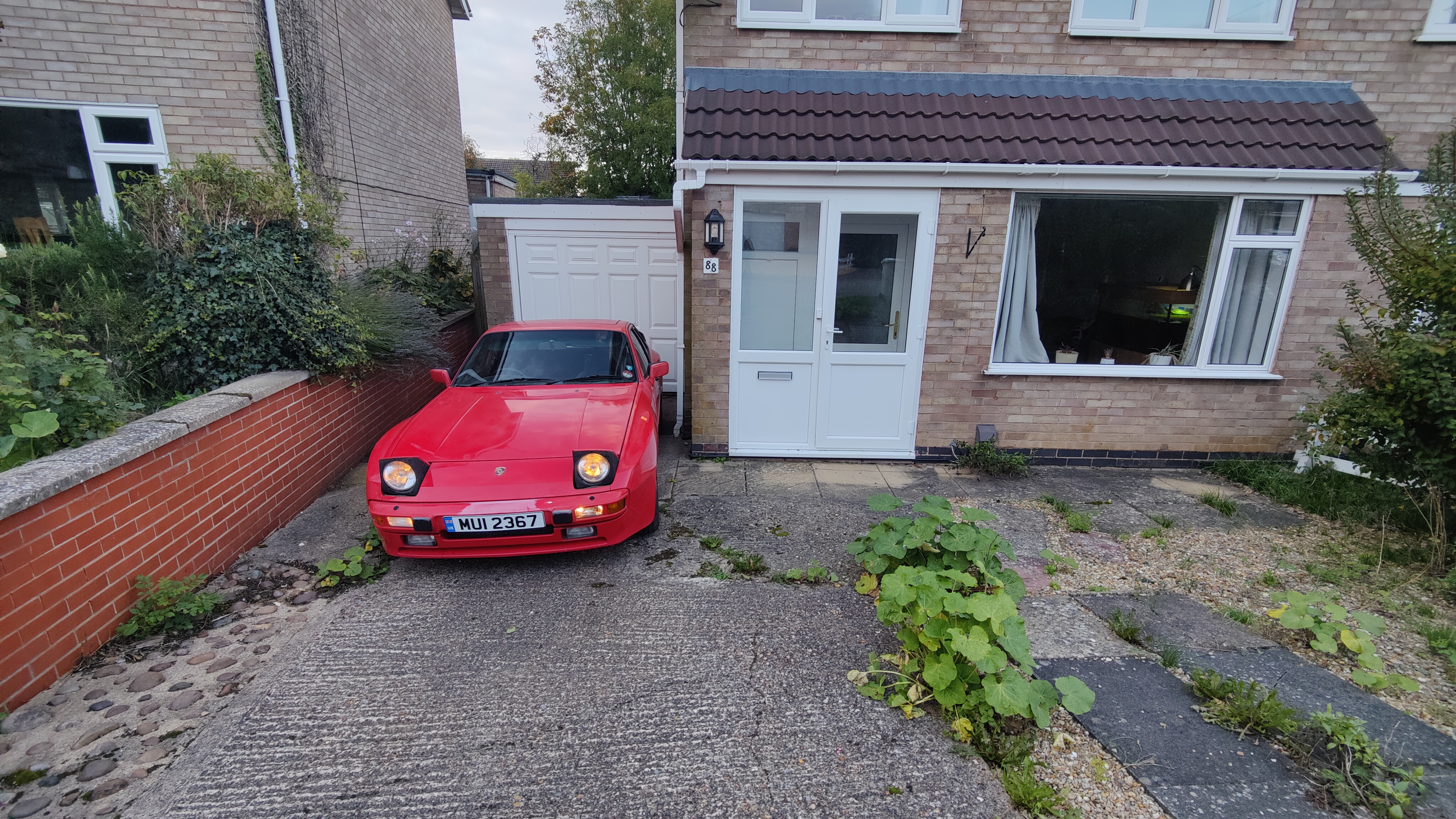

home after the drive back from the MOT
