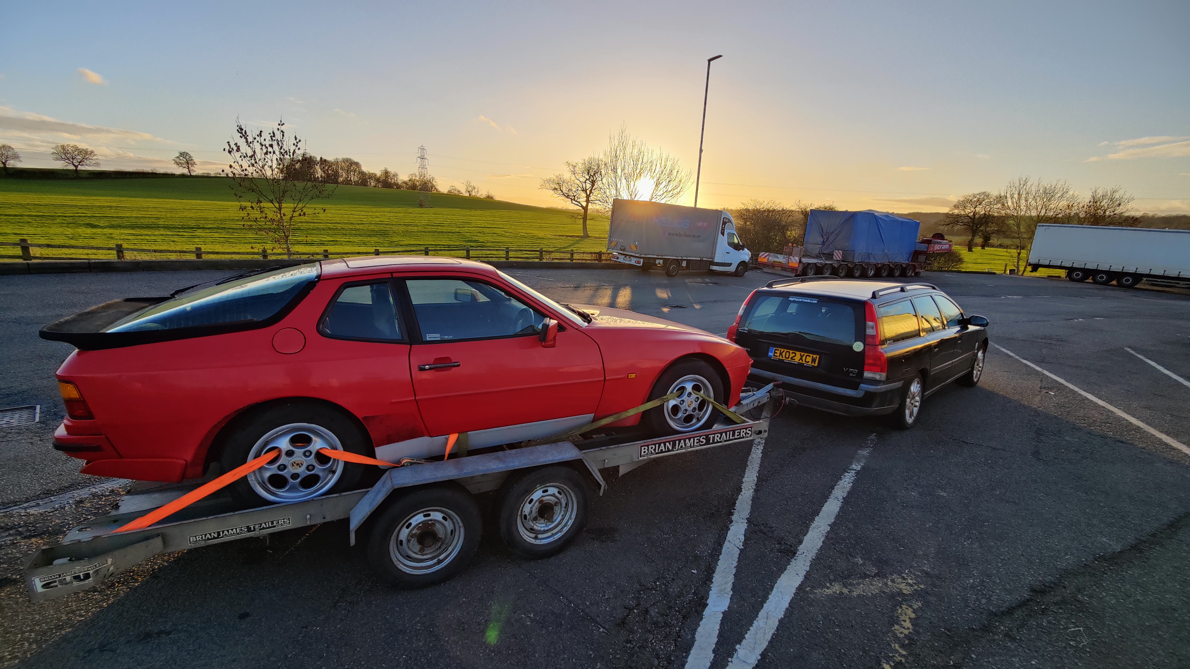

I bought this car in January 2024 after it had sat in various garages around the south coast of England for 16 years , in that time it had had the rotten sills characteristic of anything that touches British roads during winter welded and that was about it. after purchasing it I towed it 170 miles to my work where it has been in a state of slow restoration between other projects and waiting for parts.

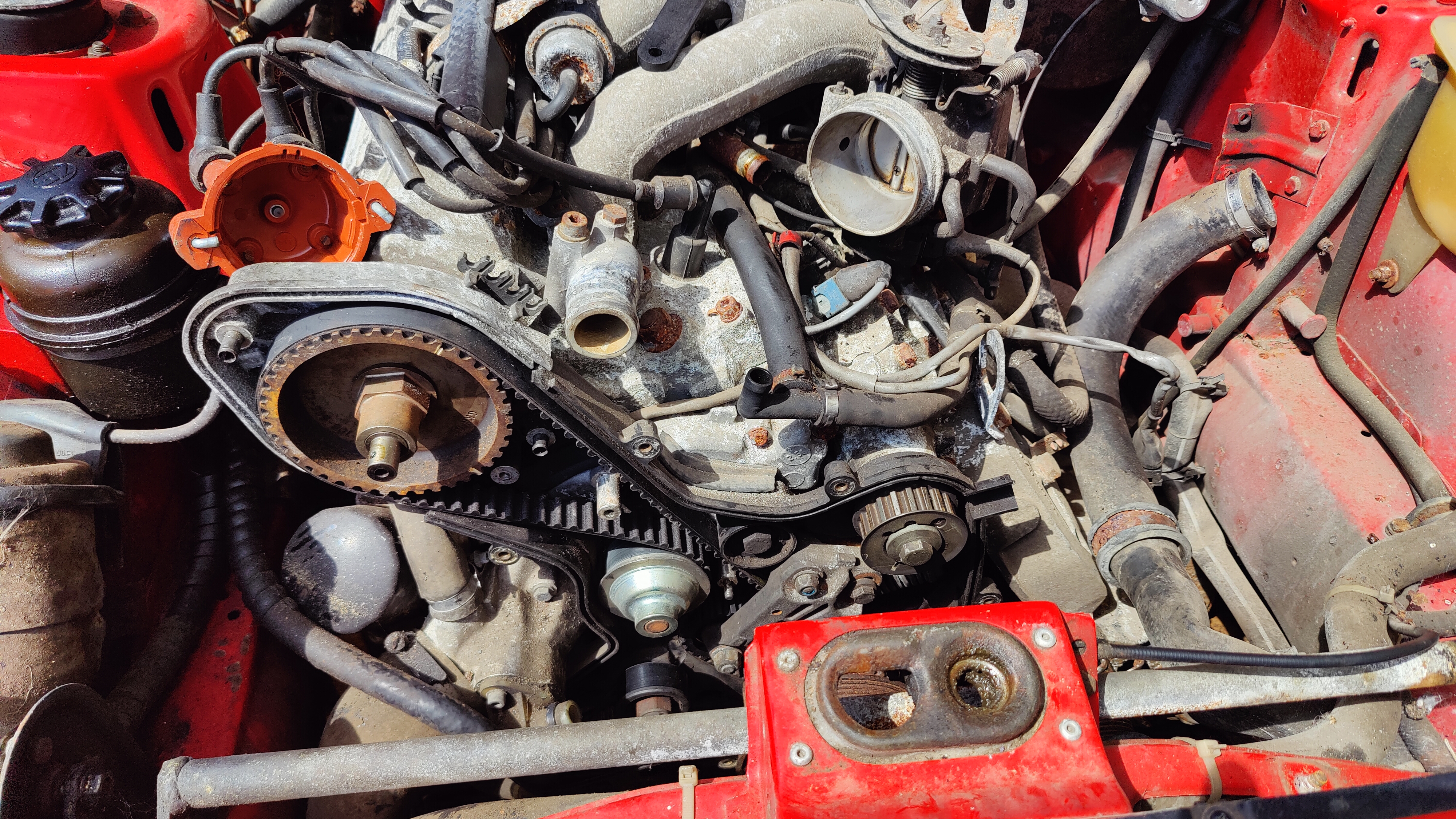

so far I have redone the front brake callipers hoses and lines , new timing belt and balance shaft belt , all of the fuel lines have been replaced with AN6 lines front to rear, and a full service .

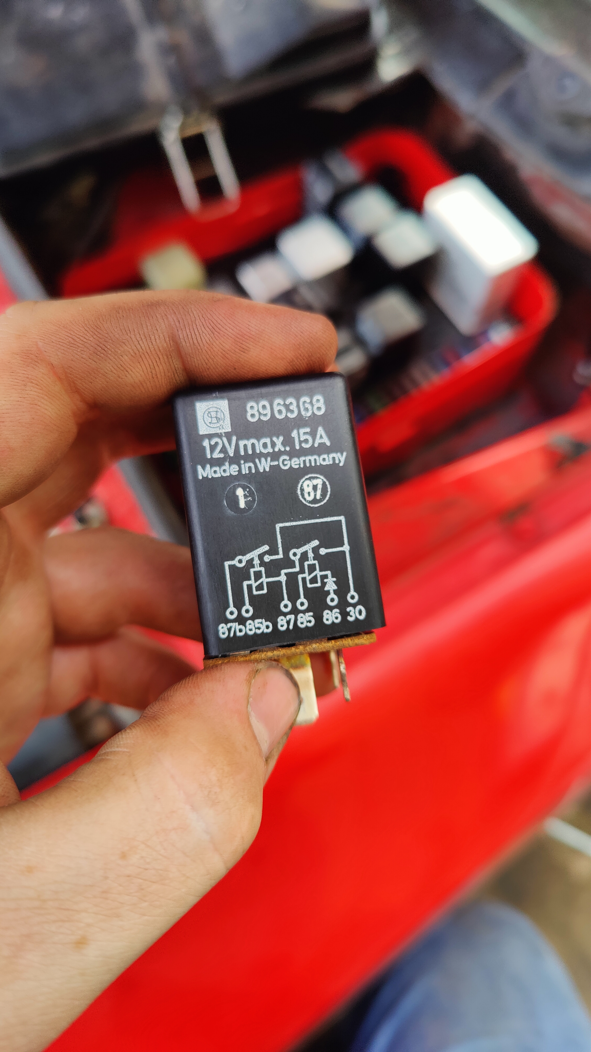

before it gets back on the road I have got to : rebuild the rear callipers (including redoing the rather dodgy front to rear brake line that somebody has created), find the fault with the fuel pump not fuel pumping ( I suspect that the original 1987 DME relay may have something to do with that ) ,at some point in time paint ,and a new set of tyres .
the journey back from picking the car up

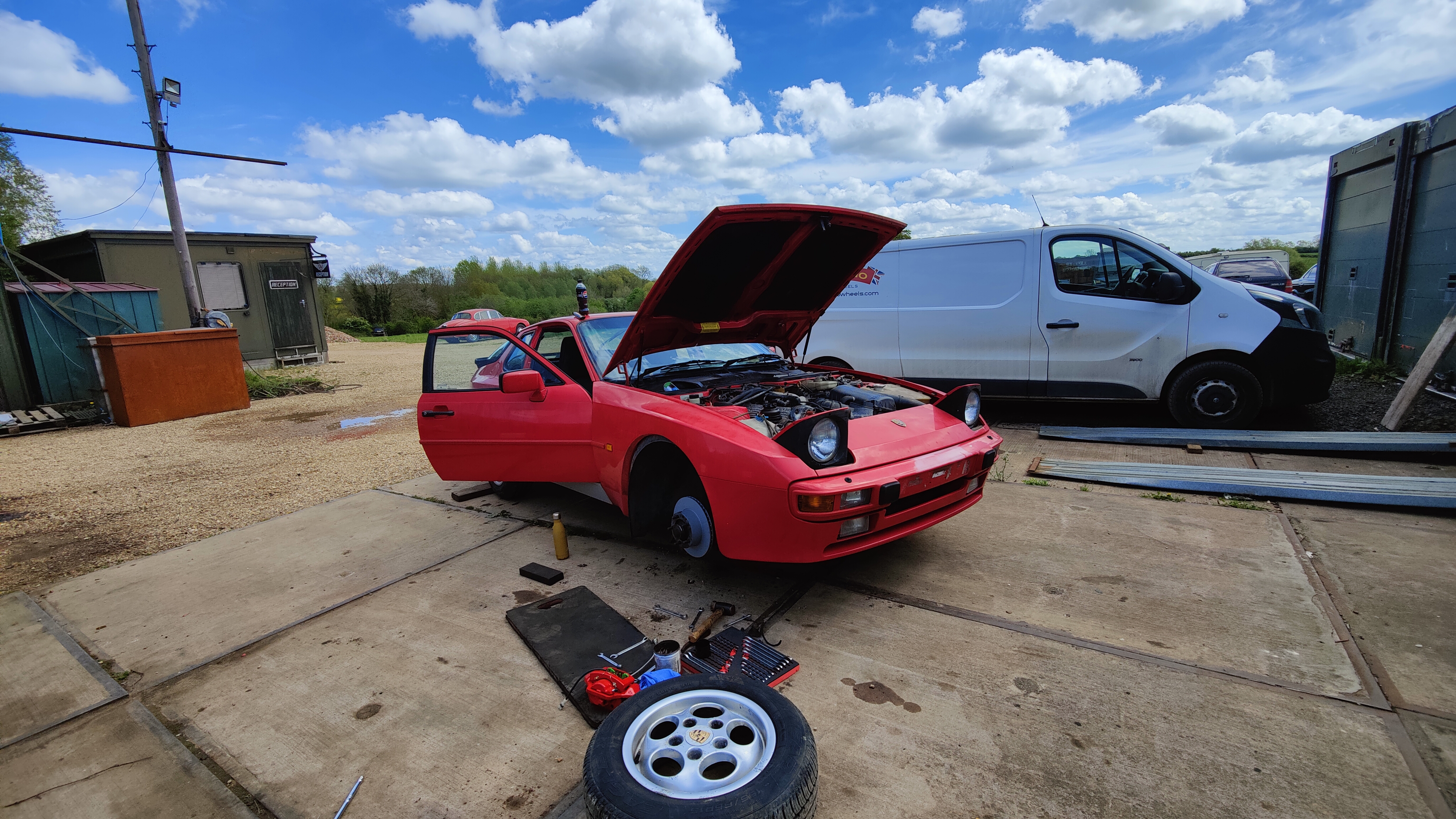

restoration of the front brakes (featuring some uncharacteristically good weather for the UK )
new timing belt installed

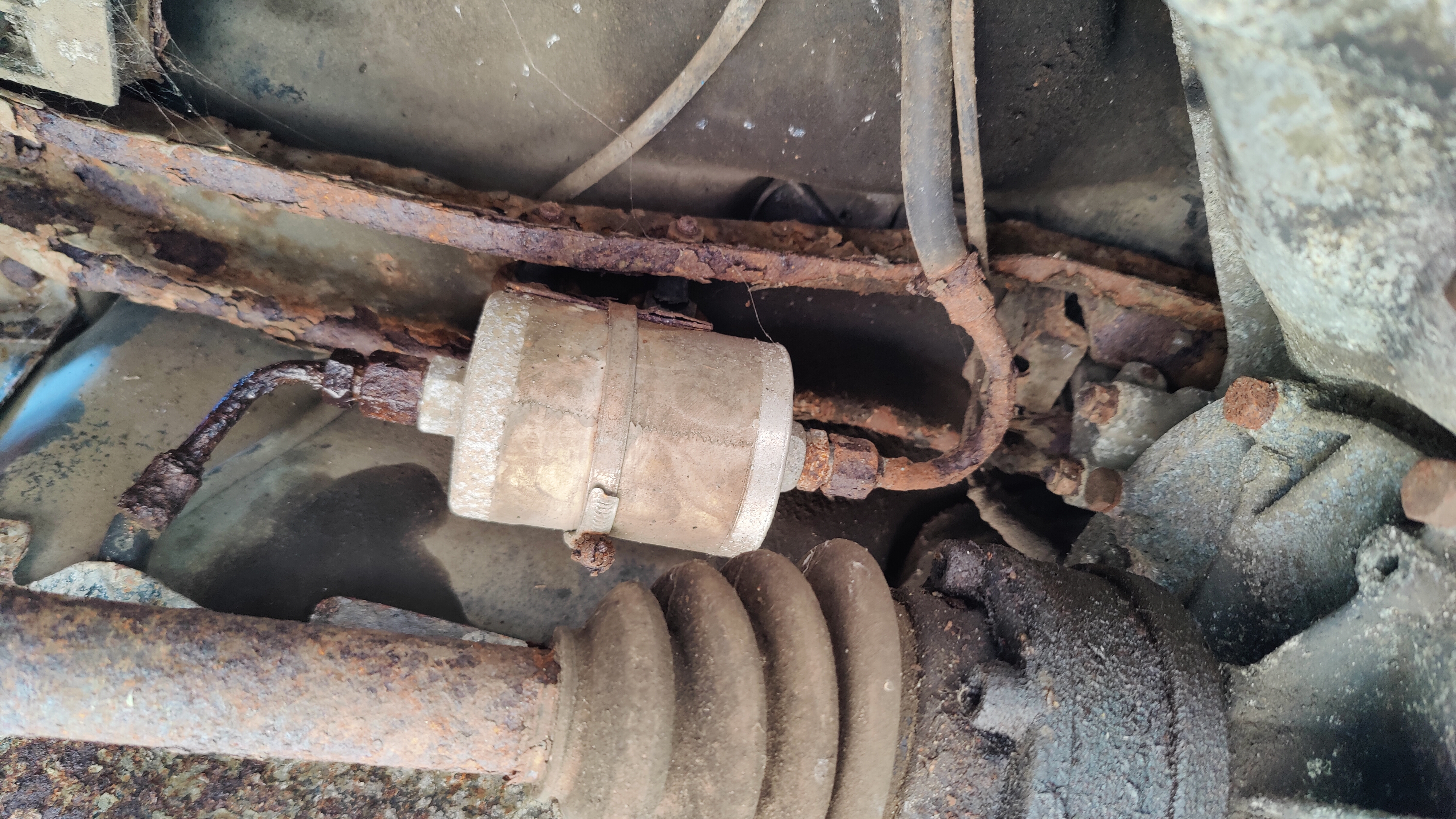

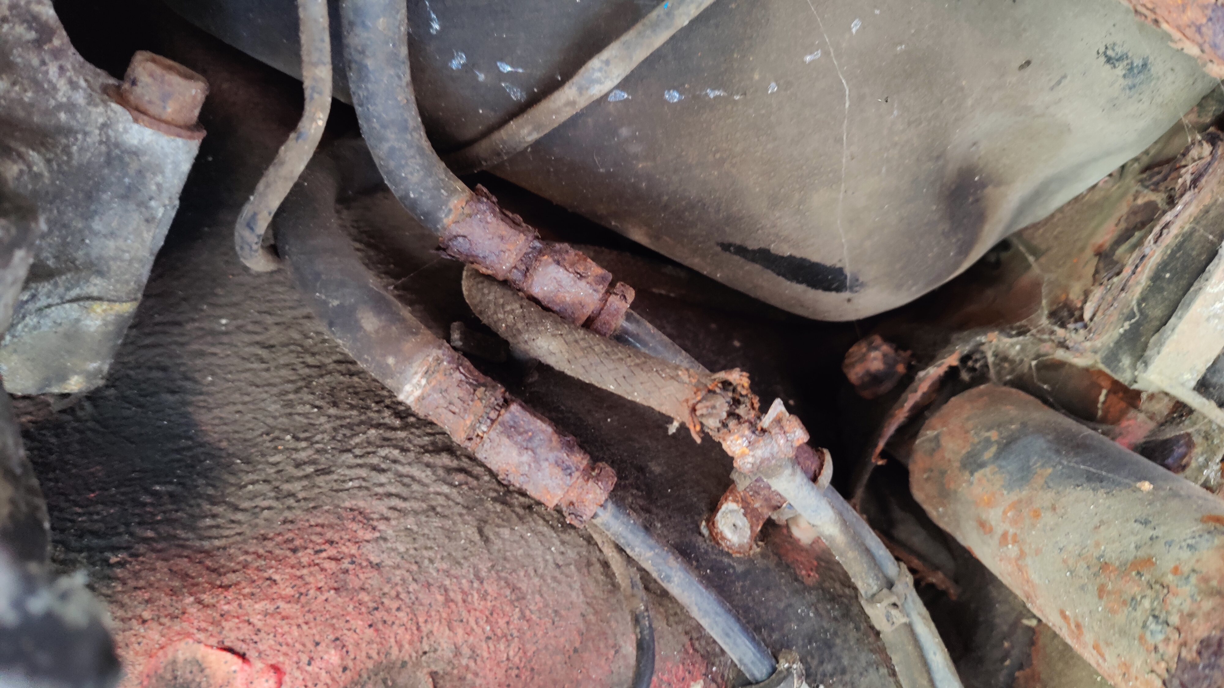

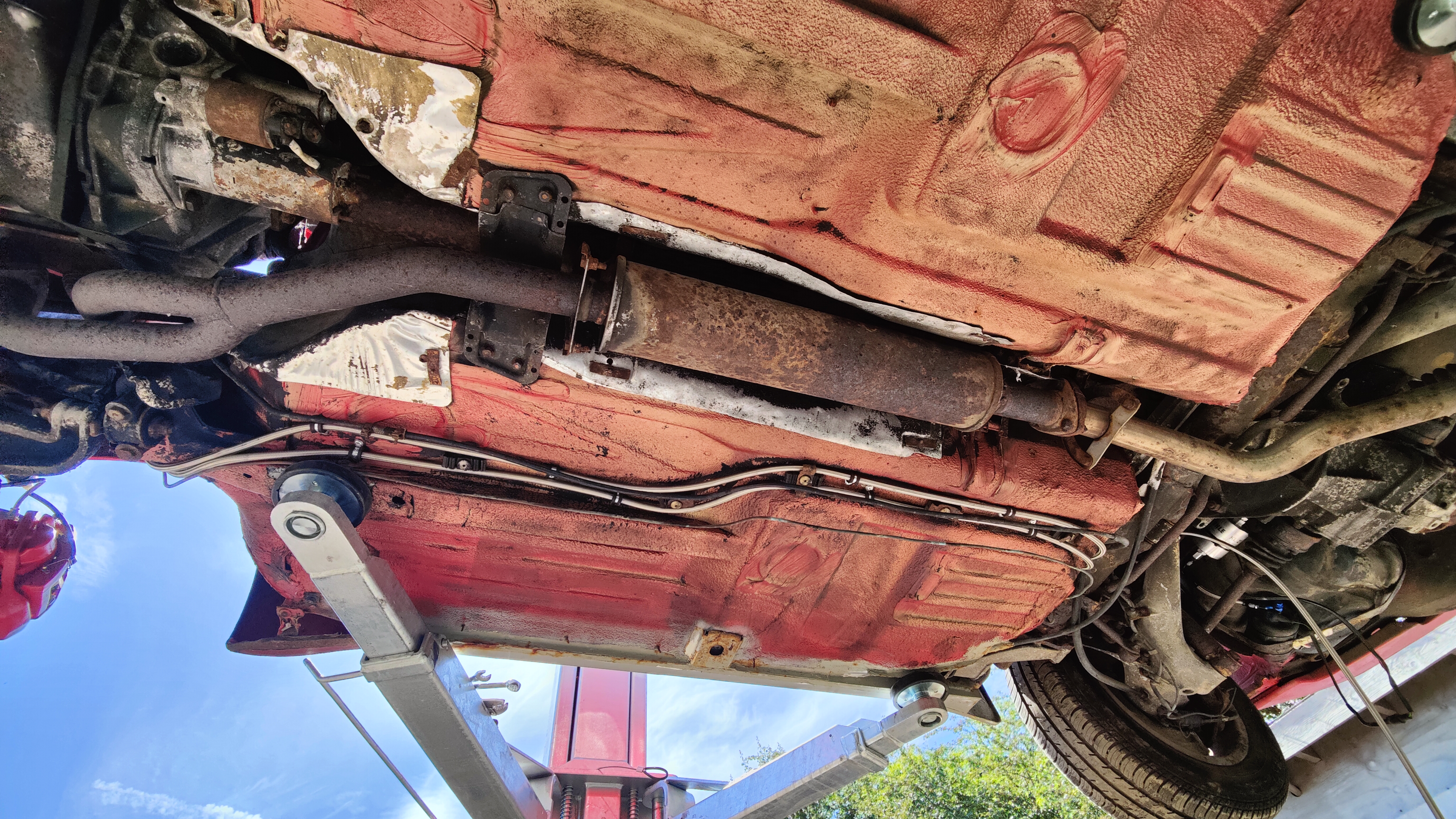

The old fuel system was way very corroded and most fittings leaked instantly when power was applied to the pump manually

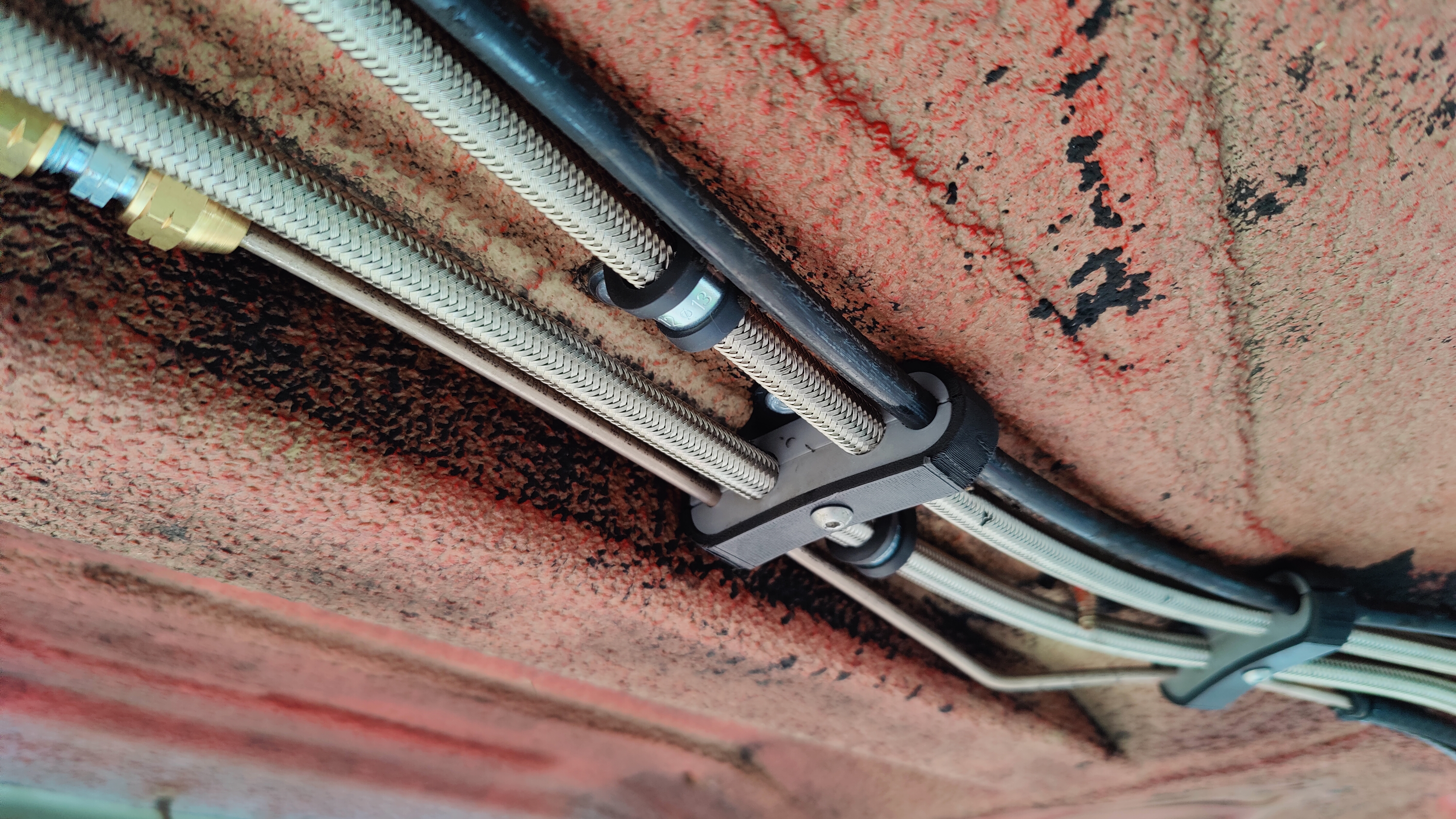

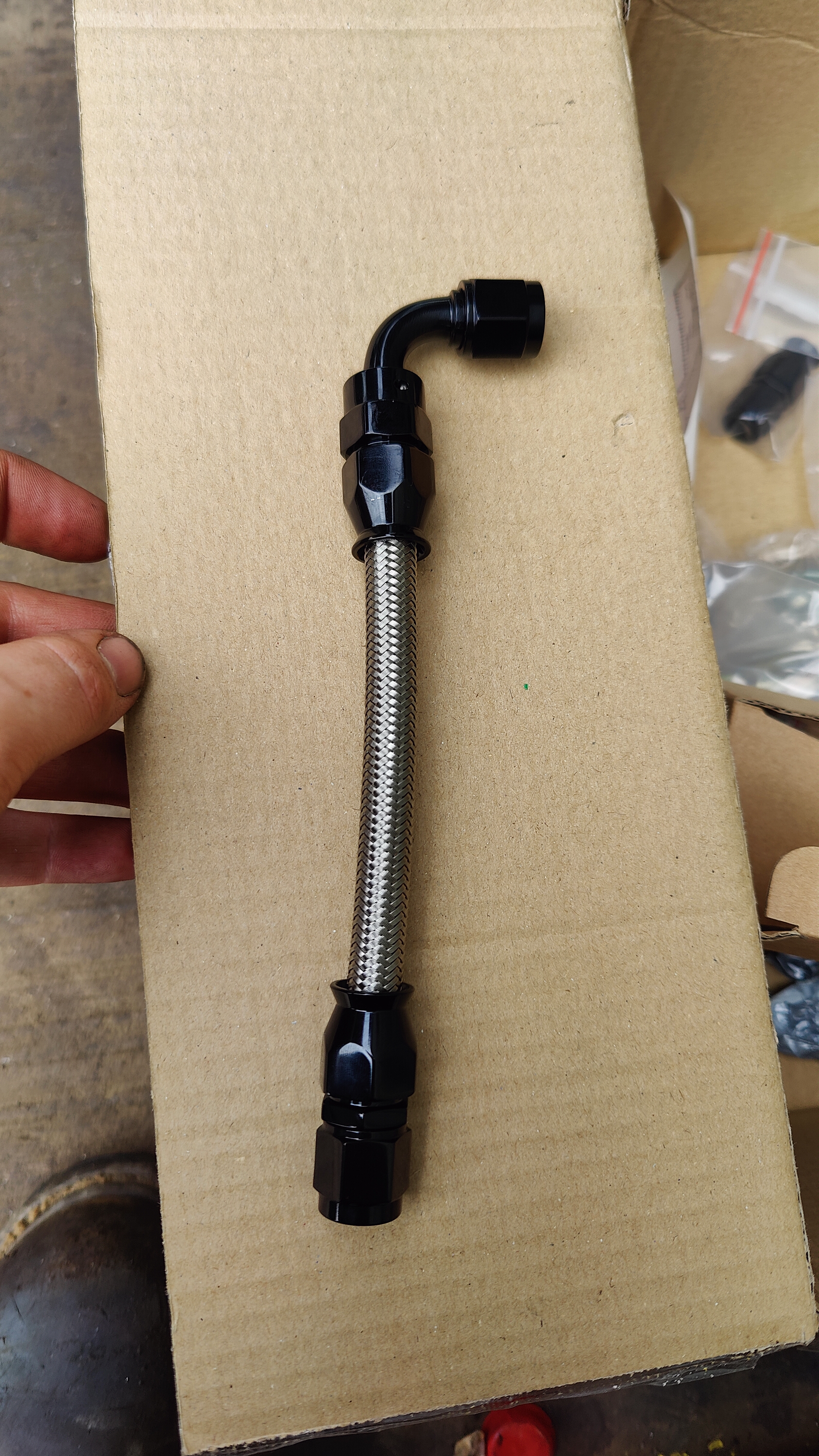

the new stainless steel over braid AN6 Lines all in the correct place ready for some 3D printed clamps to hold the breather and brake lines to them ( I will be designing and making these in the coming months and will make the files available )
the probable cause of the lack of fuel pump an original 1987 DME relay !

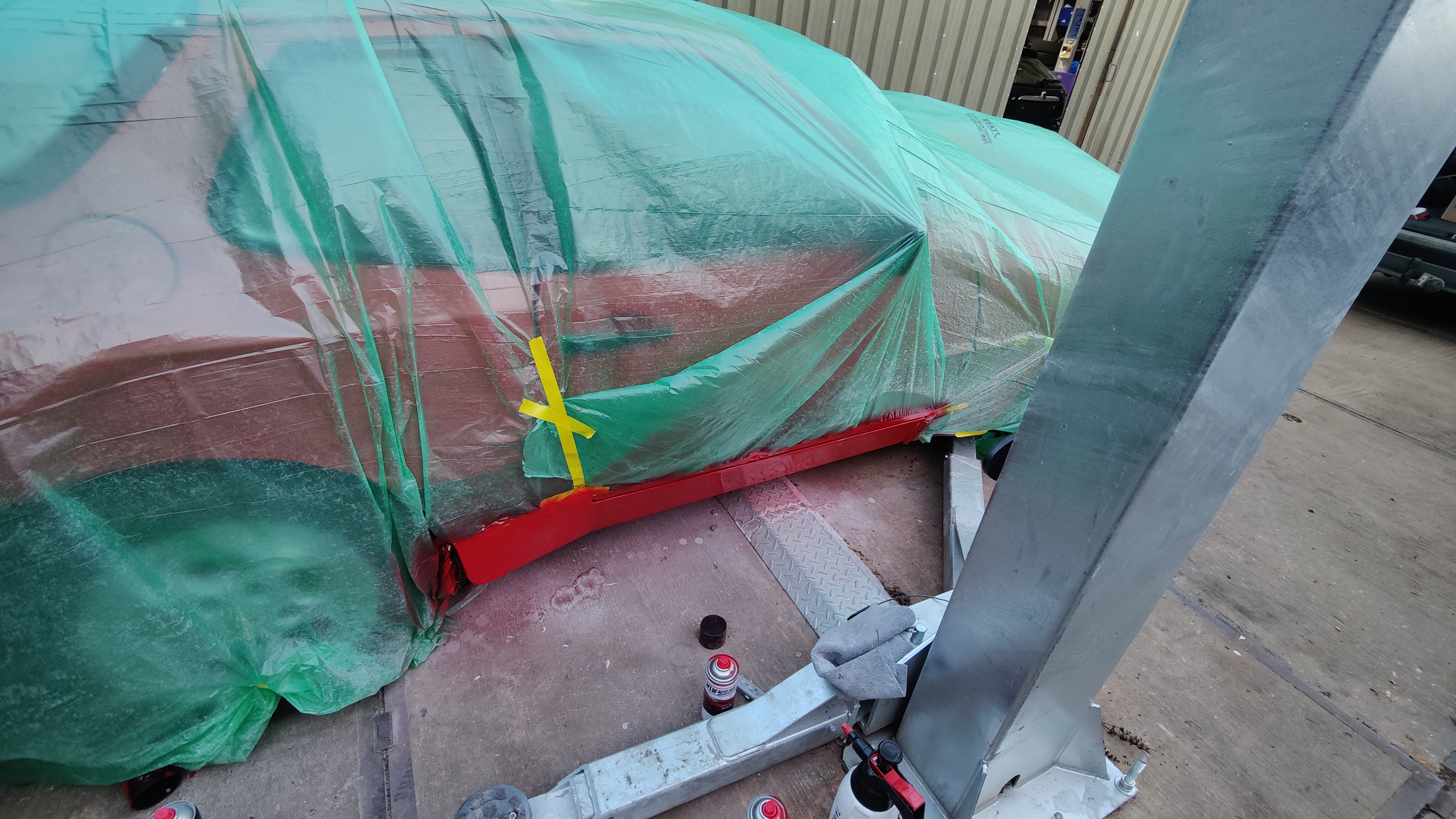

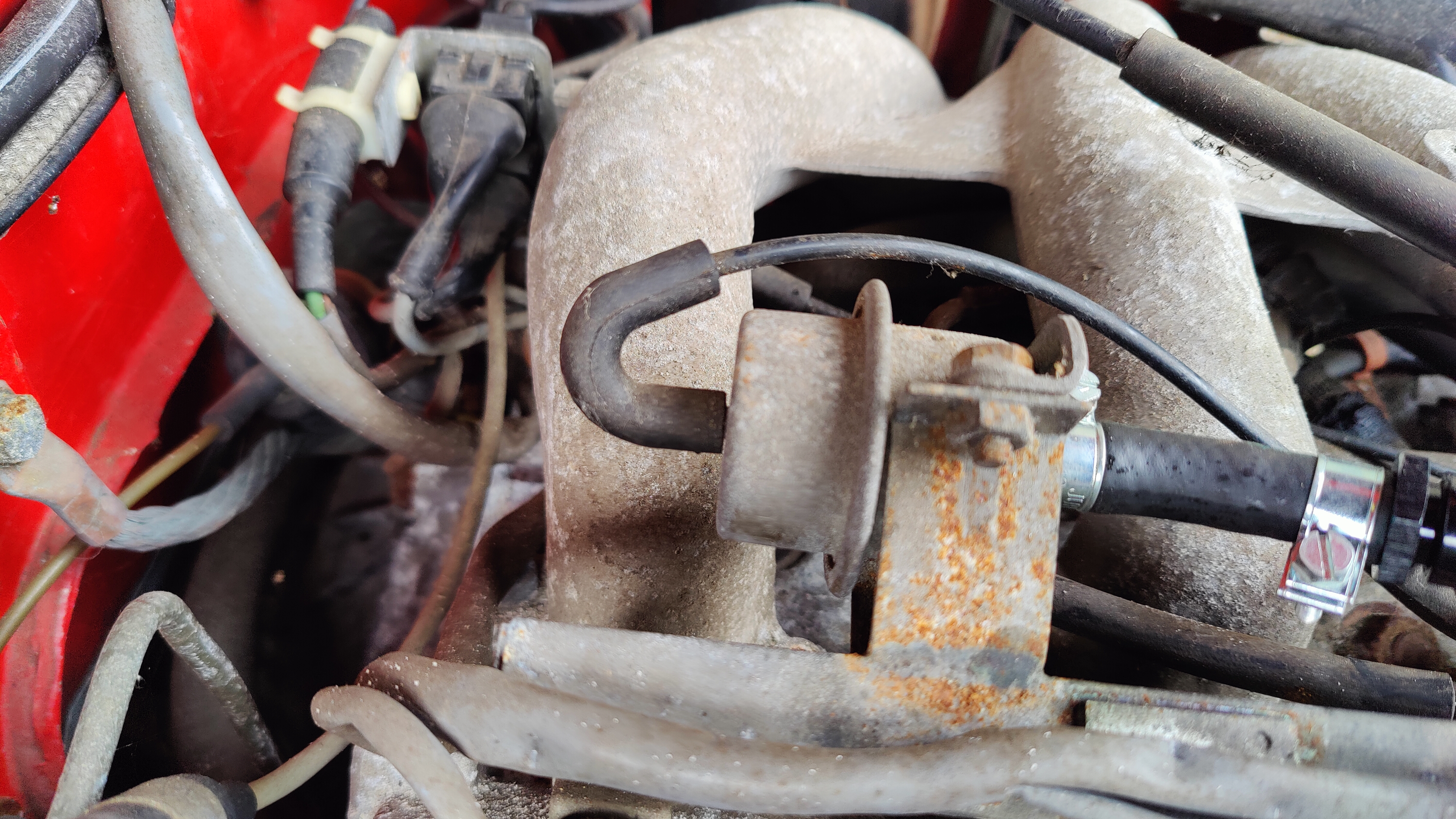

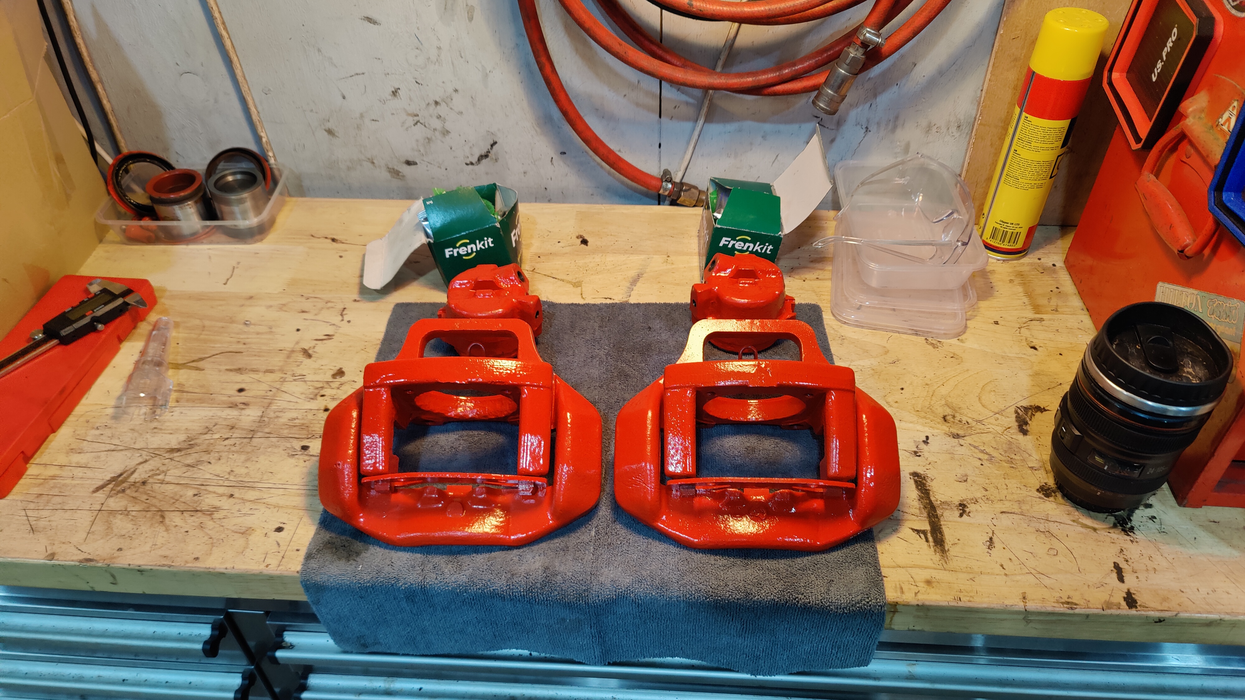

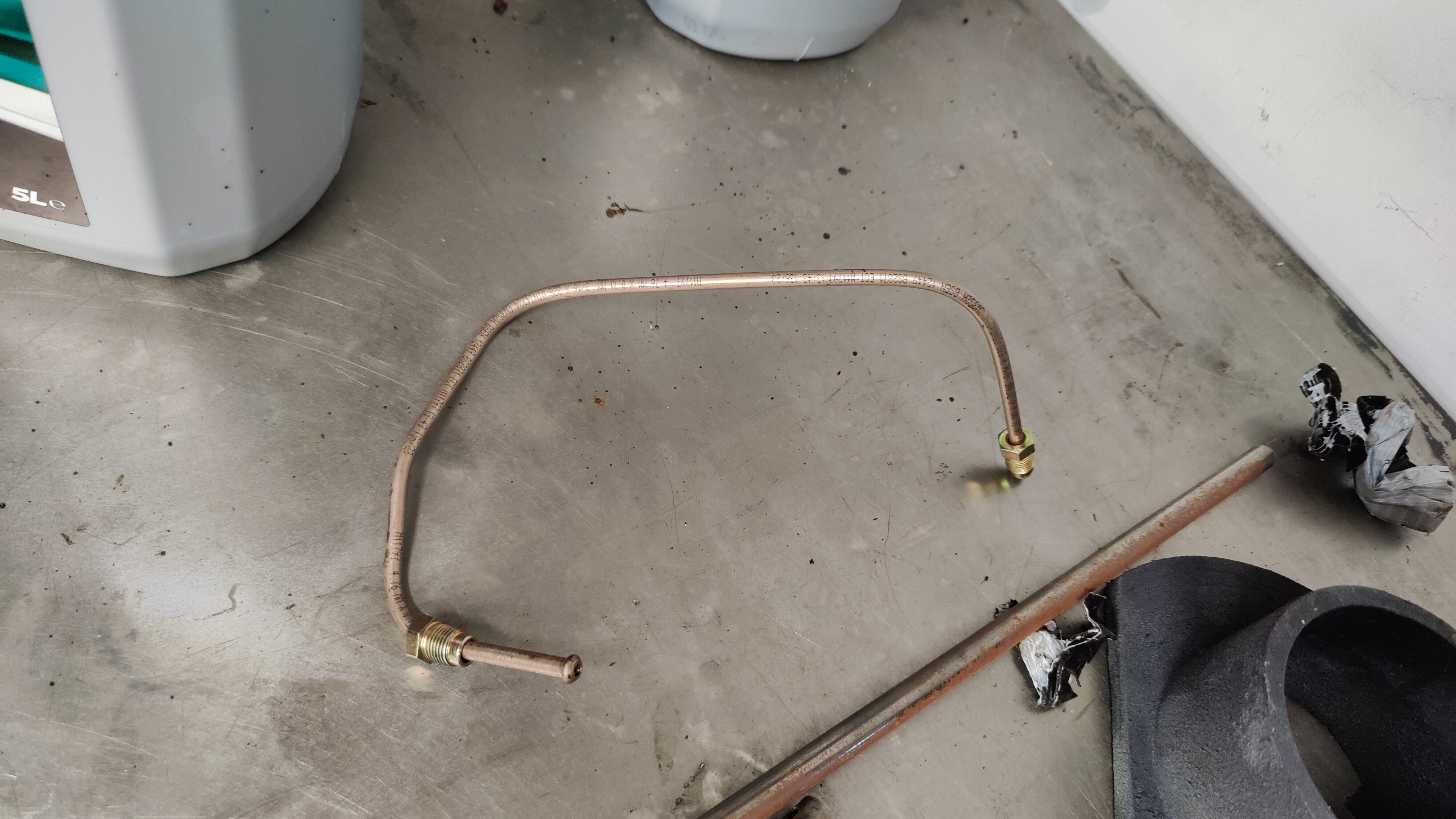

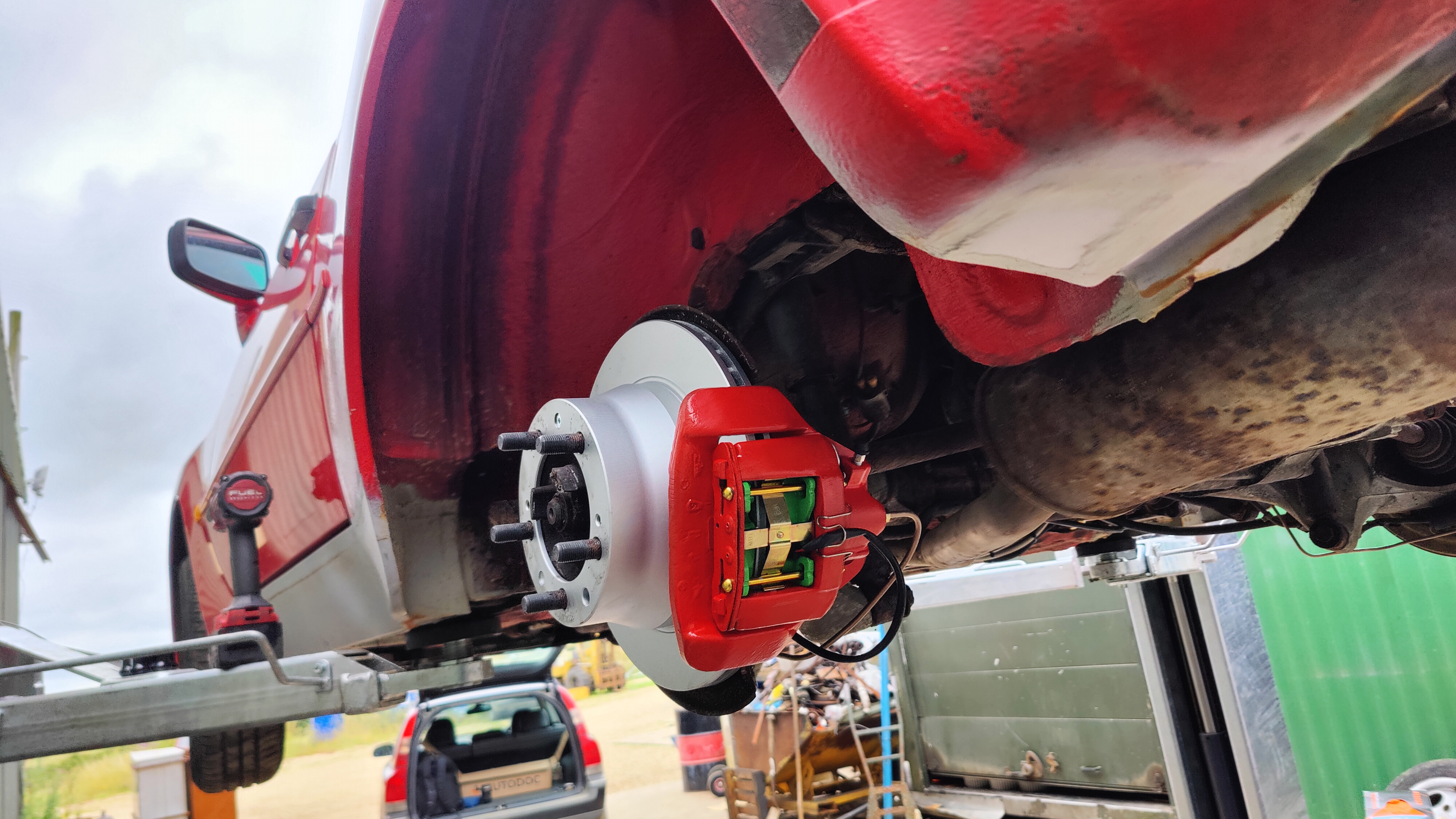

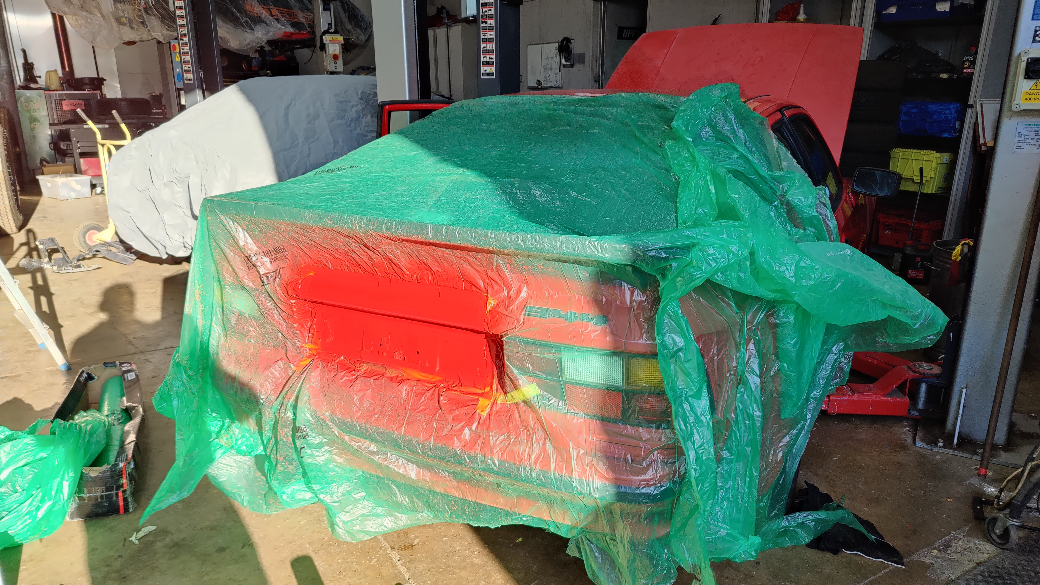

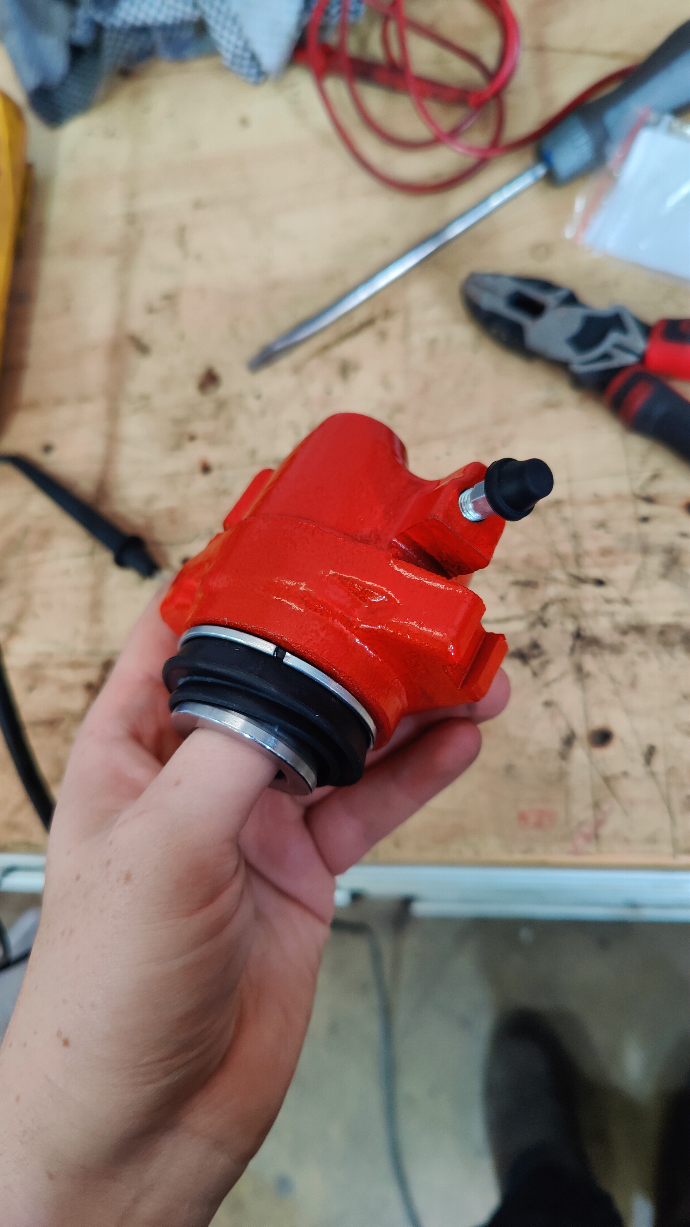

since the last update I have : Rebuilt and painted the rear calipers , replaced all of the brake hard-lines ,replaced the fuel pressure regulator ( this was the main reason it would not start ), painted the exposed primer on the sills and rear valance, replaced sunroof seal , and repaired the blowing exhaust.

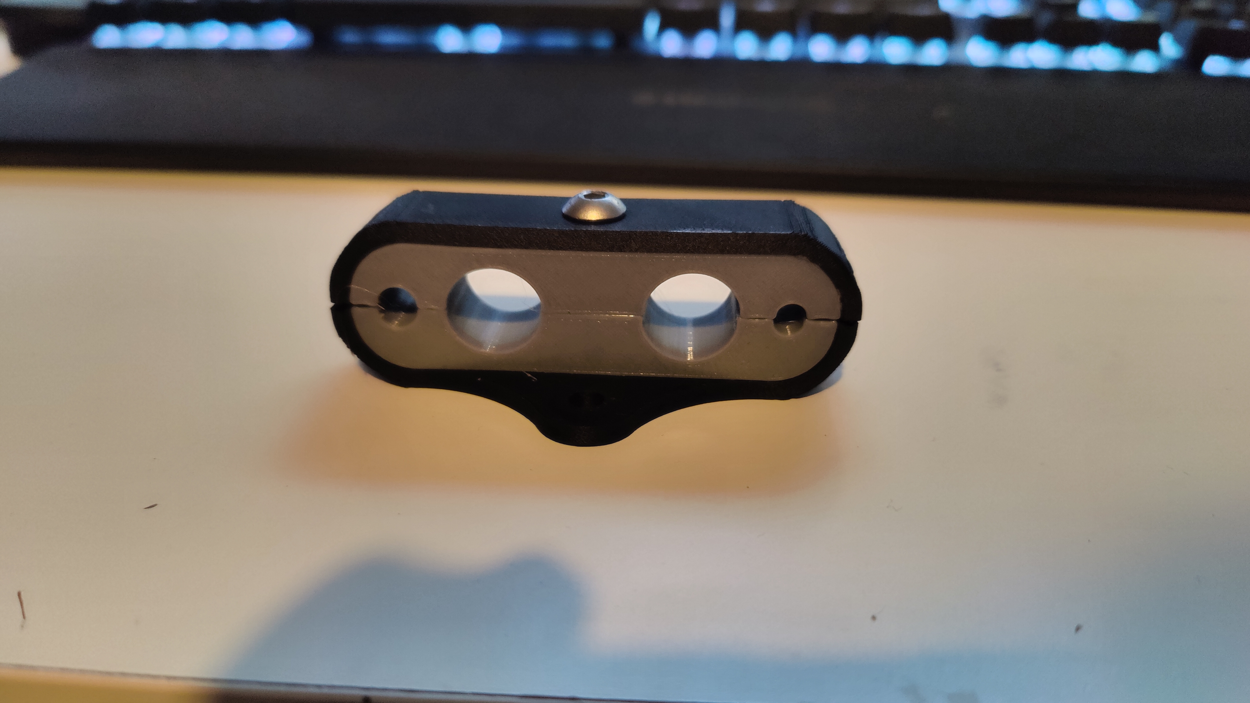

I have also designed some 3D printed fuel and brake line clamps, these are ok for now but I am not entirely happy with the strength of the outer fixing , this may have to be made of metal or I may make an updated and stronger clamp . The faulty Regulator rebuilt rear brakes one of the new brake hardlines My 3D printed clamps shown both off the car and attached the central grey inserts are made of a rubberised TPU filament to ensure that the hoses are clamped well enough the outer clamps are PLA-CF reinforced but still flex too much allowing movement when the hoses are under load .

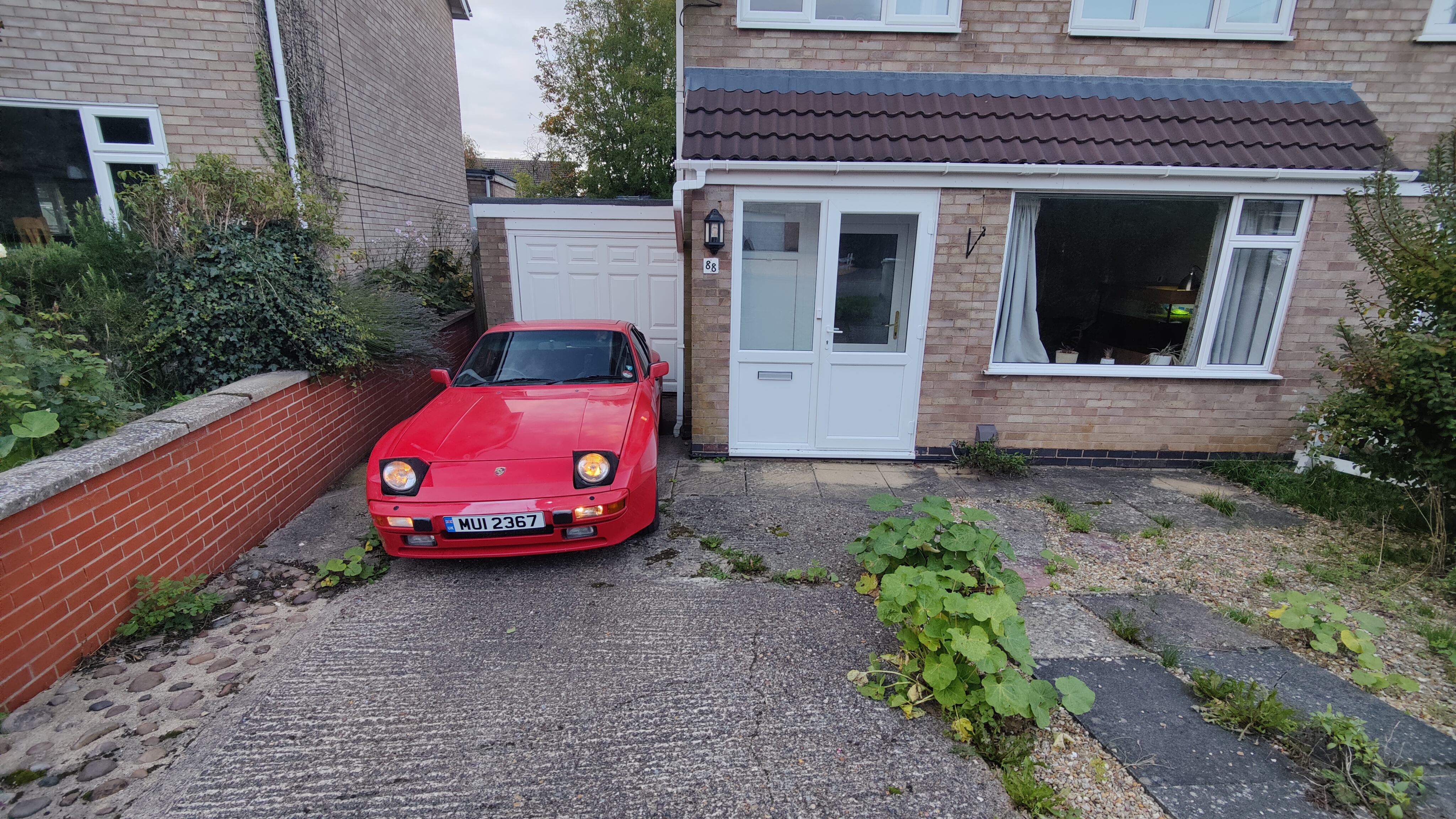

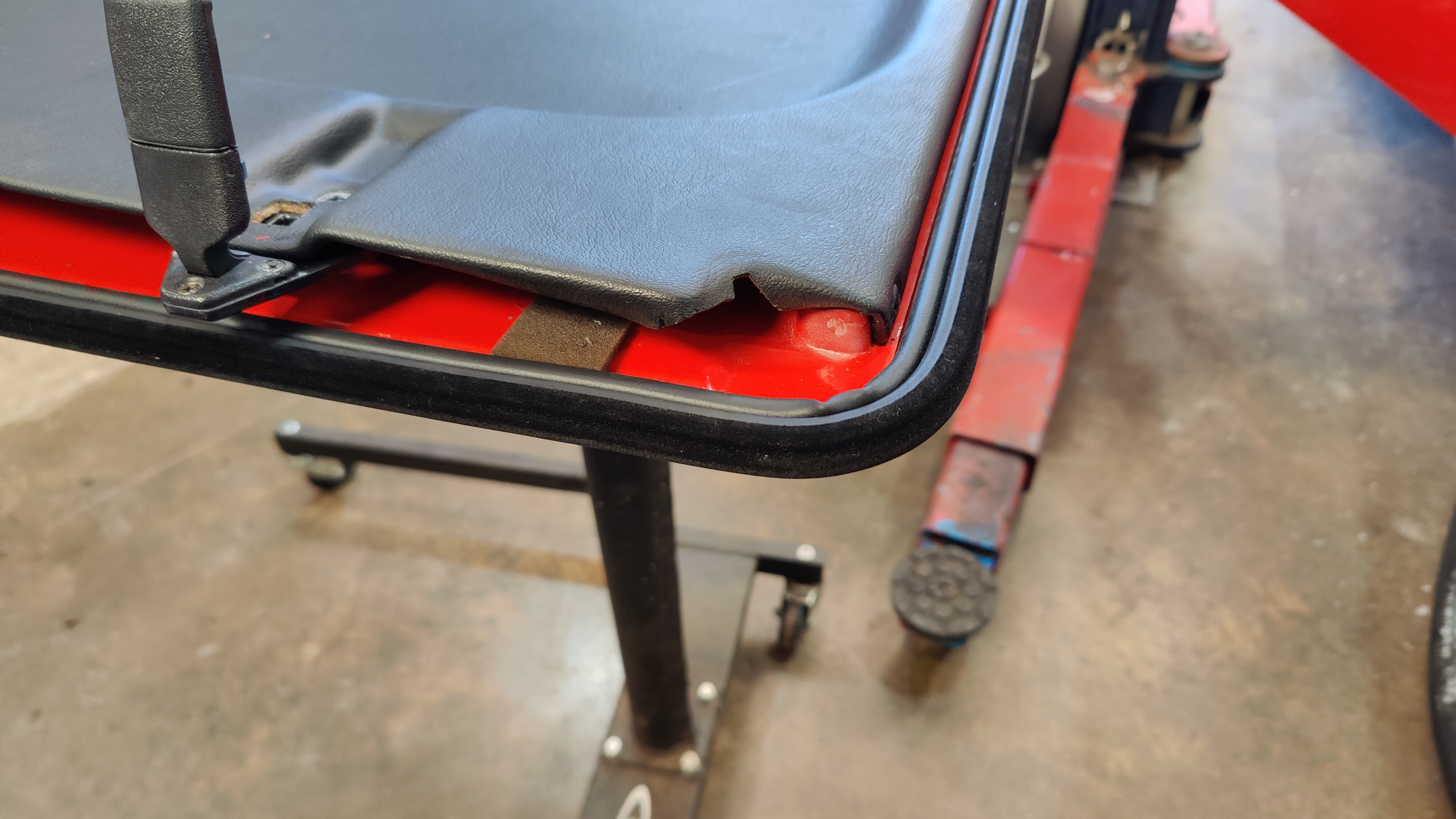

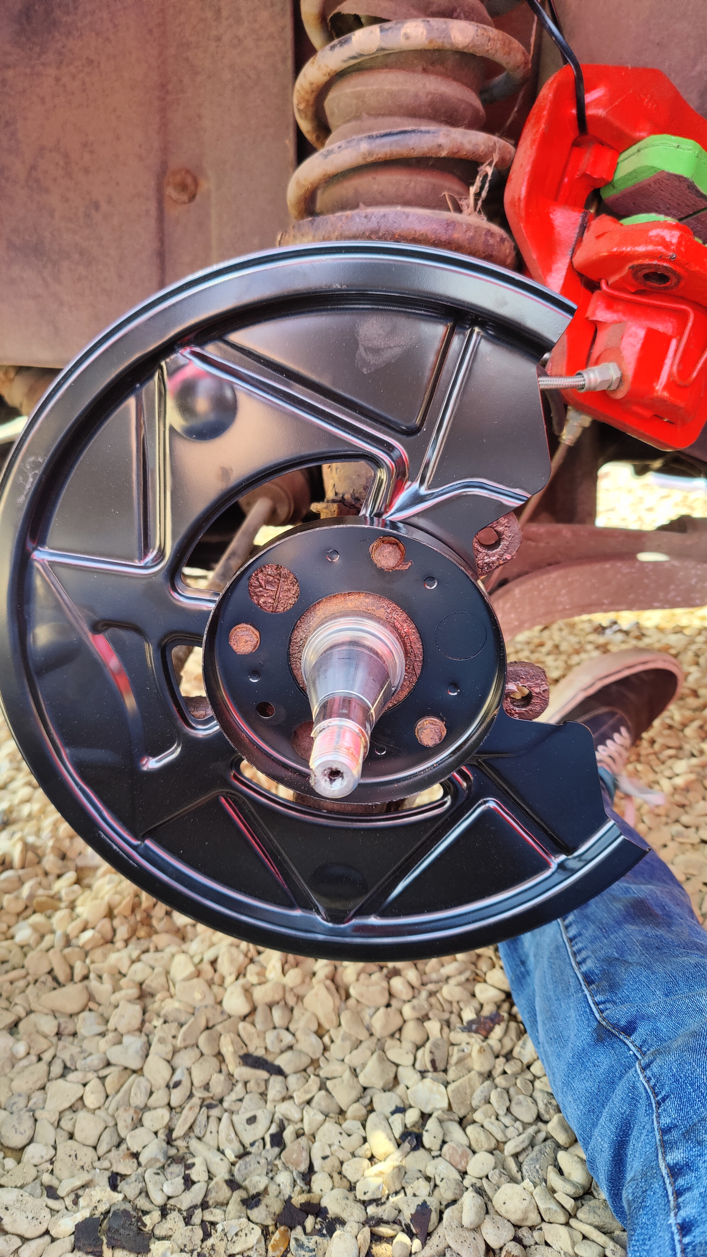

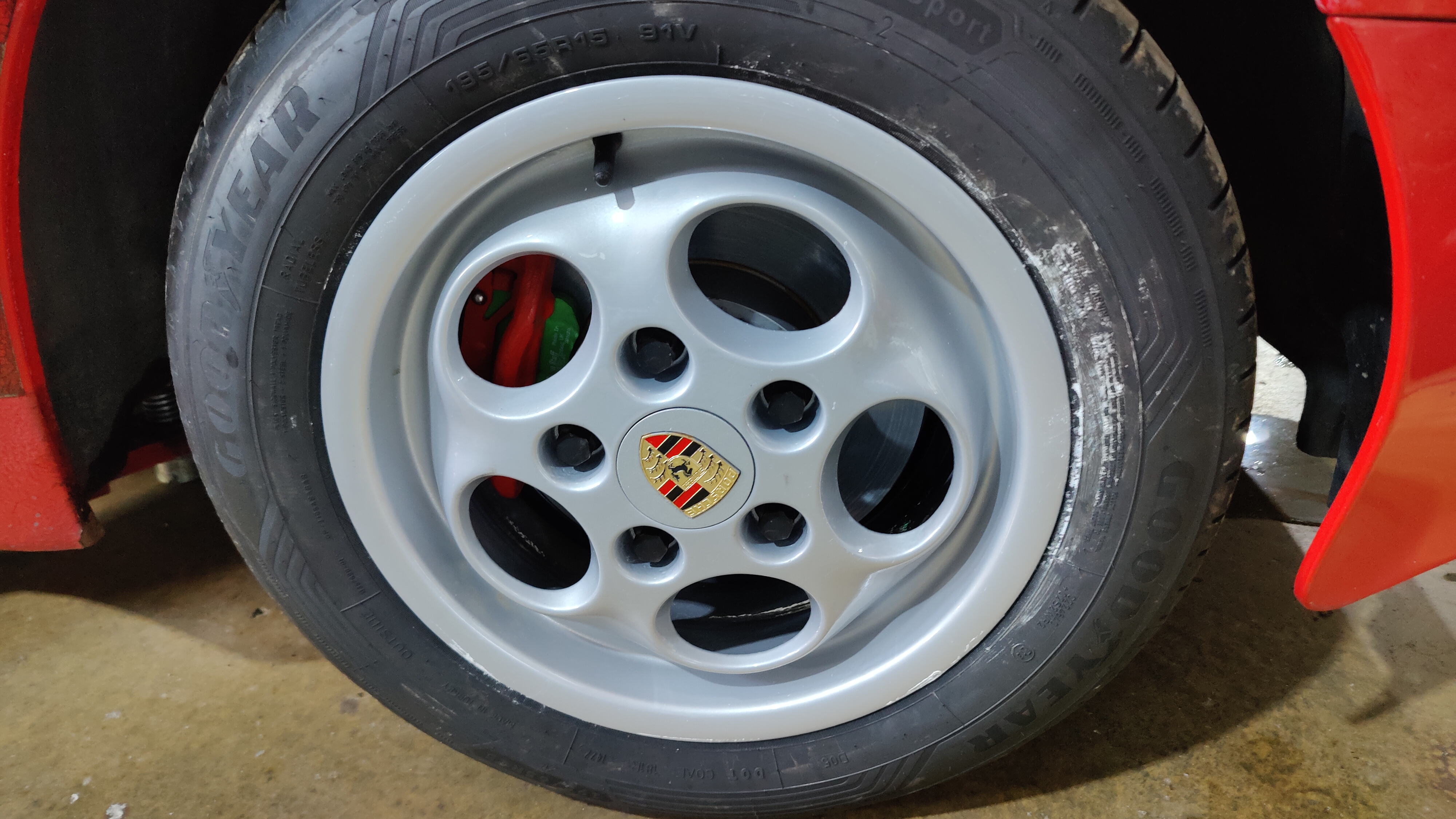

among the other things I have done include ,refurbishing the wheels , a new set of tyres , new brake backing plates , restored the fuel pump cover guard , new fuel tank straps , replaced the speakers and head unit, and finally reinstalling and refurbishing the turbo rear splitter new brake backing plates new sunroof seal refurbished wheels and new tyres paint on the sills painting the rear valance home after the drive back from the MOT
