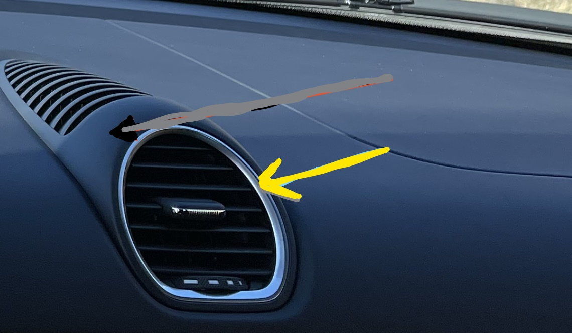

While I continue to modify my interior with the goal of getting rid of all plastics and shinny silver "metal", I keep coming back to the idea of the air vents. It does not bother me enough to change out the whole air vents, but I have always been curious if it was possible to just pop out the silver/metal ring, and paint it black...
Has anyone attempted to pop them off? I have read on other forums some people were able to just pop them off without having to take off the whole air vent....
inkedscreen_shot_2021_02_14_at_6_25_05_pm_0f89184c3107abea409c172c22a836c7c067a975_li_fcb79a98a15caaa918dbc5042cb2c29670d3e464.jpg
inkedscreen_shot_2021_02_14_at_6_25_05_pm_0f89184c3107abea409c172c22a836c7c067a975_li_fcb79a98a15caaa918dbc5042cb2c29670d3e464.jpg (86.64 KiB) Viewed 2229 times
-Note my picture

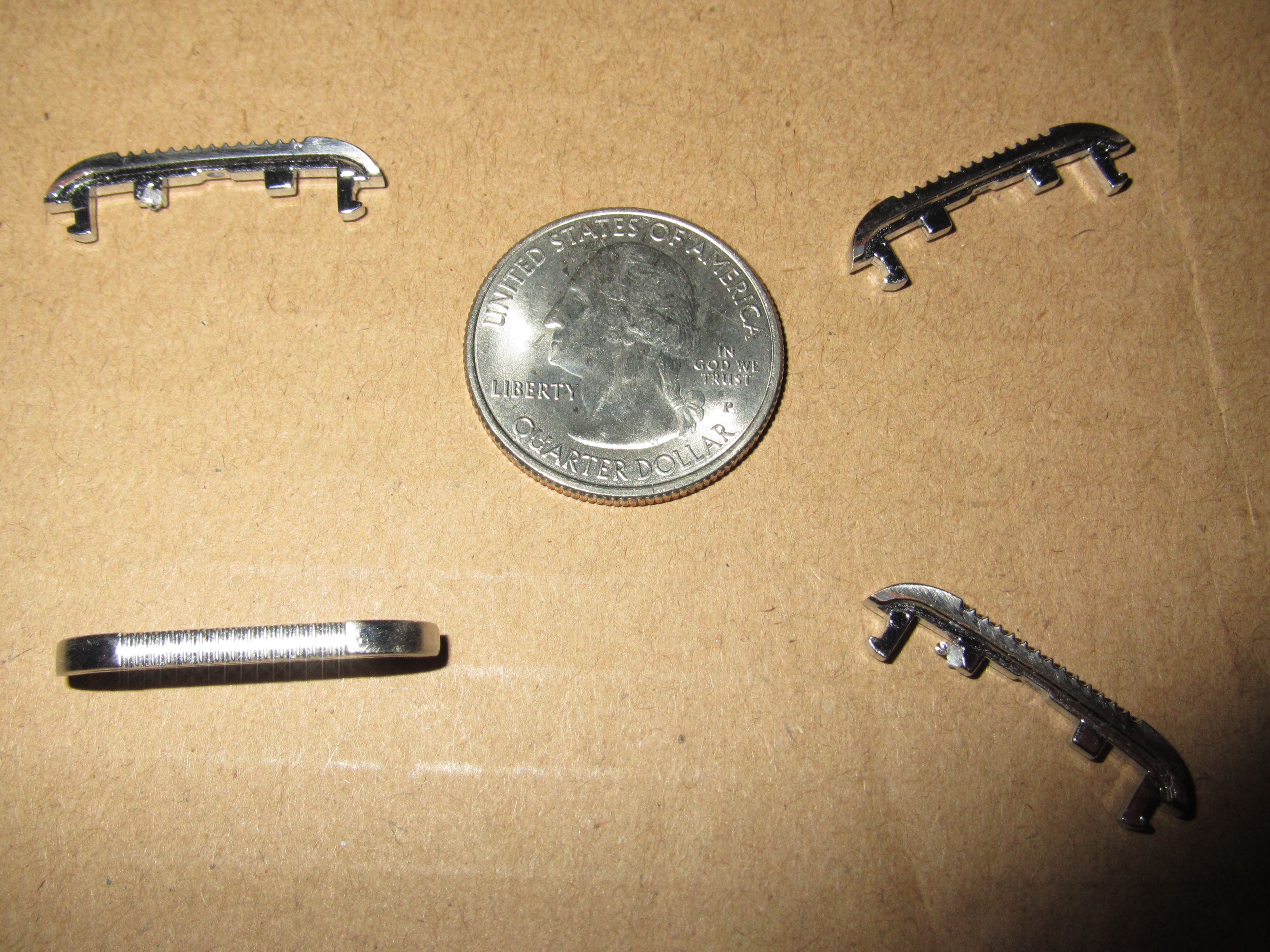

Yes, they pop right off! I use a tiny jeweler's screwdriver, like you get in the little eyeglass repair kit in most drug stores, Walmart, etc. Get it between the trim ring and base and work around a little until you see it separating and you can take it off, and when done painting just snap it back in.
I also did the chrome vent center pieces and radion button trim rings. I think there are threads on how to do these here but they are all easy projects. I recently painted my radio trim rings and vent centers Racing Yellow but left the vent outer trim Satin Black (no pics of that yet).

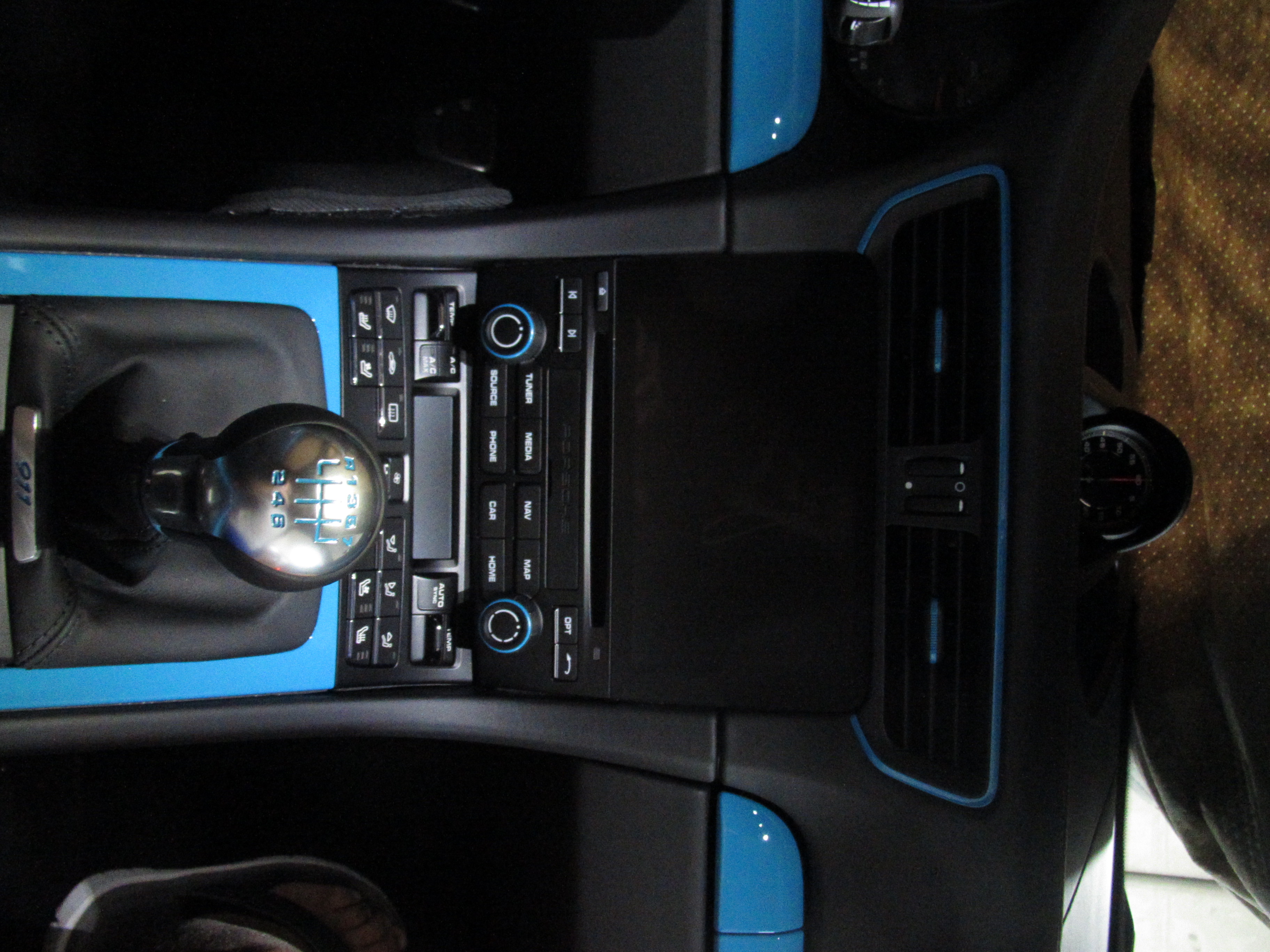

@Bob Z when you get a chance please post a photo of the installed painted radio rings. Don’t those pop off easily?
Re: New Project: Has anyone attempted to change the silver air vent rings?
Posted: Fri Jun 28, 2024 5:56 pm
by Bob Z
Larry C wrote: Fri Jun 28, 2024 5:22 pm @Bob Z when you get a chance please post a photo of the installed painted radio rings. Don’t those pop off easily?
You can see them in the pic I posted but here is one of how they looked painted in the 2019 Targa GTS I had in the past. You have to take the knobs off and take them apart - you will wind up just the chrome ring to paint:

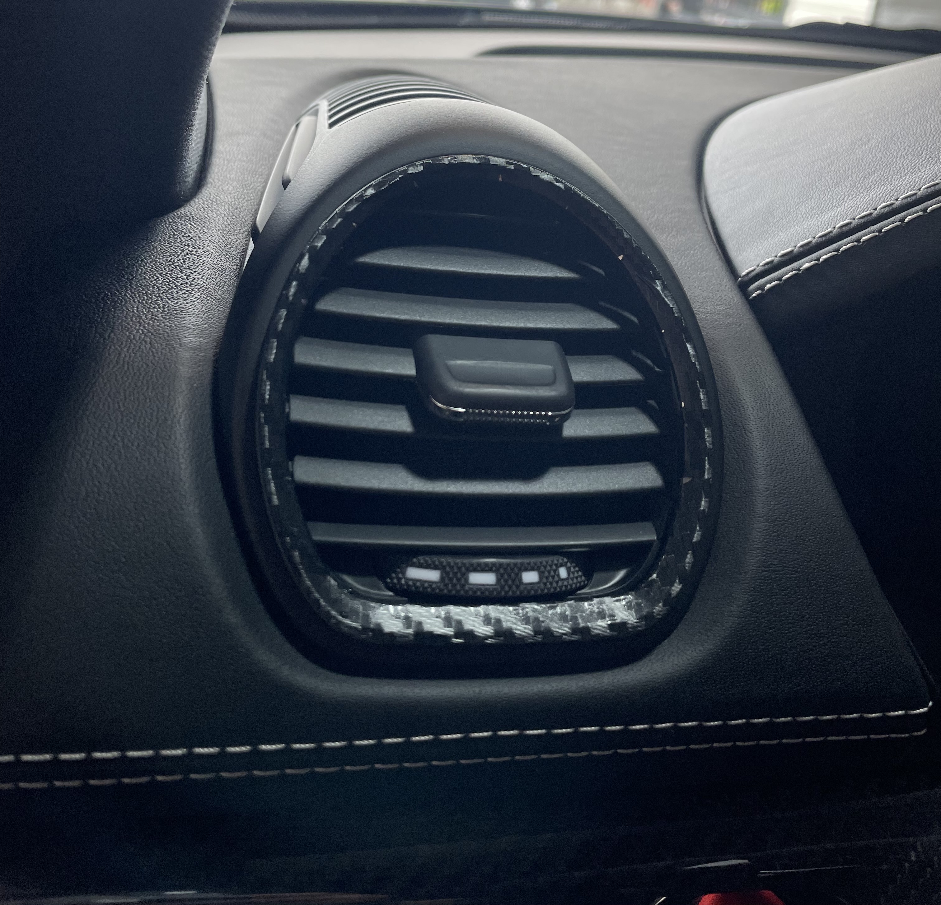

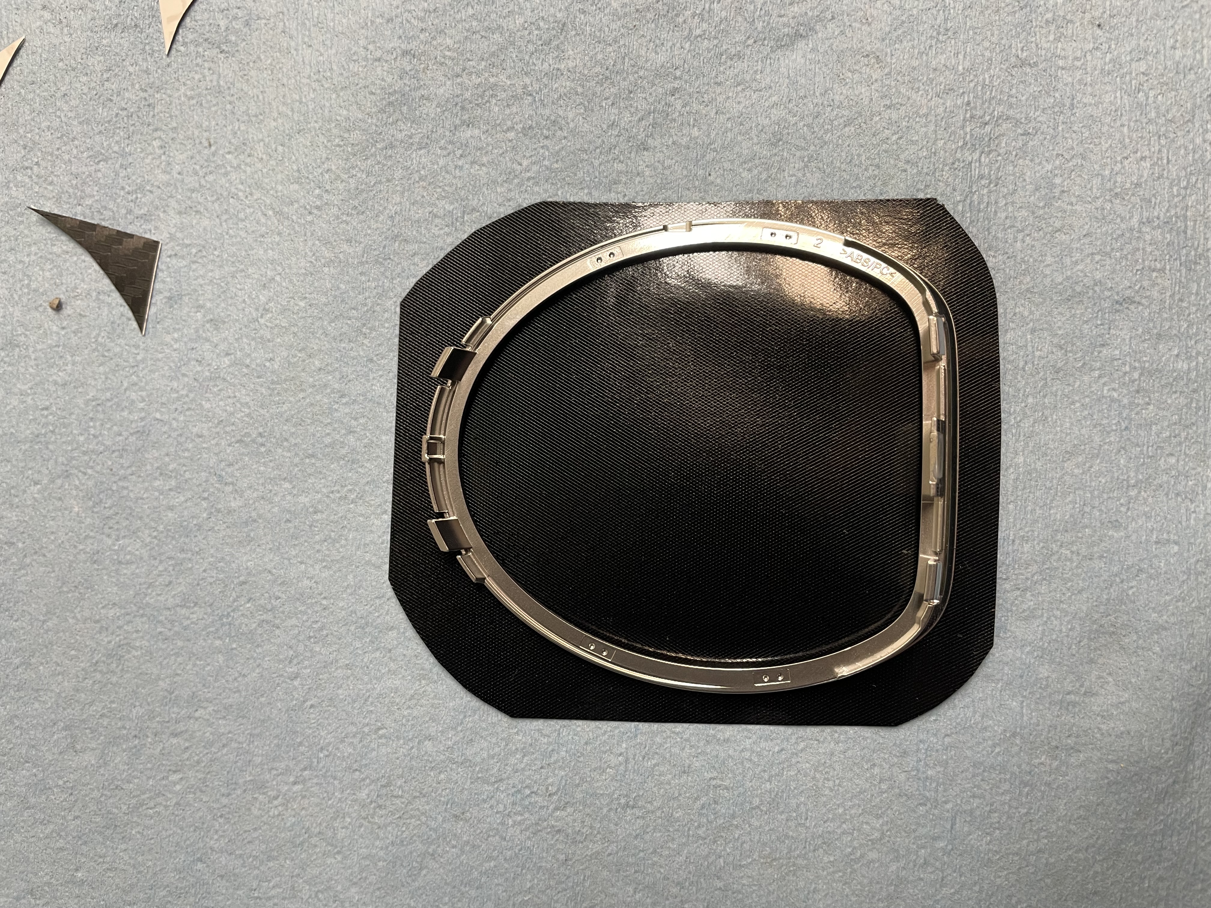

Before painting them, I wanted to try wrapping it in some left over carbon vinyl I had…
Not clipped in all the way, just hovering on it
