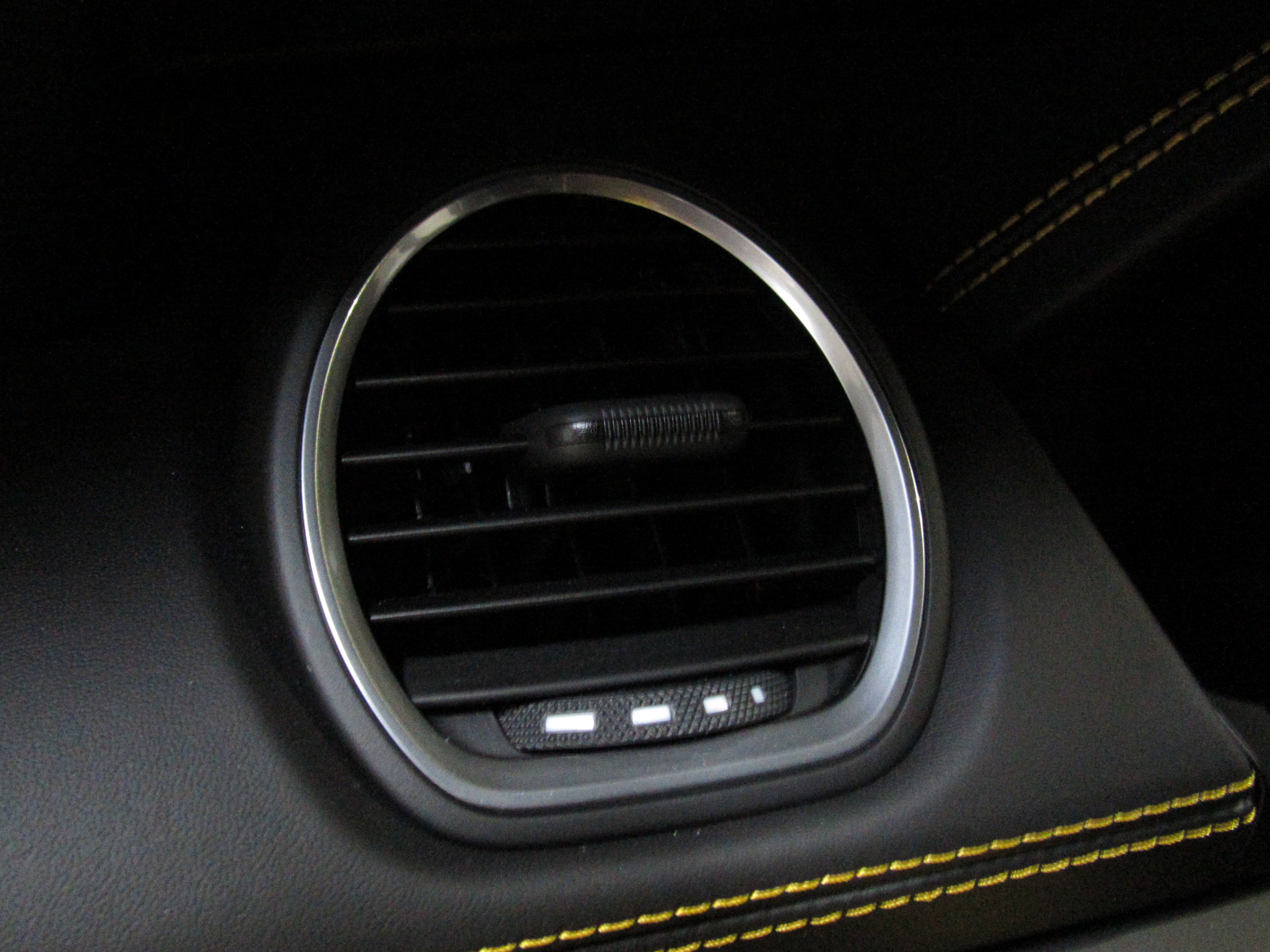

While I continue to modify my interior with the goal of getting rid of all plastics and shinny silver "metal", I keep coming back to the idea of the air vents. It does not bother me enough to change out the whole air vents, but I have always been curious if it was possible to just pop out the silver/metal ring, and paint it black...
Has anyone attempted to pop them off? I have read on other forums some people were able to just pop them off without having to take off the whole air vent....

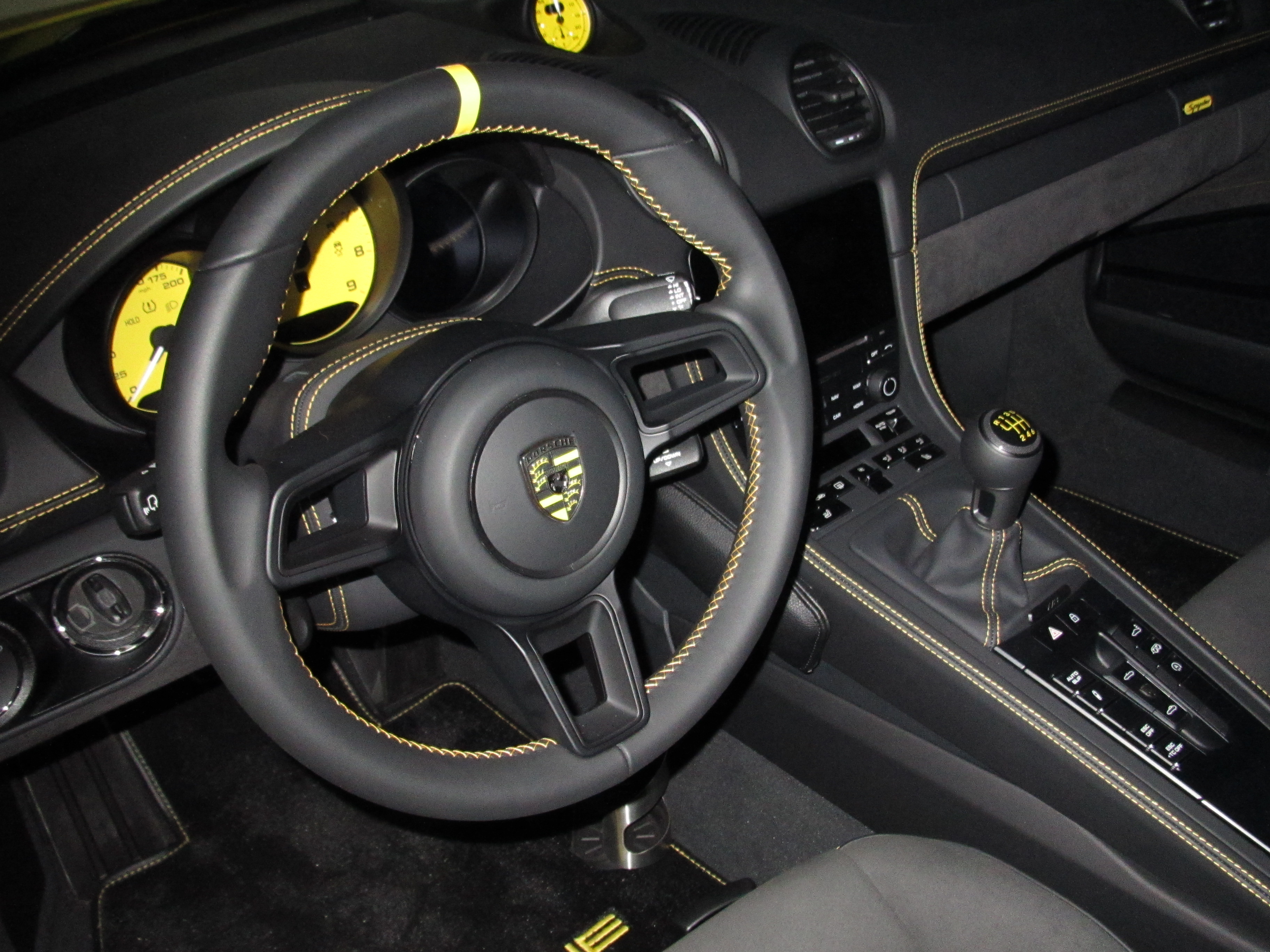

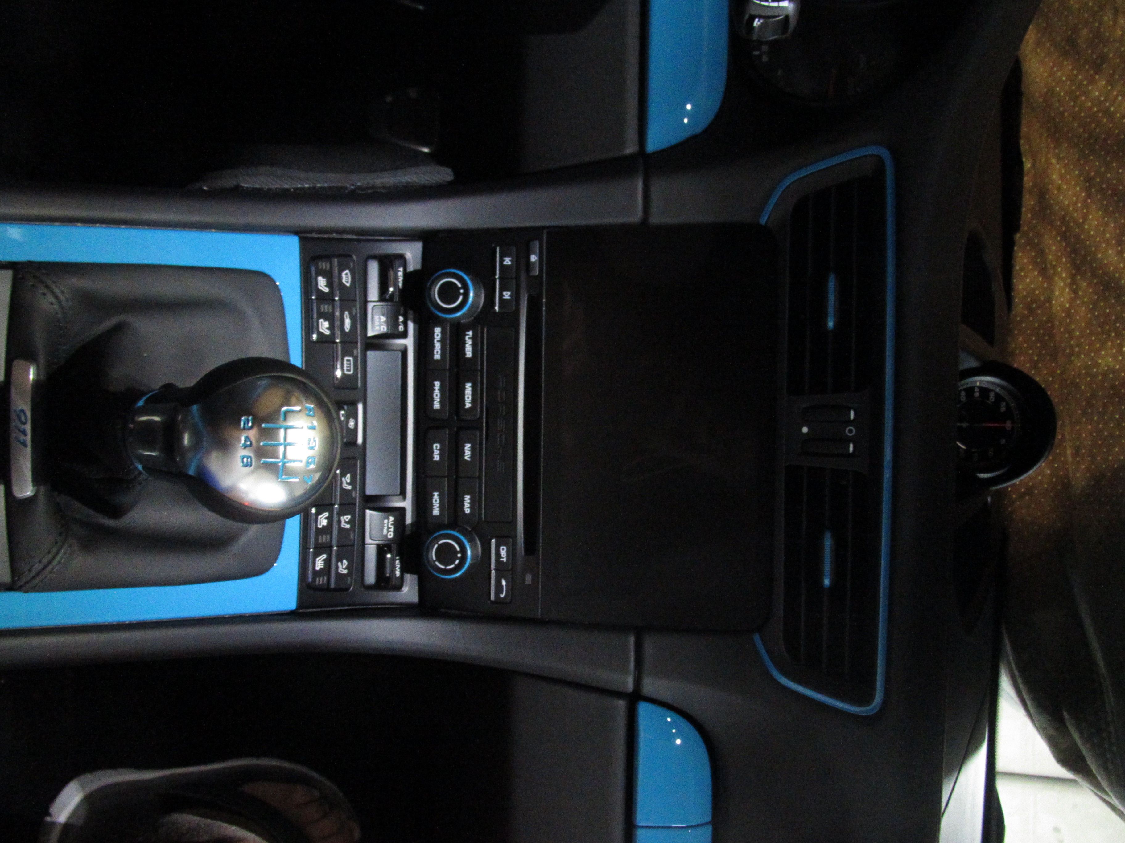

I also did the chrome vent center pieces and radion button trim rings. I think there are threads on how to do these here but they are all easy projects. I recently painted my radio trim rings and vent centers Racing Yellow but left the vent outer trim Satin Black (no pics of that yet).

You can see them in the pic I posted but here is one of how they looked painted in the 2019 Targa GTS I had in the past. You have to take the knobs off and take them apart - you will wind up just the chrome ring to paint:

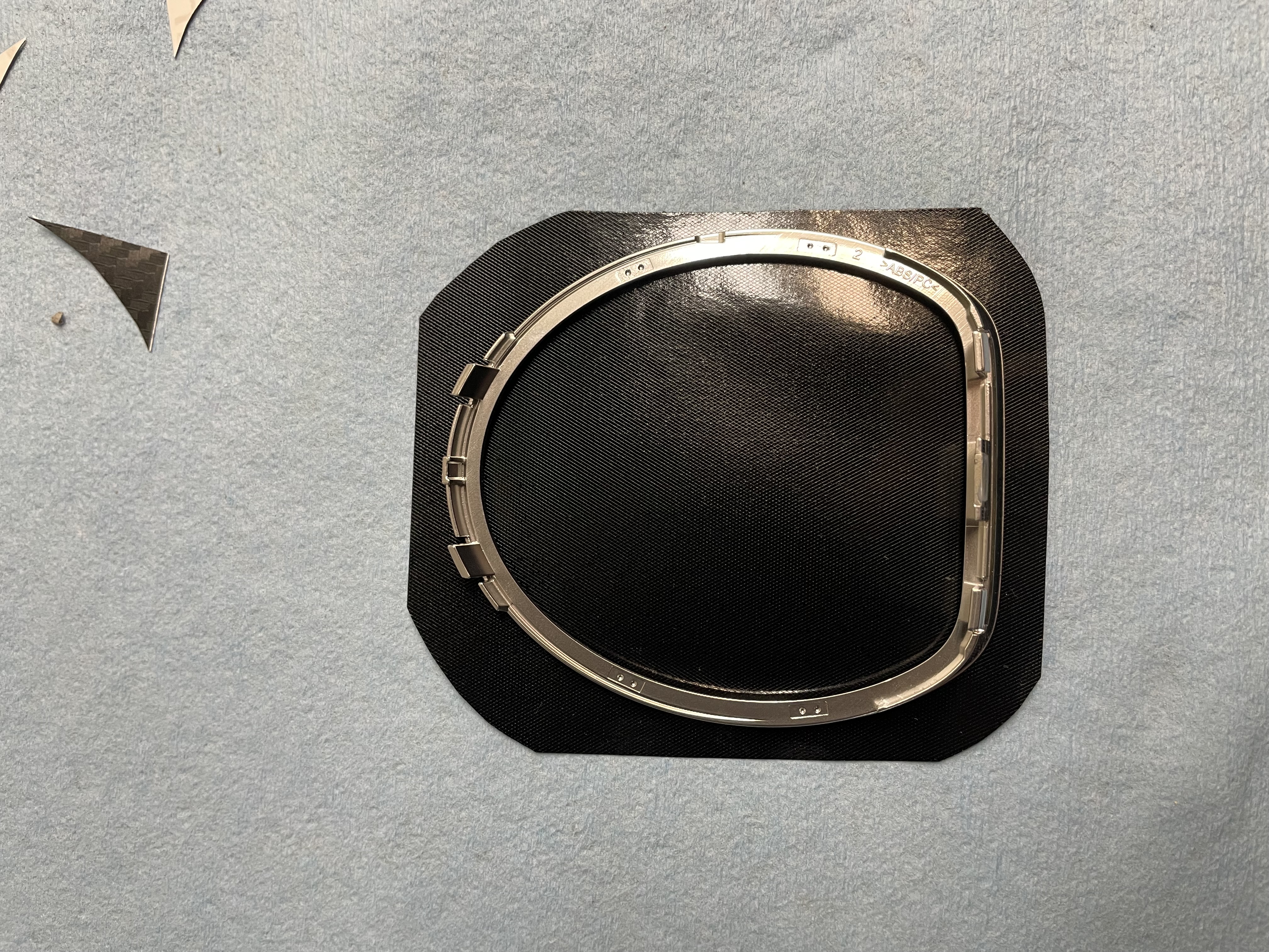

Before painting them, I wanted to try wrapping it in some left over carbon vinyl I had…
Not clipped in all the way, just hovering on it
