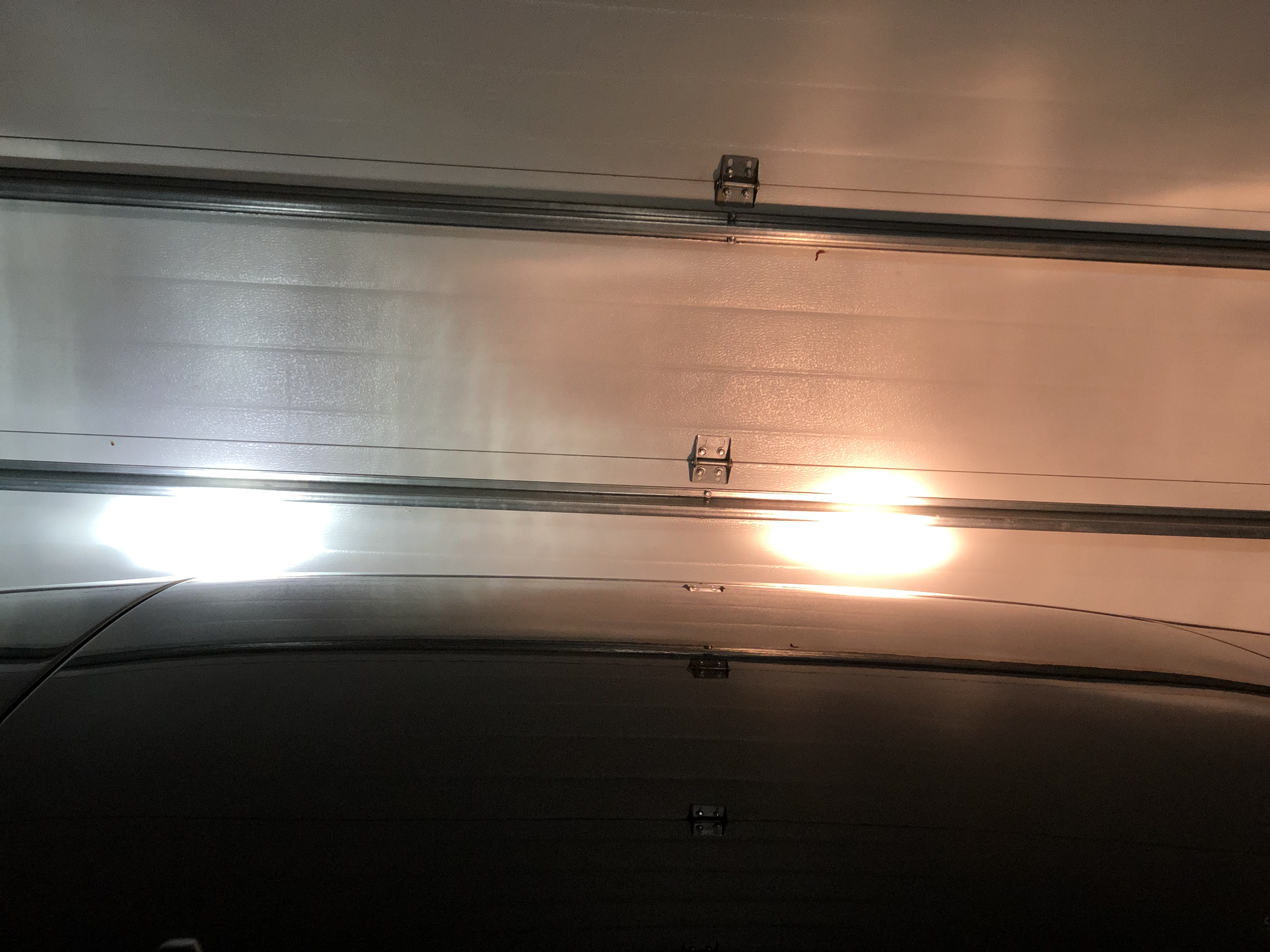

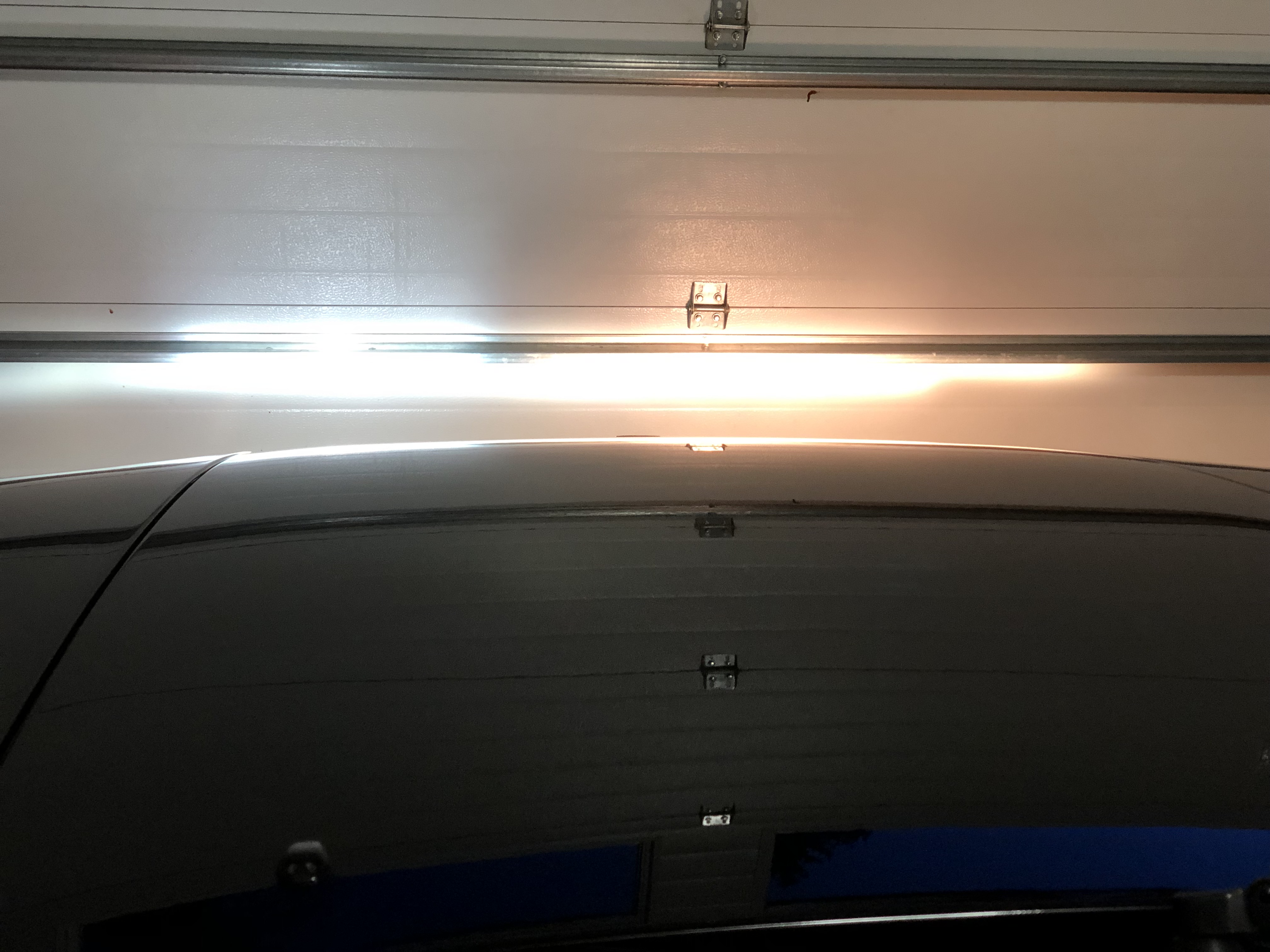

I swapped in some LED headlight bulbs on a whim, after seeing how they improved the lighting in our other cars. Of course the halogen H3's look like yellow candle light now, even with the 100W H3's in both fog and aux main beam sections. I grabbed a couple different extra-bright H3 LED pairs for evaluation on Amazon, installed them on the driver's side but left the halogens in the passenger side. Took the following pictures against the garage door to show the beam pattern (great) and whiter color (great) in comparison, and show the similar total light levels. Again, LED's on the left, 100W halogens on the right. Fogs, then the aux main beams (high beams).

The real fun started when I started removing the right-side lamps, and one, just one, of the four screws was seized/corroded. Knowing that the screw threads into a brass insert molded into the housing, I started out with a succession of screwdrivers with more force, but the screw was in there solid. Not so much twisting that it might damage the insert or spin it in the plastic. I ended up using a left-hand drill bit in the rounded screw head, very low speed, hoping the screw would break loose when the bit grabbed the head. But it just did the drilling not the grabbing or unscrewing. Once the head was off, I was able to work the front section off the housing, then remove that housing to the bench. Soaked in Kroil for a few hours, the stub of the screw came out with just a little twisting with Vise-Grips. I found some machine screws 4x18mm at the local Ace Hardware, but also ordered some stainless fillister head screws and washers for the final fitment. Same size and heads as the factory screws, but no rust this time. Anti-seize on the threads this time too. I'll replace all eight, and never look back.
Better lighting in the process, fringe benefit!

I have not yet found the perfect option, unfortunately. I've tried four different versions so far, and decided on the least-poor of the presented option. The challenges, as you may already know, include the shape and alignment of a filament vs. the LED emitters. The lamp reflectors are relatively small, so even small differences dramatically change the shape of the light pattern coming out. I use the fog lights as pseudo DRL's, and the larger scatter for those is actually desirable for that duty. For the aux main beams/high beams, the LED's I've tried so far offer no direct forward emissions, so the quality of the reflected light beam is completely dependent on the correct emitter alignment. The LED's aren't really cutting it there compared with what they replaced, but are acceptable especially considering the limited duty the car sees these days. They work fine for flash-to-pass duty though.
