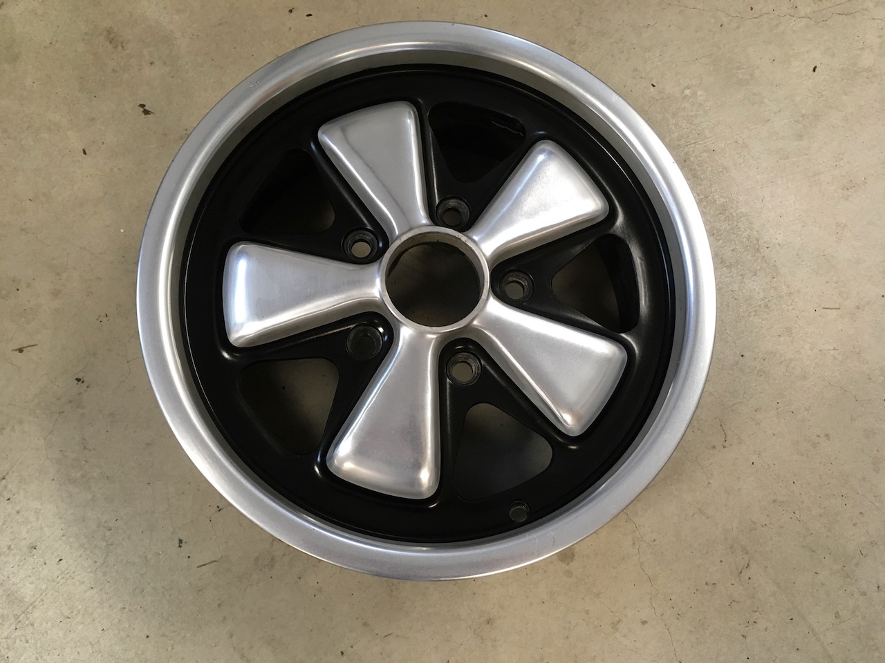

Here are the wheels I did for my 71 911. I grit blasted them, polished the lips, painted the inner section satin silver, and the section between the pedals satin black.
Cheers
Engelbert

Engelbert: that wheel looks great! You did a fantastic job.

The bar is set very high !
Beautiful wheels !
