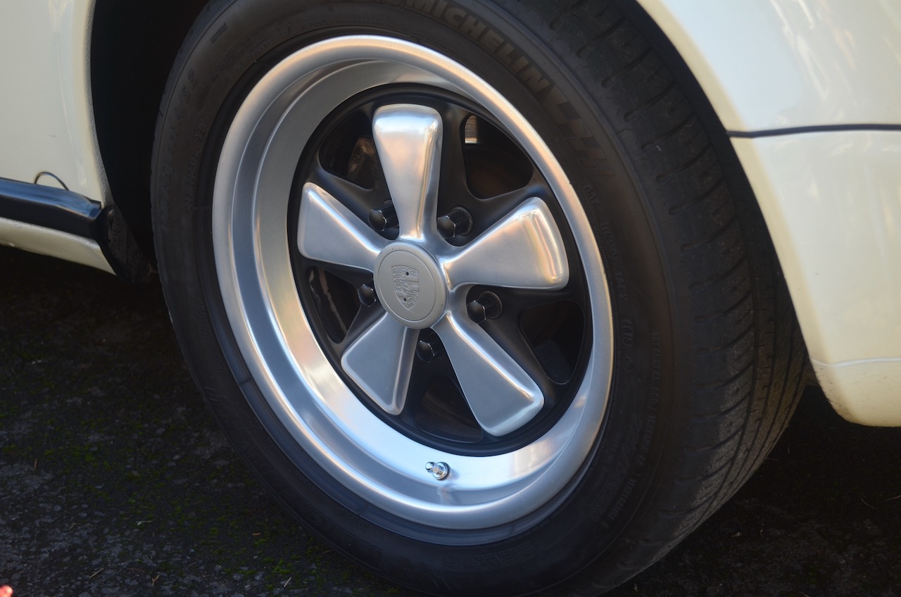

I've done this a couple of times. Used Rustoleum Satin Black, was #7777, now looks like it may be #346951 Satin Canyon Black.

Arne2 wrote: Sun Feb 18, 2024 12:42 pm I've done this a couple of times. Used Rustoleum Satin Black, was #7777, now looks like it may be #346951 Satin Canyon Black.
Gosh, those wheels look great. Nice job!

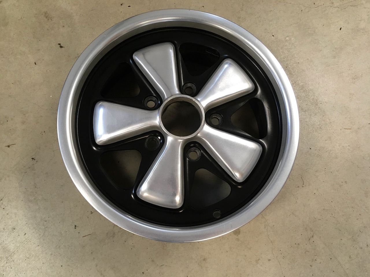

I used also Rustoleum satin black, and it looks great and lasts pretty good. You just have to leave them alone for a week or so before mounting tires etc.
I also use some small fender washers of the size of the area where the lug nuts go, and small screws so these sections are not painted. It's a lot easier as masking tape.
Here are the wheels I did for my 71 911. I grit blasted them, polished the lips, painted the inner section satin silver, and the section between the pedals satin black.

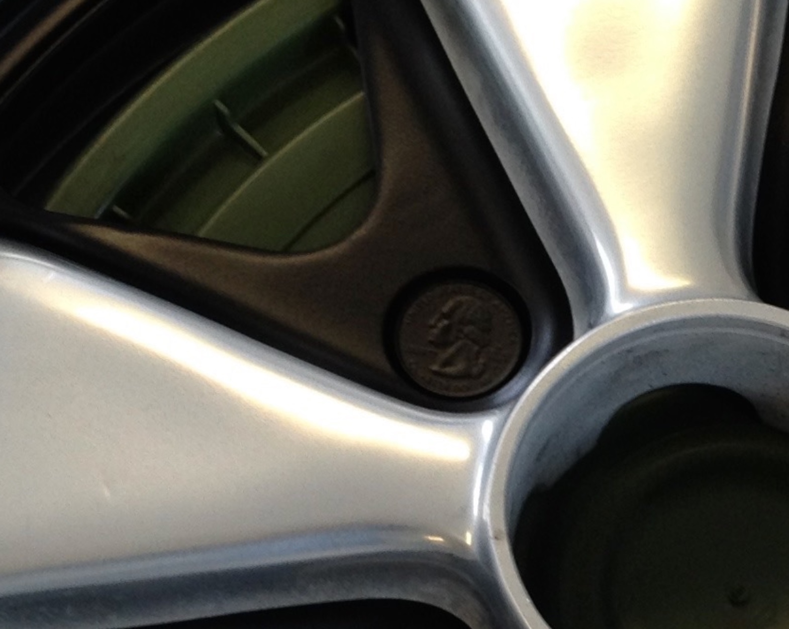

Carmagic wrote: Fri Feb 23, 2024 2:40 pm I also use some small fender washers of the size of the area where the lug nuts go, and small screws so these sections are not painted. It's a lot easier as masking tape.
Quarters work well also, if you can spare them. :thumbup: In my case, it's easier for me to find 5 quarters than it is to find 5 fender washers of the proper size.
