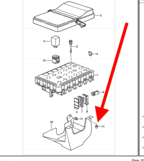

Anyone know the thread size of these? They hold the plastic cover under the dash that protects the wiring from the fuse box. #11 on the diagram
Yes they are still available from the dealer but mine is quite the drive and they don't ship. I just want to drill and tap some plastic blocks lol

They always looked like they weren't threaded, and just screwed on to course studs. Just my opinion/observation.
If your dealer doesn't ship, plenty of others do such as Porsche Marin or Jim Ellis Porsche.

Ok.. will try drilling small hole and using the stud to tap. Just need to find suitable plastic pieces. I knew there's a reason I keep all the leftover IKEA hardware....

I just looked at mine and found (A) I am missing the cover completely, no doubt thanks to the Circuit City alarm installer from the '80's that left decades of things like this, and (B) I'm with Darwin -- it looks like a jagged post that acts more like barbs than threads (assuming I'm looking at the right posts....).

A visit to your local hardware store may turn up some plastic hollow wall anchors that will serve your purpose.

The yellow anchors work fine.. but I doubt anyone can install one in the rear most position!
Luckily, I have one good original nut left.
That one position needs to be installed with a long-extention 1/4" 9mm (original) socket
