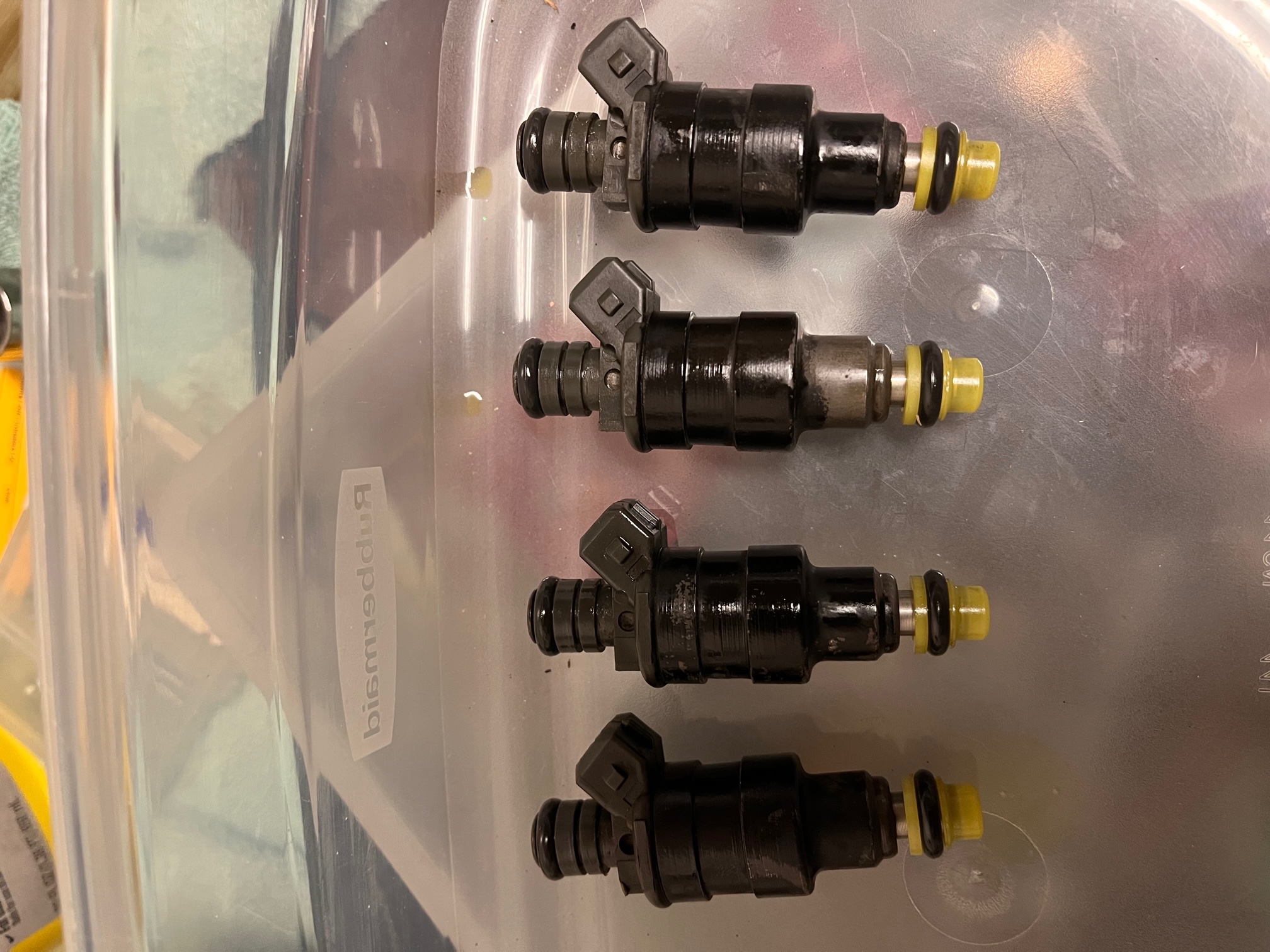

heres my fuel injectors with the yellow caps .. as you can see theres a huge space and it doesn't look right … im ordering the rennbay ones 👍🏻
-Eric
Re: fuel injectors leaking
Posted: Wed Apr 26, 2023 6:27 pm
RED944M5 wrote: Wed Apr 26, 2023 6:12 pm IMG_1998.jpeg
-Eric
Good plan! That gap isn't right...

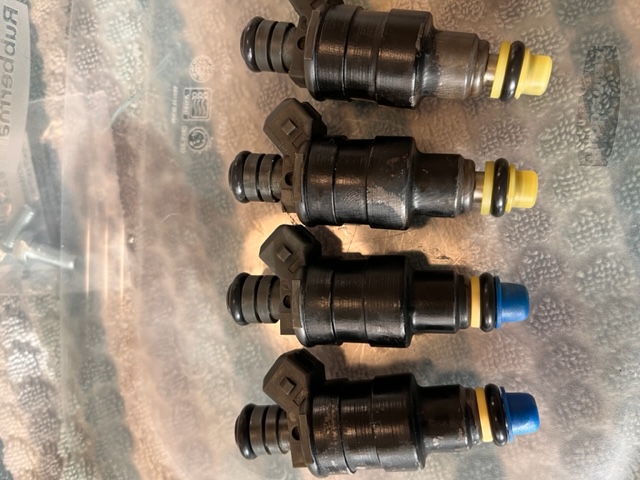

Heres the rennbay ones now in blue appearently, next to the previous leaky ones ... and I just installed the rennbay ones ... works like a charm .. no leaks ... 3d printed timing belt tool and 3d printed cam gear tool worked like a charm, belts all working good, no leaks, no white smoke ... took it for a ride, it's been down for 2 years because I was overseas for a bit .. it was quite exciting to drive it again !!
