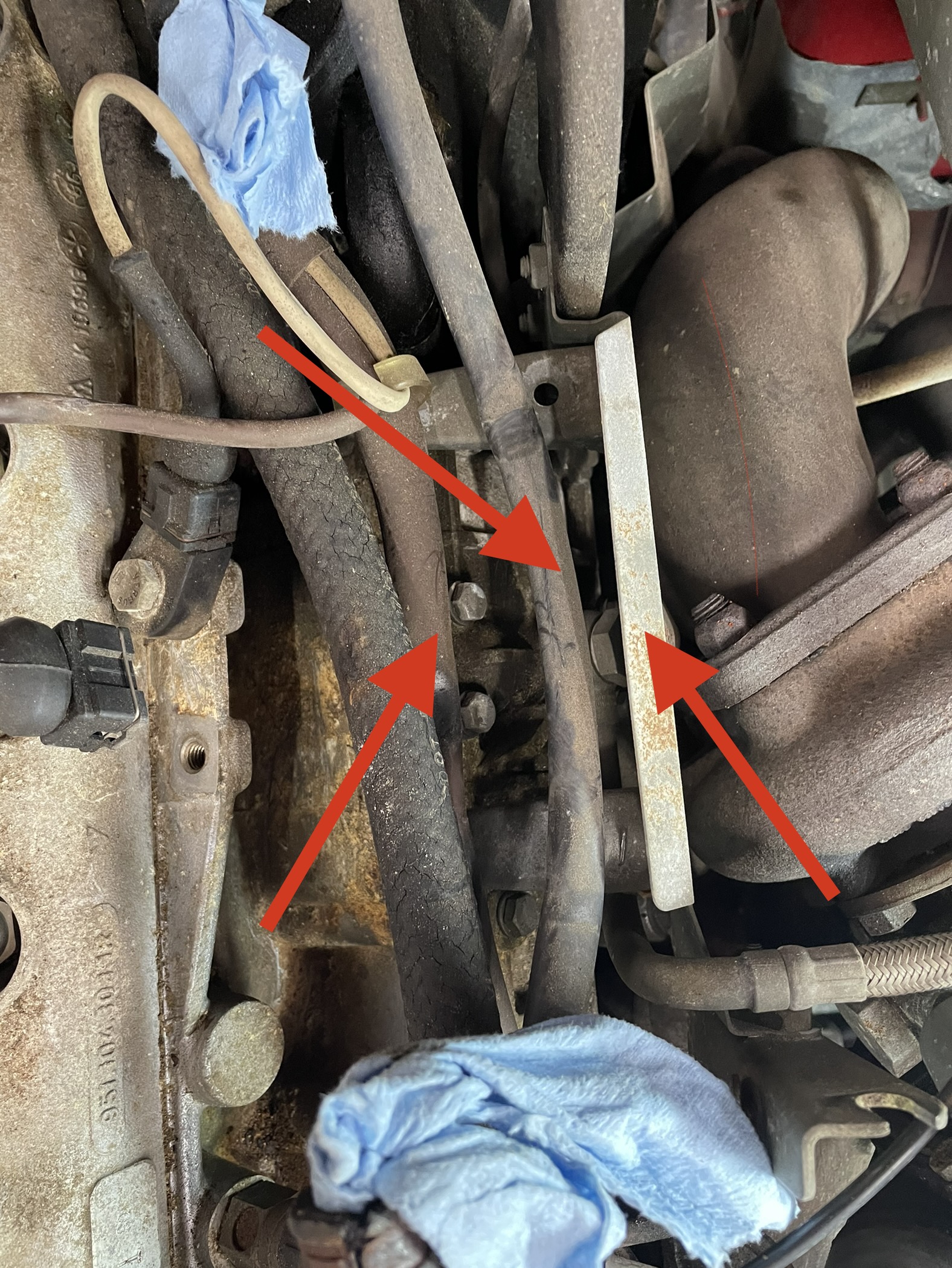

I searched my pictures and here is one that shows the 3 items. The left arrow points to the engine harness, the center to the alternator harness and the right to the shield between the turbo and harnesses.

Both great helps. I thought that it might run alongside the engine harness but just wanted to verify.
Thank you all again!
