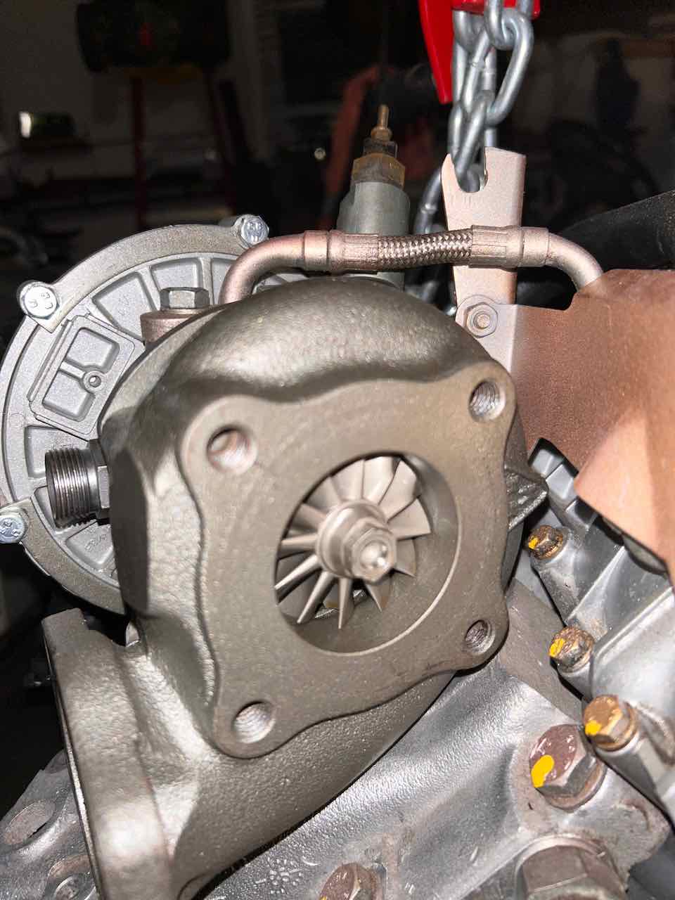

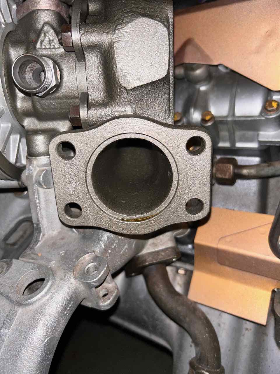

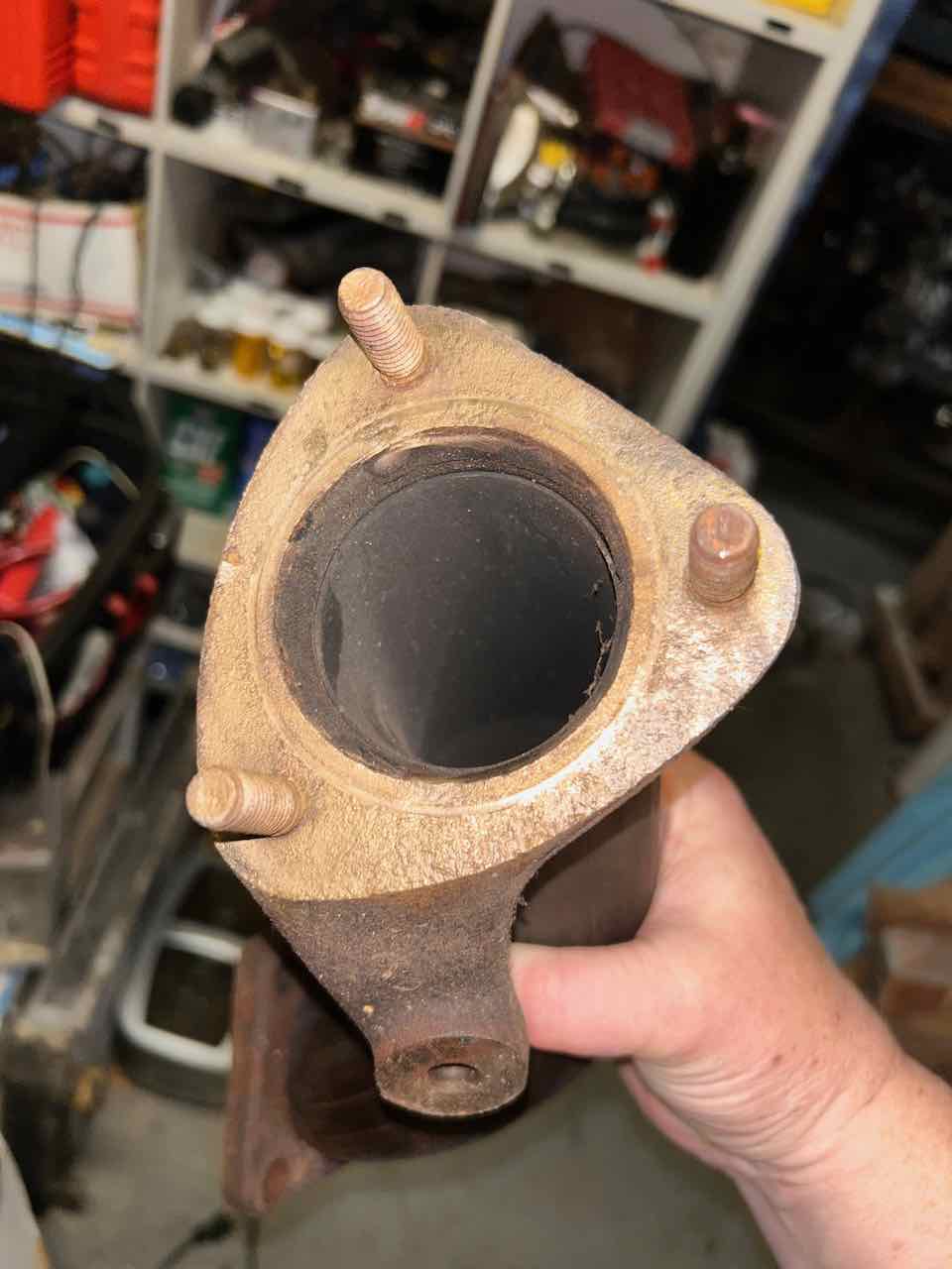

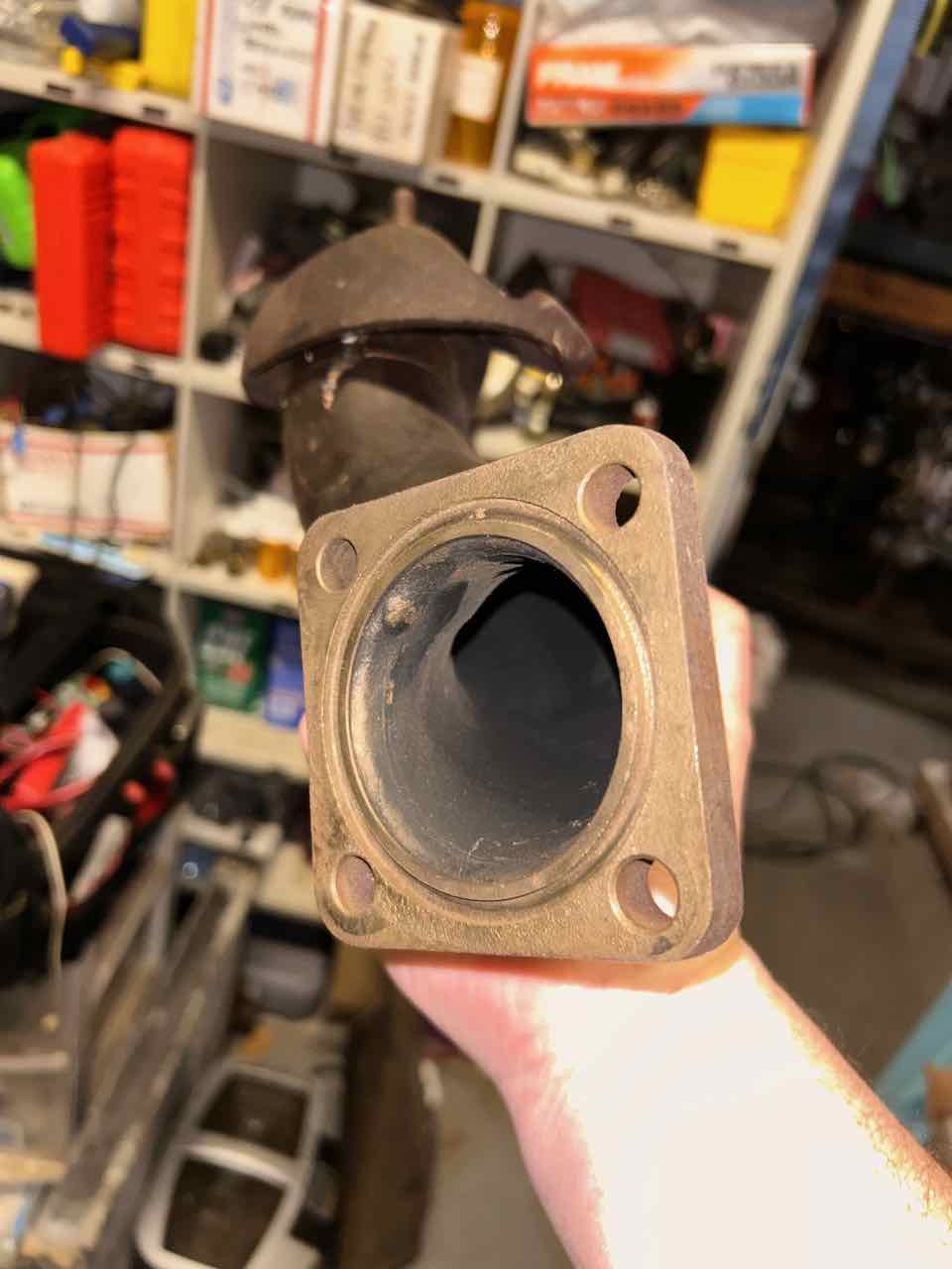

Posted: Tue Mar 07, 2023 5:39 am
by Drscottsmith
As promised here are a few pics...
The last pic shows the turbine inlet connection from the crossover with the nut welded to the back. That really does not like the type of weld I would expect from the factory but maybe so.
Any thoughts or insights appreciated!
