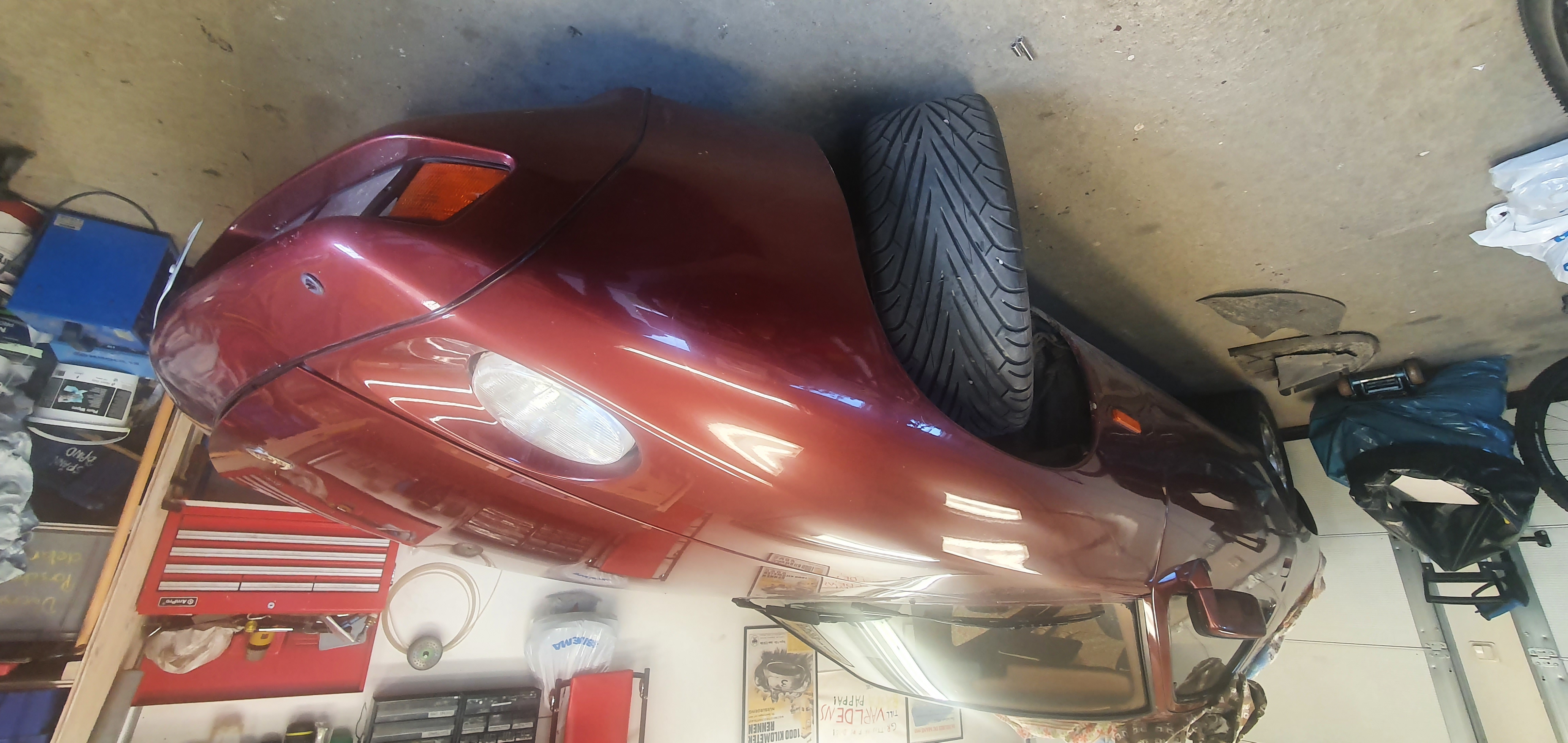

Hi.
My name is Peder Fallbom and live in Sweden. I have been into Porsches for a long time and mostly the models up until 1998. Many of them transaxle cars of which I currently own 3 i different stages of rebuild/modification.
This thread is just to share and hopefully learn some from the refresh I will start of my first generation 928.
It is a 1979 manual non sunroof pascha interior car sold new here in Sweden (my dream spec) It has just a few owners and has 115000km on the odometer so a good base car.
However age and daily use and some neglect makes It needing work in just about all areas to get to the level I want it to be in.
It had a colorchange in the 1980:s to a odd red metallic color which I think is not a stock porsche color. I will return the car to the factory delivered Mocha brown color which can be seen in the pic below. A very deep brown color which I think is very cool and 1970:s.
Also the seats need to be recovered and the interior cleaned carefully.
Long term plan is also to get the engine and all other parts refreshed in some way so that the whole car looks and feels like its around 5 years old not 41.
Tonight I start taking it apart to prep for paint.

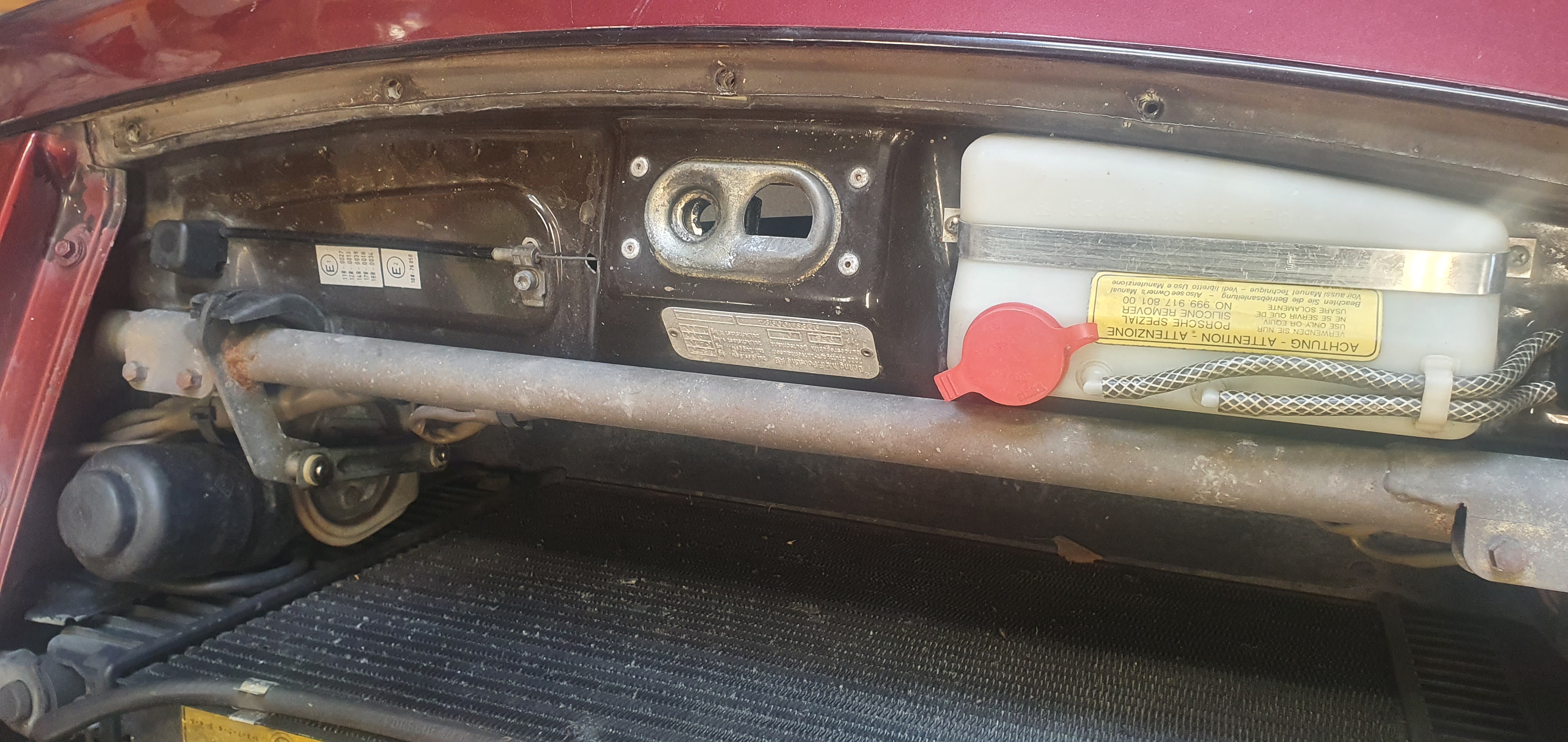

Re: OB 928 refresh
Posted: Thu Aug 26, 2021 8:39 am
by dr bob
Sounds like you have a good handle on the scope of the work.
There's an inspection-list item that grabbed my attention :ugeek: in your front-apron picture, and that's the missing washer and circlip on the link for the headlight motor. No worries if you aren't going to be driving the car before the repaint, as the headlight motor and the crossbar and links will be removed anyway. If you do decide to drive it now, putting a new washer and clip on that link will keep it from coming off and puncturing the radiator. For cars with AC, the condenser is usually the first victim of a stray link. At least yours is missing just the bottom-end pieces, so less risk of serious damage.
Enjoy the project!
Re: OB 928 refresh
Posted: Thu Aug 26, 2021 9:18 am
by Pefa
dr bob wrote: Thu Aug 26, 2021 8:39 am Sounds like you have a good handle on the scope of the work.
Enjoy the project!
Nice catch! I have not seen that, will fix it. Thanks 👌
