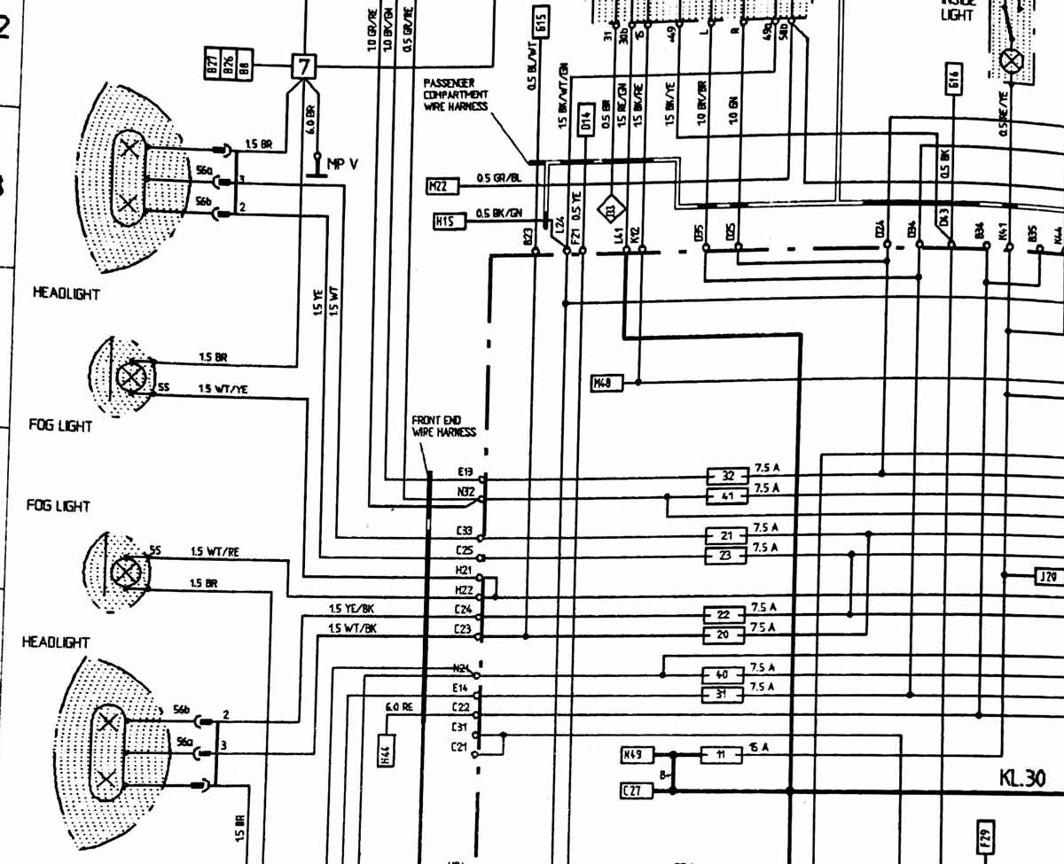

Race5103 wrote: Thu Sep 01, 2022 6:26 am I haven't and didn't think of it. I assumed the circuit flow was from the stalk to the fuse box and not the other way around. I'll play more today and figure out the flow.
I missed the headline about this only not working on one side only. That suggests it's localized to that side and not the stalk. I'll post that section of the factory wiring diagram in a bit, but would have to believe the possible causes are fairly limited on the right side, since the left works -- socket, connectors, harness, etc. Power for the high beams is making its way through the central electrics and switches, etc., but there's a break somewhere on the right side.
Re: '89 S2 No right high beam
Posted: Thu Sep 01, 2022 10:57 am
Here's an excerpt from the relevant page. Looks like all 4 light circuits have their own fuse (#20 through #24), which makes sense so that one bad fuse doesn't take out multiple lights. If you haven't already checked all 4 of those fuses, I'd probably start there... It's not obvious to me from a casual look at this diagram which one of those fuses is the high-beam on the right, so easy enough to check all 4 of them.....

Hi beam on the R is fuse 21 and it is good. So there is problem between there and the bulb. I was hoping someone knows the wire path through the car. I will probably just run a new wire.
